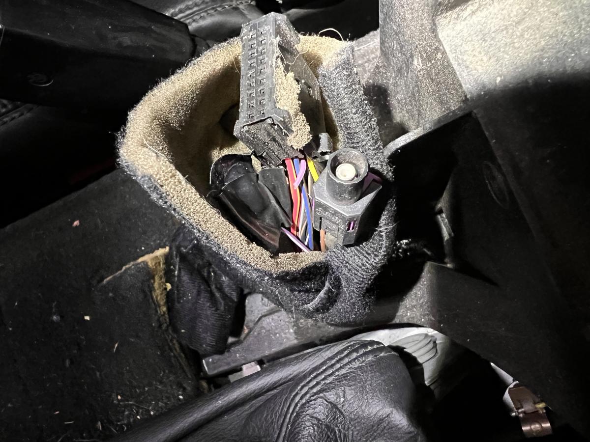

                          Click image for larger version  Name:	IMG_2922.jpg Views:	0 Size:	164.8 KB ID:	266400 So I took out my center console as the front mounting points rotted to hell and discovered some wires underneath. Anyone know what they’re for?? Also looks like the purple/lavender wire was snipped, not sure if that was intentional or not from previous owner
                            This is for a telephone, how it connects to said telephone I don't know.
                            I used a wire from that connector for switched 12V power, likely the same thing the P.O of your car did.
