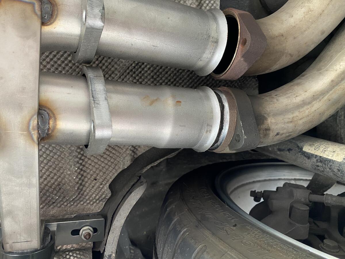

                I’ve been banging my head against this. Would be interested to hear how y’all would troubleshoot. I picked up new RE exhaust hangers to replace my stock ones which have never been replaced, and am installing these along with my new Supersprint Sport muffler. However, I seem to be running into a fitment issue with these hangers on this muffler. Long story short, I’m not able to get the muffler fully seated into the section 2 pipes likely due to the hangers not giving me enough clearance against the wheel well. I may try using one of the stock hangers in this position instead. Any other thoughts/tips anyone can lend me?

                  What is your setup upstream of sec. 2, stock or aftermarket?
                  You may have to use OE mounts on the driver's side on the R.E. on the passenger side only. I currently run the R.E mount on the passenger side only as it keeps my SCZA muffler solid enough to not hit the EVAP canister.
                  Your issue may have to do with the R.E. mounts or just the fact that aftermarket stuff doesn't always land in the same place as factory. Too bad, as those R.E mounts are quite nice, and expensive.

                    All currently stock except this new ss sport sec 3. Seems likely that i'll end up in a similar config and swap one or both of the hangers back to OEM on the drivers side. Thanks for your thoughts!
