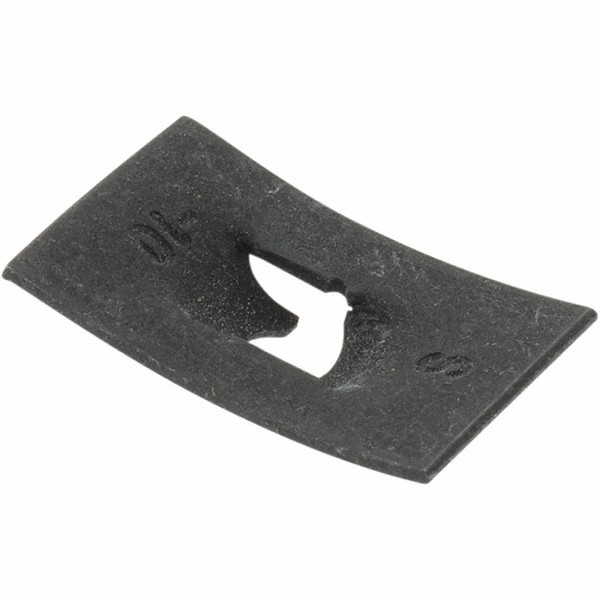

          Hoping there is an obvious solution to this that I haven’t found yet….Anyone have a solution for finding replacement nut inserts for the front carbon/Kevlar bumper reinforcement bumper pins? Looks like they are NLA, and the only option is likely buying a damaged used reinforcement just for the clips..

                  I used a hardware store spring nut aka speed nut although I think technically "speed nut" is the wrong term for these. Looks just like the below, has worked great and even reused them a few times so far.

                      Thanks for the suggestion! I’ve been checking eBay and no luck yet. I did find some damaged bumper reinforcements with all the clips and such still intact so I’ll just likely do that to get the hardware and trash the damaged bar.
                      I think if someone is looking to replace the washer fluid/horn mount clips they could toss the self tapping bolts and use M6 bolts instead with part number 37146850307 Prestol-Cage (M6 Zns3) which has an M6 nut insert and is still available to buy…but for the bumper pins since those are self tapping thread this idea won’t work (sharing in case someone else runs into this issue).
