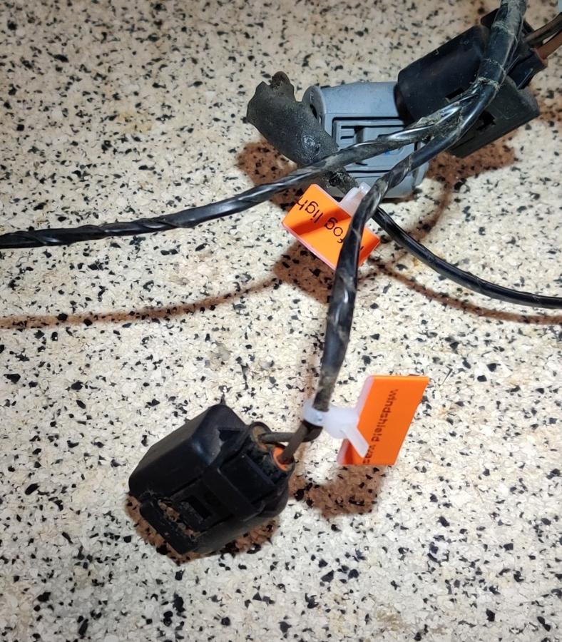

    Do you have high pressure headlight washers? It might be to that pump or the main windshield washer reservoir pump.
      Looks like it could be the high pressure pump. I don't have a pic of it square on to see the shape of the connector but found these pics from when I had mine torn apart.
      In the 2nd pic, it's the black connector at the top of the pic with fairly heavy gauge wire, next to the grey connector.

              Thanks Casa. Very kind of you to dig up the photos.
              The car has no headlamp washers, and I am fairly certain that the washer reservoir had only two connectors - the pump and the level sensor, but at this point I am going to take out the fender liner and check again. The connector in your photo does look like the one in question. Black connector with heavy gauge brown and brown with black wires.

                  My bet is it has always been there (common wiring harness from the factory) and you're either just noticing it, or you disturbed it's hiding spot location and it's more obvious to you.
                  Are there witness marks on the inside of the connector or does it look like it has never been plugged in?
                  Also that high pressure headlight washer connector draws more amps (presumably - it is higher pressure than the normal windshield sprayer) hence the thicker wire.

                    I wont have a chance to pull the fender liner and have a look until this evening, but I do suspect that you are correct. If there is no available connection on the washer tank then I will look for witness marks on the connector.

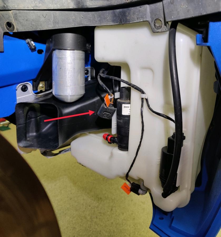

                                I am putting the front of the car back together and there is an electrical connector I cannot seem to find a home for. Anyone know where this thing plugs into?
                                Passenger side. Branches off the harness that attaches to the windshield washer tank. Just below headlamp.

                                Ambient air temperature sensor on the passenger side? Idk if RHD cars or non US stuff has the sensor there instead. My car had an extra passenger side connector when I had the bumper off.
                                The OEM fender liners have a cut out for the sensor on both sides iirc.
