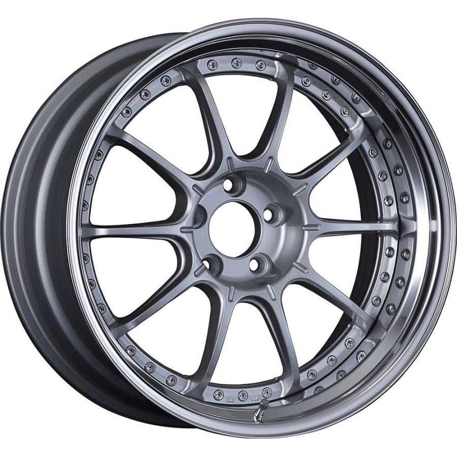

    Thinking about picking up a set of SSR SP5s. Anyone have any idea what these weigh in 18x9.5 or 18x10? I see them listed on some sites at 29 lbs but that can't be right.

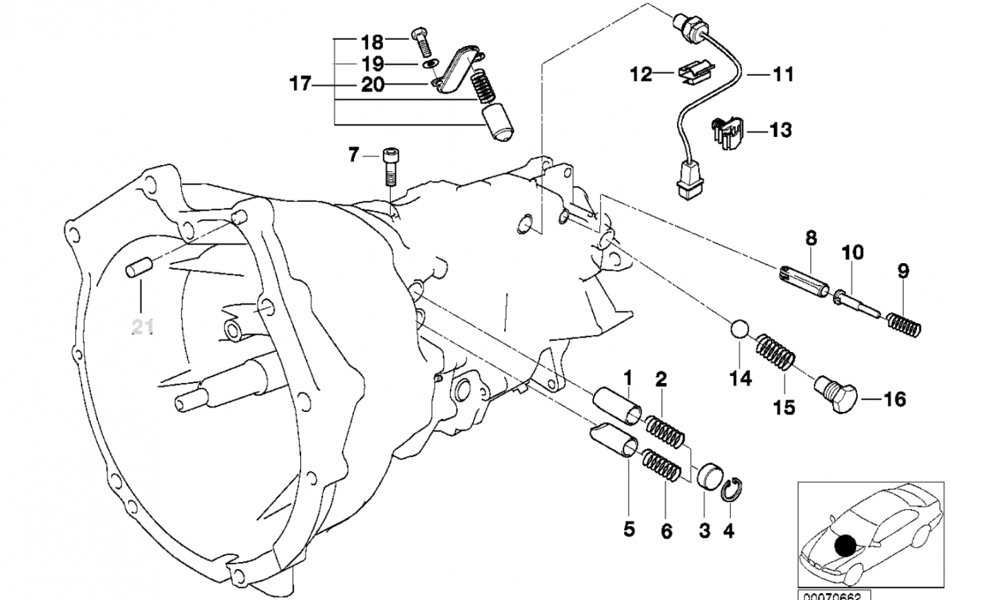

                  I currently have my 6MT out of the car because I'm rebuilding the engine. And I'm trying to solve a slight annoyance with shifting. Haven't driven the car since July so my memory may not be great, but I remember that pushing the shifter into 1st or 3rd never felt quite right. Almost felt clunky trying to get it into gear even with clutched in and engine off. Looking at the compression springs diagram, i honestly have no clue how these things work.
                  I assume since I have no trouble finding the actual gates, I have no reason replacing #1-6 right?
                  I took out the other springs but none of them were broken so it's not clear what could be causing the wierd shifting feel.
                  In short which parts from the attached diagram are worth replacing with the transmission out of the car?
                  I'm thinking of getting the kit for 17 aswell as 8 and 9
                  Or do i get everything and eat ramen until my FAFSA comes through lol.
                  EDIT: I decided to buy everything except the locking device 16. Boutta bust my ass at work for the next month as soon as winter break starts.

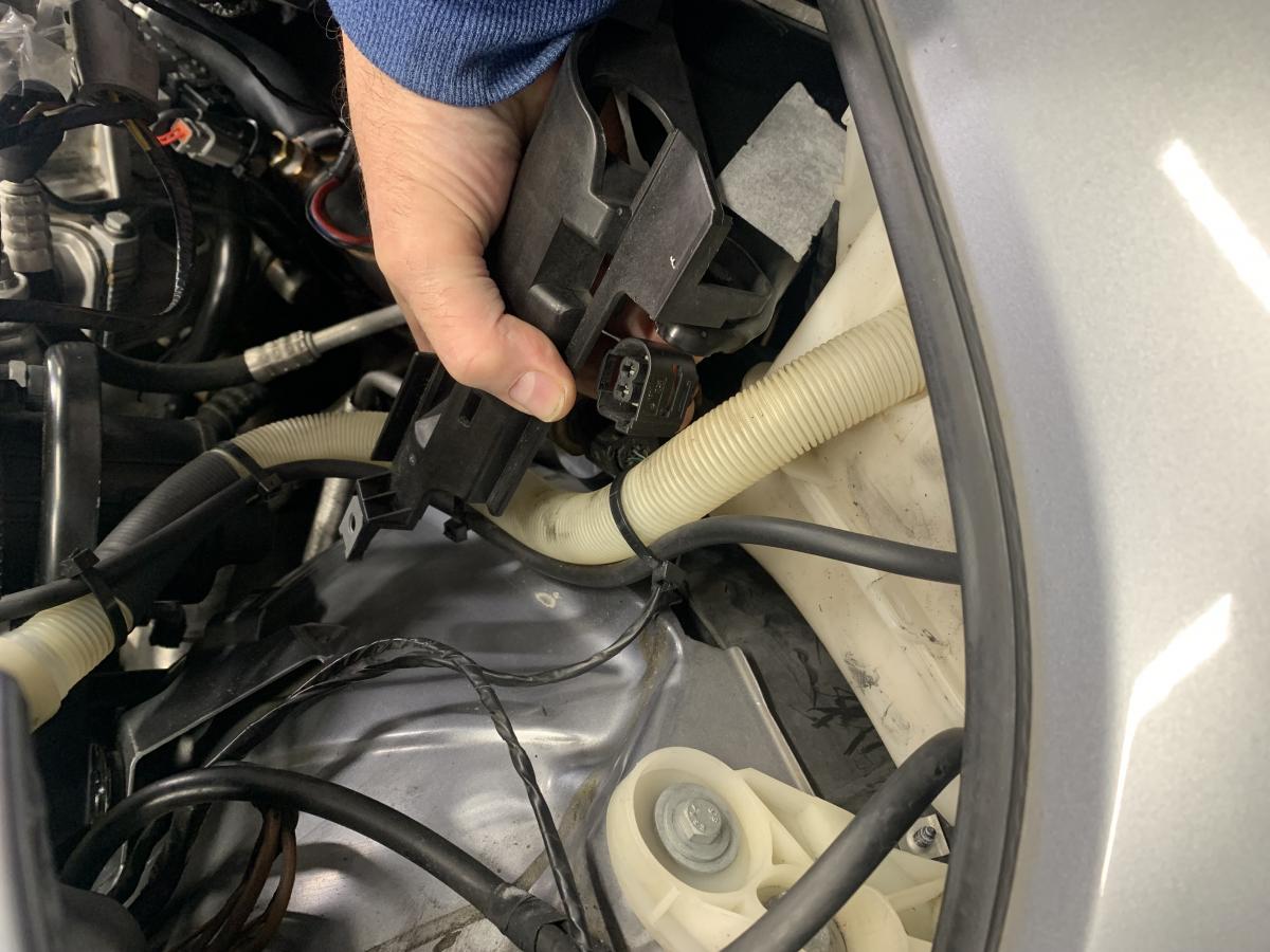

                        I am putting the front of the car back together and there is an electrical connector I cannot seem to find a home for. Anyone know where this thing plugs into?
                        Passenger side. Branches off the harness that attaches to the windshield washer tank. Just below headlamp.

                          Secondary air pump or headlight ballast connector possibly?
                            Possibly fog light connector?
                              Many thanks. I have halogen headlamps, so no ballast, and the secondary air pump has been connected. I am missing something and it has me stumped.
                              I have been through the Bentley manual, but none of the schematics are shown in reference to each other. Anyone know where I can find a schematic of all the wiring on the front of the car?
                              Old, not obsolete.
                                Fog light, corner light, and headlamp connectors are accounted for.
