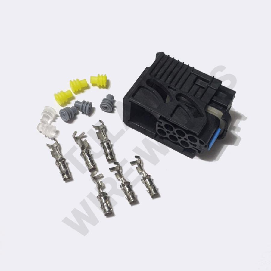

This might not be the specific information you are looking for but these will likely have the one you need, likely the tool is of the circular variety from the pin itself.Originally posted by discoelk View Post
These are some cheeseball Chinese tools, but I have seen even SnapOn brand de-pinning tool bend unfortunately.

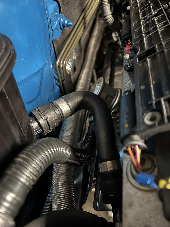

Random but Is there any knowledge/evidence of this expansion tank hose failing?
Only ask because I'm finishing up a complete cooling system overhaul and forgot this hose when ordering. I'm already changing the o-rings with the viton kit. Only point I could see failure other than the o-ring is the plastic in the mating points. I can order one, it's just another $70 + wait time which is a waste if not necessary.

Mine is original. 2002 w/ 134k.Originally posted by bavarian3 View PostRandom but Is there any knowledge/evidence of this expansion tank hose failing?

I've never seen real failure in our cooling system besides the water pump. The o-rings can get flat and maybe you leak a little, but no failure on that hose I've seen. You can "refresh" the hoses with Gary's Oring kit (wolfn8r).DD: /// 2011.5 Jerez/bamboo E90 M3 · DCT · Slicktop · Instagram
