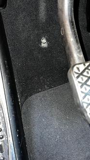

        After service at the dealer, found this thing in the driver’s side footwell.
        Does anyone know what it is?

            Is that attached to the back of the clutch pedal or to the back wall?

              floor/wall

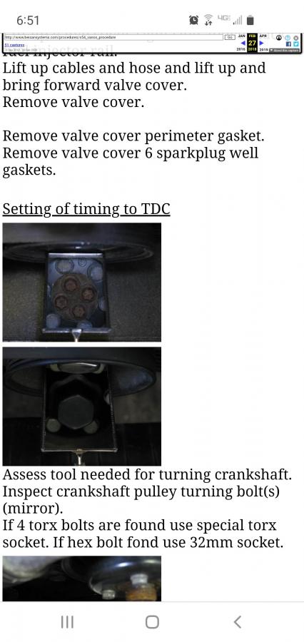

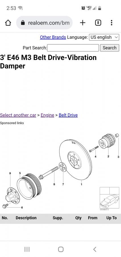

                    When you need to turn the crank by hand some vehicles have the four torx bolts requiring the use of a special tool while other cars (like mine 04') have a 32mm deal you can put a socket on.
                    From what I can see on realoem the 32mm "deal" is simply a cover and underneath are the 4 torx bolts that attach the damper to the crank.
                    Is this accurate?
                    I thought for a while it was a single 32mm bolt vs. 4 smaller torx that attached the damper to the crank but IF that was the case that would be two different dampers and two different cranks.
                    Did BMW decide to put a cover over the 4 bolts on later vehicles to protect them or something of the like?
                          Is this accurate?
                          Yeah just a cover. Crank and other parts are the same.
                          Mine (04/02) also has the cover and realoem says it's been on cars since 01/01. Maybe the ones that don't have it just had it removed at some point (i.e. whoever was working on it didn't put it back on).

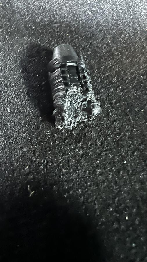

                            It definitely was a pain getting the broken screw shank out of the hole in the footwell.

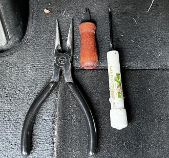

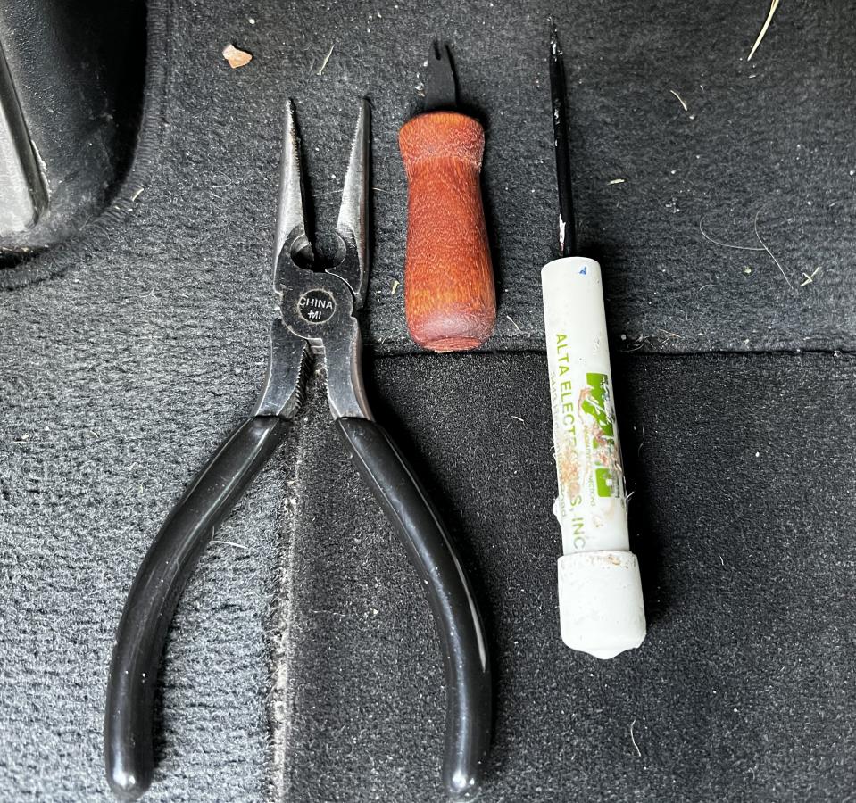

                            Had to use a combination of these tools at different steps:

                            Started with the corn holder. Tried to stab a corner of the remaining screw shank at a 45 degree angle and push it in a circular motion. But that didn't go too far. I was able to get, maybe, 1 or 2 turns out of it.
                            After that, I used the screwdriver. Its tip was very small and thin, so I was able to jam it in between the screw shank and the screw hole's wall and wiggle it back and forth. With that I was able to make an indentation enough for the needle nose pliers to get in. Repeated on the opposite side to get another opening.
                            Finally, I was able to grip the screw shank with the needle nose pliers and unscrew the broken piece. It looked absolutely butchered with all the poking and pulling. But, at least, I had it out.

                            Was also thankful that I didn't have to buy these easyout screw extractors, since I didn't feel like drilling in cramped spaces.
