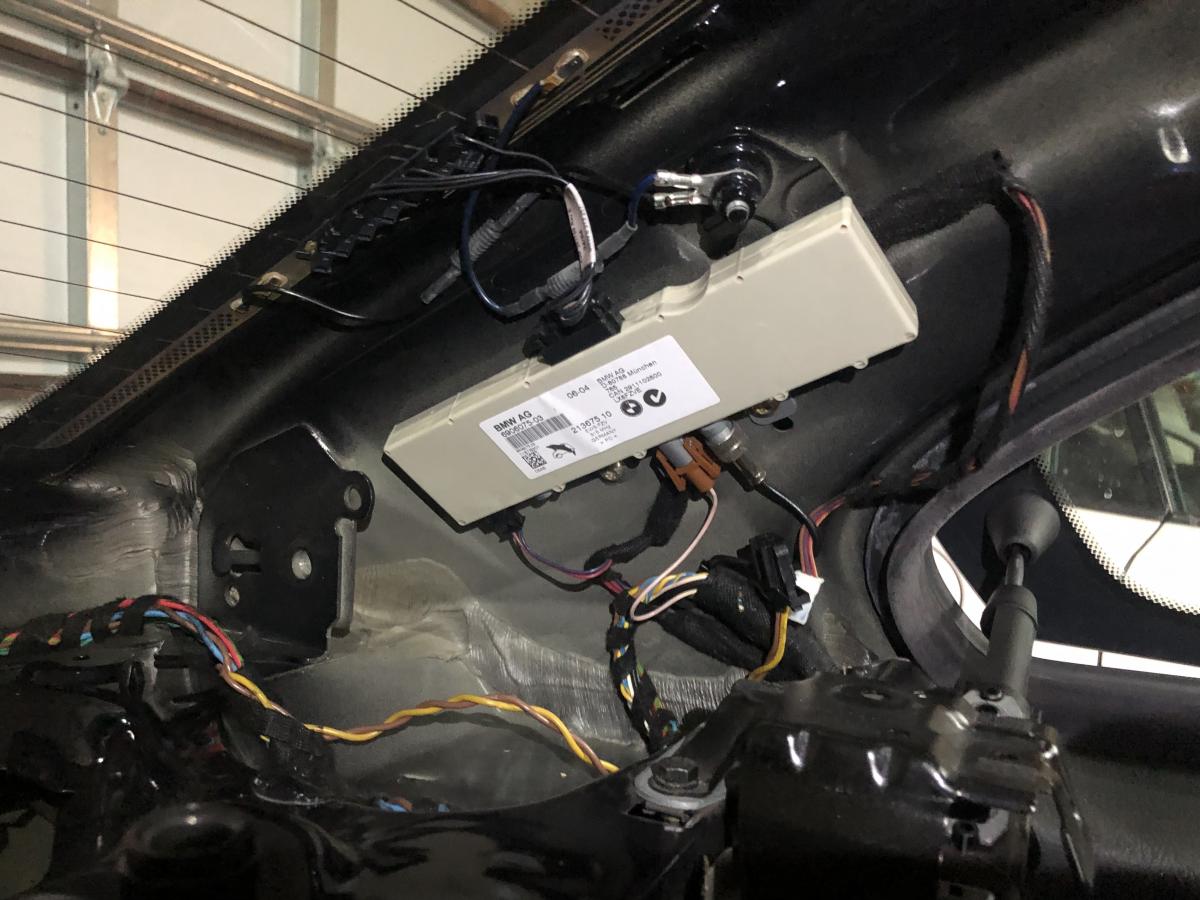

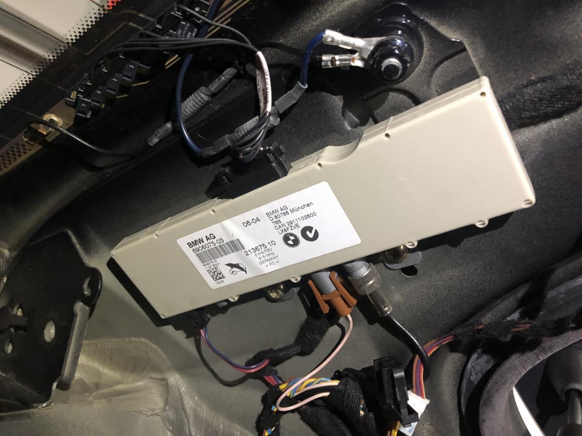

    Whats this module behind the drivers side c-pillar? My assumption is related to the radio antennae and rear glass defroster? My car doesnt have radio and my defroster has never worked, am i ok to unplug and remove this?
      You're correct - Amplified Radio Antenna Module.
