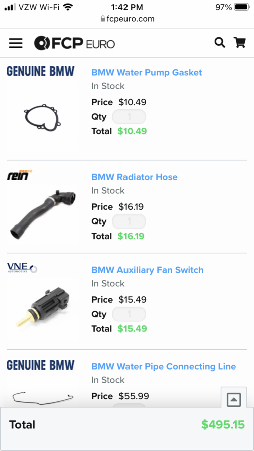

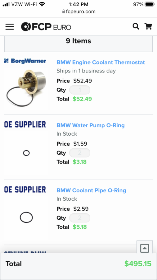

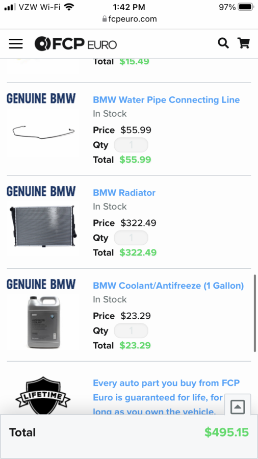

      Another cooling refresh question I have is what components are ok to skip on genuine BMW?
      I have a cart set up with BMW Waterpump, BMW radiator. But then I choose a Borg Warner thermostat, mahle fan clutch, febi fan,, rein hoses and VNE coolant sensor.
        rein hoses
        Get the o-rings that WOLFN8TR sells if you're doing rein hoses. There was a thread in the old forum where some people had issues with the included o-rings. The hoses themselves are fine though.
          You just posted exactly what I did last summer haha. The only thing I did different was an oem fan clutch but you should be fine with the mahle fan clutch.
          Are you getting the parts from FCP or elsewhere ? If you can wait one more week there should be some sales coming up.
                    I'm going FCP, I'll definitely be waiting for a potential Black Friday sale. The car has 69k on it and I don't plan on doing the cooling refresh until ~100k, just trying to stock up on parts before the prices go up or NLA.
                    Also forgot about the little line running from the expansion tank to the radiator hose that you have pictured on your FCP cart. I'll have to figure out that little clamp deal on the exp. tank side.
                      Cubieman Prices have gone up already on certain stuff. Last year I stocked up on everything needed for my subframe reinforcement. I’m comparing prices now and I’m glad I purchased when I did.

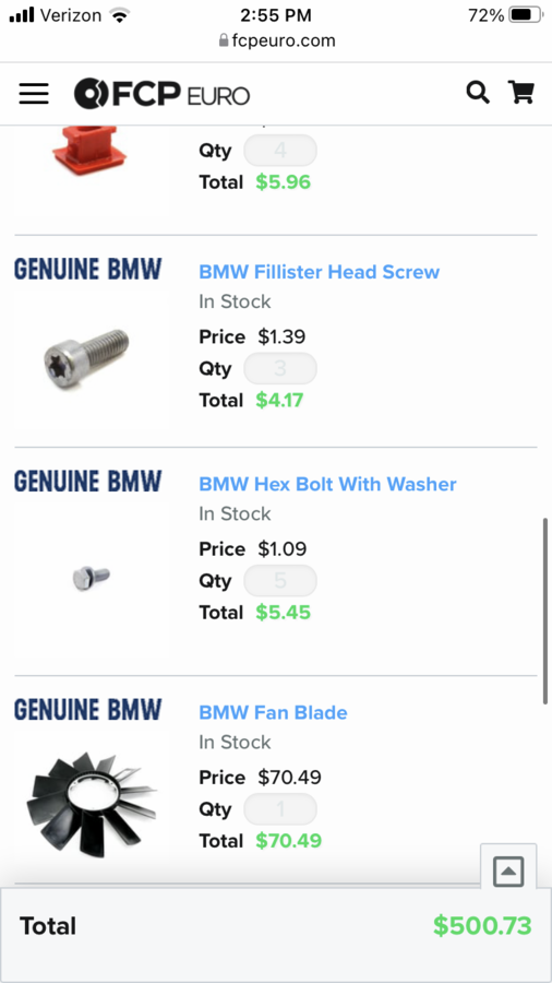

                      I bought my cooling stuff when FCP had the summer sale 10% off up to $500. So I had placed a few separate orders just so I can get the discount. I’ll post some more screen shots in case you may have forgotten something else.

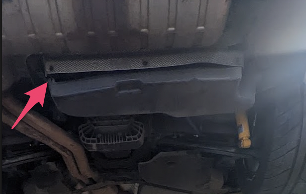

                              What is the name of this part that is broken on my car? Having a hard time finding it on the parts diagram.

                                Looks like part #21, a cover for the charcoal canister.
