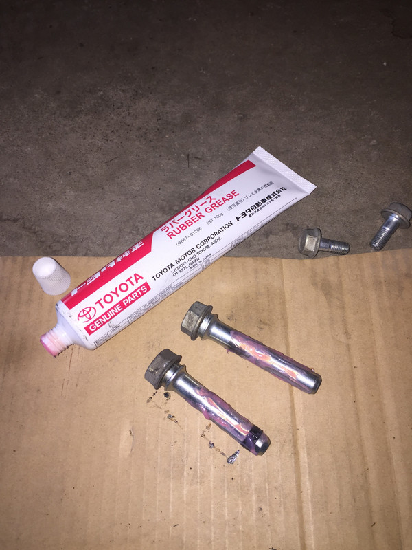

      I did a brake job and installed everything dry--new bushings, pins--had problems. Pulled the pins, lubed with a Lithium soap grease (Toyota, actually) and no problems. Technically, the pins should be pulled every 3 years or so, cleaned, re-greased and re-installed. Maybe replace the bushings too. So, think the "no grease" is a "no <wrong> grease" kind of statement. Lithium soap grease won't swell the rubber. Pic below lifted from another forum, but this is what I used on my Lexus, and, the M3.

        I have heard the dirt argument before. Honestly, if the pins are kept clean every brake service, that is all that is required. Lightly greasing with Sil-Glyde or other should be fine, but it'll have to be cleaned off during service and it can get messy depending on how much is used.
        I'd follow the instructions. This feels similar to adding RTV to the entire perimeter of the valve cover gasket or oil pan gasket rather than only the locations specified in the instructions. It is just not necessary and makes a hell of a mess cleaning it up the next time a gasket needs to be serviced.
          I have always greased the pins on fixed calipers like the stock ones. Especially when used at the track.
          However, one lesson I learned the hard way. Do not put grease on the tip/end of the pin. And especially don't glob it on like I used to. After a couple of cleanings and re-greasing, if you don't clean the caliper mount bore that the pin goes into, it leaves grease behind and will not allow the pin (and caliper) to compress all the way, leading to accelerated and uneven pad wear. So 1) only grease the sides on the pins and 2) make sure you get all the old grease out of the bores before reinstalling.
