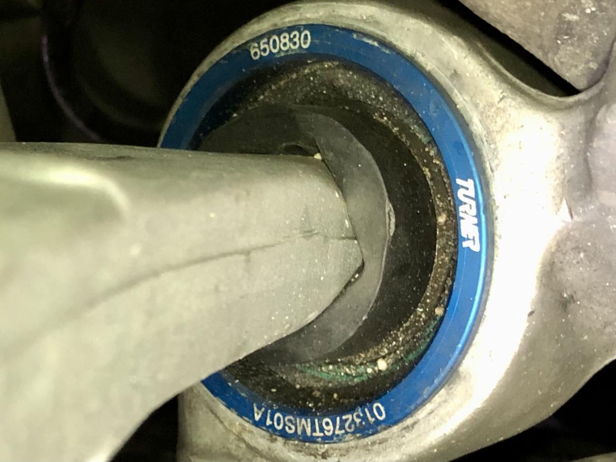

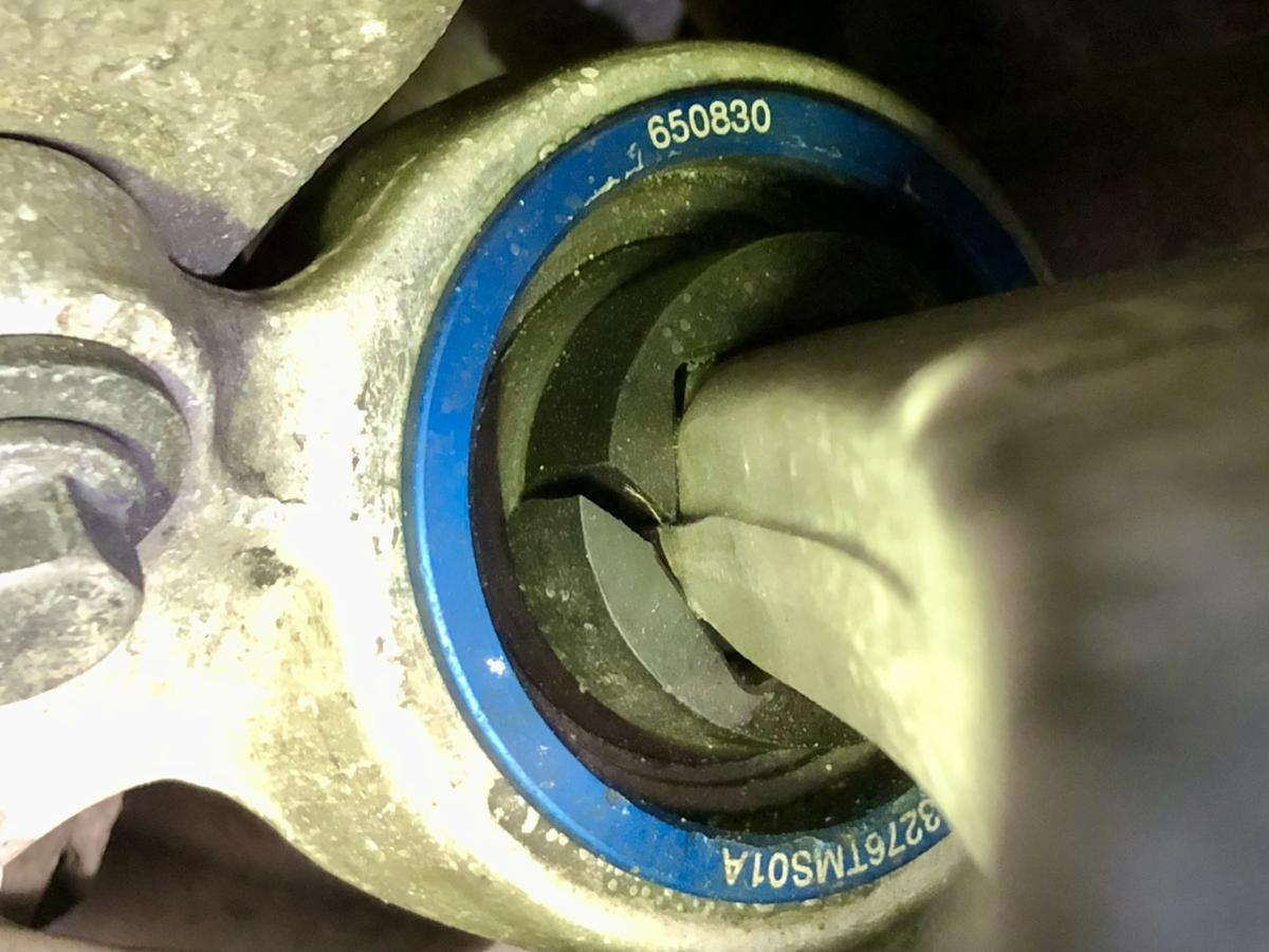

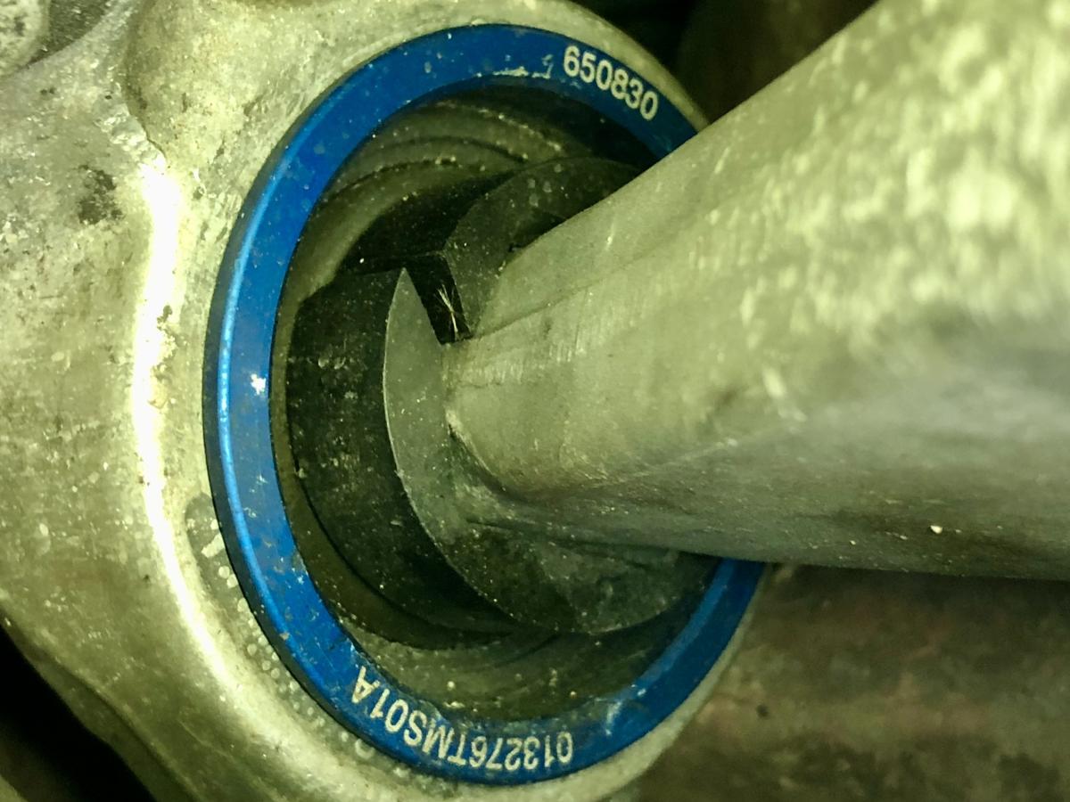

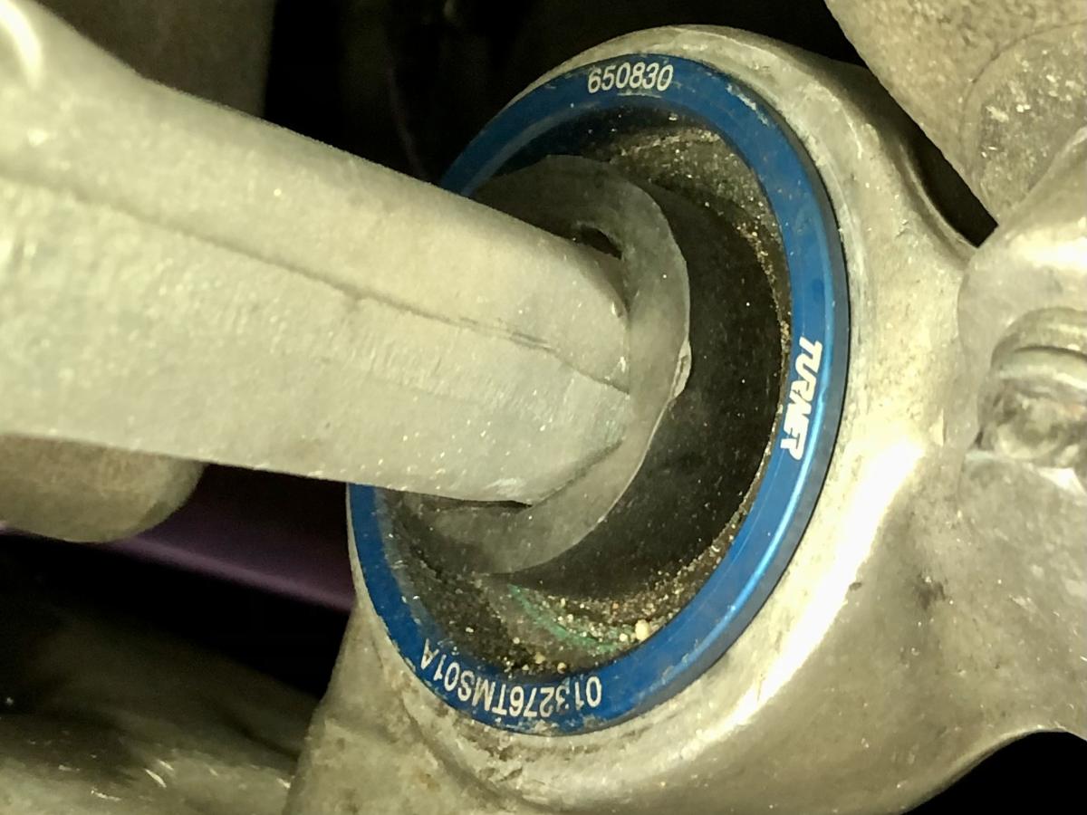

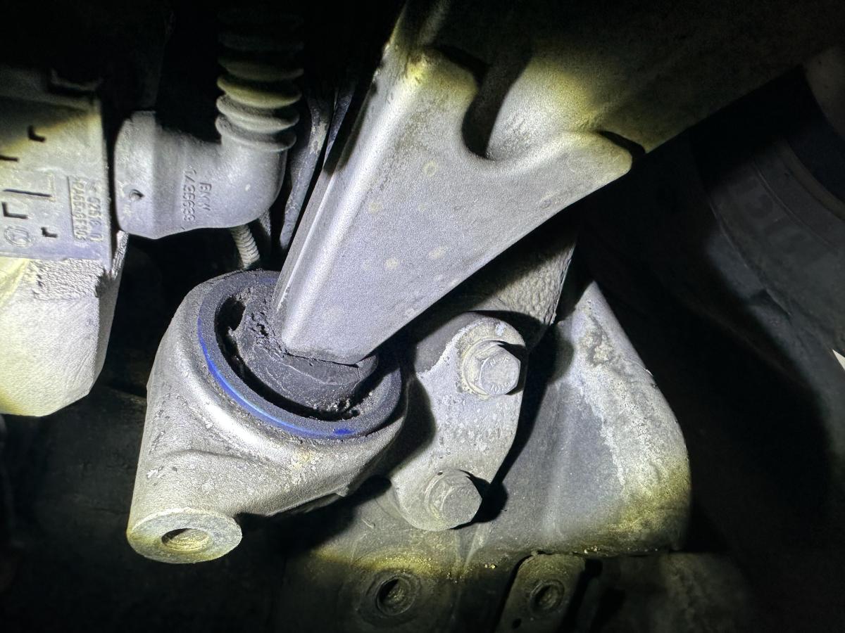

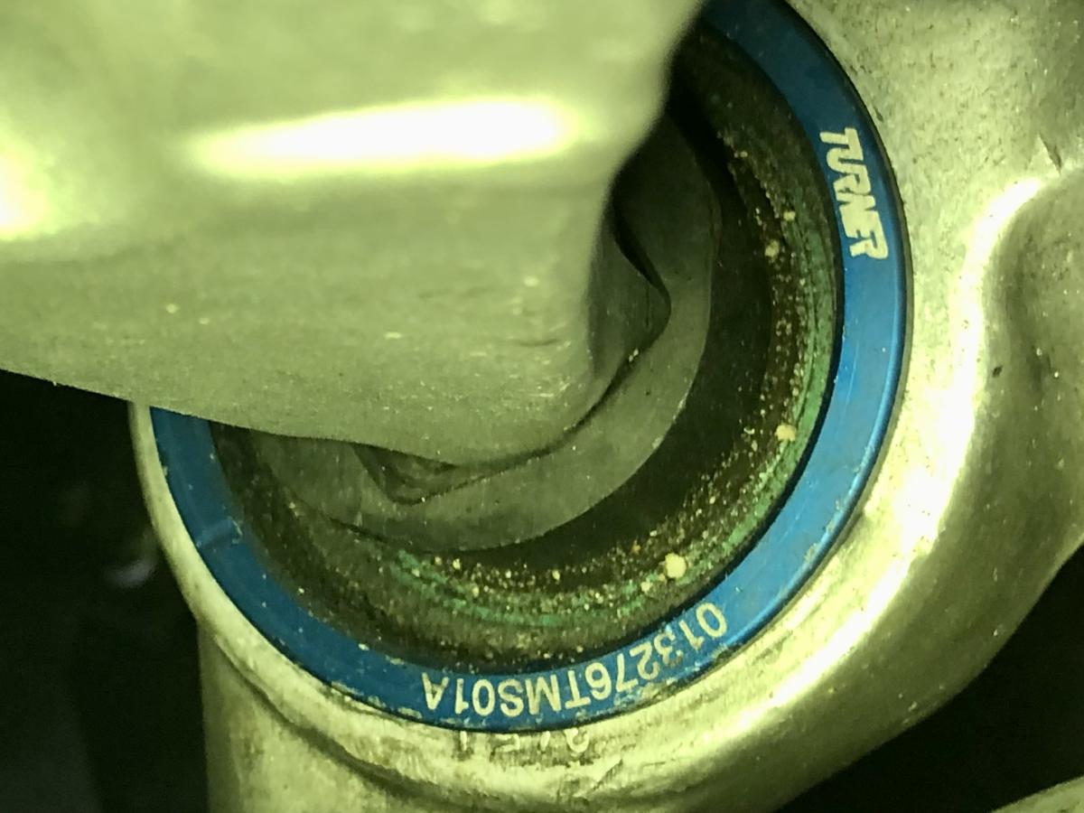

      Dont want to spam the dumb questions thread with my FCAB issue too much, but figured followup with pics of my findings. So; faulty install by my indy’s mechanics when doing the new LCAs last year (had the Turner FCAB installed by them prior that, ~2 years ago) OR had the FCAB just failed/broken?
      Passengers:
      Click image for larger version  Name:	IMG_9758.jpg Views:	0 Size:	142.1 KB ID:	287832 Click image for larger version  Name:	IMG_9759.jpg Views:	0 Size:	112.3 KB ID:	287833 Click image for larger version  Name:	IMG_9762.jpg Views:	0 Size:	122.1 KB ID:	287834
      Drivers:
      Click image for larger version  Name:	IMG_9765.jpg Views:	0 Size:	102.8 KB ID:	287835 Click image for larger version  Name:	IMG_9766.jpg Views:	0 Size:	108.4 KB ID:	287836 Click image for larger version  Name:	IMG_9768.jpg Views:	0 Size:	107.9 KB ID:	287837
      Thing is i had seen that the passengers side had that crack right after the lca install but didnt think much of it… i didn't complain to the shop thinking it was just a superficial plastic outer piece and there was no noise or creaks at the time. I feel if it was broken before they did the lca install they would've said something.
      Also I wasn't able to replicate the creaking sound with the front end in the air unfortunately.

        Look like it broke right at the cast line
              Passengers:
              Drivers:

                              Same issue being that yours are cracked as well, or also have the creaking sounds too? Lmk what you end up replacing them with
                              cracking.
                              so this picture is from last year and probably after 50k (at least) of driving on these. After rethinking maybe yours are failing pretty fast if they are only a few years old. This was daily driving and a handful of track days.
                              You can see a crack developing.
                              overall the car has done 50k miles (realistically I think closer to 60-70ish) on these and don’t squeak. They did however squeak for the first 500 miles or so.
                              i probably will replace them soon with new units as i love the feel… compared to stock. Don’t remember how the poly ones did in comparison
