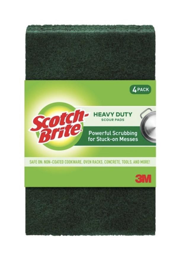

                          Any ideas on what to use to remove residue from cylinder walls?
                          WD-40 and scotchbright. Best to put rags in the cylinders to catch any the debris falling into the piston rings.
                            Thank you…just to confirm, we’re talking about this scotchbrite?

                              Yeah, it will be abrasive enough to remove heavy carbon buildup, but shouldn't remove any material from the iron block. You just don't want any of the fibers or loose carbon getting between the piston and rings. If you are going to leave the block and cylinders exposed for an extended period of time, it is good to spray them with WD-40 to keep moisture out; otherwise, they can start to form surface rust.
