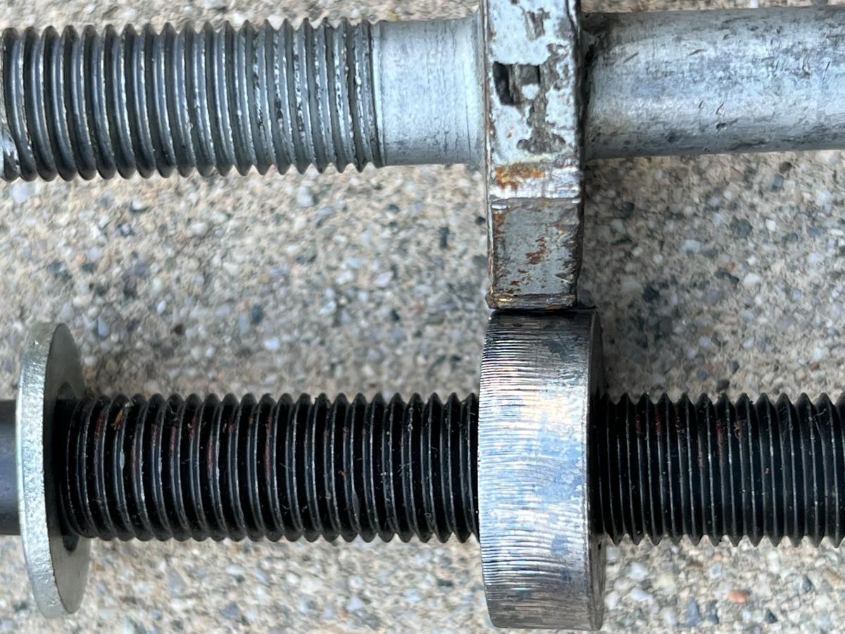

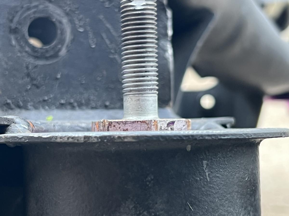

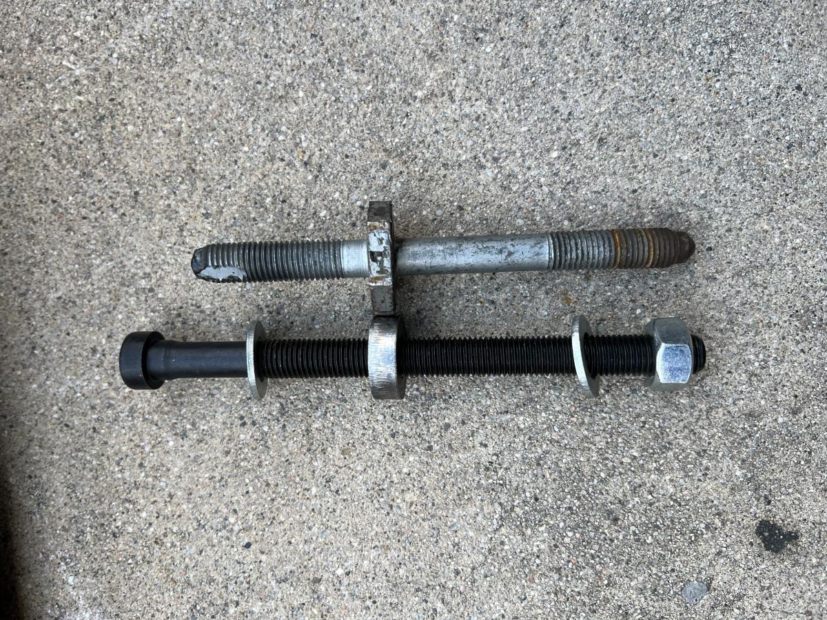

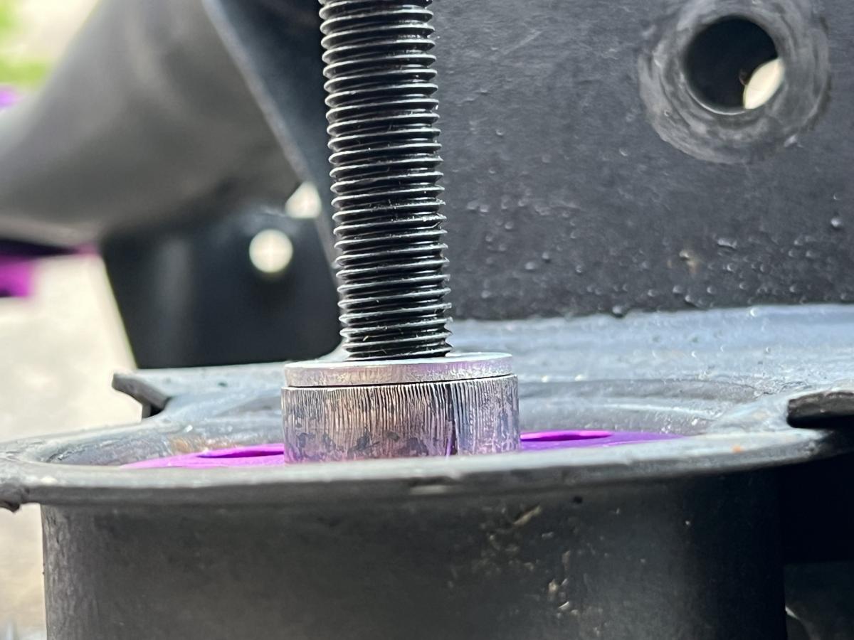

        Which brace do you have? I have a Yurkan Cages 6-point brace. Funny though the spacers he gave me are thicker than the hex washer on the OEM bolts. So I’m using the stock bolts and I cut myself a stud using an old stock bolt, and thread them in from the top. I wasn’t comfortable running a thicker spacer because of the solid aluminum CMP mounts I’m running. Dunno how much impact a few mm would have but I figured better safe than sorry(?)
        '01 M3, Imola/black
          Which brace do you have? I have a Yurkan Cages 6-point brace. Funny though the spacers he gave me are thicker than the hex washer on the OEM bolts. So I'm using the stock bolts and I cut myself a stud using an old stock bolt, and thread them in from the top. I wasn't comfortable running a thicker spacer because of the solid aluminum CMP mounts I'm running. Dunno how much impact a few mm would have but I figured better safe than sorry(?)
          I did the same thing, have yet to drive it, but used stock bolts from the rear to cut and add to topside front.
            Interesting! I have the Yurkan 6 point as well and the spacers are the same thickness as the hex studs. When did you buy yours? Maybe he's changed the size of them? I bought mine April 2024.
              Interesting indeed, I bought mine I think early 2023? Here’s a couple pictures:

                Also I should clarify something, I don’t actually have the brace installed and working yet. I have cut the studs though. I’m
                actually curious if you guys had any fitment problems? I tried mocking it up on the car when the car is on quick jacks and the studs do not line up with the holes. I’m wondering if they will when the car is on the ground… 🤔

                  I don't have any photos of the spacers I received but basically exactly the same thing but thinner (same thickness as the hex).

                    Mannnnn. The spacers are wrong, the holes are wrong, gotta love it.
                    I’m going to have to over drill the holes a little I think. I can’t just force it over the threads on those bolts.
