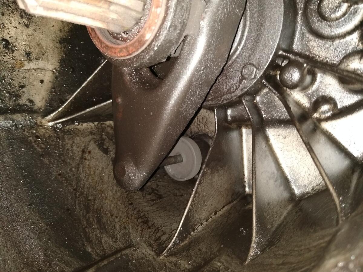

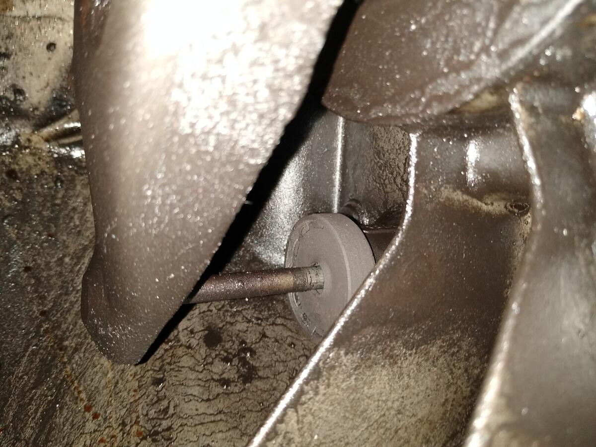

                  The "leak" if it's on the passenger side especially, is not an issue. It's weeping, not leaking. As long as the fluid is not dripping on the ground. The diff bushings use a stout foam. You don't need new ones at 71k. Ofc some people, like myself, replace things way too early, but you don't HAVE to.
                  Tbonem3, thanks!! it seems like your always answering all my questions!
                  Yes both sides are weeping and no dripping. I am very OCD about my car but i guess i'll wait till later on to replace the seals.
                  i had the car jacked up while installing my dinan ssk and i notice there's also some oil drips somewhere else and the mechanic said it could possibly be the oil pan gasket? hopefully nothing serious
                    You can spend your $ how you like because a huge part of the enjoyment of the car, for many of us, is replacing parts diy. But if you're prioritizing/budgeting, you can hold off for a while.
                    OPG can leak. It'd be great timing if you need rod bearings done soon. Replacing the oil pan gasket is almost a rod bearing job unfortunately (hang engine). If you could pinpoint the leak, there might be some sealant that could be applied externally? Not sure.
                    That said, I bet several different leaks would drip down and move back towards the tranny so you may want to try to isolate it or inspect for dampness higher than the oil pan line.

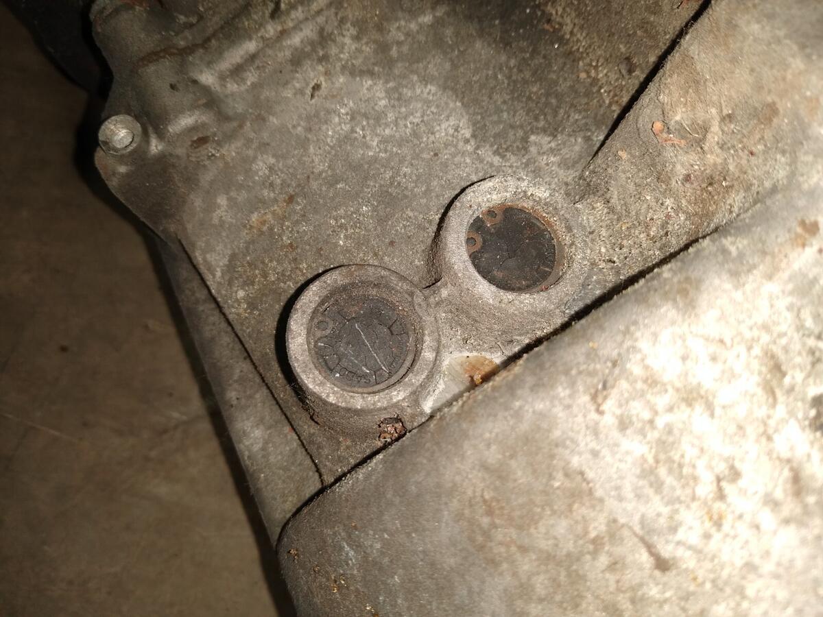

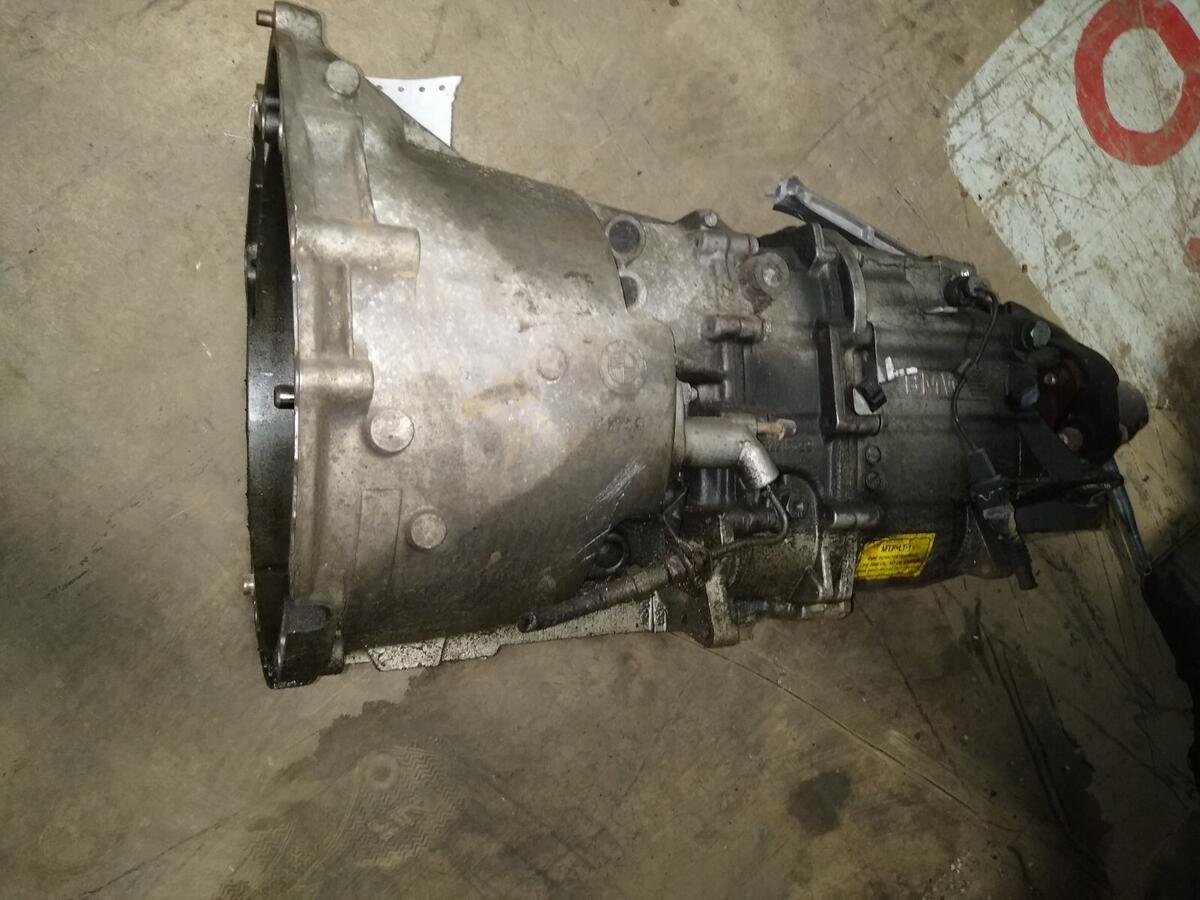

                          Can someone help identify if this is a manual or smg transmission?
                            Looks like a manual because the detent springs are already plugged up. Also, the gear Identification switch is already in the location where it needs to be tapped for an SMG
                              Worth buying for $1000? The risk is that it was in an accident and could possibly be inoperable. Looking to do the SMG to Manual swap.
                                Any reason why you're not just machining your trans? It'll be cheaper and you'll know that everything works like it should.
