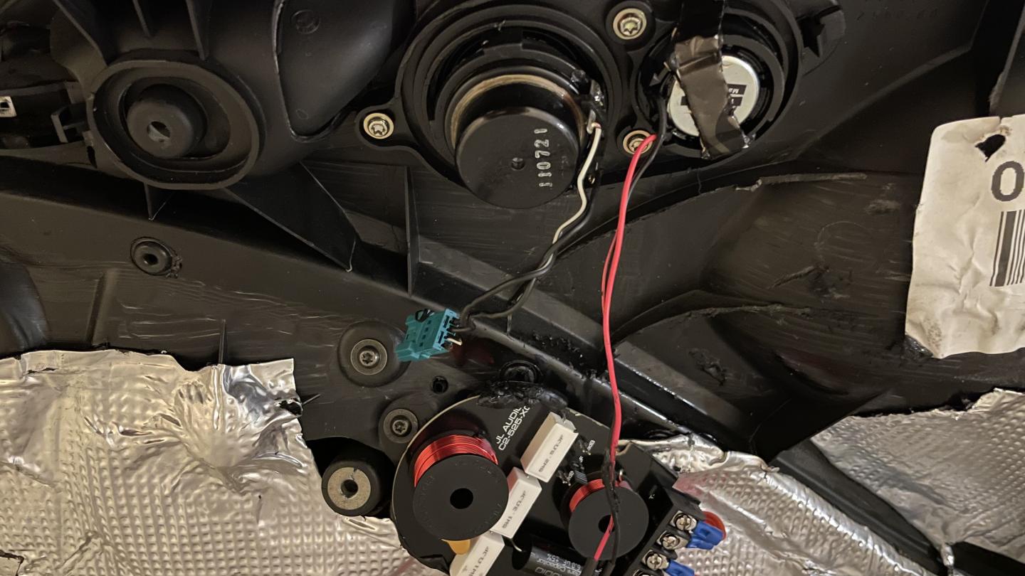

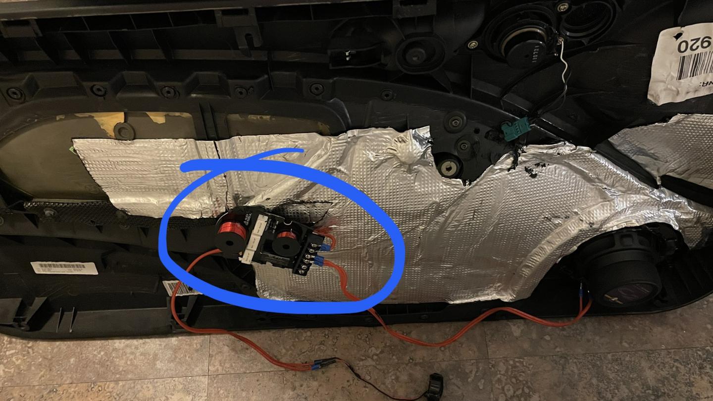

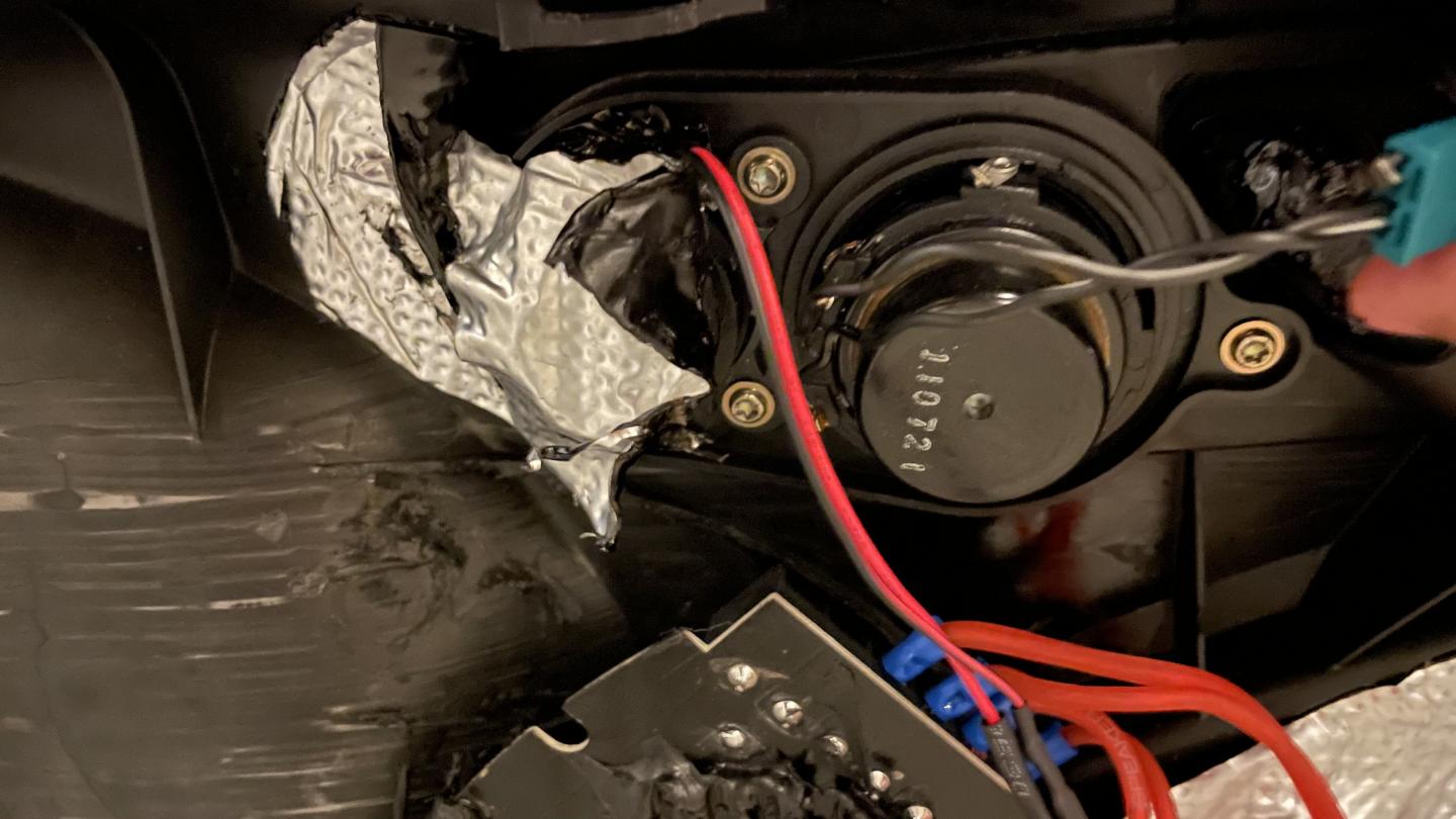

              Any audio experts able to help me figure out what’s going on here with these aftermarket speakers that came with the door cards I just got? They’re not hooked up to any OE plugs, so did someone give up halfway thru the install? Thinking about just replacing them with OE HK speakers. Thanks.

                Those are passive cross overs and they're feeding just the woofer & the 1" tweeter. Factory 2" and wiring bypassed. I can't tell if they are running their own wire for the main input or if they borrowed the factory woofer wiring. If they ran all their own wire, it would be visible at the door electrical boot, only place to feed it.
                  Those JL two way components are a good upgrade over HK speakers. However, they really need a full range amp to drive them. Since it’s a part way install it would pay to check what amplifier has been left in the m3. Would pay to check behind left hand trunk liner to confirm if factory or aftermarket amp is sitting there.
                  If aftermarket run with the JLs and complete the install. If the factory HK unit is there, connect the mid range connector back and daisy chain the hk tweeter of the mid. Make sure the tweeter still has the capacitor across it to avoid the mid range music present from damaging the tweeter.
                  Connect the JL audio mid bass the the hk woofer connector. Whilst it might not present the same ohm rating as the hk mid bass it will probably sound better than a hk woofer.

                      Thanks for the info! I’ll ask the owner which amp he had. If HK, I’ll probably just run the HK speakers, since it sounds like trying to run these JL speakers will require a lot of work.
