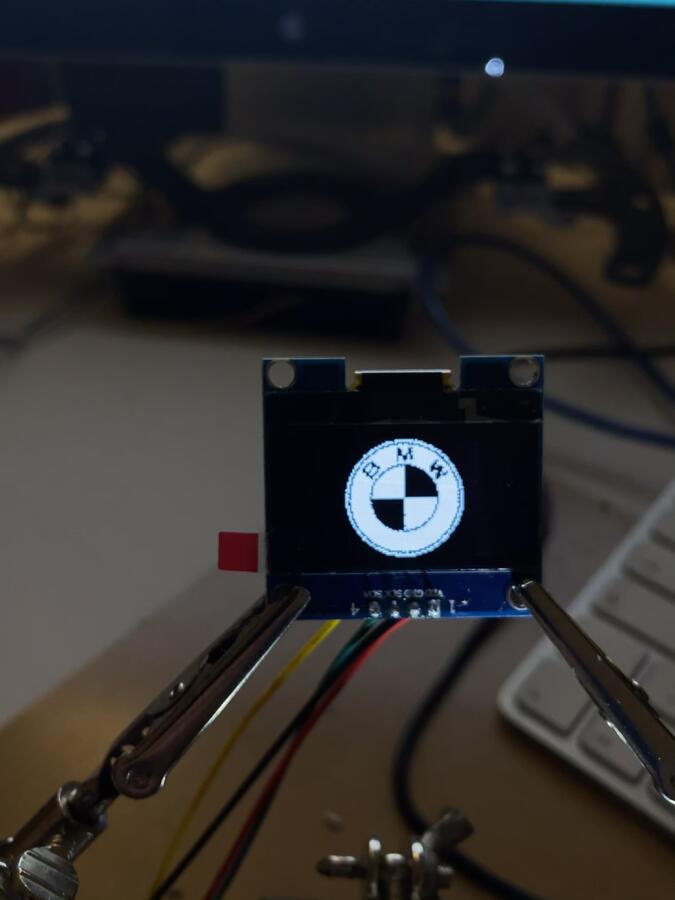

                            -Splash screen with Logo or Text when powering it up

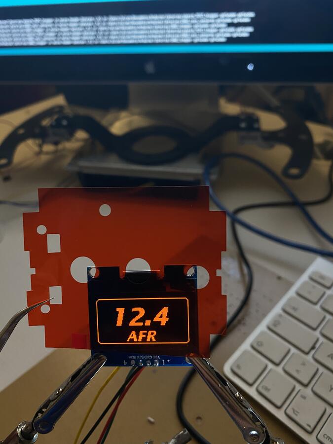

                            -I found a amber/red film in a e30 clock, and it gives a very nice color. Currently searching for a transparent film like this to color match with amber Interieur design.
