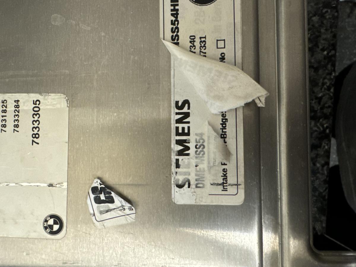

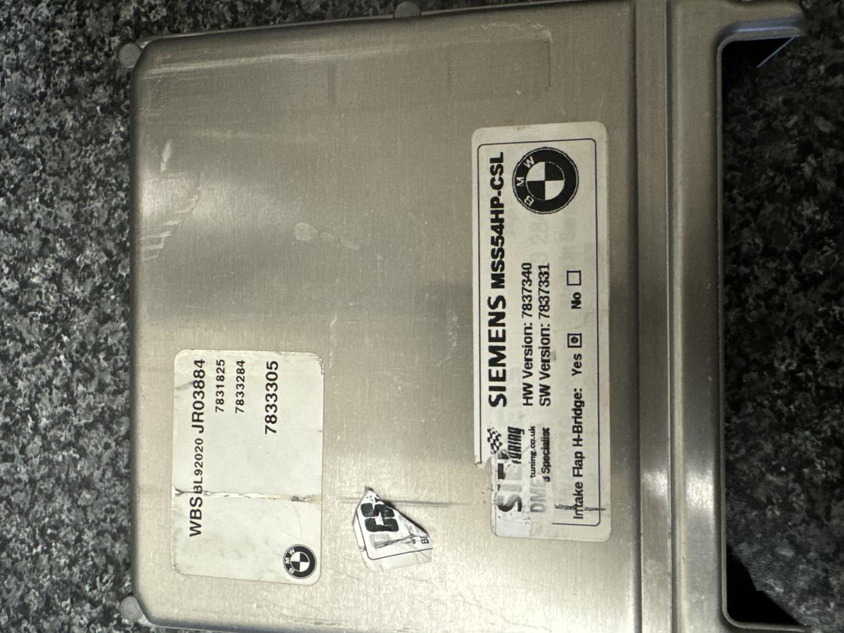

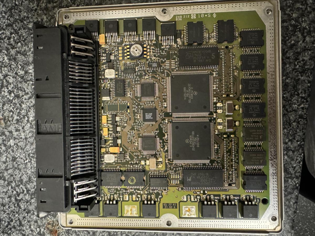

    Just pulled it out and taken a closer look.
    Tuner had placed a sticker over the original and now having peeled that back can clearly see it is a mss54 and not an mss54hp.
    See pictures.

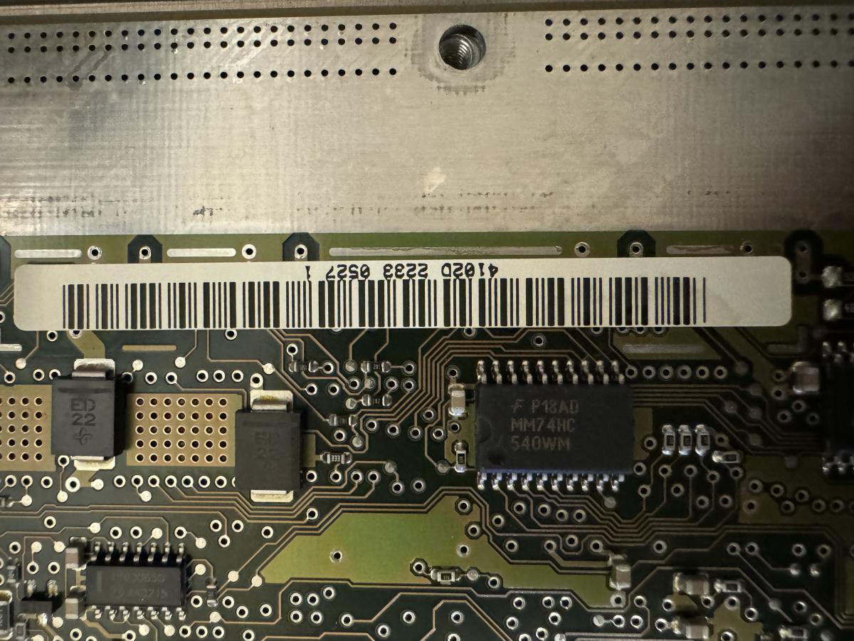

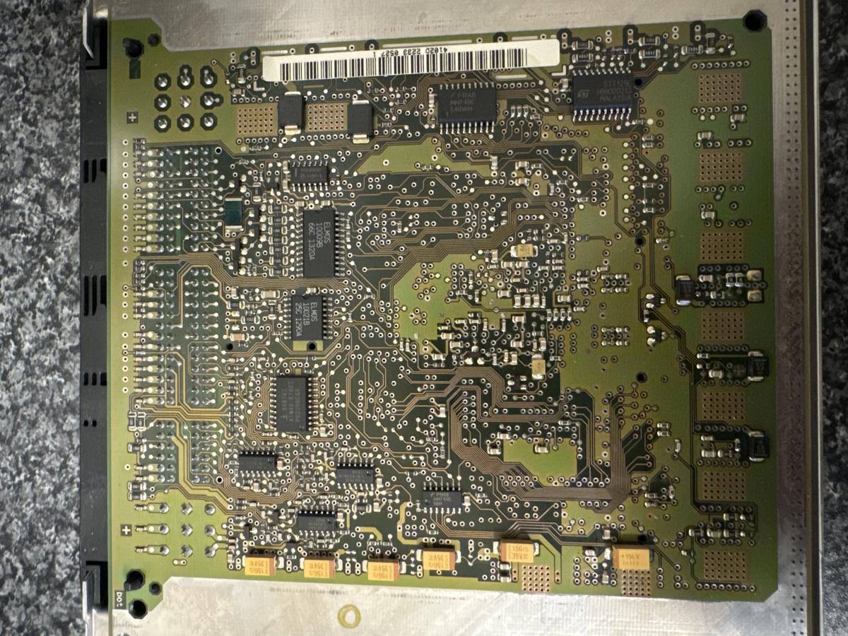

      See pictures.
      Well that answers that…
      Looking at it it looks like it's had the resistors and capacitor added as it should and that would make sense given we're seeing valid values from the MAP sensor.

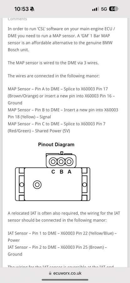

        Yes it is a Bosch 101 sensor, it’s located under the pollen filter housing using a t piece on the line that runs behind the airbox under the pollen filter housing.
        It is wired in as per the diagrams provided in several online resources (pic attached).
        We have recently renewed the map sensor and wiring incase there was something not right there (pic attached of the replacement sensor) but it has made no difference and we’re still unable to clear the code.
