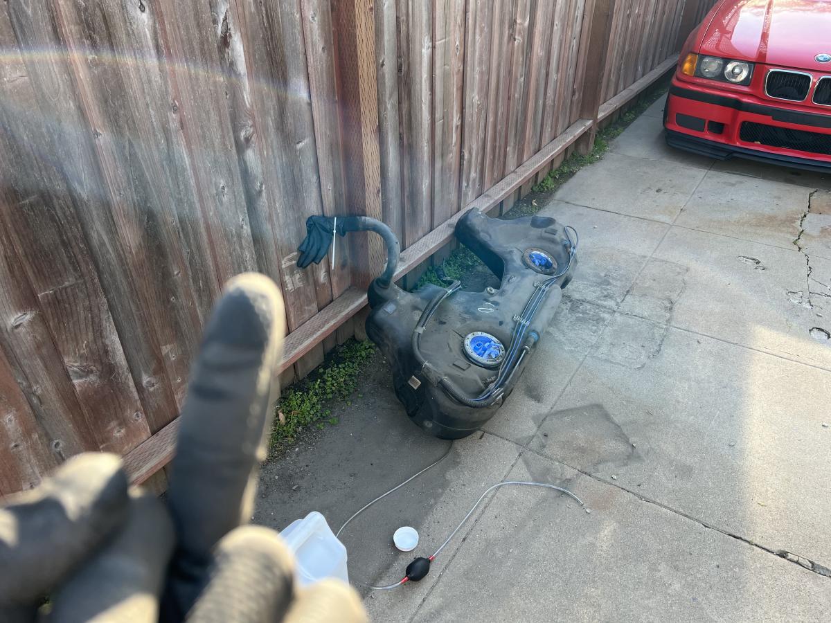

    Penetrating oil and get an o-ring pick to get inside the hose. You lift hose from nipple than shoot oil or lubricant like PL100 and try to rotate the hose on the nipple.

      Disconnect them in the wheel well and pull them through the body when you drop the tank.
      When I drop a fuel tank I don't even pull the backseat, you can get everything from the bottom.
      I hadn't thought of that, do you find that's easier overall, including getting he lines back through the body cavity at the end? I already cut some of the clamps and if GT4's method doesn't work, I will try doing this.
        Do my method for the hoses but where George mentionned! I also do it like him when I drop fuel tank to do RACP reinforcement. I remove line from passanger side wheel well.
        Also, it’s way easier if reservoir is empty

          Okay gotcha, thank you!

            I've pulled 40-50 E46 fuel tank in the last 5yrs alone and would never do it the way you are, just a fyi. Not saying it won't work, just that its waaaay harder IMO.

              Cool got it, I'm going to do it as you've suggested. Thank you for the tip!

                Heroes of the day, Gt4 George Hill thank you kind sirs. Took me all of 5 minutes to get this out by disconnecting the far end of the lines and feeding the hoses through the body cavity. Yesterday was super annoying and I’m glad to have this out so I can keep going!

                  Make sure to put foam insulator on top of fuel tank where there is square shape. Once the tank installed, it will squeeze tank again chassis and will avoid rattles!
