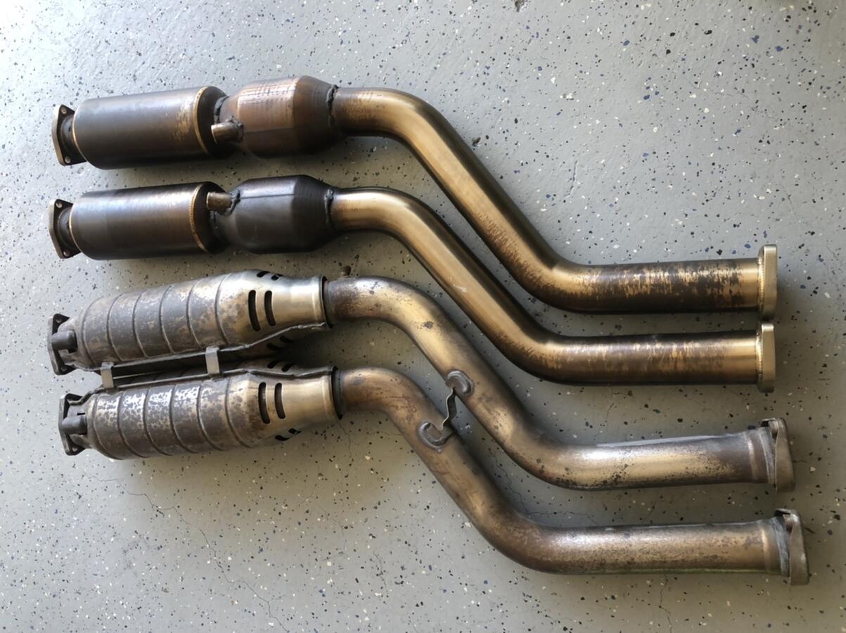

            Finally got a hold of a Euro200R. (Got rid of the euro sec 1 last week)

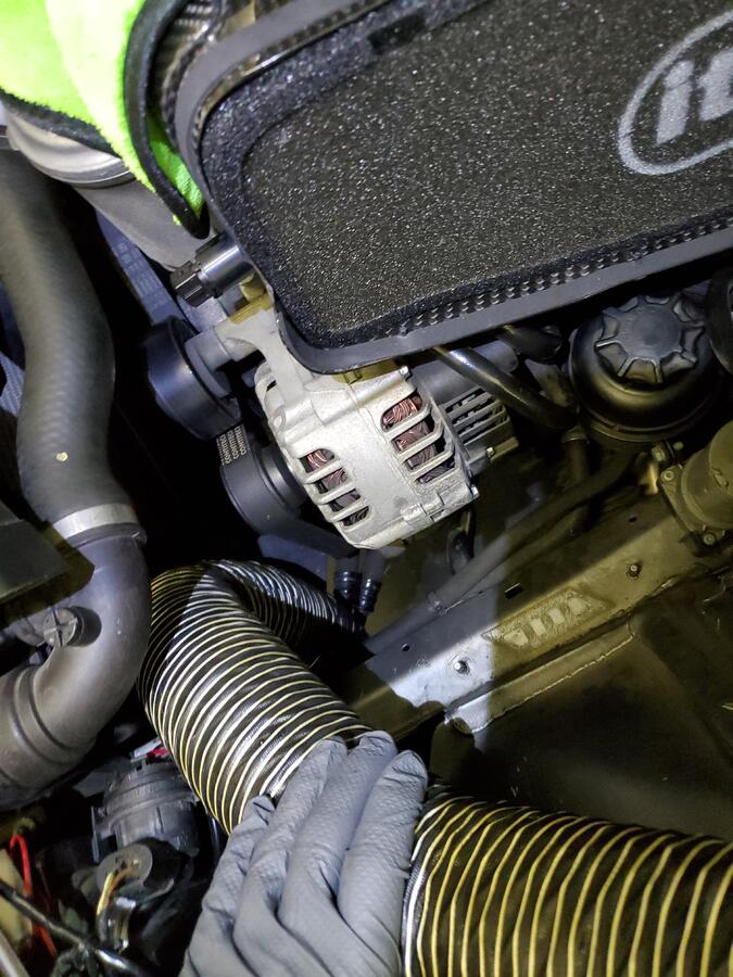

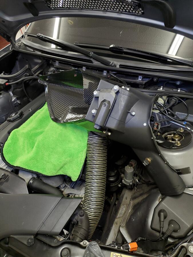

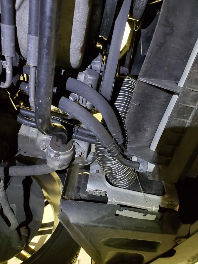

                  Installed ducting to let colder air into the rear hole on my Karb. airbox.

                        So those pipes are what? It looks like a US Sec. 1 with resonators downstream of some tiny cats. Cool setup, just have never heard of a Euro200R and am not quite sure what it is.
                          Yes, made by Jack @ CPI years ago before he sold to BW. Wanna say the piping is slightly over stock as well (like 2.25 or even 2.36 instead of 2.16").
                          That's a huge step down in terms of the quality of cat, mind. More flow, however.

                            Well said
