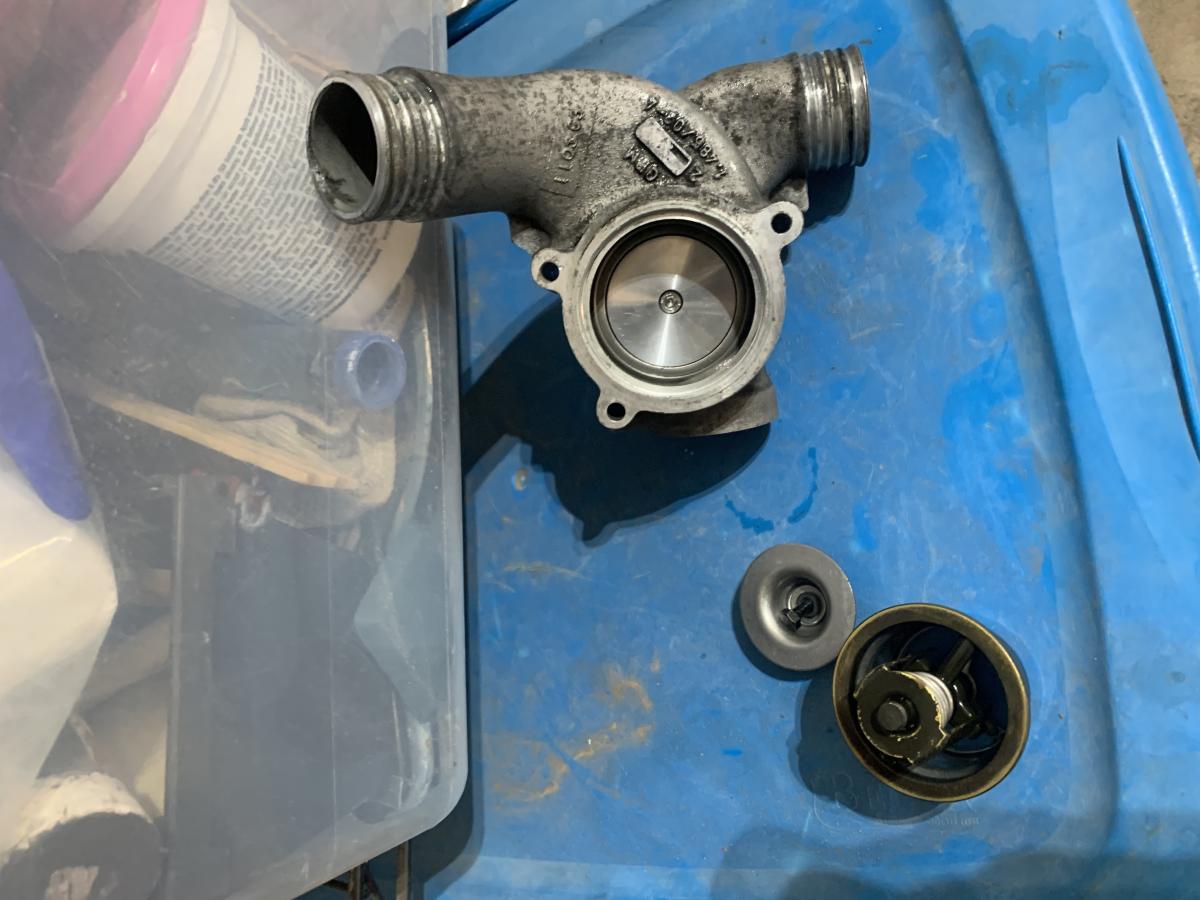

        I deleted my thermostat today,
          I thought my thermostat manifold was beat up 🤣

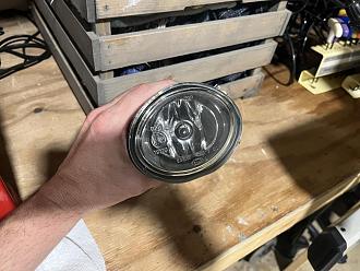

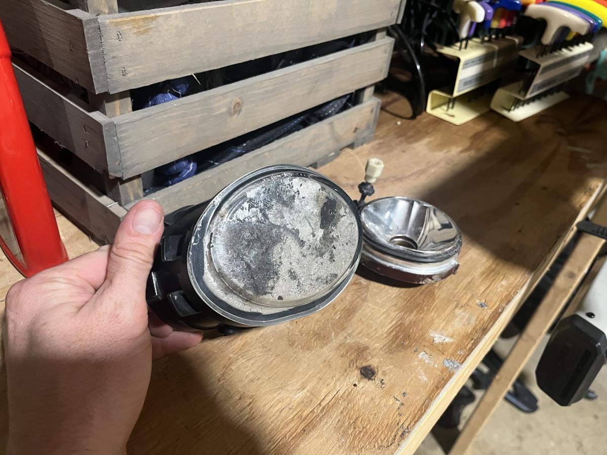

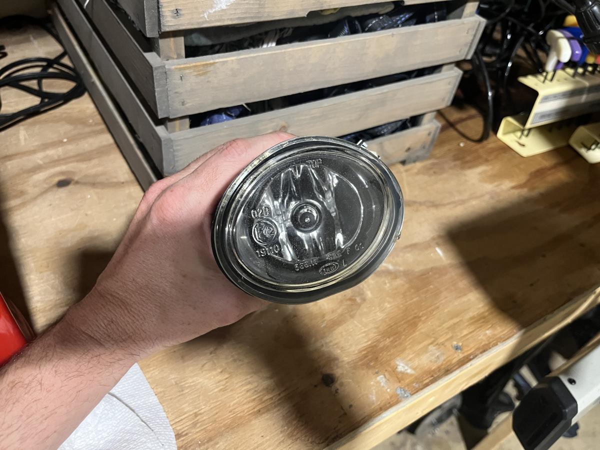

                Removed and deep cleaned these crusty oem fog lights.

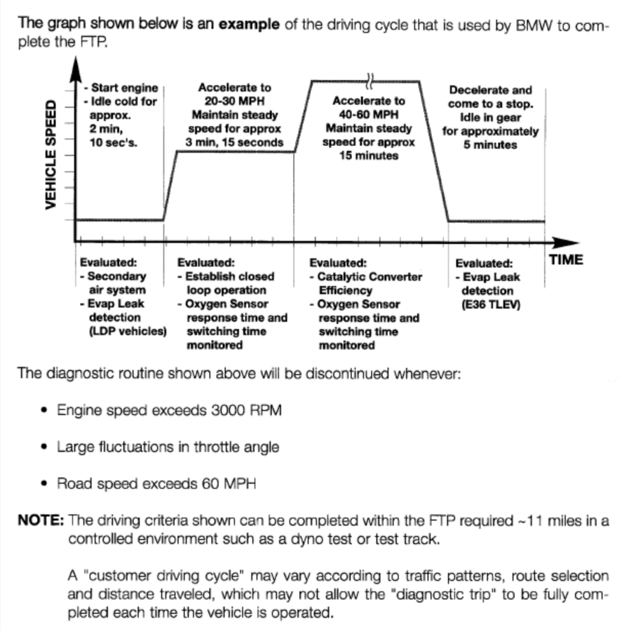

                        still trying to get the SAP readiness monitor to set so I've been driving it to work. I've missed how much fun it is to drive.
                        this should set in the first 2 minutes of idling with engine cold
                          I've been cold idling it the last week in the mornings lol. Not sure what I'm doing wrong. All the other monitors are set besides that one.
                            Is your battery ok? just did a quick google (gemini) is saying potentially weak battery or vacuum issue. Although I recall having the same problem last year on my crashed car and it took a couple of weeks before it set.
                                yup, it fires up with no issues in the morning. i guess i'll keep at it for a few weeks.
