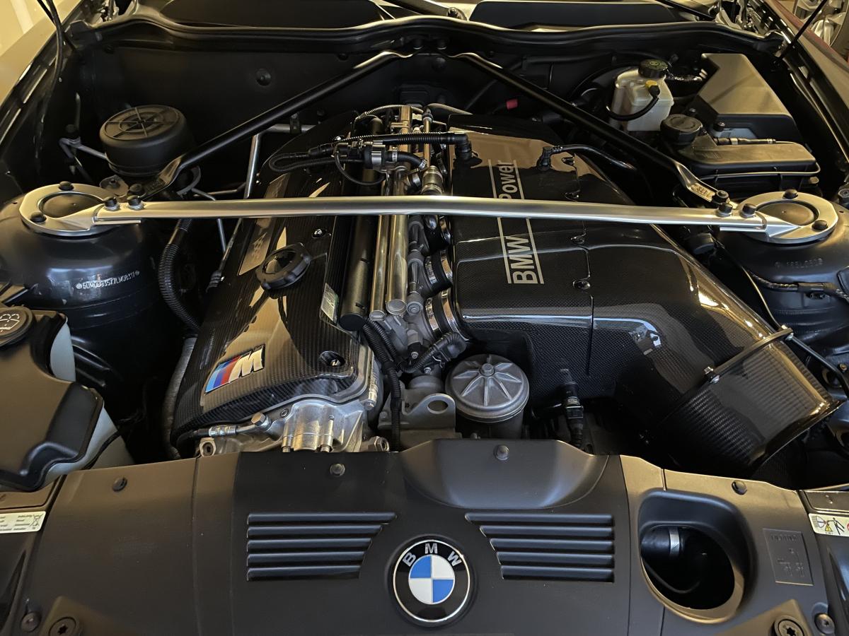

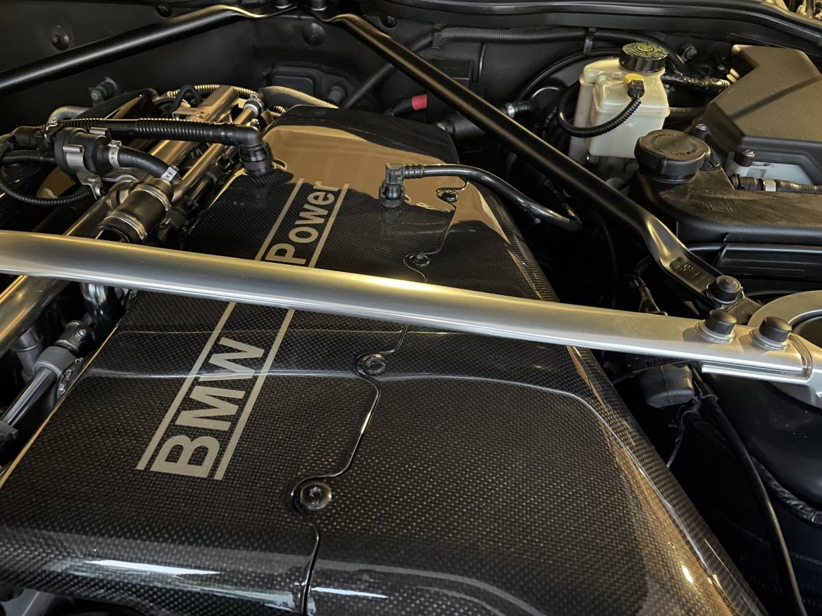

            I got new caps for my strut bar assembly and sourced BMW flat screws in black for the CSL airbox which I think looks more stealthy.

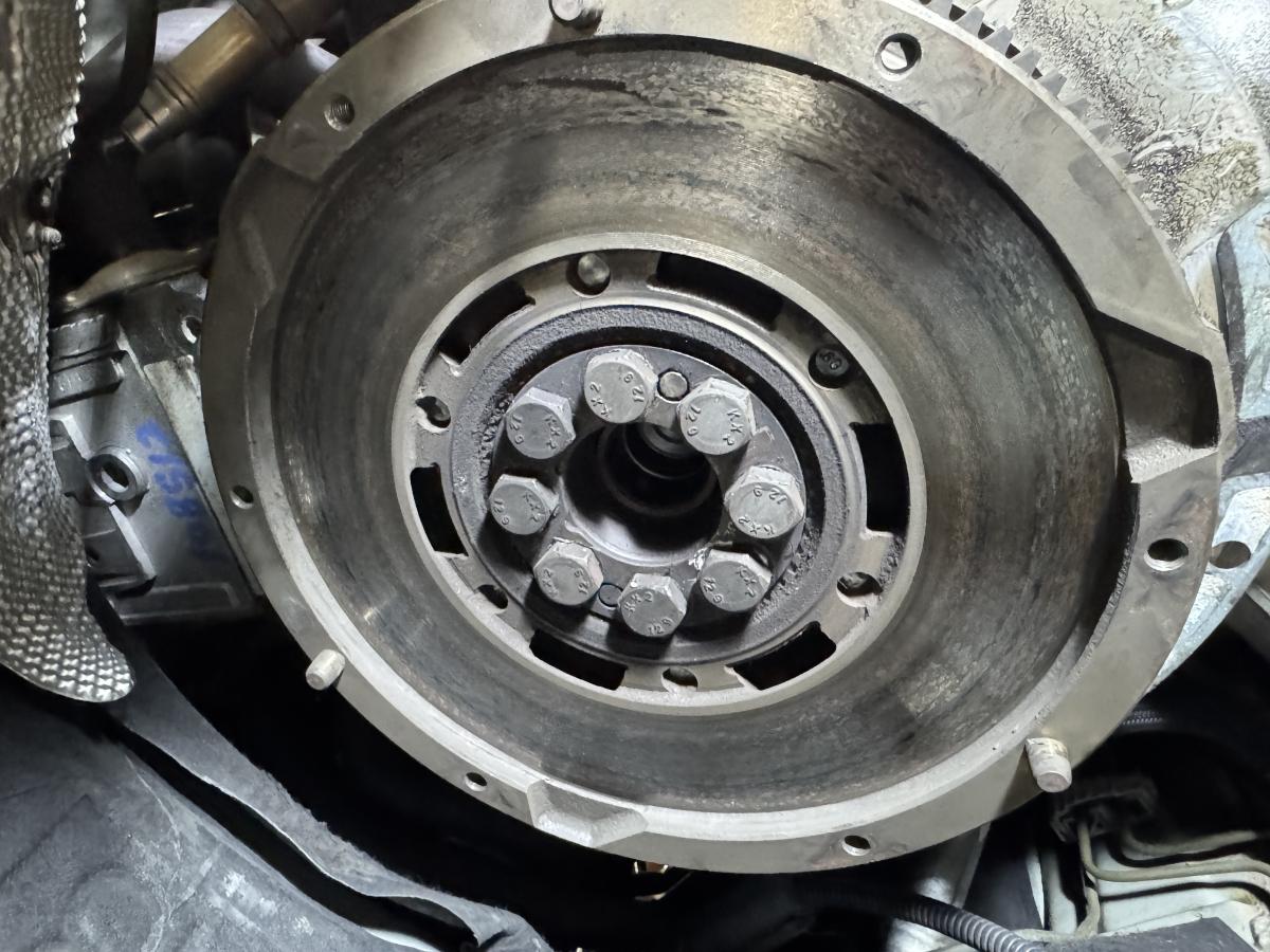

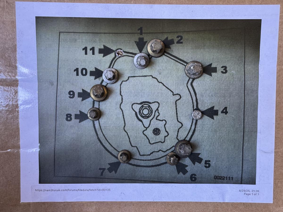

                Clutch, DMF, pivot pin, fork, throwout, pilot, shifter replaced with Autosolutions SSK 30%, stock height with broomstick This was a pain in the neck, started at 8am, finished 1am. I lifter the car roughly 19 inches. With a scissor jack, not enough space to get it out cleanly, had to drop it o the cardboard and pull it out. Pilot bearing fell out by itself, it was an after market making all sorts of noise. Shifter bushings were gone, I think it had a UUC DSSR shift kit. I'll post it if anyone wants it. Autosolutions SSK, pain in the ass to install as usual, getting it in the saddle with the hole lined up took 45 min maybe. Thanks for all the tips, doing this under that car I need some kind of a seat with a head rest.

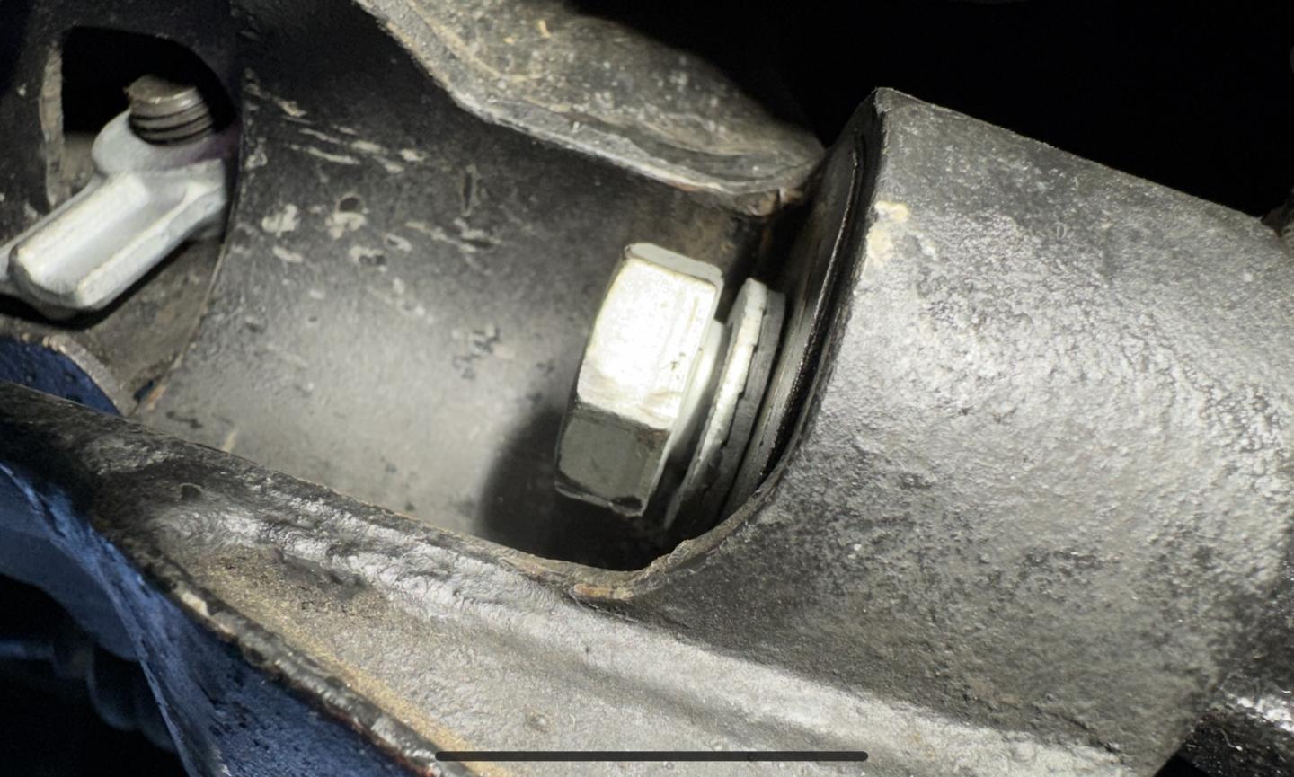

                                Got the stupidest bolt on the car (front diff mount) like 98% of the way in, how the fuck do you do this without leverage/room under the car? Sanity check: is it normal for the bolt to get tighter as it goes in? It’s for sure not cross threaded or stripped. I did put some blue loctite on it.
