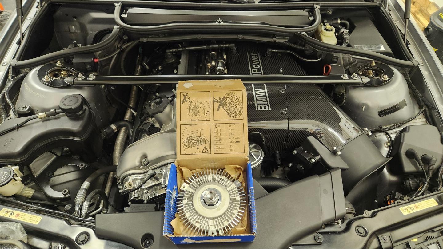

        Some boring stuff in comparison. I replaced the fan clutch to a E36 M3 for hopefully better cooling after reading through another thread.

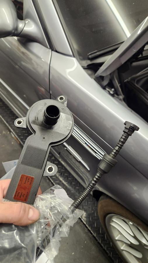

        Also replaced the OAS and the oil vent line from airbox>pan. Both were likely just fine but I guess I wanted something to do and didnt feel like installing my new yellowtag rack just yet.

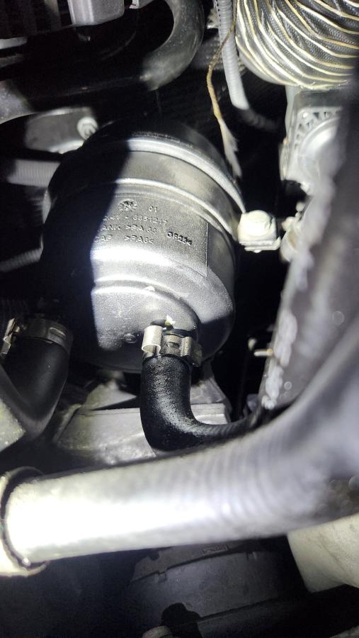

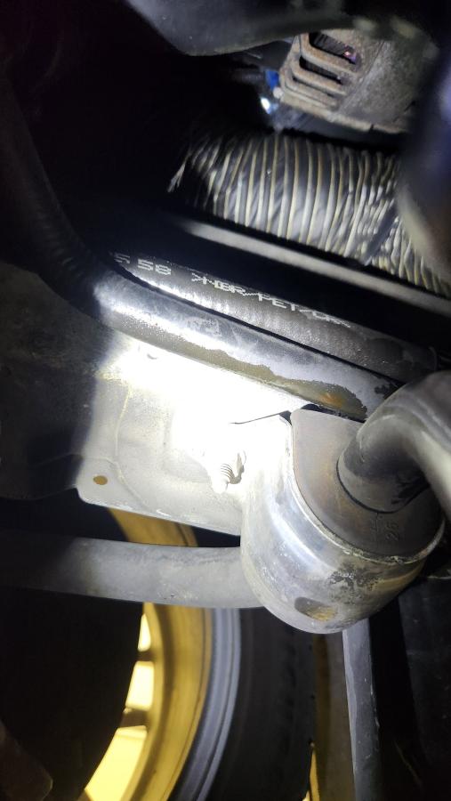

        Found a leak from the return hose>P.S reservoir, all this shit is basically brand new so that's unfortunate.
        Maybe a basic hose clamp as opposed to the stock style clamp will fix this as its not leaking out the vent hole, its definitely from the hose connection.

              Please update on how the fan clutch works out.

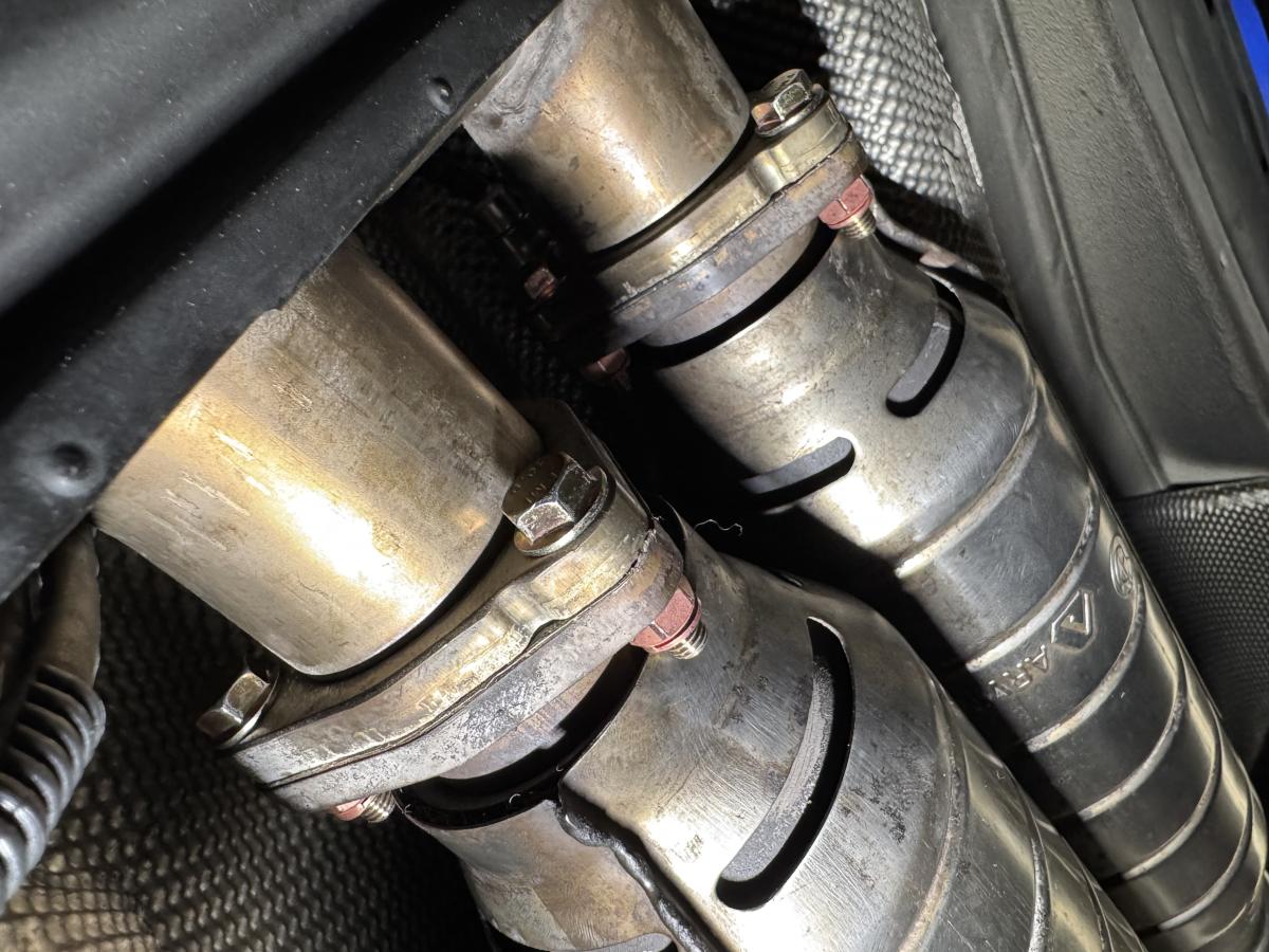

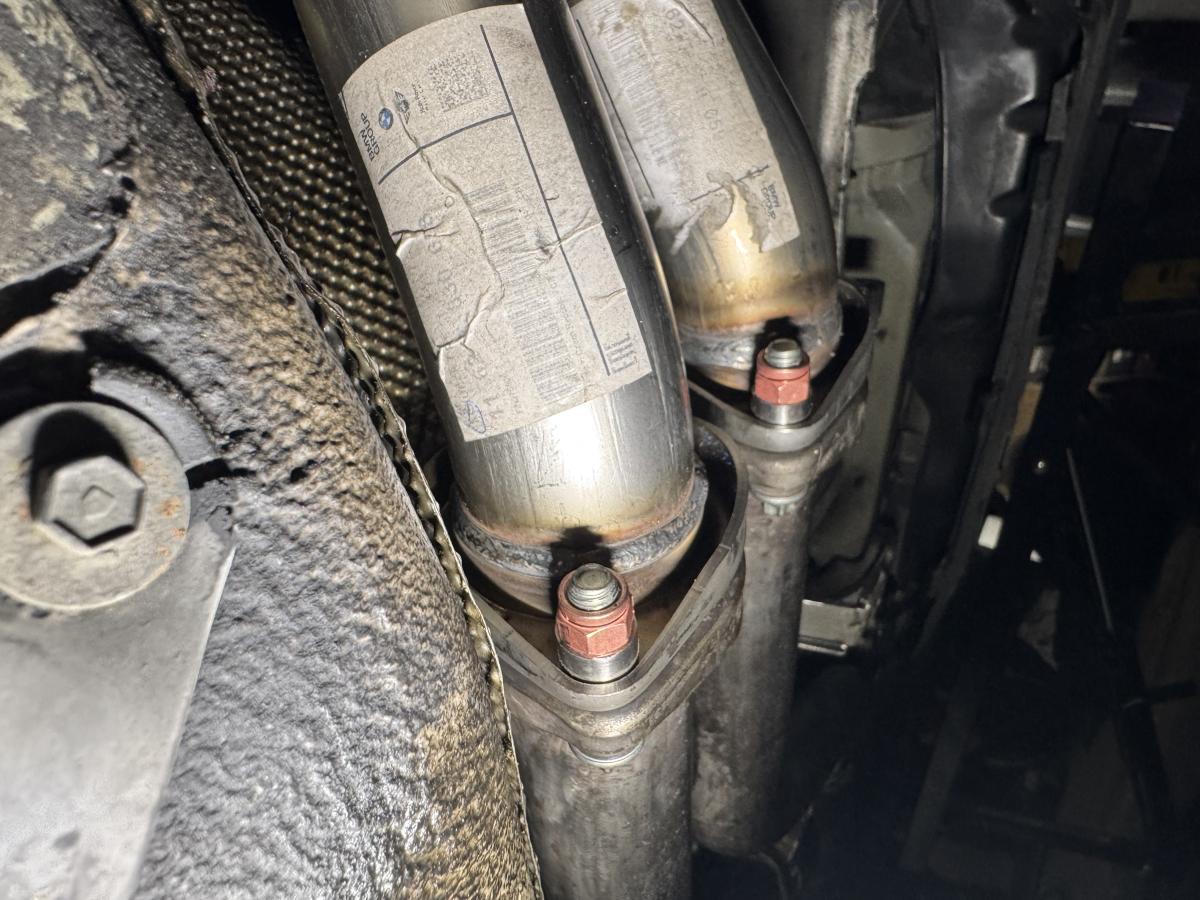

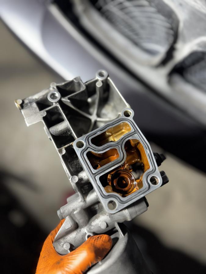

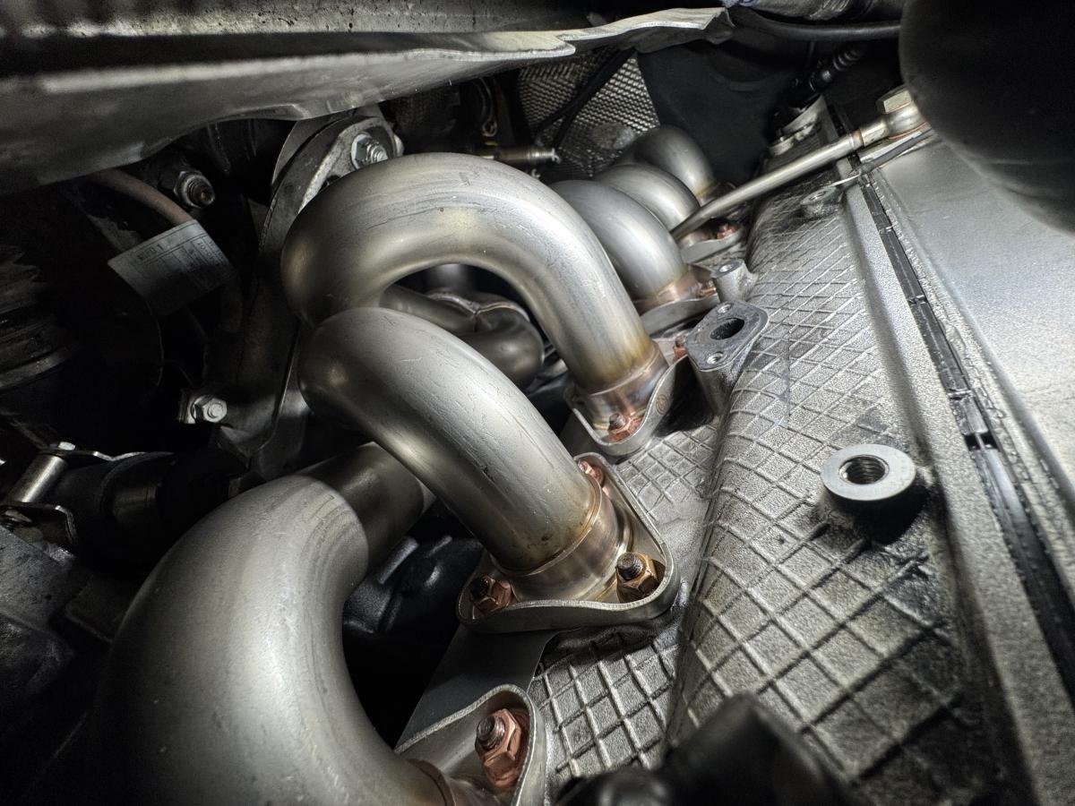

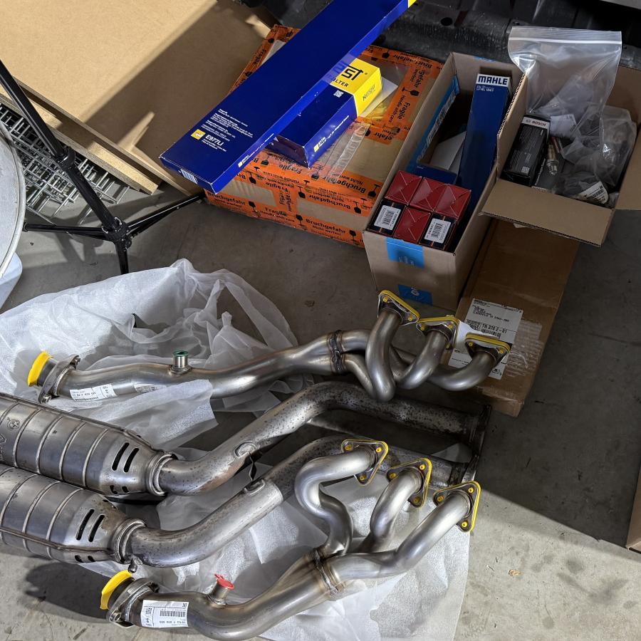

                    I did a huge overhaul:
                    -ACL Rod bearing service
                    -Oil pan gasket
                    -Motor mounts
                    -Dipstick o ring
                    -Oil level sensor gasket
                    -OEM oil screen/w gasket
                    -New OEM Euro headers/new -nuts/gaskets
                    -Euro section 1
                    -New ignition coils
                    -New o2 sensor/extended to mount like OEM euro section 1, (driving side routing)
                    -Oil filter housing gasket
                    -New steering wheel
                    -All new undercarriage hardware
                    -Extensive under carriage cleaning as well as cleaning all parts that were removed
                    Click image for larger version  Name:	IMG_1772.jpg Views:	0 Size:	135.9 KB ID:	305561 Click image for larger version  Name:	IMG_8065.jpg Views:	0 Size:	162.5 KB ID:	305560 Click image for larger version  Name:	IMG_8072.jpg Views:	0 Size:	158.1 KB ID:	305559 Click image for larger version  Name:	IMG_8074.jpg Views:	0 Size:	158.5 KB ID:	305558 Click image for larger version  Name:	IMG_8052.jpg Views:	0 Size:	60.4 KB ID:	305557
                      Keep that euro exhaust and never change it, that shit sounds so good.
                        As annoying as it is, you'll want to completely remove those labels off the headers before starting the engine; otherwise, the burning smell might take a while to go away.
