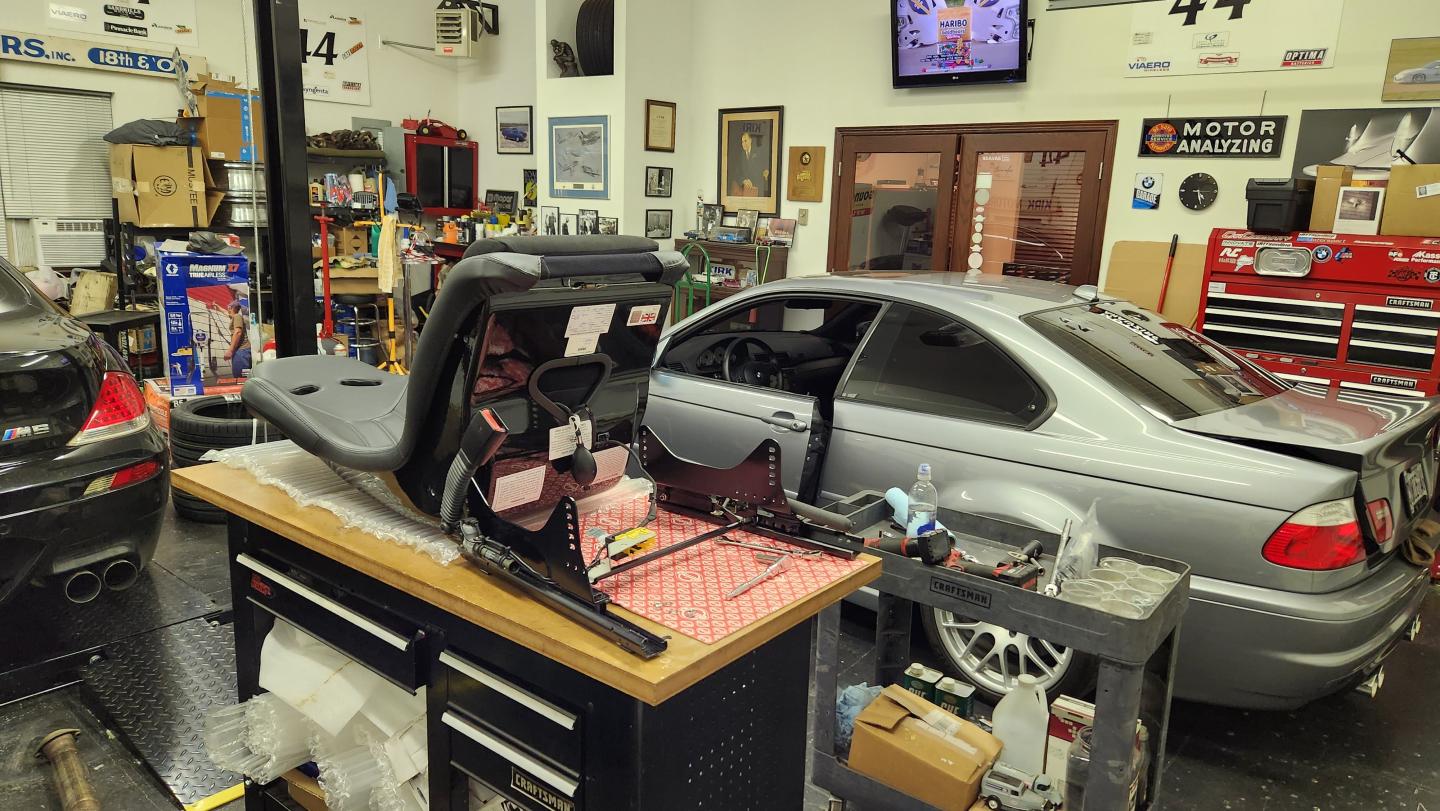

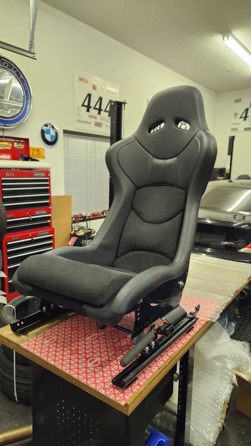

    Installed BK 9222 brackets on the driver's side replacing the Norgaro specific brackets.
    Now I can see quite a bit better and it feels more comfortable in general. I can even use the armrest again, I would highly recommend these to anyone of average height.

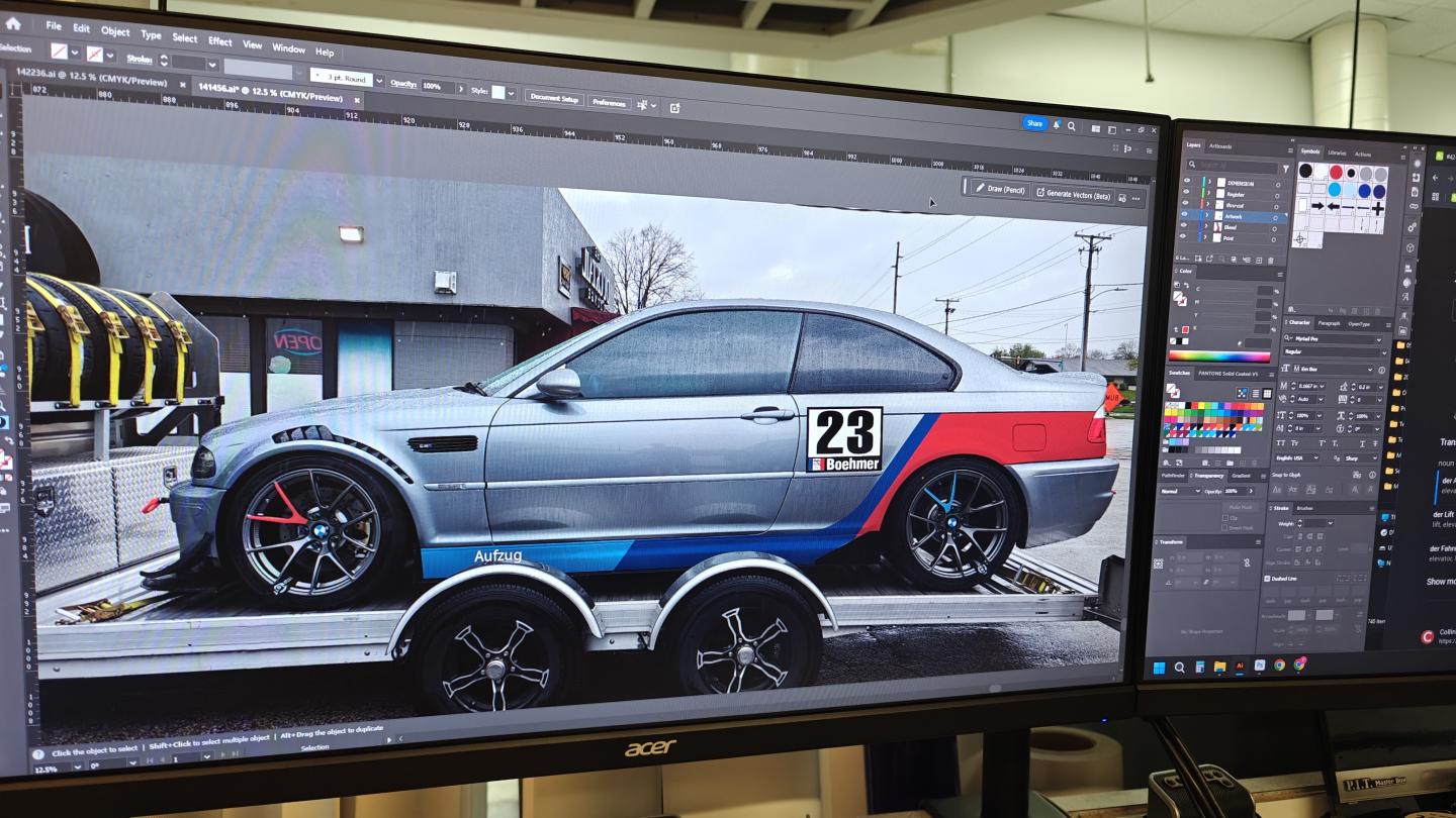

        Visual:
        Started working with my vinyl guy on a graphic set for the car. This is NOT the final design as we were just playing with things. I can't wait to see where it goes next week

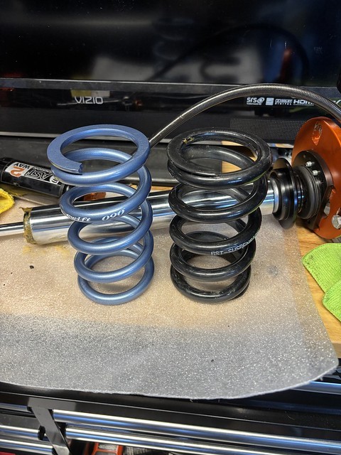

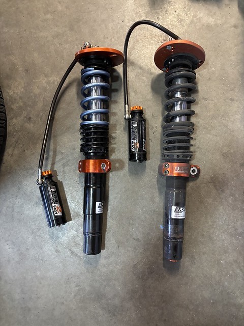

          Swapped out the120 N/mm (685 lb/in) front springs. Felt great on track but were a bit harsh for a daily driver. Wasn't unbearable but I wanted to soften it up and get closer to flat ride. Went with 9k (503 lb/in) Swift springs which is at the limit for these dampers. Any softer and I'd have to get them re-valved. I'm happy with the results. More compliant but still planted. Only bummer is one of the lock screws on spring perch is stripped 🙁

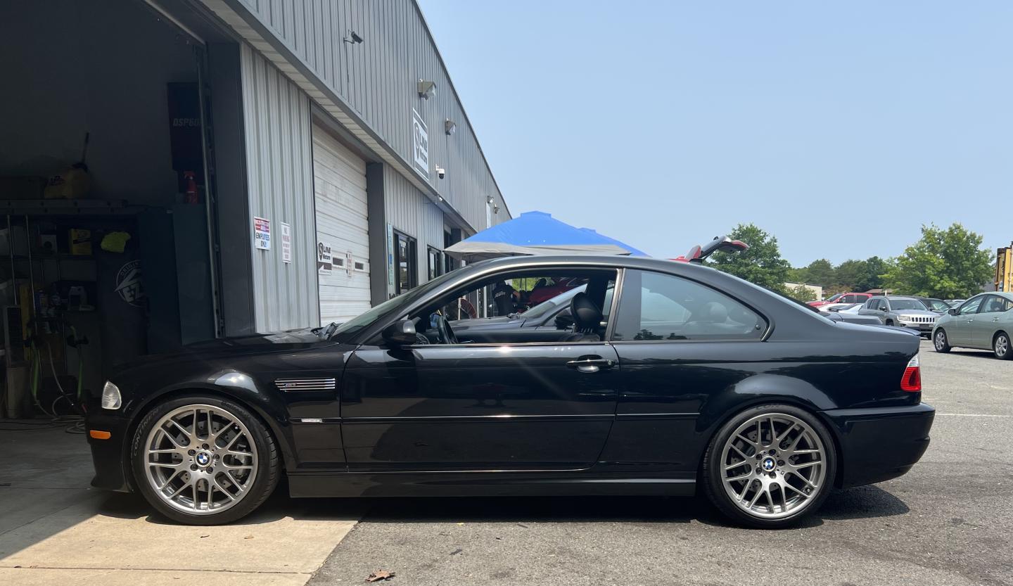

                        when I tell you I’ve read every suspension thread 50x, believe me - I have - shoutout to everyone here and abroad for the guidance. I gave this a lot of thought and waffled from OE-only to Koni/Dinan, to PSS10, and finally settled on TCK after months of deliberation.
                        Many thanks to Matt at Eurompire for his efforts and collaboration the last few months. Picked up the car yesterday, here’s what we did:
                        - CMP RACP reinforcement - bottom and top
                        - SPL adjustable rear control arms
                        - SPL Monoball RTABs
                        - BW solid subframe bushings
                        - Genuine/OE bushings everywhere else - diff, rear-upper/outer, etc.
                        - new diff cover/diff service
                        - front/rear hubs/wheel bearing
                        - rebuilt half shafts
                        - CSB/Guibo/all driveshaft bits - cv joint, gasket
                        - engine and trans mounts
                        - TCK SA 300F/600R
                        - bimmerworld adjustable front sway bar
                        - wheels refurb’d by Prince Wheel
                        - trailing arms and subframe powder coated
                        - found and replaced some misty PS lines
                        - genuine fan clutch/fan
                        My quest to restore this machine to a condition befitting of the marque continues - might just need to fire up a build journal at this point, Avedis recalling an early chat with you when I first got the car haha.
                        plan is to get 300-500 miles in and get a corner balance and finish dialing it all in.
                        It’s hard to comprehend all these changes coming from the tired stock suspension it had, but 200 miles in the car feels just incredible. Thank you Matt Eurompire !

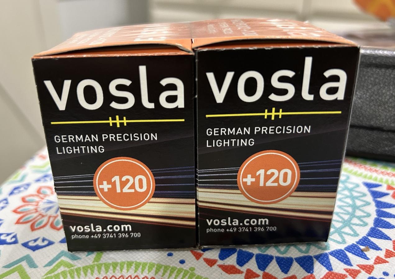

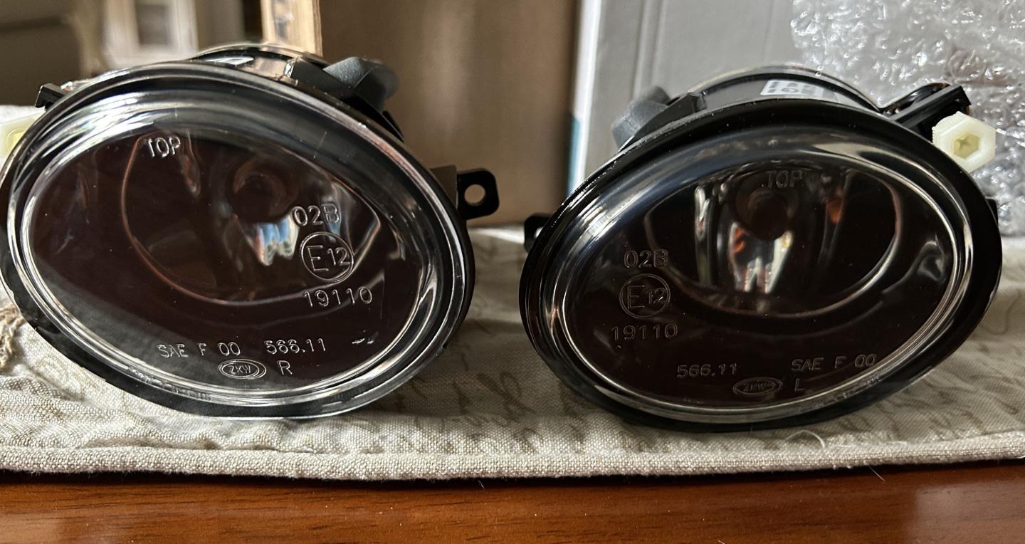

ID:	307254 New clear ZKW fogs lights and 9012 bulbs for some more light.
