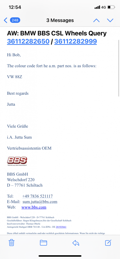

        88Z

          Awesome

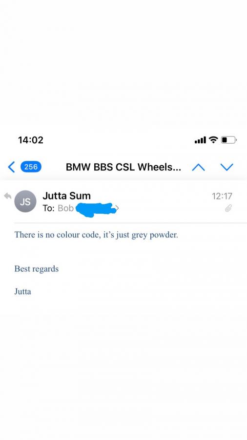

            The barrels are ‘grey powder’, which I presume is just a grey primer.
            Looks like the big mystery of ~20 years has finally been resolved…

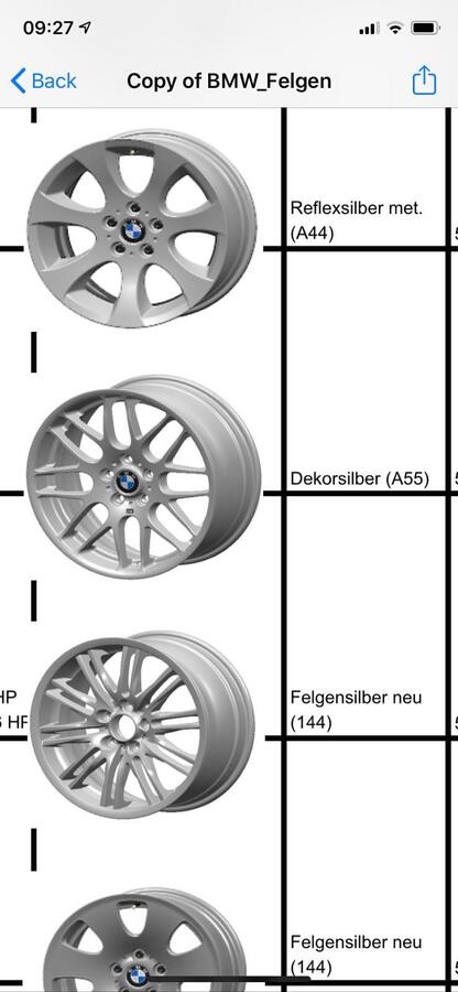

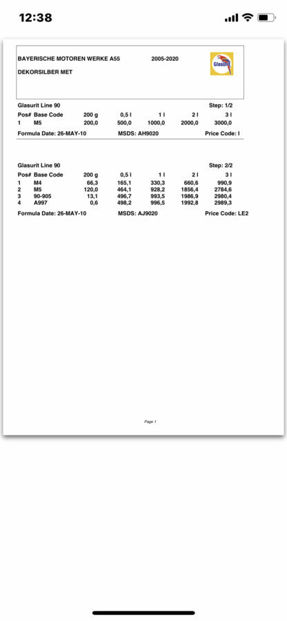

              it is a Glasurit Special paint code A55 Dekra Silver from Line 90

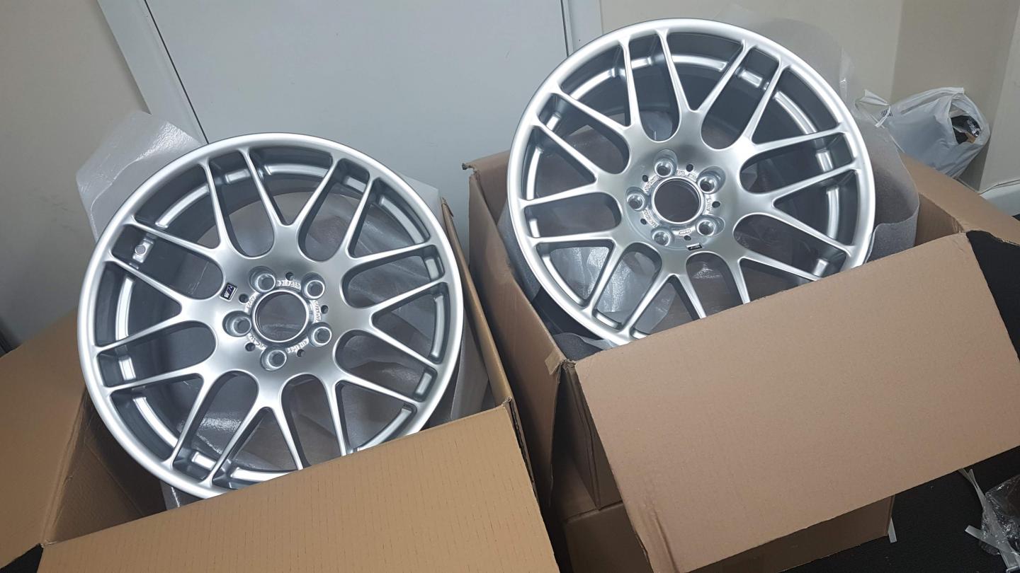

              I believe A55 is used on the 359 M wheels (hence the dates of 2005 - ). The CSL wheel was made in 2003 and is finished in 88Z.

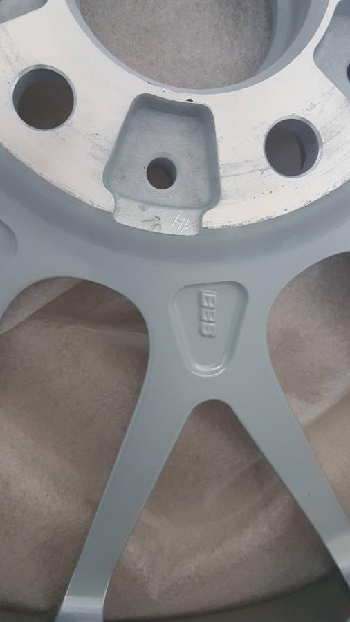

              Original BBS finish attached for reference:

                  The 359M wheel finish doesn't hold a candle to the bbs 163m csl wheel, in case anyone is wondering.

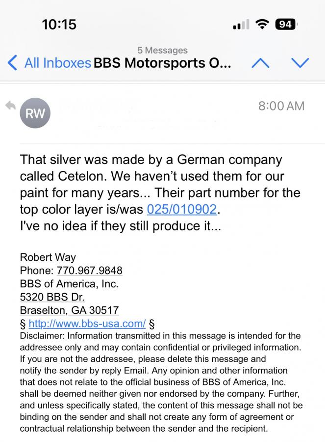

                    Reached out to BBS and got a completely different paint code from y’all. Hmmm. I sent them A55 and they said that was BMW’s alias for DS-AP which is BBS’s internal code for paint 025/010902. This appears to be the same code the BBS CH has (Brilliant Silver). Idk - this doesn’t seem like accurate information.

                      Most likely because you emailed BBS USA as opposed to BBS Germany.
                      As per post 18 of this thread, the colour code is 88Z.

                        What is the best way to refinish CSL wheels? I’ve seen some with blurry part numbers around the BMW rounded. Assuming this is because they had new powder coat applied but the person didn’t sandblast them down to bare metal?

                                What does 88Z mean? Are you saying that we should be able to go to a paint supplier and just tell them 88Z with no other context of codes and they will be able to pull it up?
                                88Z seems like such a short small number like its missing something
