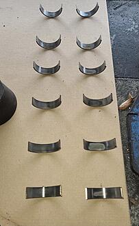

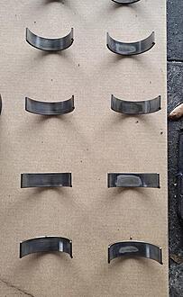

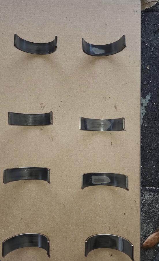

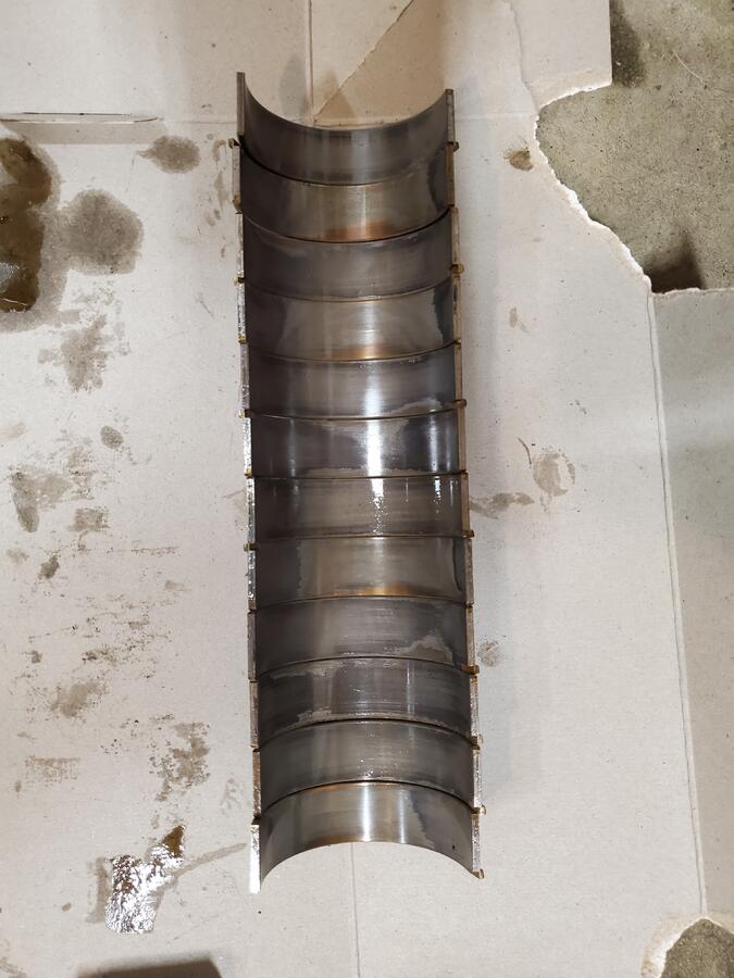

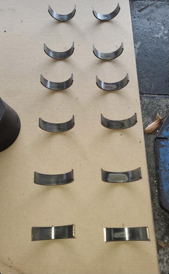

    Done at 121k miles, no record of them being done before.
    Pics are in order from bank 1 to 6.
      I need to replace rod bearings..

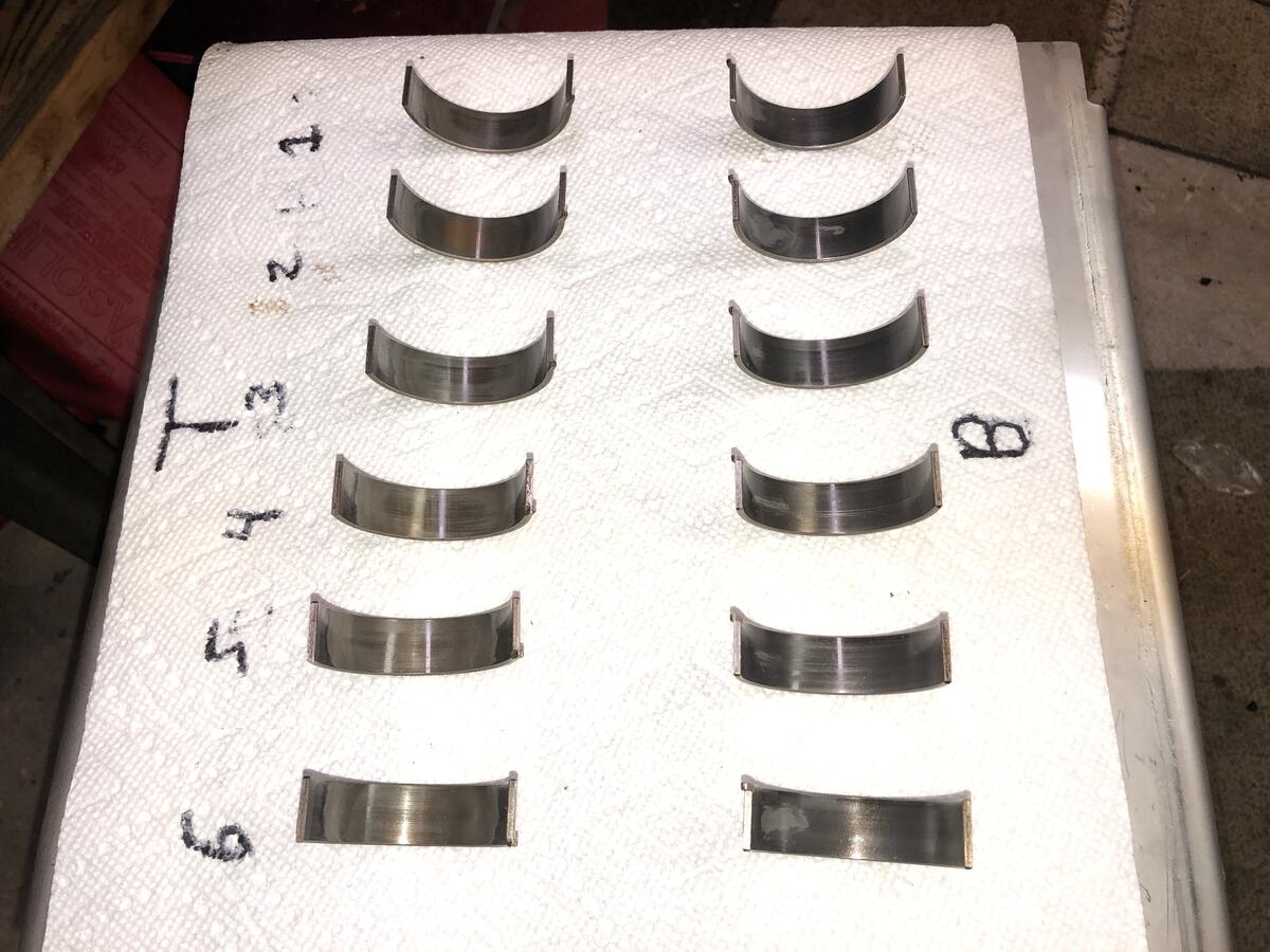

        2006, first time replacement at 91k miles. Blackstone was showing relatively high levels of copper all the time, but I didn't like the increase of all three lead, copper and iron in the last report. OCI ~7500 miles, didn't do Blackstone every time. Planned to do it around 100k miles, but used the downtime working from home and not needing to drive to get it done.

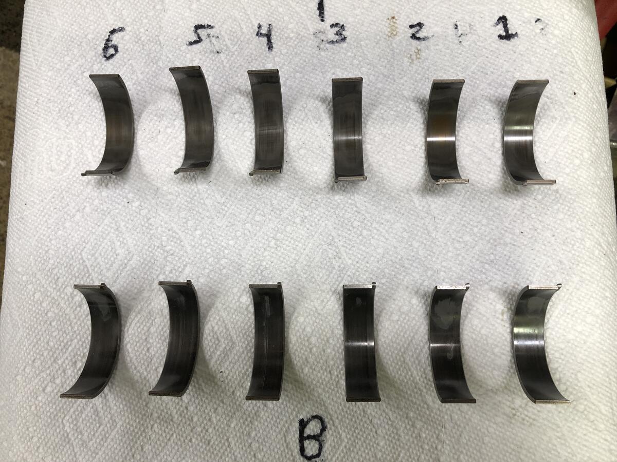

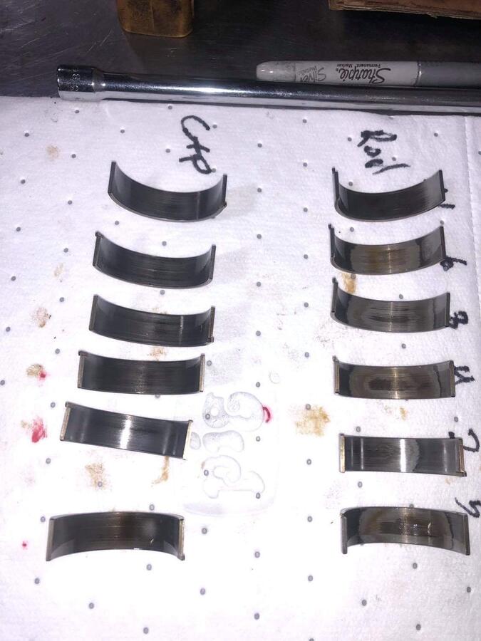

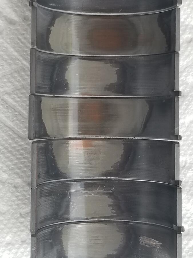

              198K, 2004, no copper showing but the "spring" was gone in several suggesting detonation pounded them at some point. Not bad at all and probably could have gone another 60k.

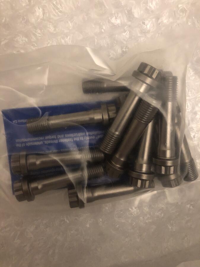

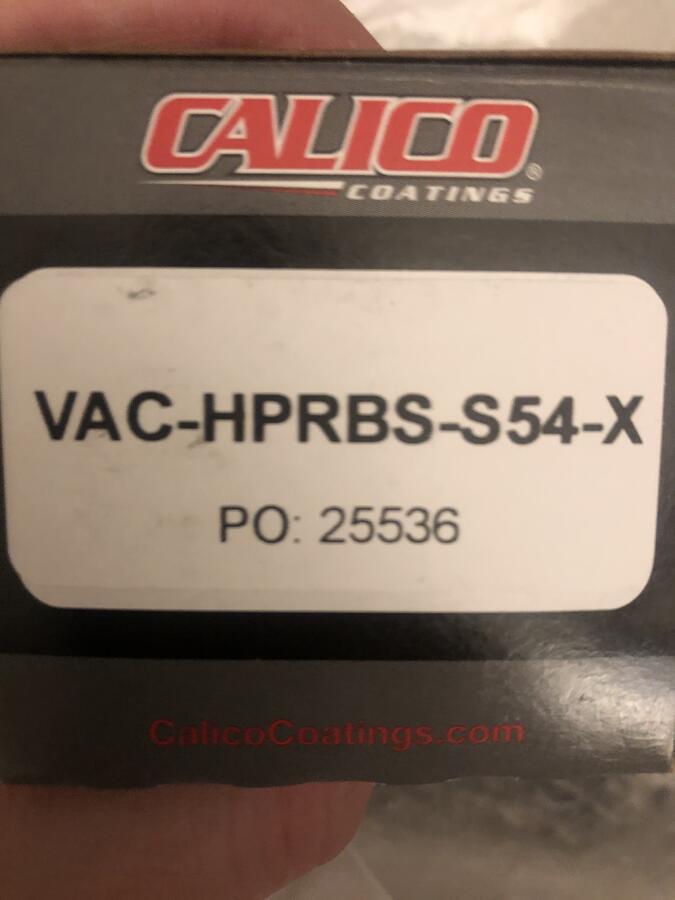

                About to have mine done. VAC coated rod bearings with extra clearance and ARP bolts. I also got the oil pump upgrade kit.
                Will post pics of the old bearings.

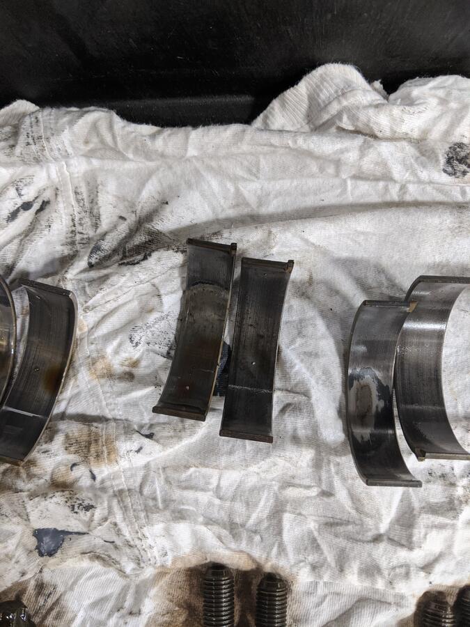

                  My rod bearings at 80K . . .
                  Replaced with OE, WPC & OEM bolts

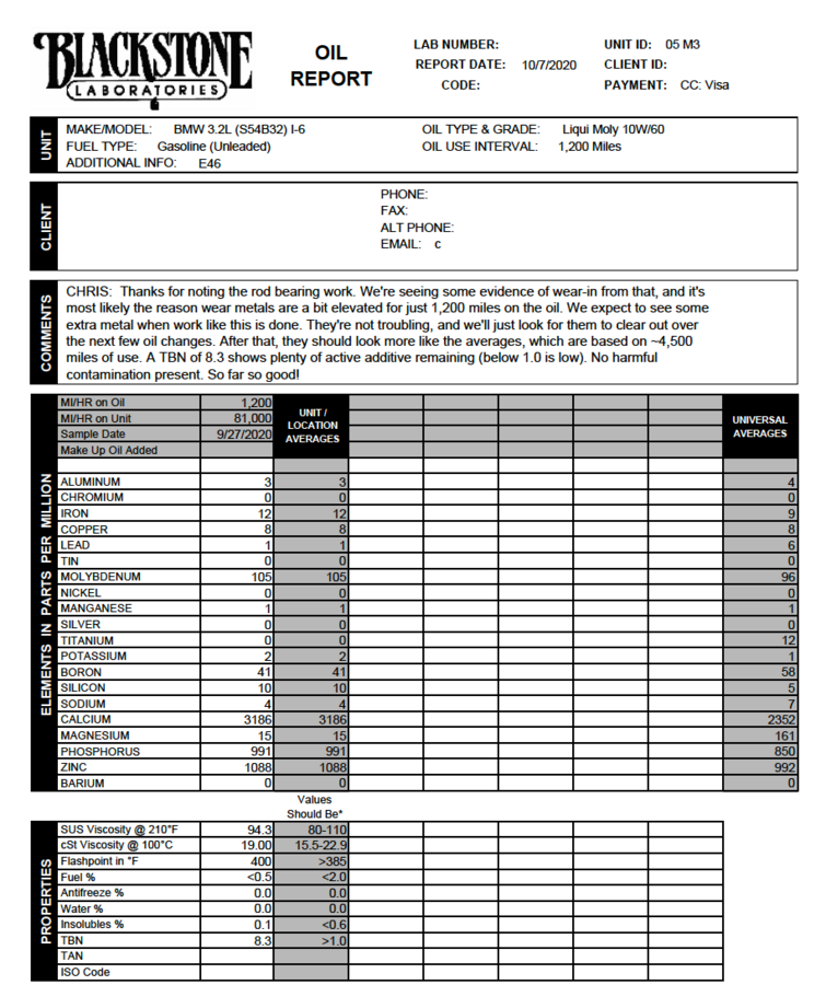

                  Oil Change 1200 miles after rod bearing job . . . Blackstone analysis

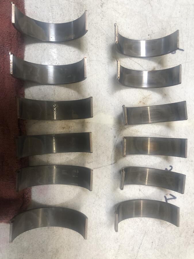

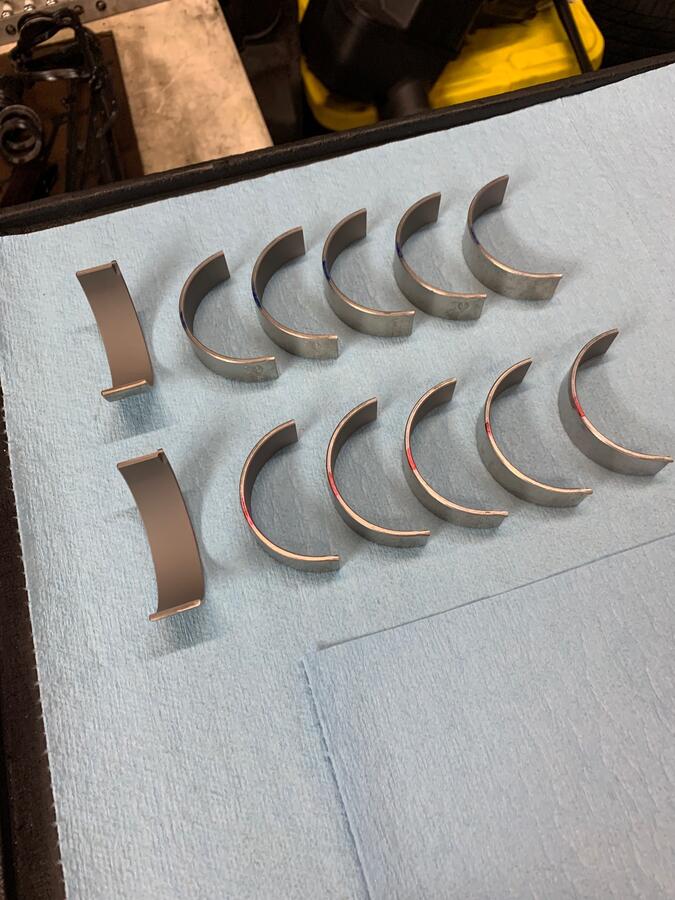

                    Records show the recall was done at around 11k, these were replaced at 164k. Replaced with ACL bearings.

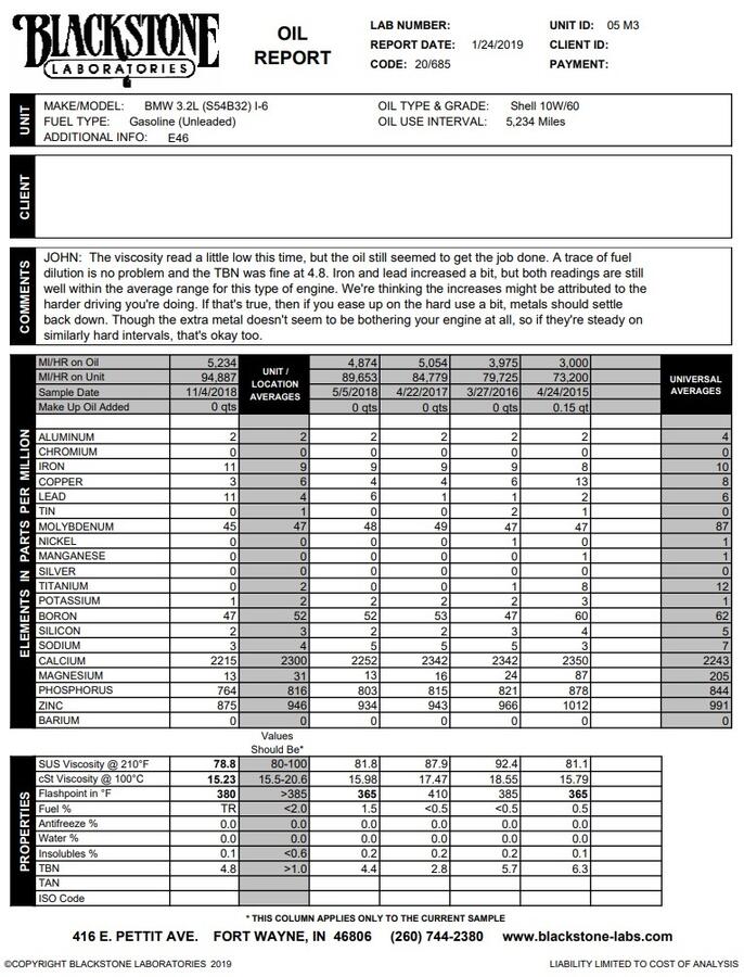

                        Bearings changed at 97,658 based on the trend in lead in multiple reports.

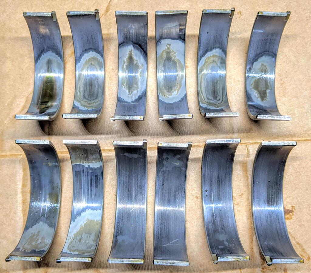

                            Had the rod bearing recall done around 25k and then these done at 145k. Mostly highway miles, but still, they were ready to change out. Glad i did it now and didnt wait any longer. Blackstone wasnt showing much copper

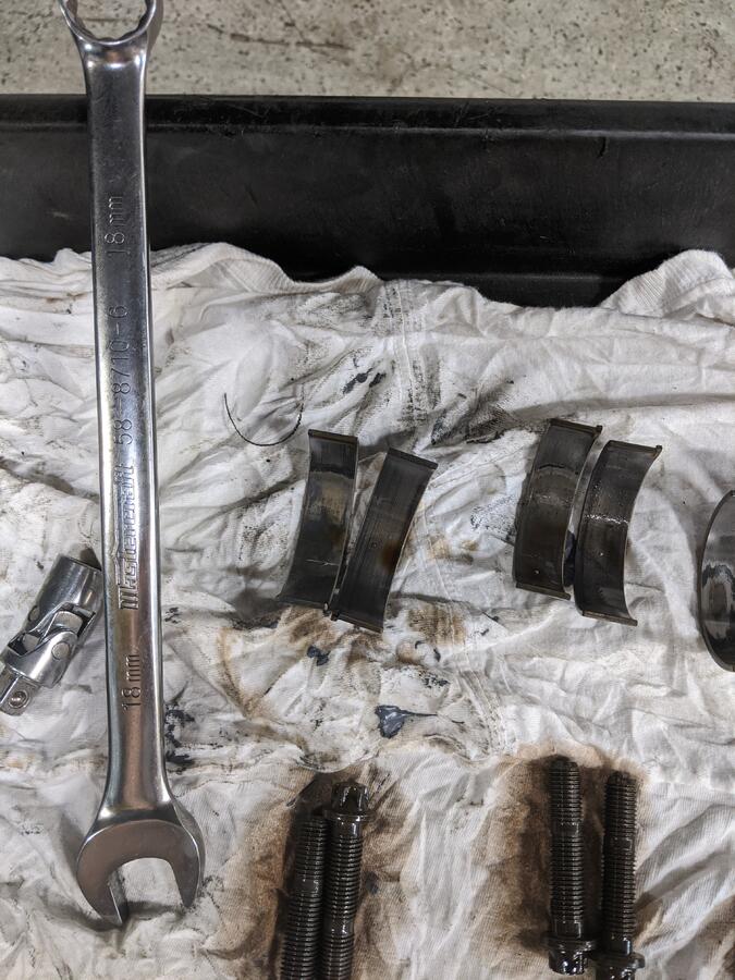

ID:	95983 160k miles. Don’t know when the previous owner changed them. But glad I got it done.

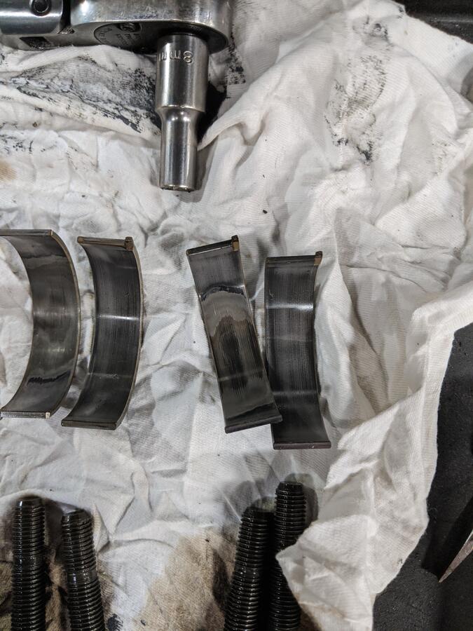

                                216,500 km (133,000 miles). Top of number #3 was worst - copper just starting to show through. Funny, my oil analysis consistently looked fine. Blackstone's report stated "Your original rod bearings still look good with lead (the primary bearing element) at a perfectly average 6 ppm". I'm glad I replaced them anyway.
