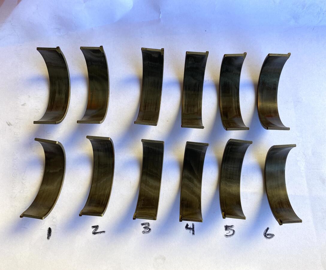

        #33
        Originally posted by Mattn1192 View Post
        Don’t know when the previous owner changed them. But glad I got it done.
        Not too bad at all.

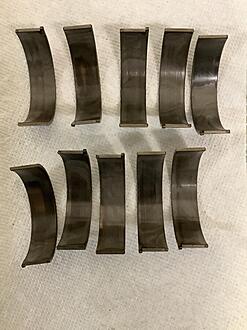

            Had Rod Bearing Recall done at 15,509 and these done at 208,426. So 193,000 on these…

              #36
              Too dark to tell if copper shown or not, but they seem to be in good shape for 193K miles.
              Why changed now and not when it's around 100K?

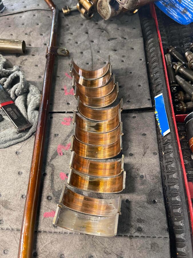

                Saw these posted on Reddit. 170k mile rod bearings.
                  #38
                  Wow, hard to believe one didn't let go. Owner is very lucky.
                    #39
                    He squeezed out every mile of the bearings -- what's a timing. Once the copper layer is worn through then the crank will hit the steel layer and be damged.
                    The bearings/crank journals matched perfectly for this engine: look at how the red copper worn down uniformly around 360* instead of just a short arc at the middle of the bearing shell curve. This means the bearings have a very small clearance -- minimum side on the spec.
                      Although it is lucky one didn't spin, I would still be seriously concerned about the condition of the crank with the shells looking like that. Not necessarily away laughing.

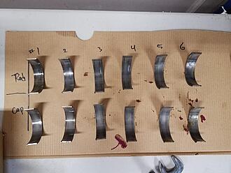

                            2003 M3 production date 10/02' w/ 110k (had the bearing recall done prior by previous owner at some point mileage unknown best guess was about 50-60k). I've been doing only track only miles, only a track queen.
                            Click image for larger version  Name:	20161226_114056.jpg Views:	0 Size:	104.0 KB ID:	119562
