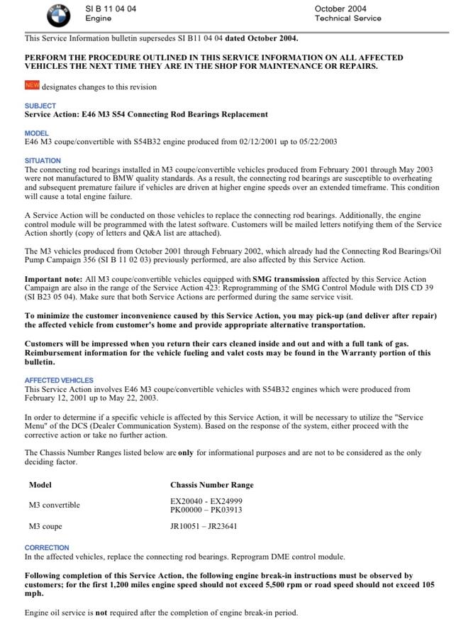

          5/22/2003 was the cutoff date from the SIB I have.

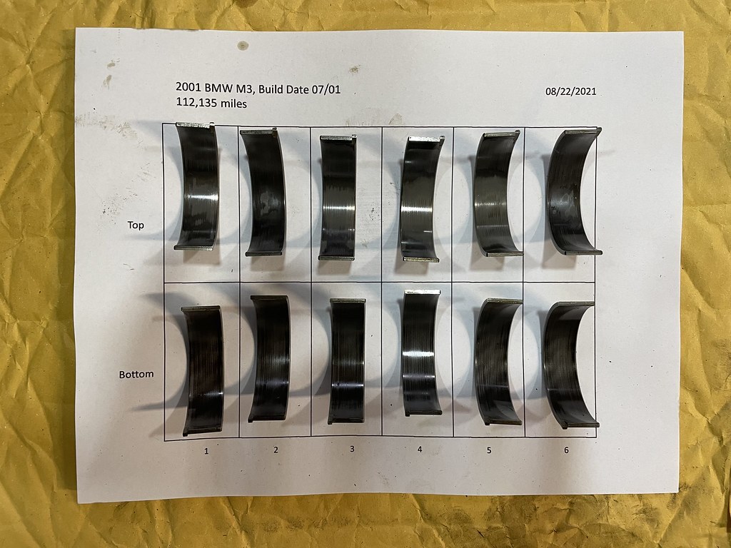

                  07/2001 production with 112k miles. Bought the car with 48k miles. No record of previous rod bearing service.
                  Click image for larger version  Name:	51397255714_ae6cdac6f9_b.jpg Views:	77 Size:	160.3 KB ID:	122521
                  Last edited by DJAM3; 08-26-2021, 10:28 AM. Reason: Edit: Forgot to add that I've been running Motul 5W-40 in the winter, 10W-60 in the summer.
                    #54
                    These bearings look in great shape.
                      #55
                      Those look great. You’ve got piece of mind for many more years and miles.

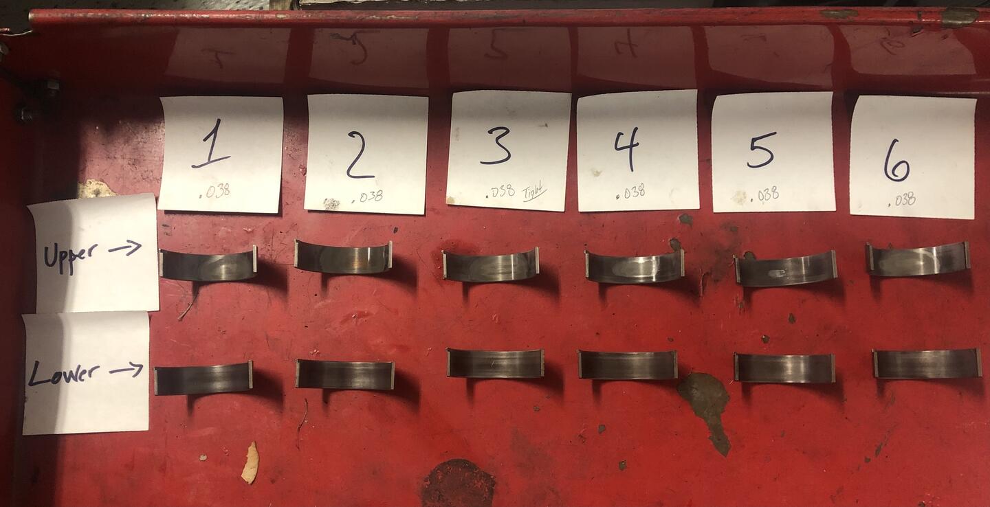

                        Here are my rod bearings from my recent service. I’m the second owner (since 1200 miles) and car is 03/04 build with 76k miles, car has been supercharged for the past 30k ish miles. I opted for WPC treated OEM bearings and OEM hardware. Nice to hopefully not worry about this for another 75k-100k miles!
                          I have a 2002 car with an unknown SIB history on the rod bearings. I believe the SIB wasn't a full recall, is there anyway to find out if my car had the SIB applied to its rod bearings (date & mileage) or can I see the details of the SIB? Thanks in advance.
                            #58
                            BMW should have the info in their system. Give them your VIN.
                            Here is the SIB I have.
