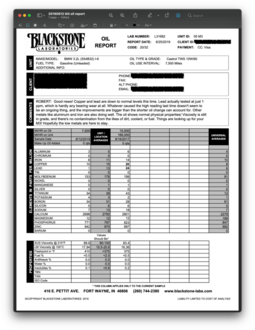

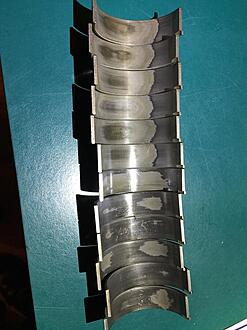

                  2005 with 100k miles. First 50k miles were original owner who did 15k oil changes @ the dealer. Second 50k were me and I did 7500mi oil changes with TWS 10w60.
                  The copper in the report worried me so I did the bearings. I would say they are definitely wearing out but don't look quite as bad as others I have seen. They probably could have gone a little longer with no ill effects.
                  1, 2, 3 tops
                  4, 5, 6 tops
                  All the bottoms looked new
                    #69
                    Good call on replacing them 👍

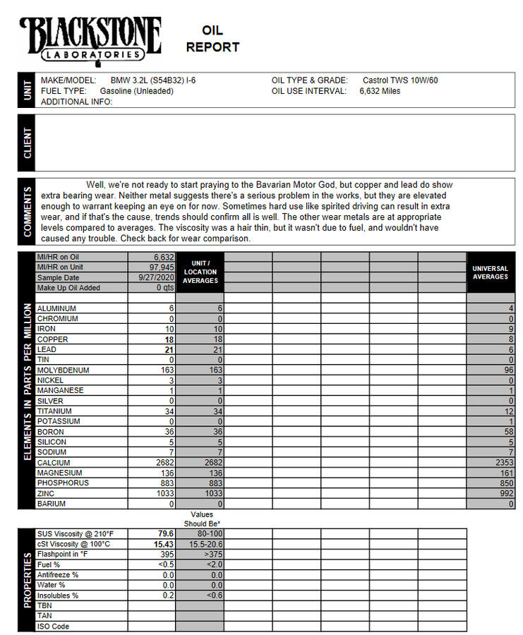

                      2004 M3 with 141k miles. As far as I know the rod bearings have never been replaced and I was really worried. First report came back with really good news. I have sent out another sample and waiting for results.
                      I do oil changes myself with Liqui Moly 10w-60.
                      It has been daylied in Illinois for 10 years now so it has seen all kinds of weather. Warmed up 30 seconds before driving, oil changed every 5k and has seen redline every day.

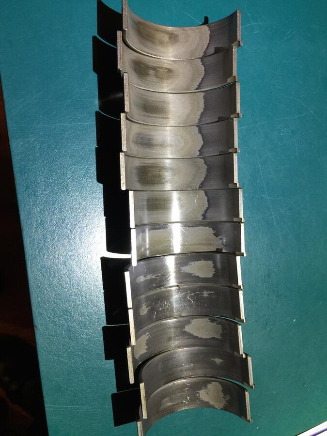

                        Blast from the past...had these done Dec 2017 at ~170K miles.

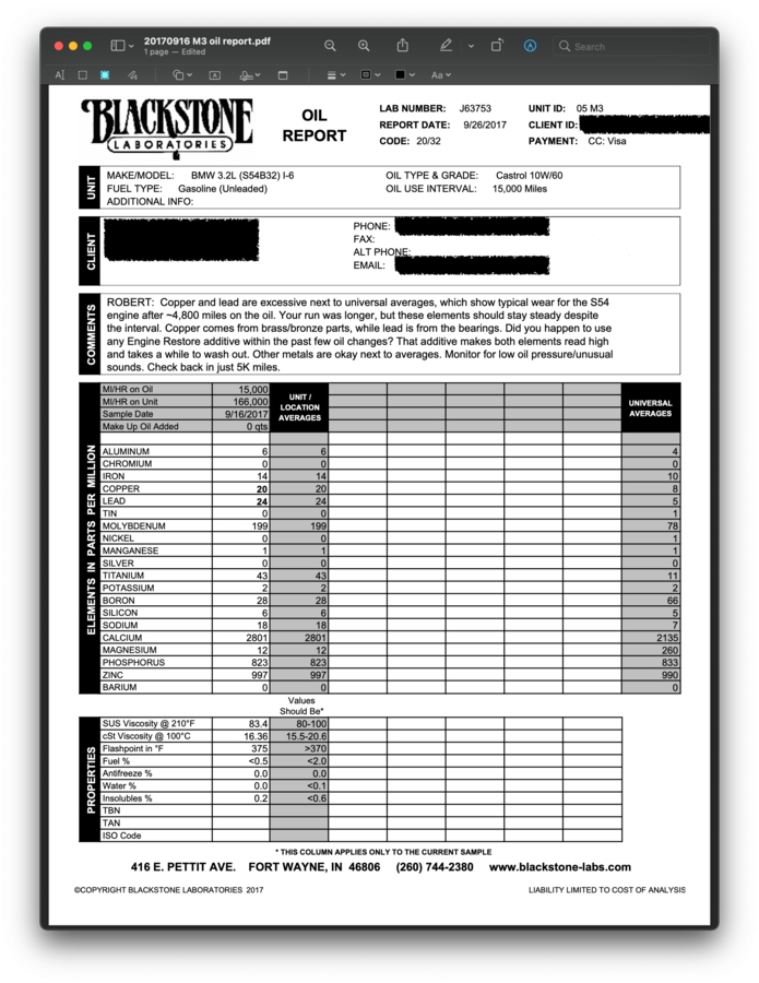

                        Applicable Blackstone report (pre bearing replacement) :

                        and post bearing replacement. The high copper has been a constant...i wonder if the sample gets contaminated from the copper washer on the oil drain plug.
