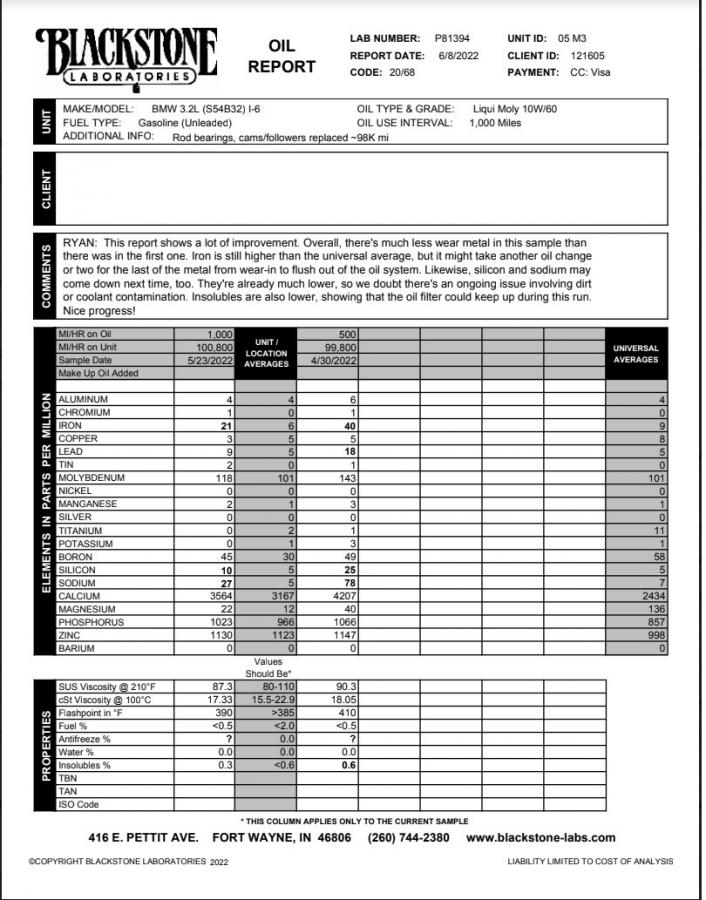

Nope, I bought the car last fall and drove it home from California, and took it apart over the winter to overhaul everything. Here are the two reports from right after the bearing change (I also ended up replacing the cams and followers because one of the followers had been worn flat). I have driven about 1500 miles since the last oil change and it seems to drive really well, I'm waiting for about 2000 miles on this oil before I change it again and do another report.Originally posted by mtpktz View Post

So basically the oil report didn’t tell you anything. Guess it’s worth just calling it an 80k-100k maintenance item like the old internet group think always said.Originally posted by DoubleSidedTape View Post

My post on the first page of this thread includes 6 reports over 30k miles on my previous m3 before I changed the bearings. I bought it at 150k, but the engine was not original to the car, so even though I had a fairly comprehensive service history for that car, I knew nothing about the status of the bearings.Originally posted by repoman89 View Post
For my current m3, like I said earlier, I bought the car, drove it home, and pretty much immediately took it apart to do all of the big 3 as well as some other work. I took a sample of oil from before the change but I don’t know if I still have it. In any case, I didn’t send it in for analysis.
