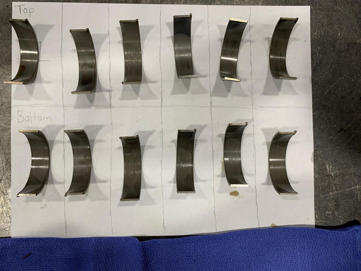

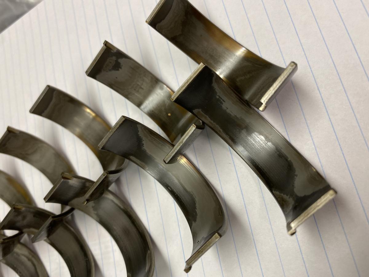

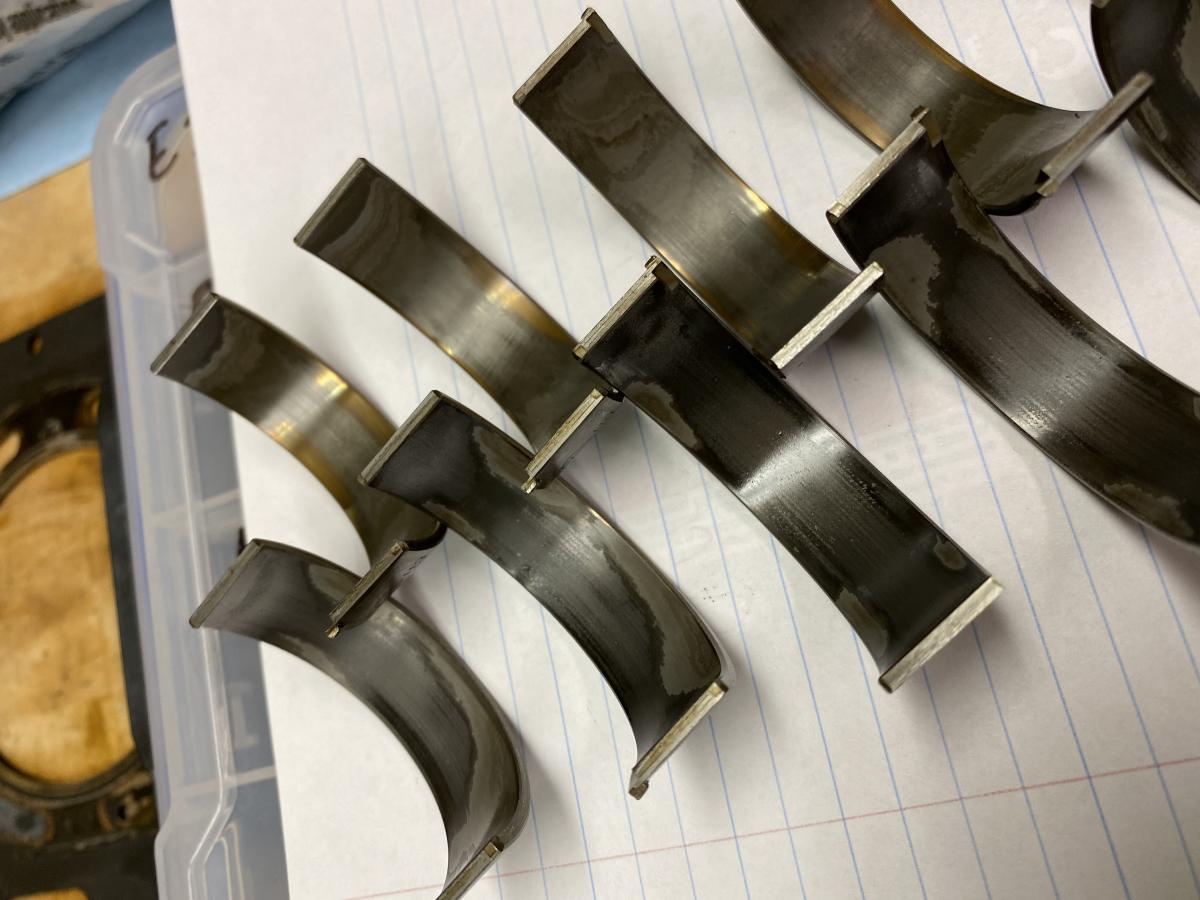

    Ok, here we go.
    211k miles. 2002 SMG convertible. I’m doing a full engine rebuild and just dropped the block, heads, pistons, and crank off at the machine shop. The piston and cylinder wear are well within spec so intend to re-ring, hone and go. The main bearings looked nearly new save for #7 that has slight wear.
    I have decent maintenance history and all
    major jobs were done at the dealer and show on the carfax. For non major jobs I also have Midas receipts for oil changes and a drain plug that was stripped and replaced at some point. So, yeah it was treated ok, but never looked after with an open checkbook.
    I believe these to be original. Not bad I thought?
    Every rod bearing, save for two, does show some sort of copper, however.

      I'm assuming those were replaced at the dealer at some point because of the 02 model year. Any idea when that was done? They look pretty good regardless.
        #93
        Well, I have no proof they were replaced, if they were. Several other major services (SMG, clutch, etc.) do show up on the carfax.
        The first few years of the car’s life only saw 15k miles total, so I would assume if they were replaced that they were replaced in that timeframe.
        so 195k-ish miles. Does anyone know for how long the rod bearing service was offered?
          #94
          Since this was a no cost SA, the dealer would have the record, or the PO had the work done elsewhere. Who would do that? So, I think it's safe to say the dealer did it, or they weren't done.

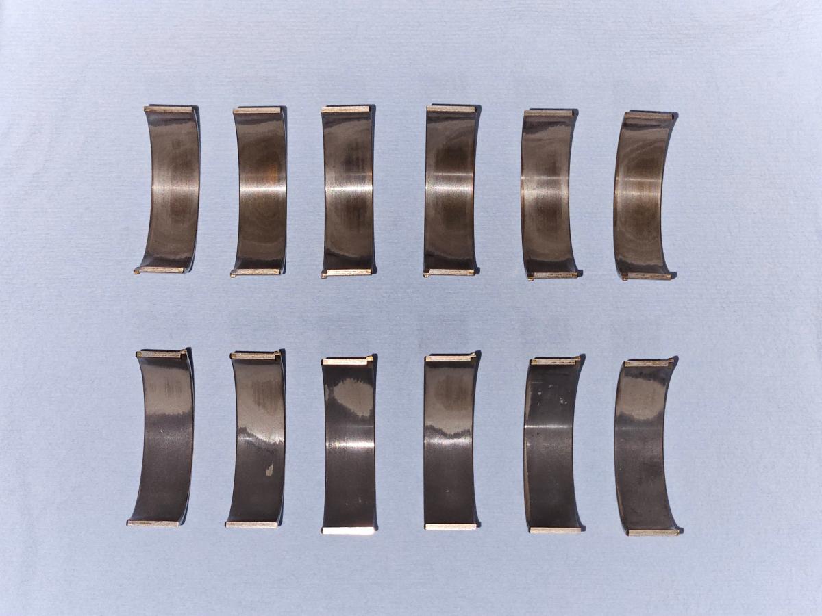

                    2006 M3, 100.7 k Miles.
                    Blackstone reports showed clean health (3 consecutive submissions, last one being about 2,000 miles ago)
                    Overall looked pretty good except for cylinder 4 and 5?

                        just to follow up here. The dealer network was searched. There is no evidence that these rod bearings were ever done by the dealer. And fwiw, the pics don’t really show how worn they were. There was copper of some sort on every top and bottom. The tops showed guide a bit, but never did the copper cross all the way across the bearing like you see in spun bearings or bearings that are about to spin.

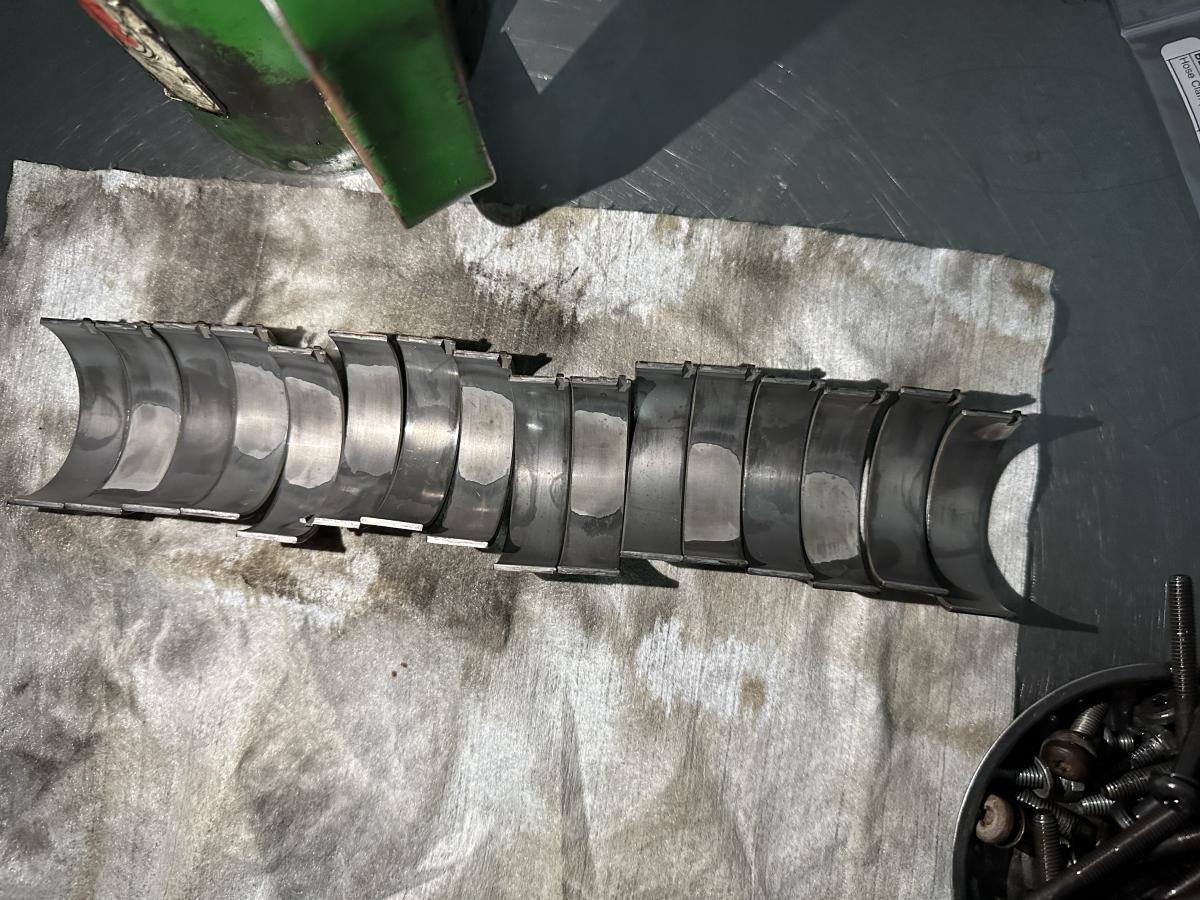

                            Car runs fine, no noises or anything weird ... just did an oil change and found this:

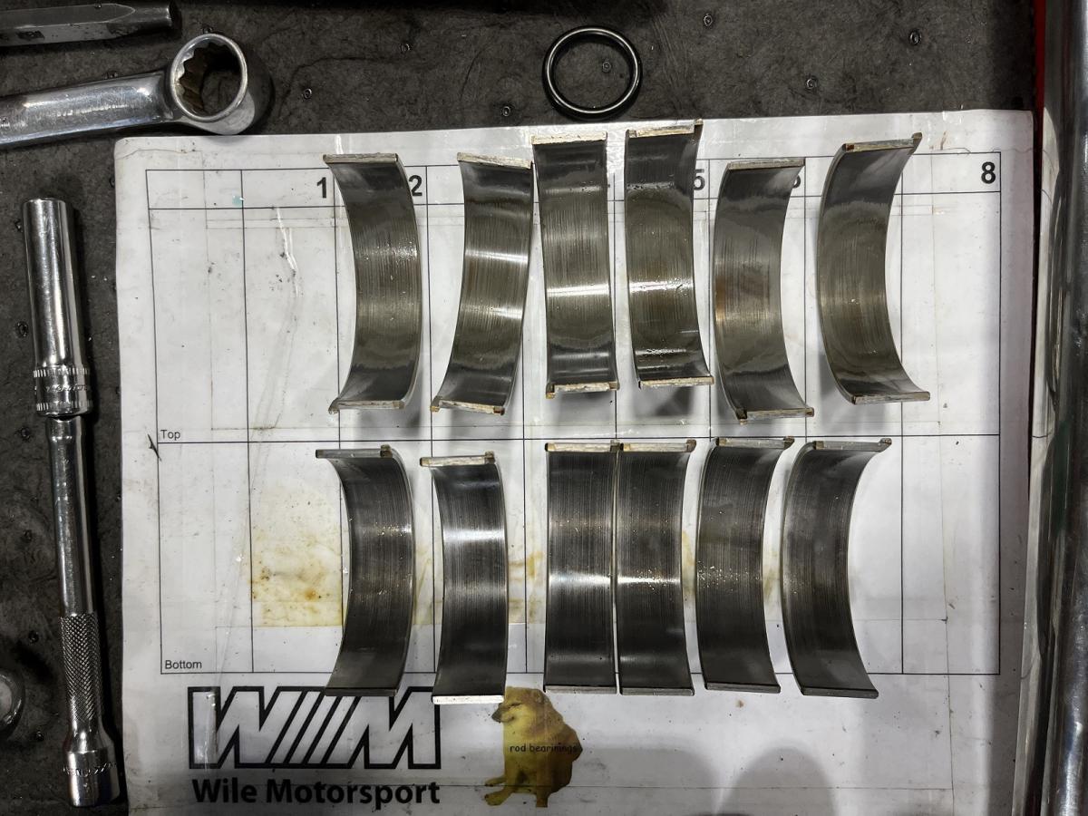

                                These came out of a late production car (04/25/06 build date) with 183,968 mi on it:
                                Click image for larger version  Name:	20240107_191945.jpg Views:	0 Size:	108.2 KB ID:	248345
                                I was told that they had never been changed. Not bad for the mileage!
