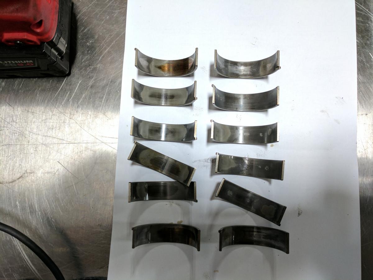

    These came out of a late production car (04/25/06 build date) with 183,968 mi on it:
    I was told that they had never been changed. Not bad for the mileage!
    wow, they look not bad for 183K miles! What was the mileage when you bought it and what makes you to inspect/change them now instead of around 100K?
      Mileage when I bought it was 183,968 mi lol. Didn't even drive it home after buying. Had it towed cause I knew the bearings were original.
      ​​​​​​If I had owned it when it had 100k mi, I would have changed them then.

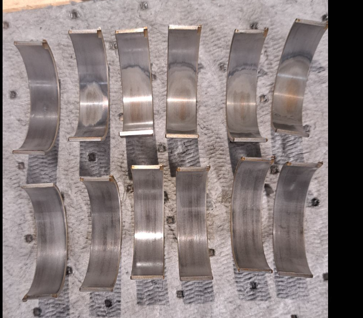

        Out of my 2003.5 6 speed, 75k miles. Cylinders 1-6 left to right, uppers on the top row. Not terrible but glad I went ahead and did them.
          Good wear patterns; Could run another 30K miles.
          How often redline? Track? Hard acceleration?

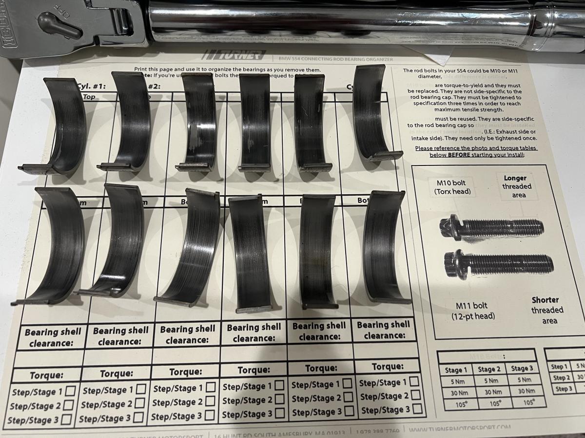

            Unknown mileage on bearings, 95k mile odometer 2001 spec.
              Must be a second set bearings as they still have plenty of life.

                Good to know! I just got the car last year so I can’t speak to the previous owner’s driving habits. I’ve put about 6k miles on it but they’ve been pretty tame since the car needed quite a bit of preventative maintenance (vanos, cooling system, bunch of bushings, diff reseal etc). No track time, maybe a couple redline pulls a week (which will change now that I’ve got the car more sorted). Otherwise just freeway cruising to work at 3k.

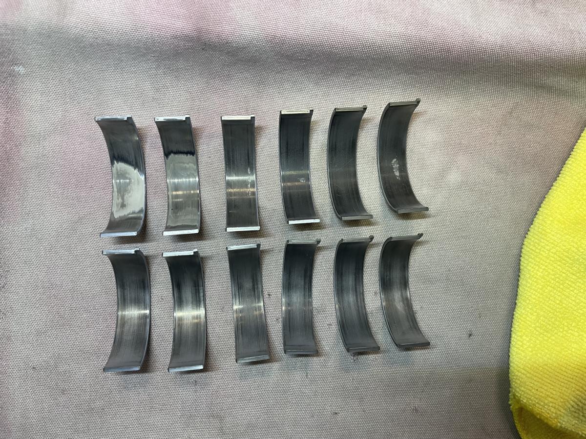

                  This was from a few years back, but for the records … about 109k on engine. Engine is from an '06 model year and presumably had original bearings. I put the previous 55k miles on it including maybe 6 track days
                  OH also under my ownership I drove this thing through cold Chicago winters, those super cold mornings didn’t help much I’m sure

                    right side halves are the top?
                    Not bad for 109K with some track days. This is good to have in the record.
