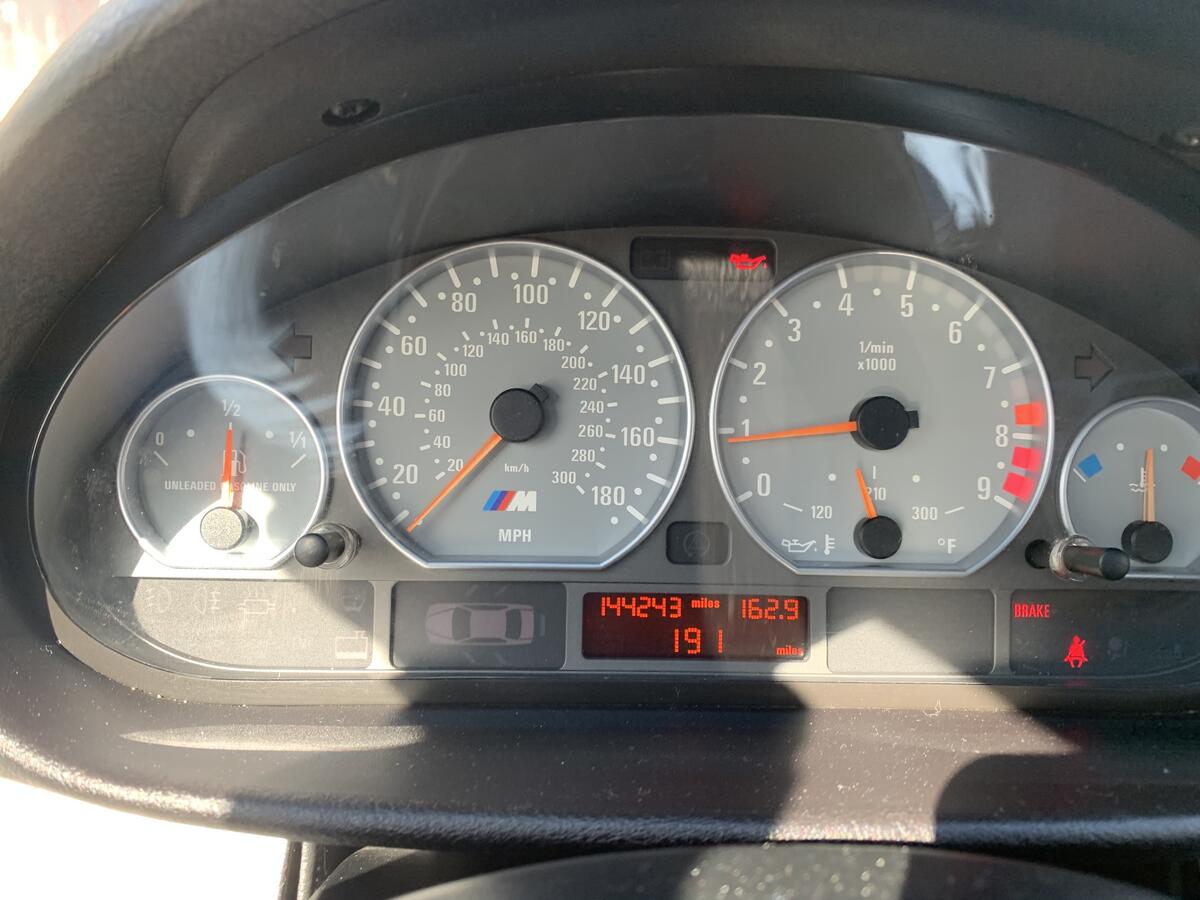

    Almost sh*t my pants when I saw this. Leaving cars and coffee this morning I noticed that a red oil pressure light popped up on the dash. Whenever I would move the car or take the revs anything above 1K RPMs the light would go away. Come to a stop and it immediately comes back on once the RPMs drop below 1k. My idle is around 900 RPMs once the car is warmed up. My oil is not low, it's actually fresh.
    For more context, my rod bearings were done yesterday. We did the full FCP Euro kit and used the correct torque specs for everything and bolted the car back together perfectly. I'm taking it back to the shop tomorrow but I just wanted to know if anyone on here ever experienced something similar to this? I don't believe my oil pressure is actually low, but that a sensor got dirty or went bad sometime during the job, but I don't know at this moment. Picture below for reference

    No good. Install an external pressure gauge to check for the actual pressure. Just remove either the oil pressure or temperature sensor and install the gauge to the same threaded hole.
      Oil level sensor or oil pressure sensor perhaps. Pull the codes.

        oil level should be yellow, not red.
        Code won't help if it's a bad oil pressure sensor.
