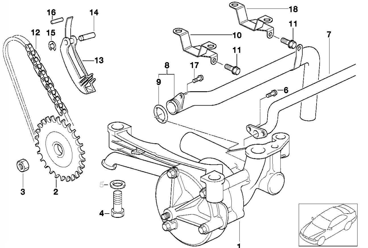

            If it was normal before changing out the bearings, it's either that or something went wrong during the installation, possibly with the oil pump. Was the O-ring replaced on the larger pipe going to the oil pump?

                I'm not sure which o-ring you're referencing. Everything that came in this kit: https://www.fcpeuro.com/products/bmw...-1124783440kt1 was done though, do you see what you're mentioning listed?

                            Unfortunately, it is not included, but it is strongly suggested to replace it. I'm not sure why FCP suggested two pointless items in that kit, one being the oil pan cover and the other being the dipstick tube seal (both can be reused), and they left out one of the critical o-rings.

                            Number 9 -
