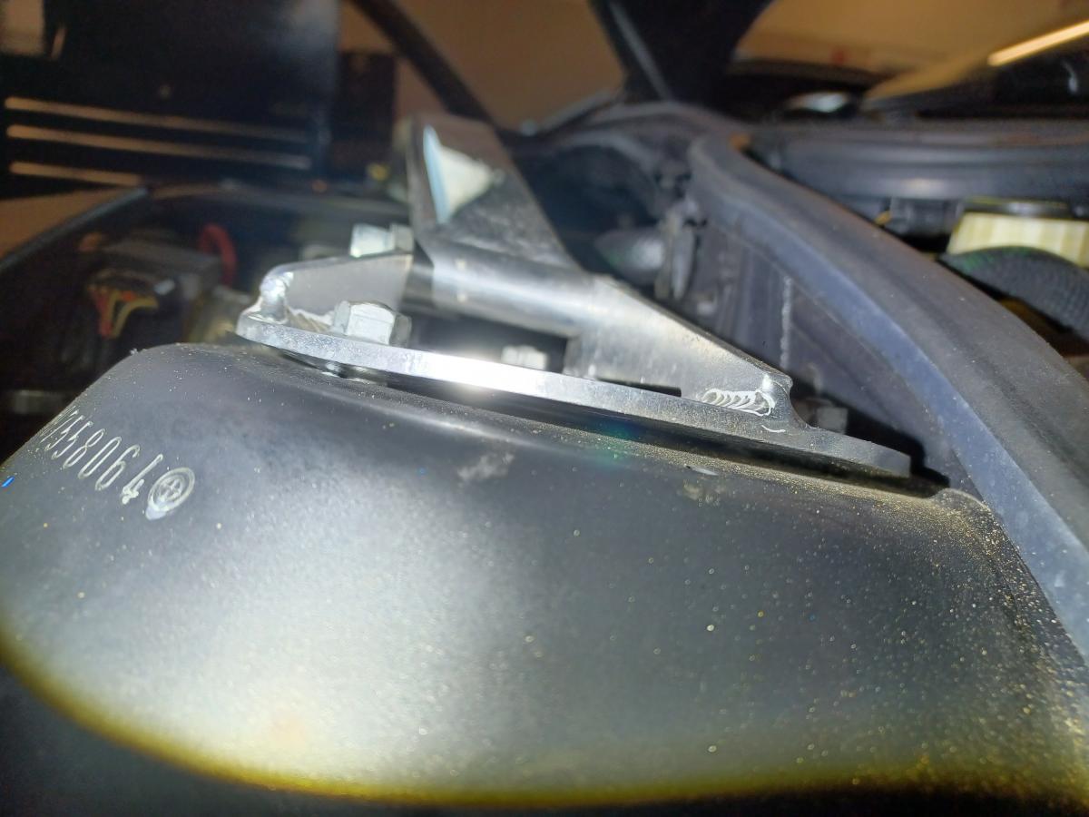

ID:	172969 Click image for larger version
                      It's not an M3 but a customer came in with a Racing Dynamics strut bar and this a warning against it. Most people that you get what you pay for and here's what not to buy.
                      I prefer stock strut bar over my Dinan one. Looks much better and it easier to remove and install. They accomplish the same exact thing.

                        2002 BMW E46 M3 Coupé
                          #87
                          I’m not sure I see what’s so bad to warn against the RD brace from photo? Is it not keeping the towers the same distance from each other? True it’s a hinged brace, but it’s job is to tie the two front towers together.

                            Idk about the hinge but looks like the mounting plates are warping and pulling the strut mount nuts/studs in weird ways.
                              #89
                              I had one of these RD braces on my 325 (about 20 years ago). Those plates are soft aluminum and are very easy to distort.
                              Having said that, it does confirm (in my mind) that these braces do help to some degree. If they weren't being loaded, they wouldn't bend.
                                Most modern BMWs are not allowed to be driven without the front reinforcements, especially the M vehicles. I was lifting a new 4 series and as soon as it left the ground, the whole front end flexed.
                                We don't need to see a mangled eBay strut brace to know they work, however, I agree it is good to see a living example of stress induced on them. This also means buy quality parts and not a garbage aluminum one. It's not an essential part to go high quality, just strongly recommended.
