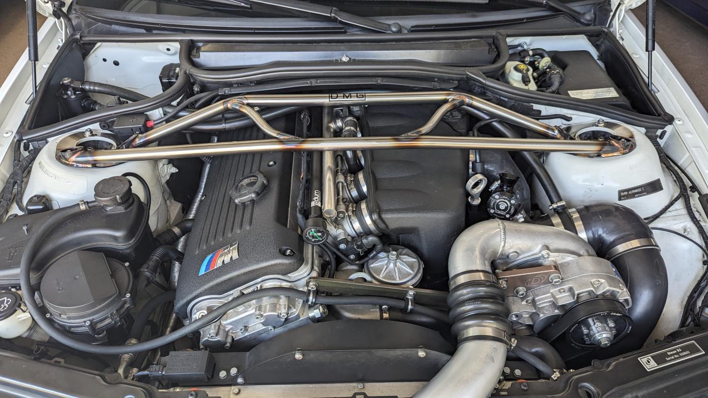

      DMG Pro-46 R w/ Removable Center 3pc in raw clear with heat signatures. Makes it easy to remove and work on the car and of course the bling factor.
        I have the same bar only powder coated black. Probably the best strut bar on the market IMO. Fit and finish is perfect. Surprisingly light as well.

          DMG is some quality stuff

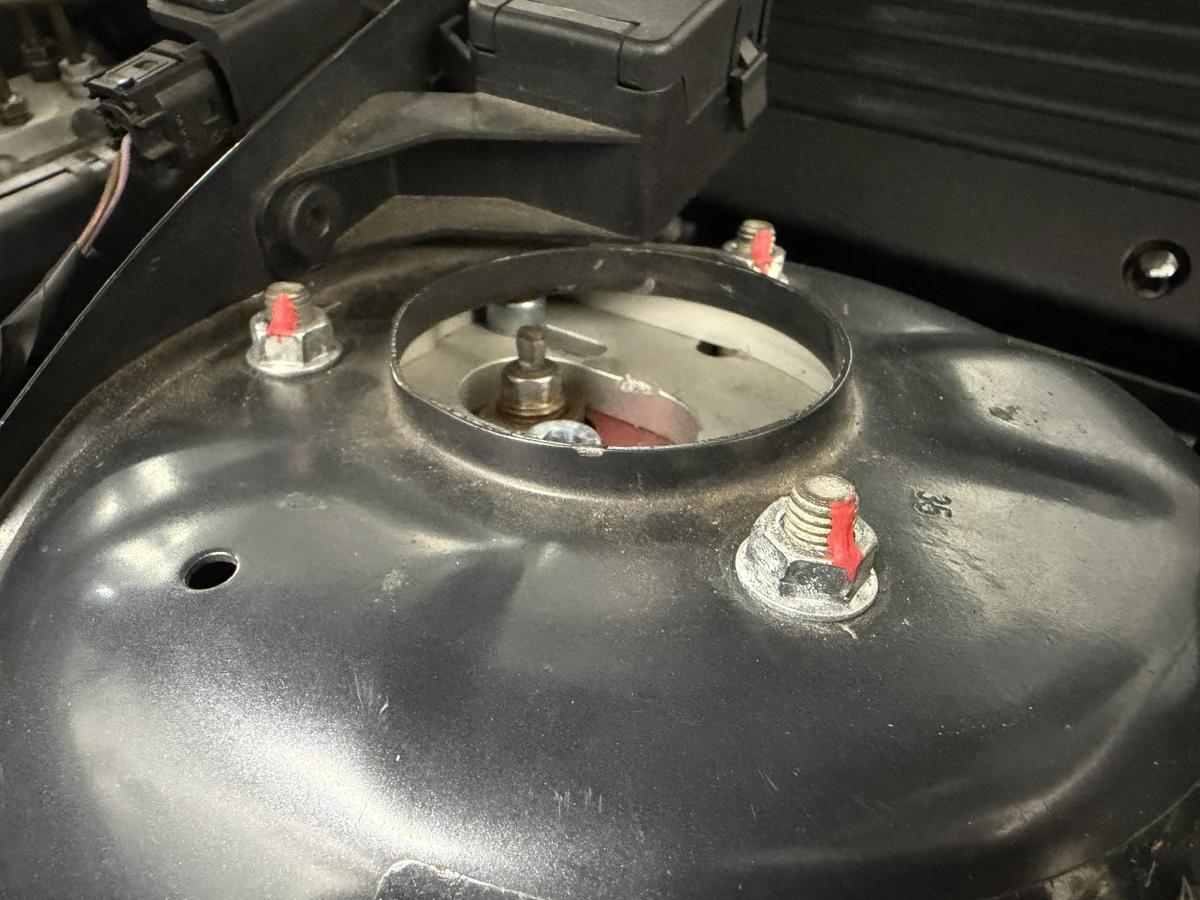

              So there I was...wondering if I could put a used OEM strut brace on our 2002 (8/2001) M3. Our 2005 has the OEM brace; that's the only one I'm familiar with. I remove it often and prefer not to deal with options that aren't easily removed.
              And I found this thread...what the hell?!...the bumps on the 2002? Difficult and more $$.
              This car has the TC Kline camber plate and TCK DA setup. Key measurements:
              1) Remaining length on strut 'bolt': 5.5 to 5.8 mm, with the variance mostly coming from minor differences in the top of the 'bolt' (from manufacturing)
              2) Remaining threads: 4 +/-
              3) Bump Height from base of strut tower: 2.25mm
              With those measurements, the inside position (which has 5.5 mm and 4 threads) leaves 3.25mm of space to accomodate the thickness of the strut brace.
              Does anyone know of an option that allows for removal of the bar, with the mounting plate material around 3mm thick? (Our 2005 with the OEM brace is not with me)
                #97
                With a strut brace, you will want to use these special nuts that have an extended portion to give you more thread engagement.
                p/n 51717895241
                    you can use the stock bar on your 02, i've been using one for years on my 01
                      OK. I'll get six of the BMW Strut Brace Cap Nut - Genuine BMW 51712268565 elbert recommended...Using FCP, they're $12.50 ea...comes to $75 w/tax (it's a good thing I have a hefty FCP credit...that way I can pretend I'm not paying that much)
                      Next, I'll find a used OEM bar.
                        Well if you get a used OEM bar often you can get these deep set nuts with the used bar.
                        But sure, suppose you could return if you never use.
