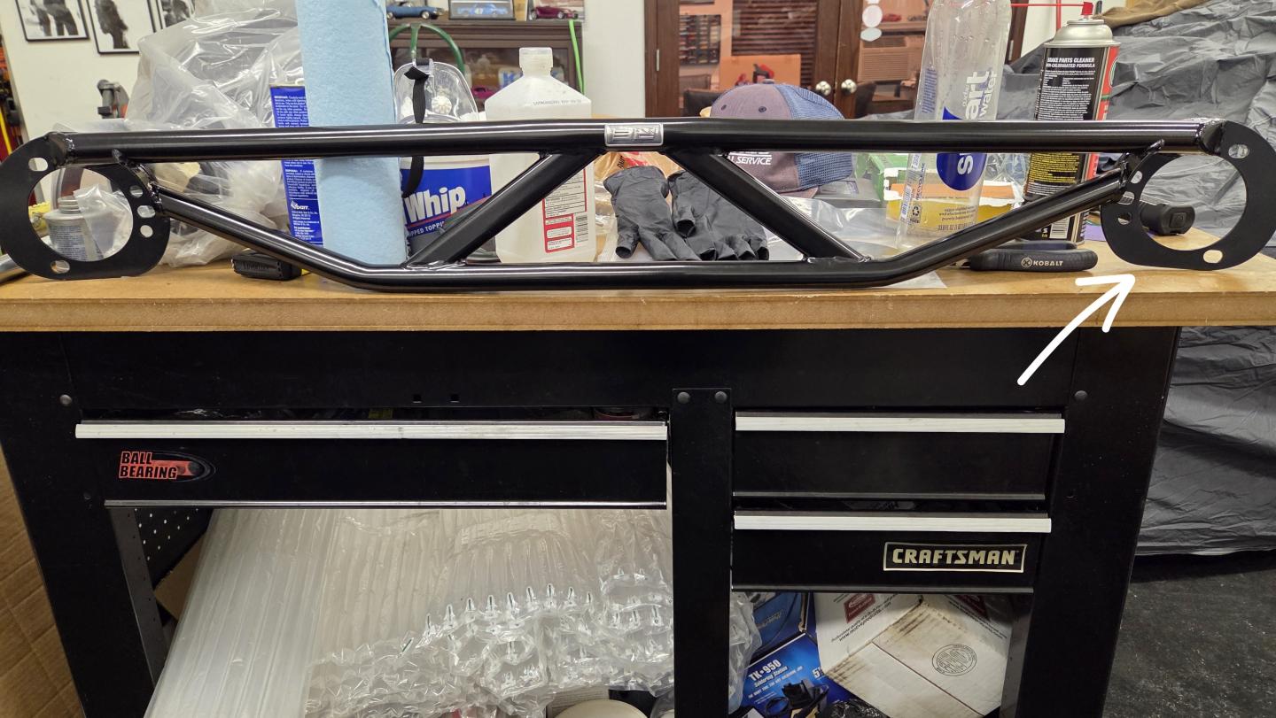

                Since this thread has been pretty busy, figured I'd ask if anyone recognizes what bar I have. Always assumed it was an early Mason/Rogue but cannot find any pics of one like this anywhere.
                Detectives what say you??​

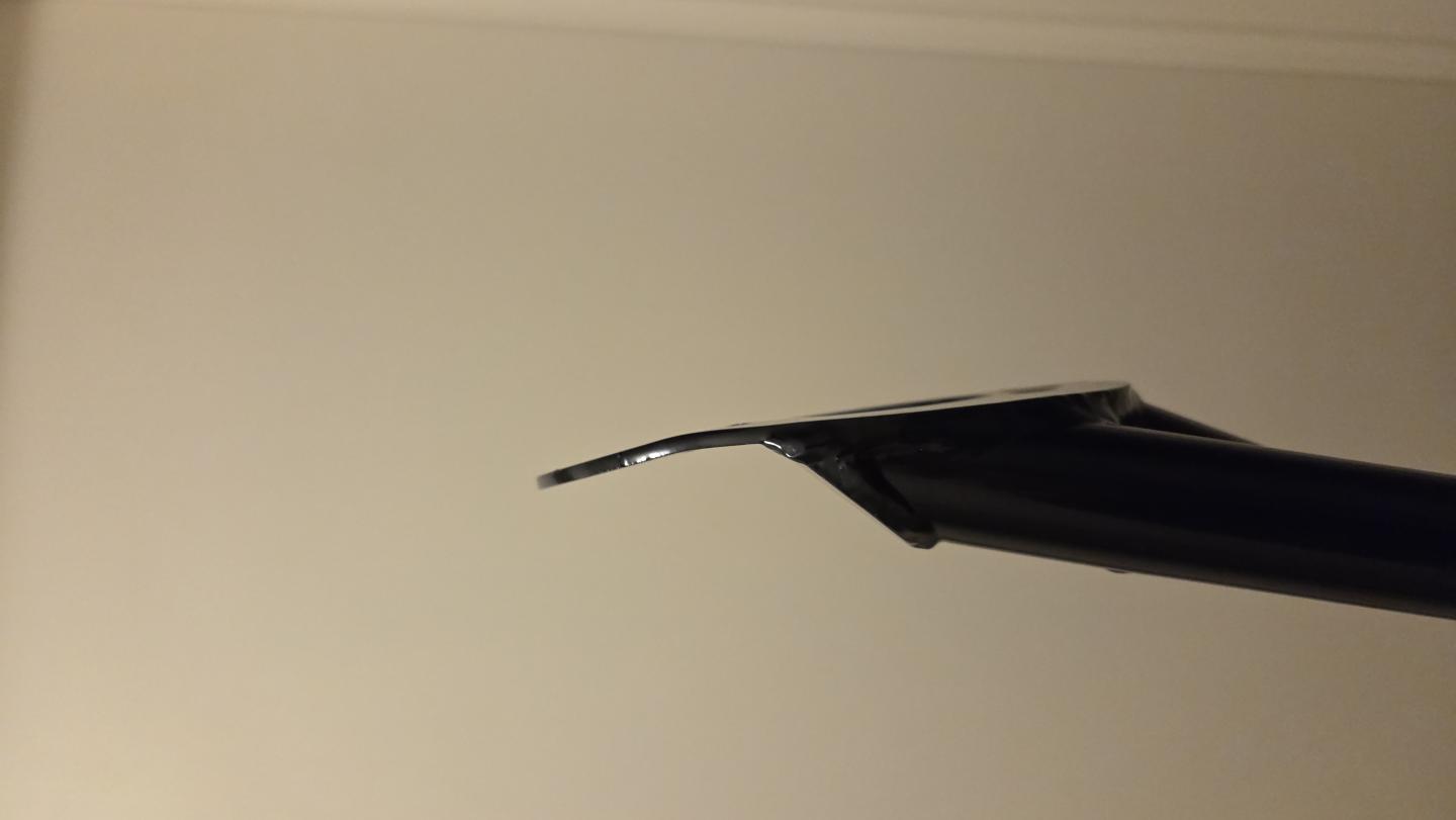

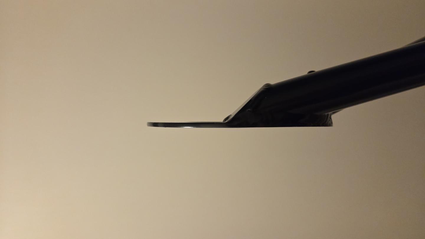

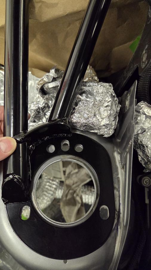

                  Never have I seen that one, on a side note I received my RE bar yesterday, I'll have to send it back. One plate was bent badly and the other side is twisted a few degrees off from the other.
                  The D.S lines up but the P.S isn't close, the plate isn't on the same "plane" as the other, it's like it's rotated 5Β° off.
                  You can see the issue on the vehicle and when I set the bar on a flat surface you can see one plate is offset from the other.
                  I was told to try and install it and if doesn't work send it back, I can't even install this as one side doesn't line up for shit.
                        Yes, this is a very early version RE bar. I was just chatting with Ben about this design a few weeks ago.
                          They sent a new one out, it'll be here tomorrow, hopefully all is well!

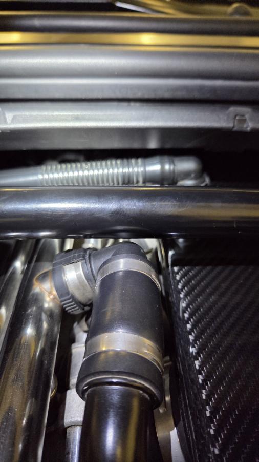

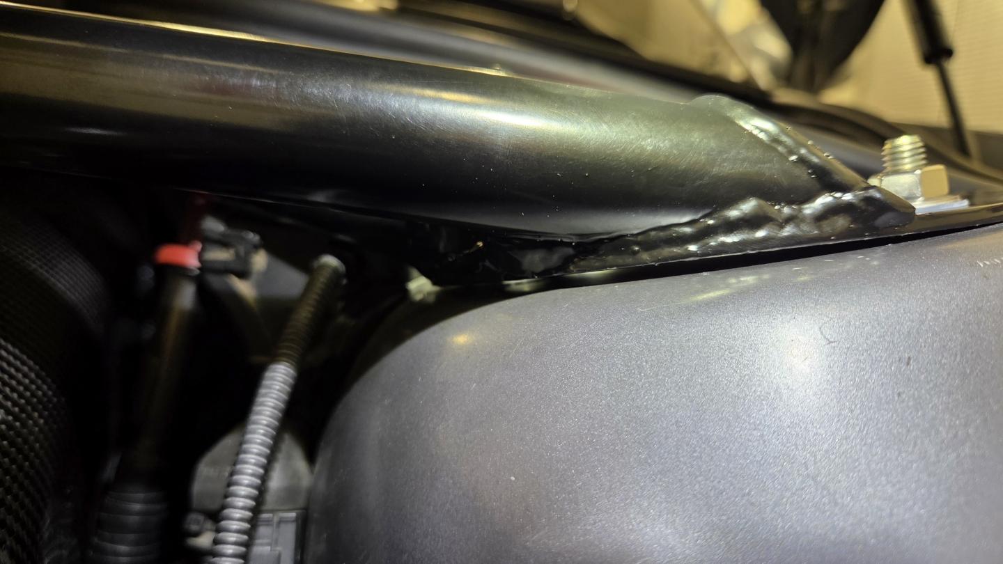

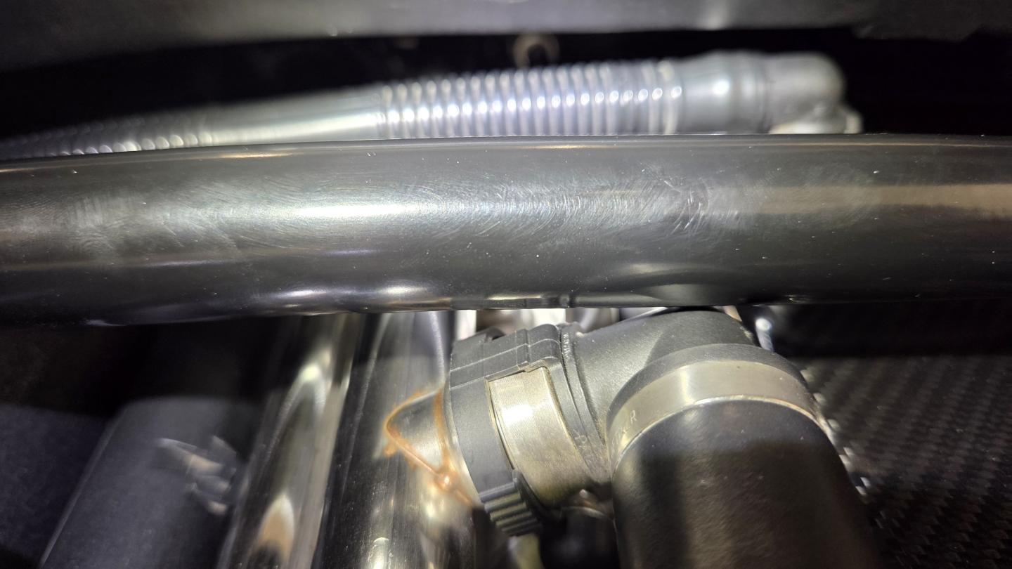

                              My new Rouge Bar fits better than the old bar, the old one had a manufacturing defect.

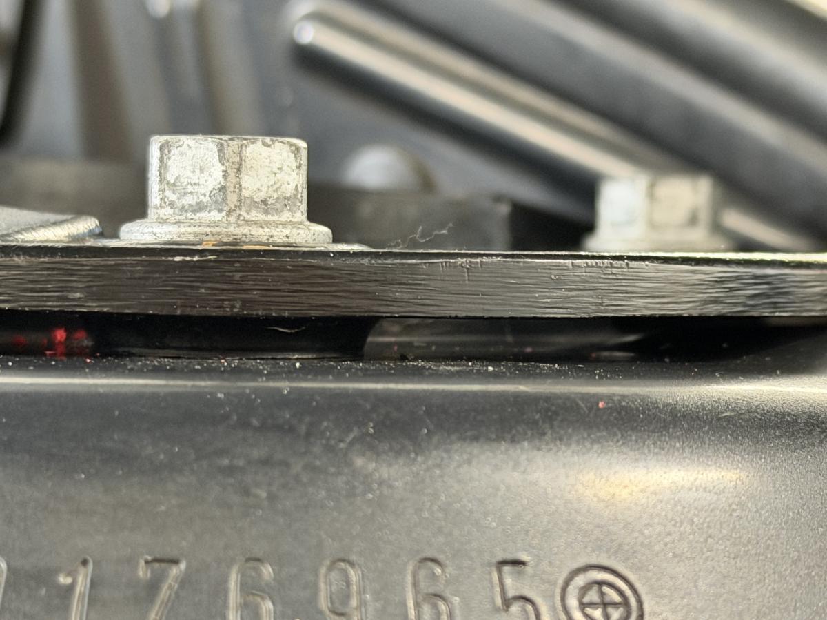

                              It may be an issue with my chassis but the inner 1/3rd of each footing sticks up more than a 1/4" on each side.
                              Once bolted down the gap may close up a bit.
                              I can take some photos as well if I remember.

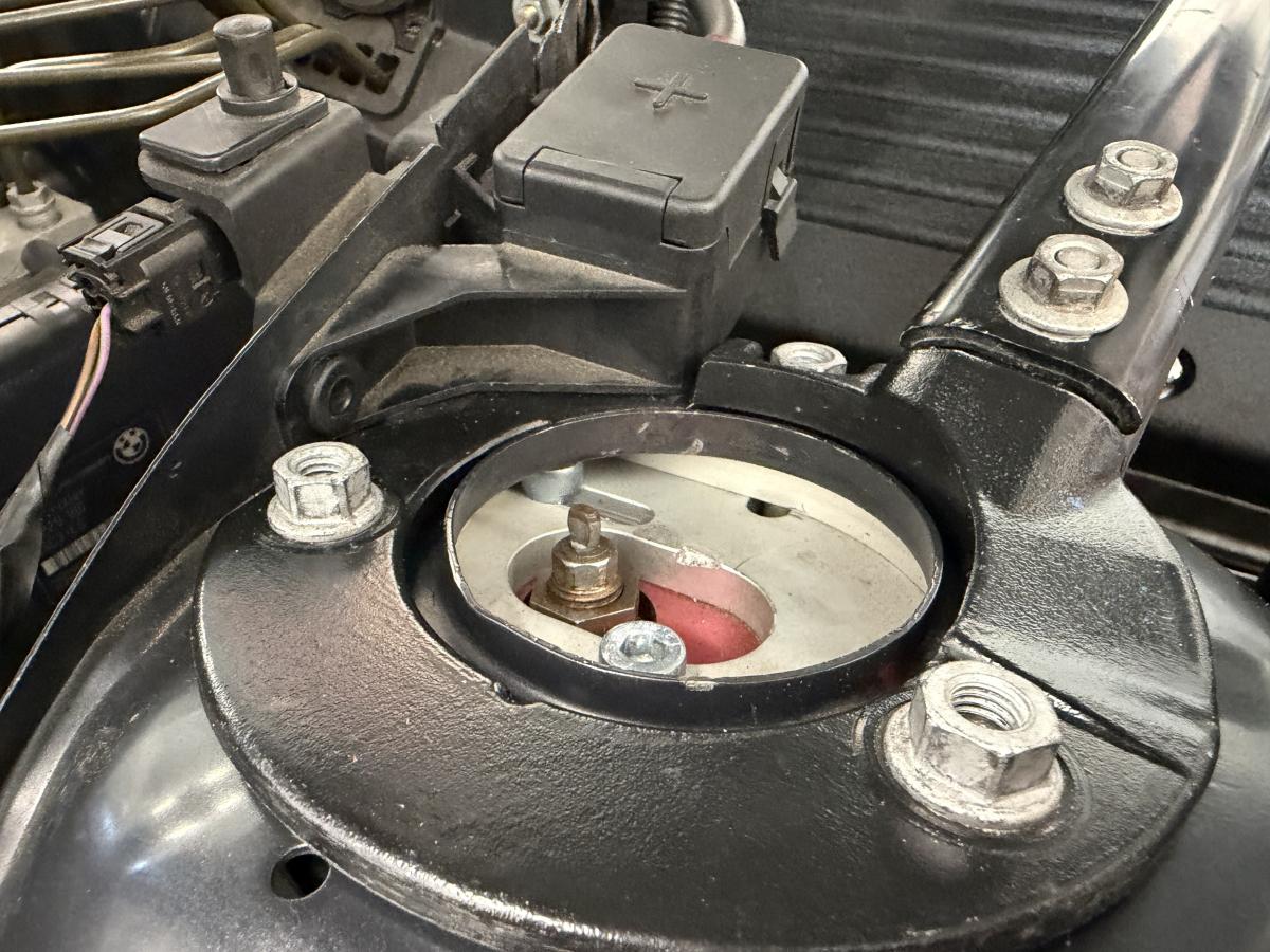

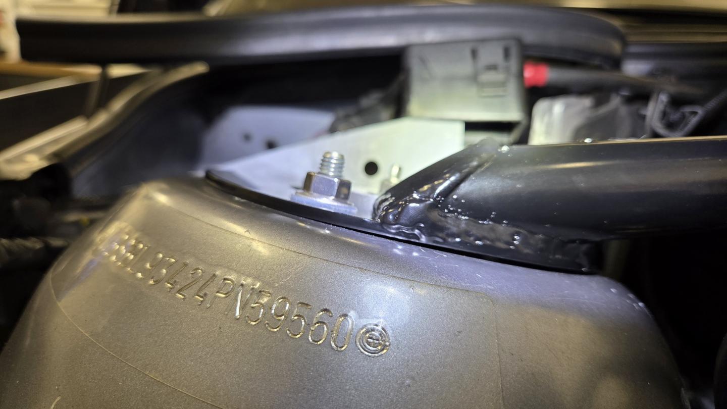

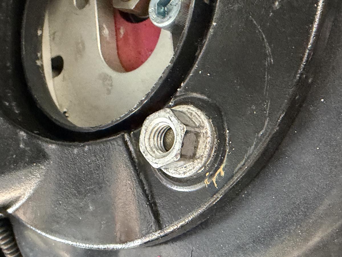

                              Edit, here are the photos, I think I will just stick with the factory brace.
                              You can see the footings not fully contacting the towers on the inner sides, the gaps are bigger than these photos show, hard to get it in focus.
                              Also, note how much the bar moves when bolted down, not saying this is good or bad, just noting.
                              When bolted down the bar touches the ICV fitting, when even the inner two bolts are removed there is a much greater gap between the bar/fitting.
                              This may be my chassis, a defect in the bar, both, I can't say.
