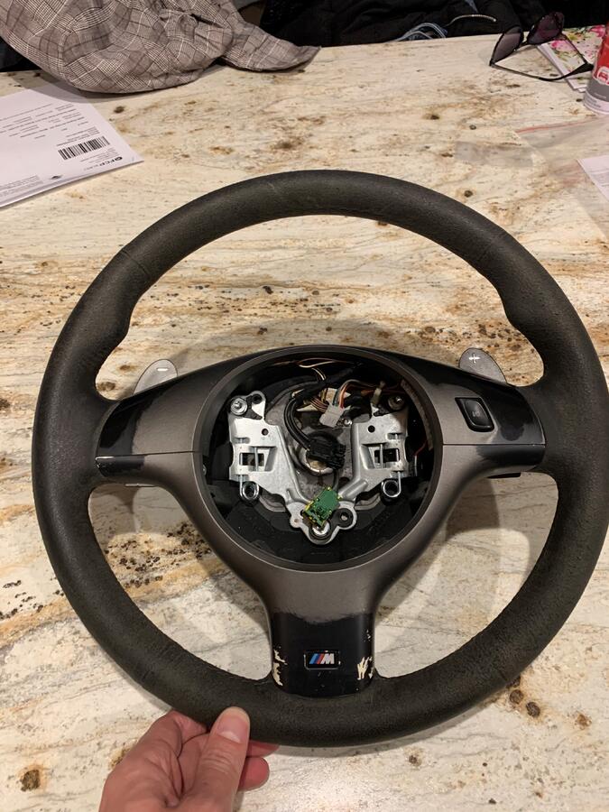

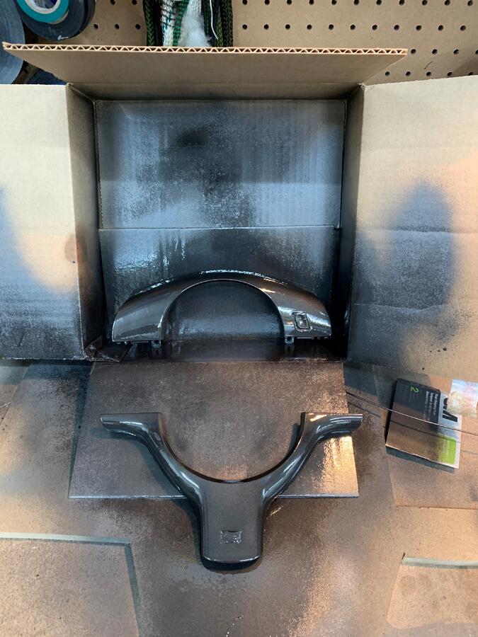

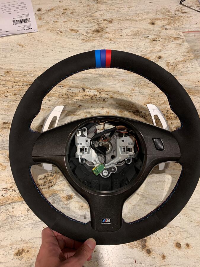

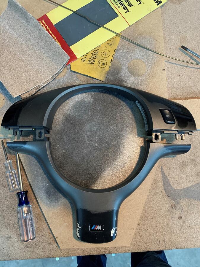

    • Refinishing the ZCP steering wheel to deal with the worn out alcantara and faded paint. Repainting trim and rewrapping the wheel with a kit I located.

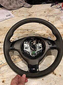

    Finished bringing back my ZCP wheel from the grave by rewrapping the cover and repainting the trim piece. Looks 200% better now. Thought I'd share the results. PM me if you want details.

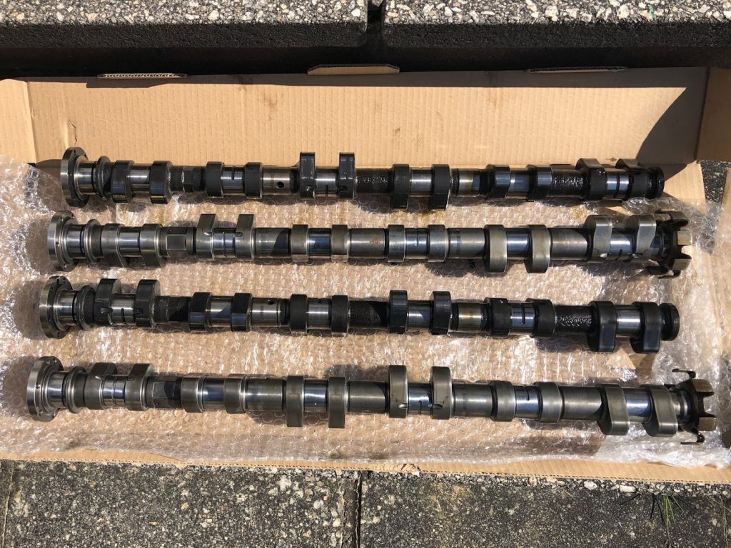

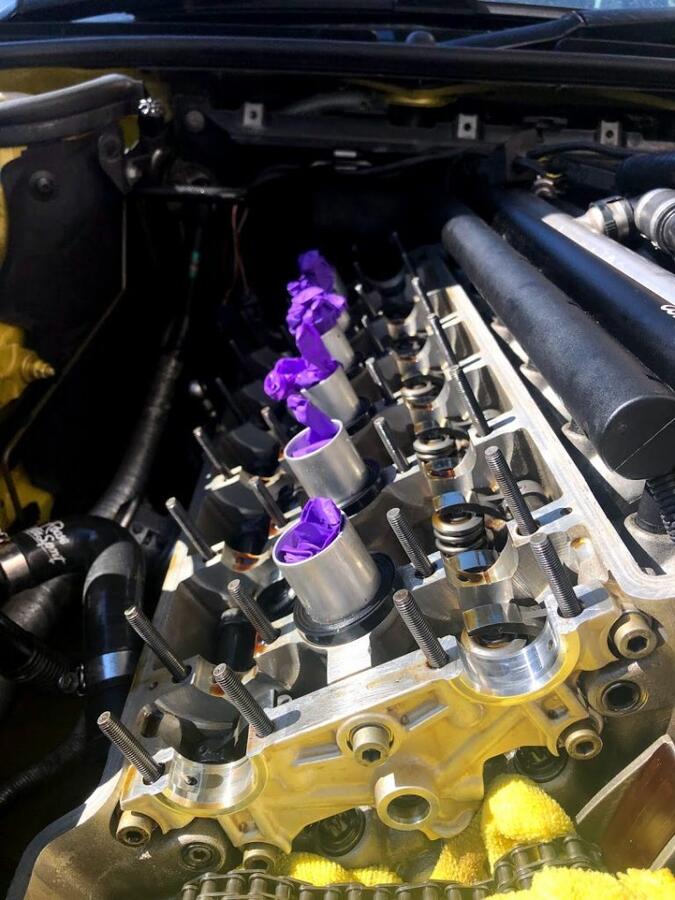

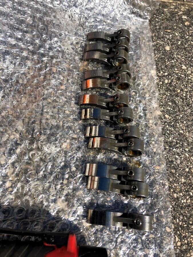

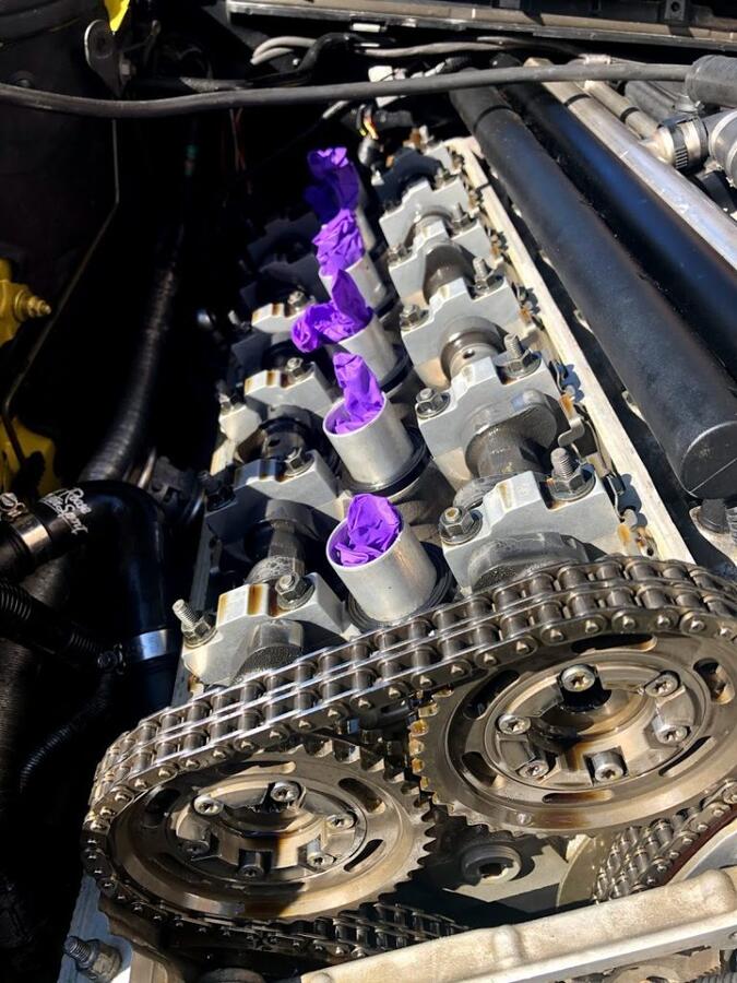

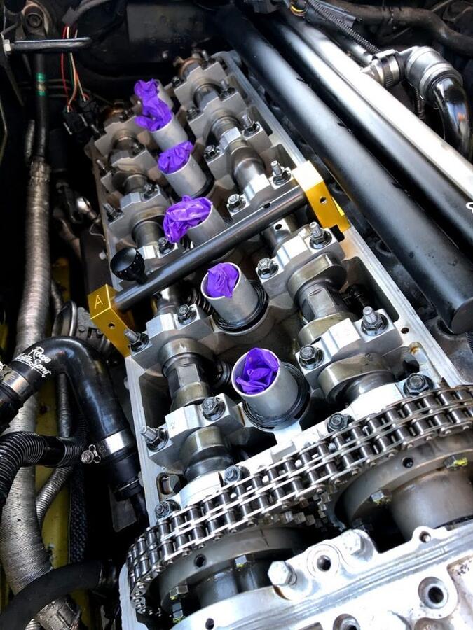

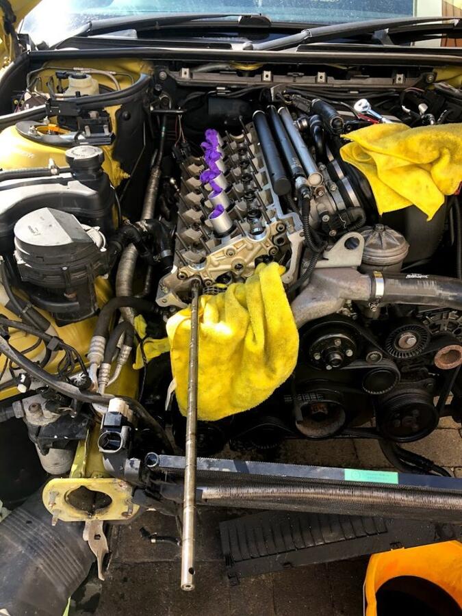

      I'm still working from home so my time has been limited, I did however manage to fit my new 280/272 cat cams and DLC coated followers.

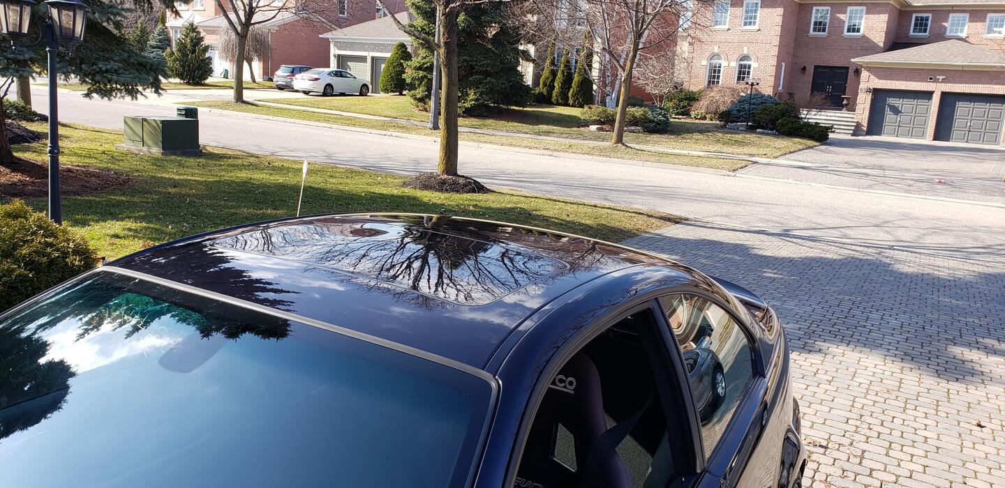

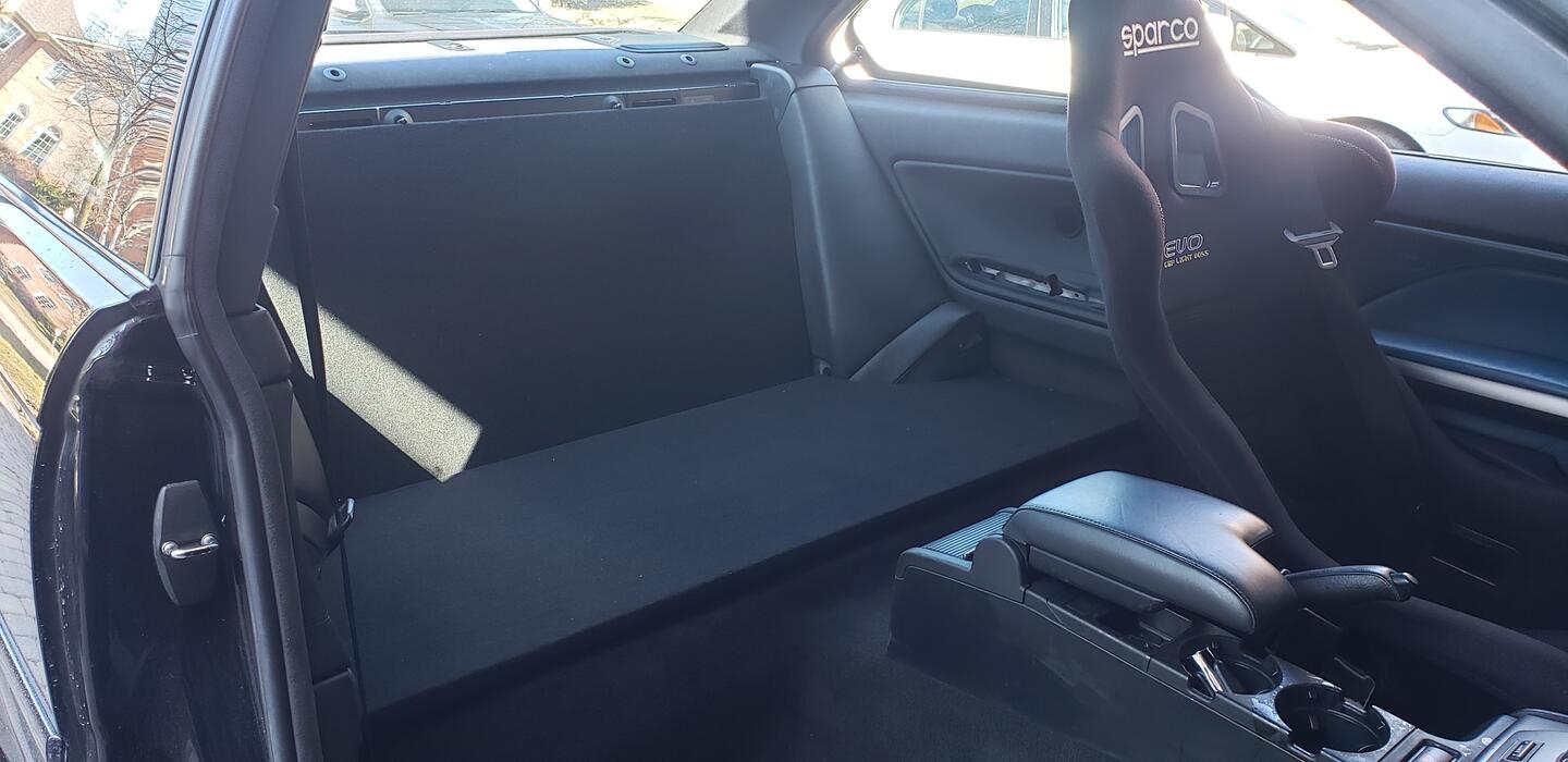

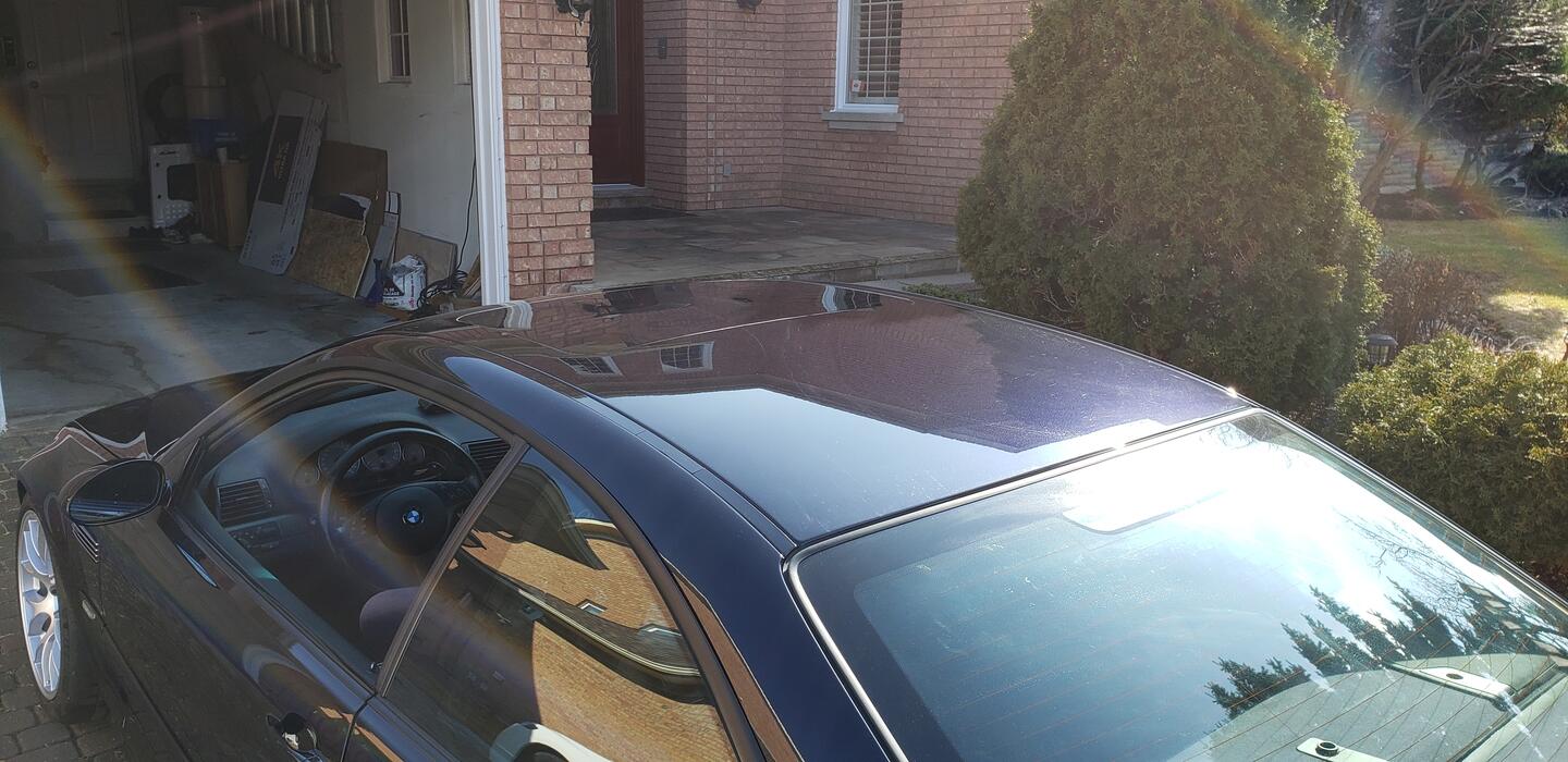

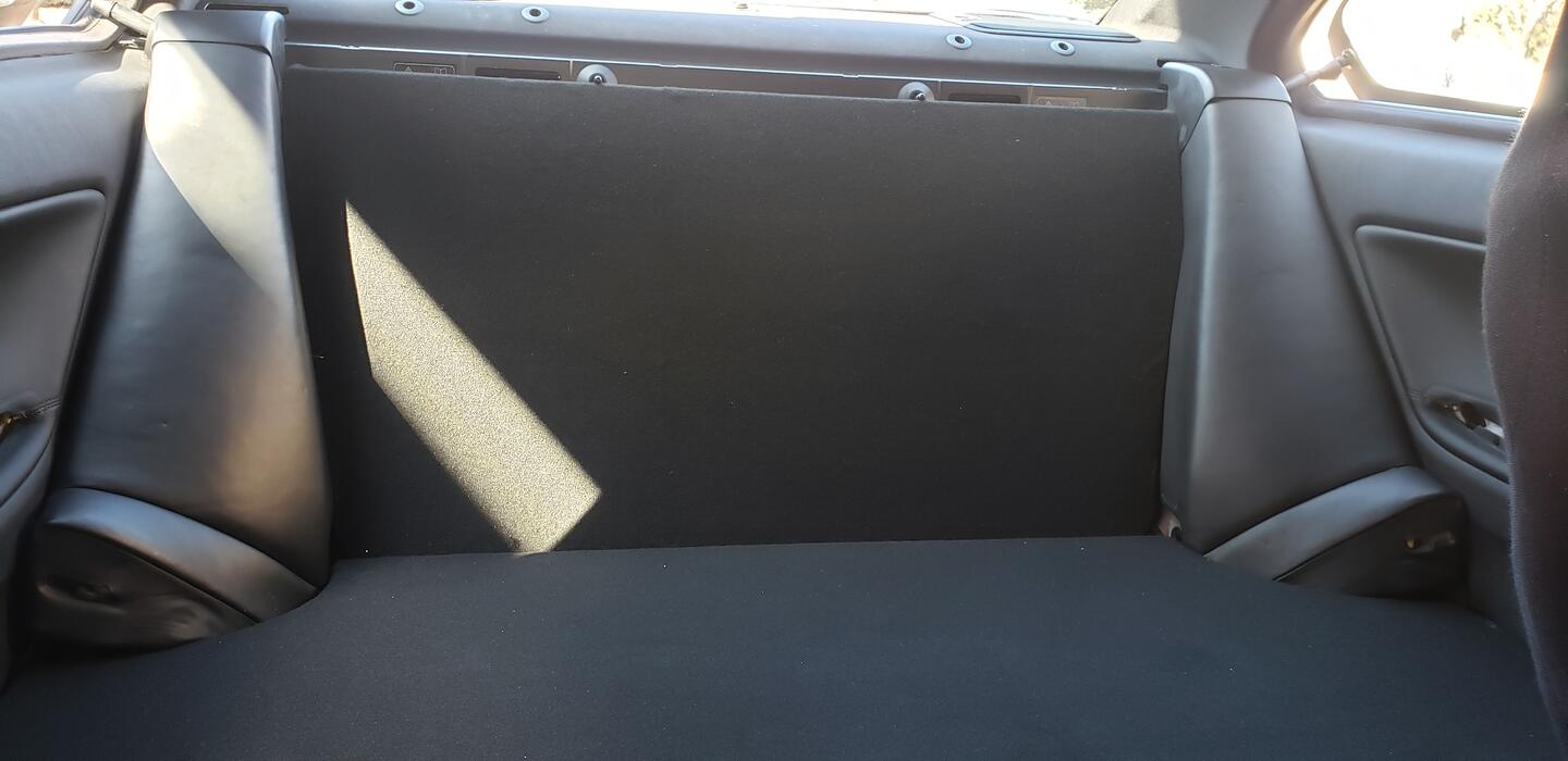

            Got my sunroof delete put in and made a rear seat delete panel to the the back up and cut out some noise.

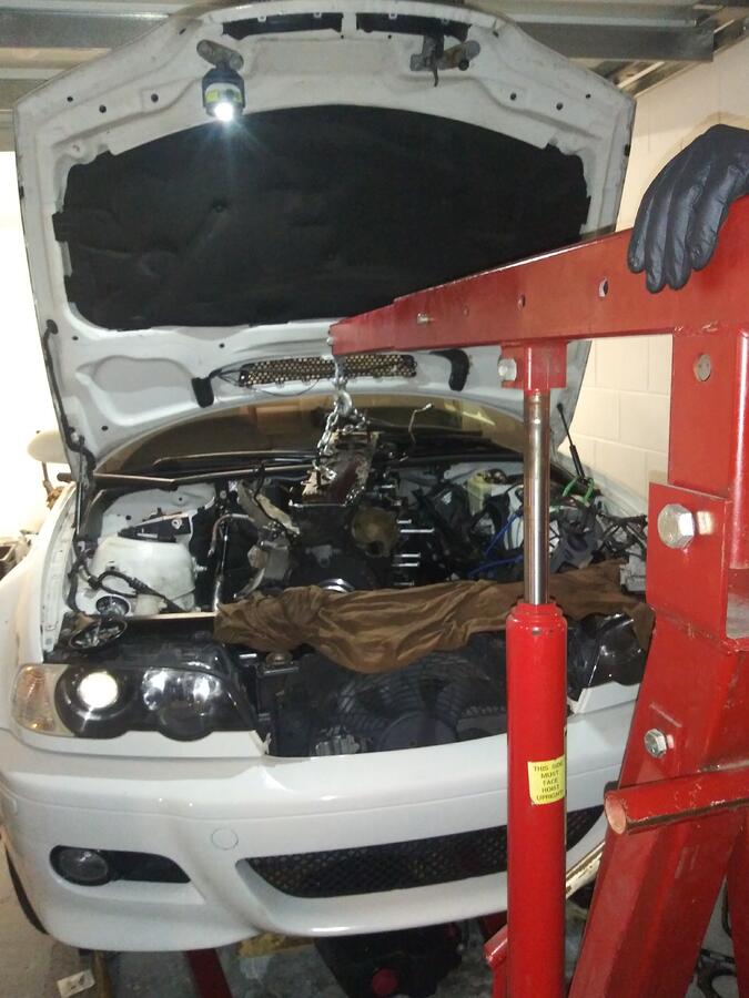

              Simple project. Just putting an engine in. Did rod bearings, valve adjustment, replaced cam bolts, put my old rebuolt vanos on, screw in studs for headers, did rear main seal which took a total of 5 minutes with the engine out, and fought the entire time it was going in. The way the hoist had it, the engine was slightly lopsided so I had to pick up the top and remove the cowl to get it in. The trick was getting it past the A/C port and not have it rest on the steering column. It was a nightmare but once it was in I just took the next day off because it has taken so much to get to this point. Hard work pays off.
