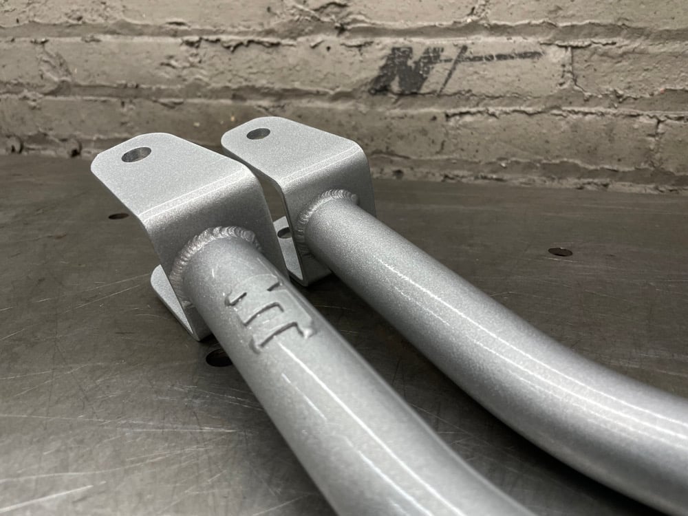

                        There are these…
                        Wisefab's upper control arm for the BMW E36 and E46. More ridgid replacement control arm for the rear which allows to adjust the rear camber. This control arm will replace the OEM spring carrier arm. This arm assumes coilover rear suspension. For maximum adjustment range check out the lower control arm aswell. Other components to include to the cart on your way out:Feal Suspension Coilovers with upsidedown rear shockRear Knuckle Front Bushing kit for BMW E36 and BMW E46Rear Subframe Bushing kit for BMW E46 Scroll down to order your spare parts conviently right here!
                        E36 / E46 Upper Control Arms (For use with true rear coilover conversation only) A tubular and adjustable upper control arm to replace the factory spring bucket style. The bend allows clearance for lowered cars, and the adjustment allows for the rear end to truly get dialed in when used with our “Lower control arms”...
                        But then going with a rear coil-over creates a bunch of other issues.
                        - I don’t run a rear sway. One of them has a provision for a link.
                        - You have to reinforce the upper shock mount area.
                        - Will the lower shock bolt hold up?
                        - Sacrifice back side tire/wheel clearance?
