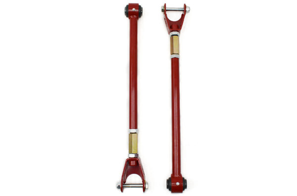

    get the GC adj. LCA's with sealed bearing
    Tired of disconnecting the muffler just to align your car? Did you pay extra labor because your current control arms are difficult to adjust? The GC control arms can be adjusted without moving, removing, or bending anything. Chrome moly racing rear control arm manufactured in Germany.
