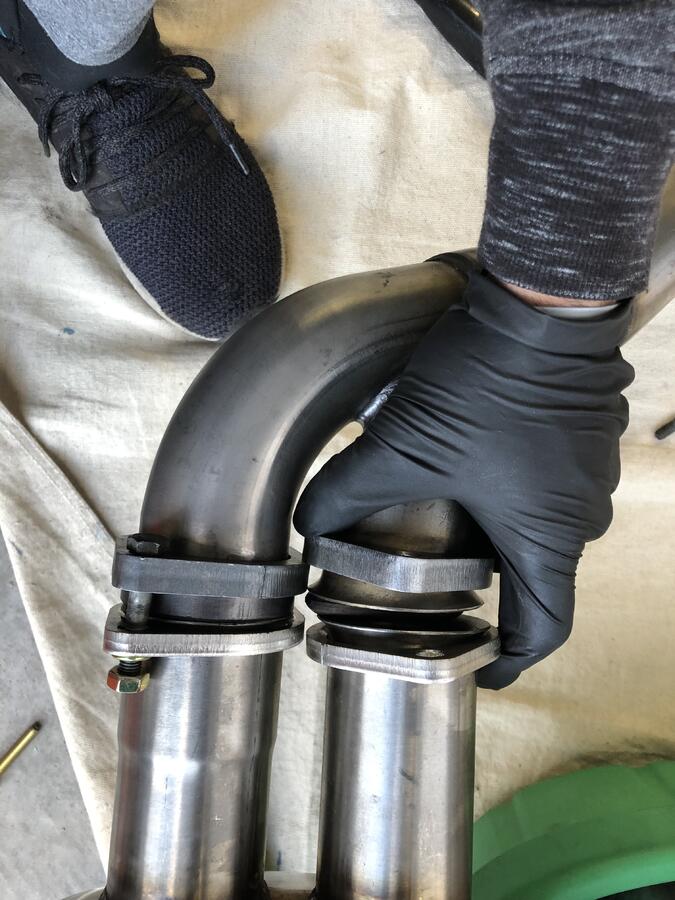

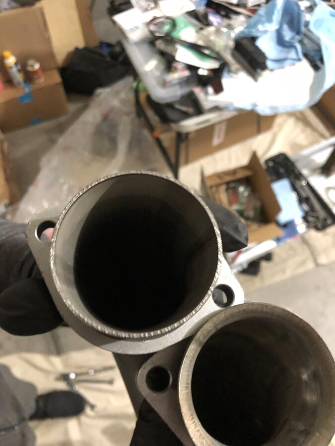

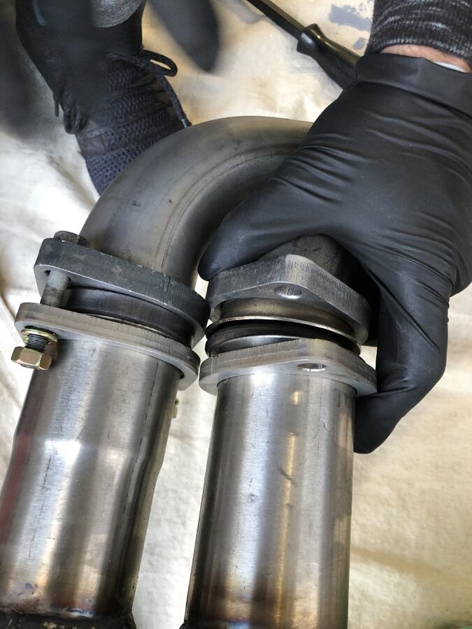

                        Very disappointed in quality control from SuperSprint and also with the packaging as my Section 3 arrived very scratched in several places including tips. Below is the 60mm Section 2 they sent to me:

                        It's not even close and at this point, I'm worried about what QC issues await with the Header/Sec1 install. I'll be reaching out to Turner and hope they'll expedite me a new Section 2 and Section 3 ASAP.

                          Jesus, not even close. Feel free to put me on CC to Turner. I’d like to keep an eye on this.

                              Mine had the same gap. Pulled it in with the bolts. Had the same issue with the stock section 2 into the ss muffler

                                It’s not about the gap between both sections, it’s about not having enough spacing between flanges to allow them to correctly bolt up to muffler effectively pulling them together and sealing via gaskets. Both flanges hit no matter how you turn them for alignment.
