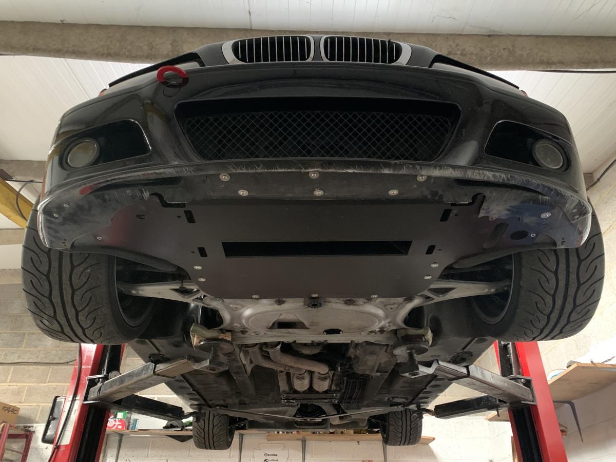

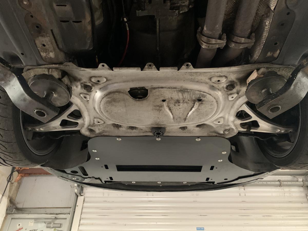

      Here's some pictures from our customers! Everyone liked it so far and most commented on how easy the install was especially with the instructions and necessary hardware already provided.

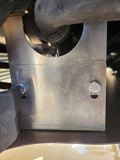

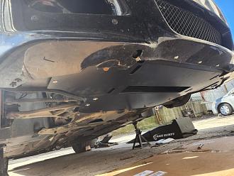

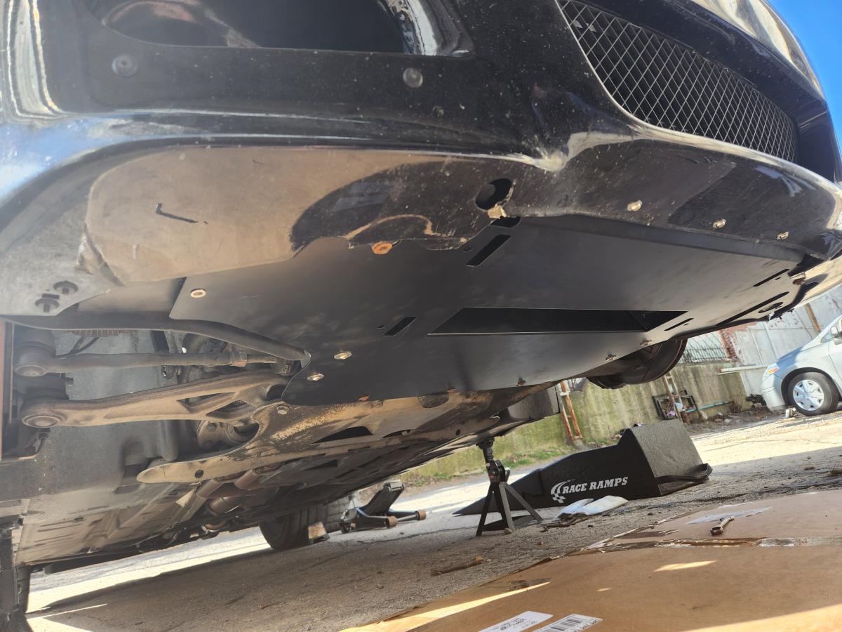

        wanted to share some picture and some notes regarding my install. this is a pretty complete product. everything lines up as it should. a lot of nuts and bolts included as well as some riveted pieces which certainly make the install easier.
        definitely easier to take the wheels off when doing this. i did this on the floor, i imagine on a lift this is a cakewalk. took me about 1-1.5 hours. doing this again, i could probably do this in 20 minutes (yes, that simple)
        i personally feel that in the instructions, when it asks you mock-fit the rear to make the holes for the front, i would also suggest you mockfit the 2 screws on the side. this attaches the undertray to the front lower fender liner and the bumper, although seeing the pictures above, the bumper above doesn't extend whereas mine does. i have an '06. kind of odd that the bumper mounting is different.
        overall, i'm happy with everything and with the track season coming soon, we will see how this affects the cooling (pow3r says it improves it)
        pictures below:

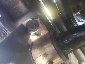

        picture from where the bracket connects to the sway bar bracket
        undertray bracket and sway bar bracket are 2 pieces and get attached from here.

            how effective is that hole for the "venturi" effect? Also not that it matters to me but might to some, doesnt that add lift? Similar to 997 911s with adding a third radiator. the air exits to the bottom versus the top like the GT3.

                            That opening isn't going to do anything. In fact it might cause air to go up into the engine bay. The problem is the undertray is higher than the leading edge of the bumper which causes air pressure to increase. That is why the OE part curves downward which keeps the flow attached and creates alower pressure region.
                            To effectively extract air from the oil cooler, the oil cooler needs to be sealed off to the undertray and then the opening needs a gurney flap to increase extraction from the oil cooler.
