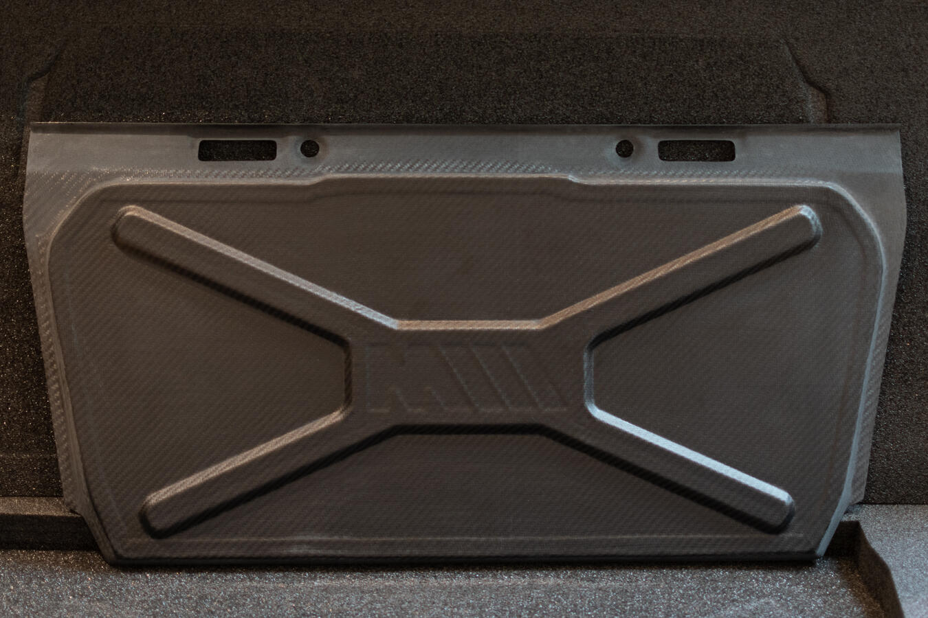

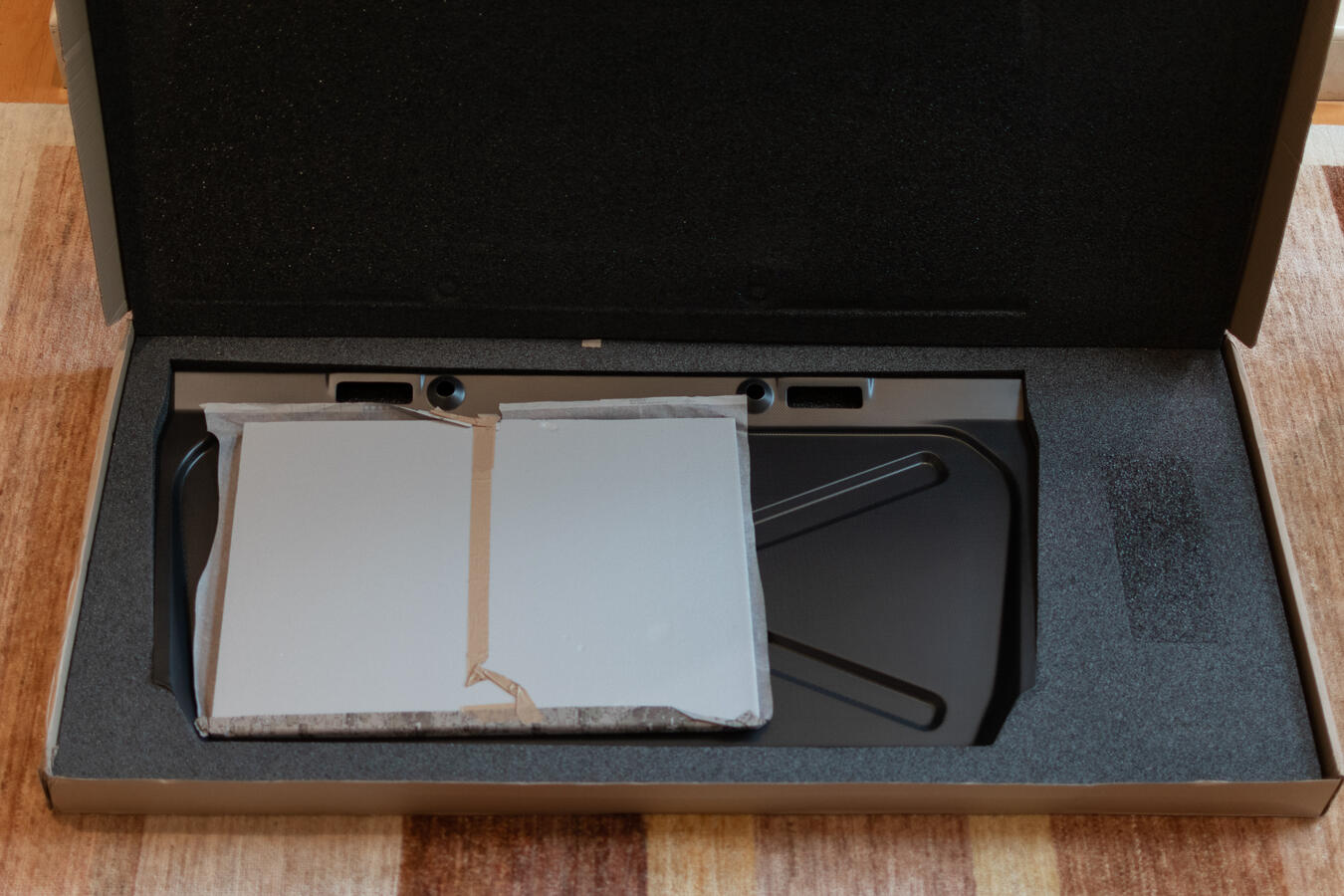

        Got mine yesterday and figured I would do a mini first impressions review.
        Starting off with the unboxing pics, it came super well packed:

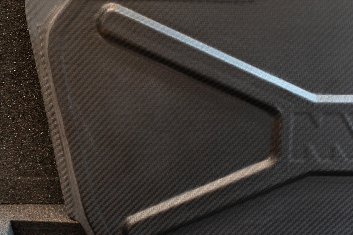

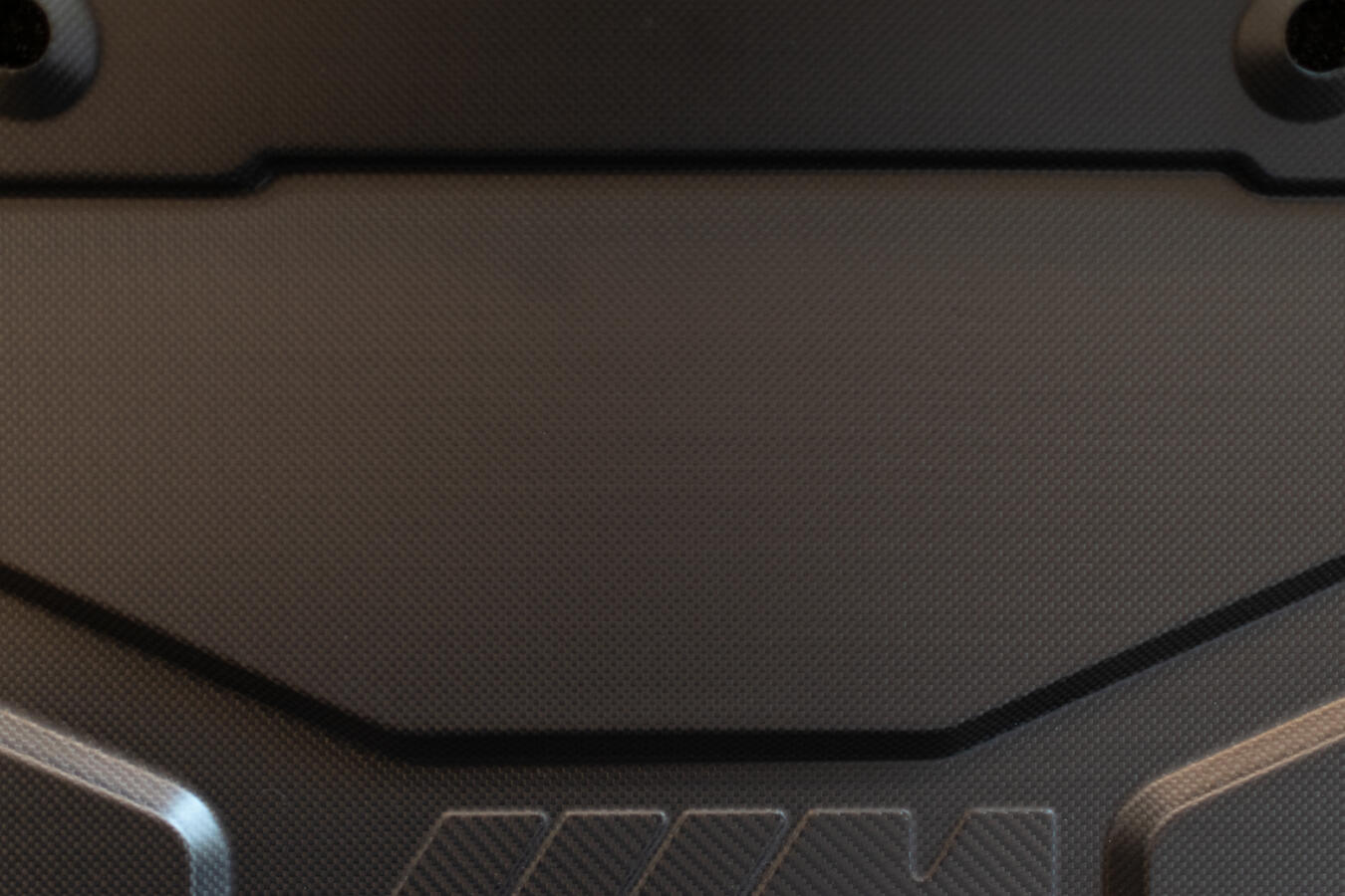

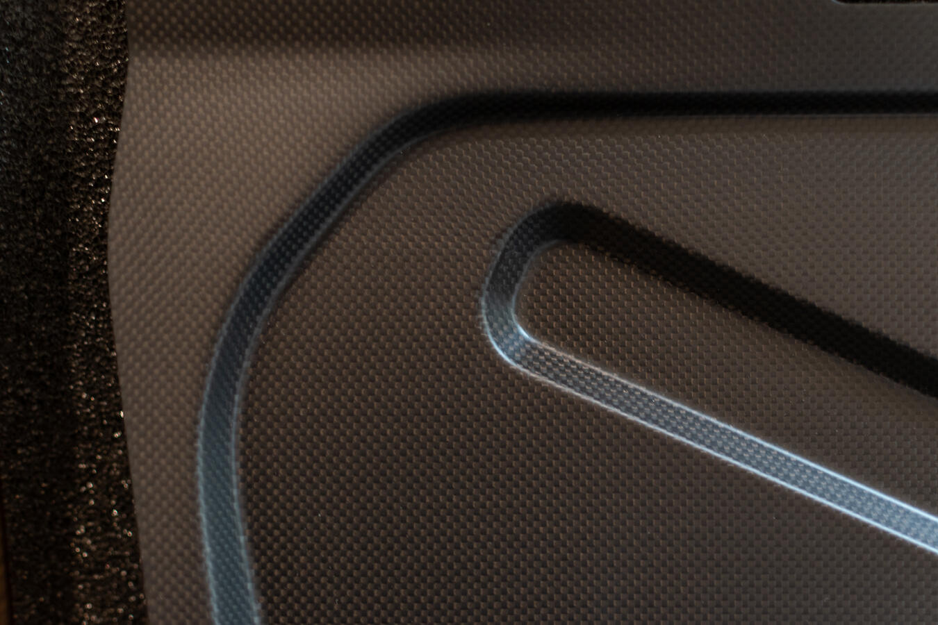

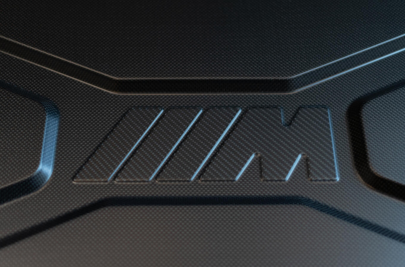

        I ordered mine in 1x1, but it looks like it's just the final layer of the piece that's in 1x1. The back and M logo are 2x2. I'm assuming this is because of structural reasons:

        The weave itself is great. Not entirely sure if this is wet-layed or prepreg + autoclave or whatever, but there was only one part I could find where the weave was a little wavy. It's the 1x1 layer, so purely aesthetic:

        The rest of the weave looks pretty much all like this:

        It's also way thicker than I expected. I measured it to be ~3mm thick right by the "bead rolled" sections. Feels incredibly sturdy, which is great since that's kinda the point of this thing:
