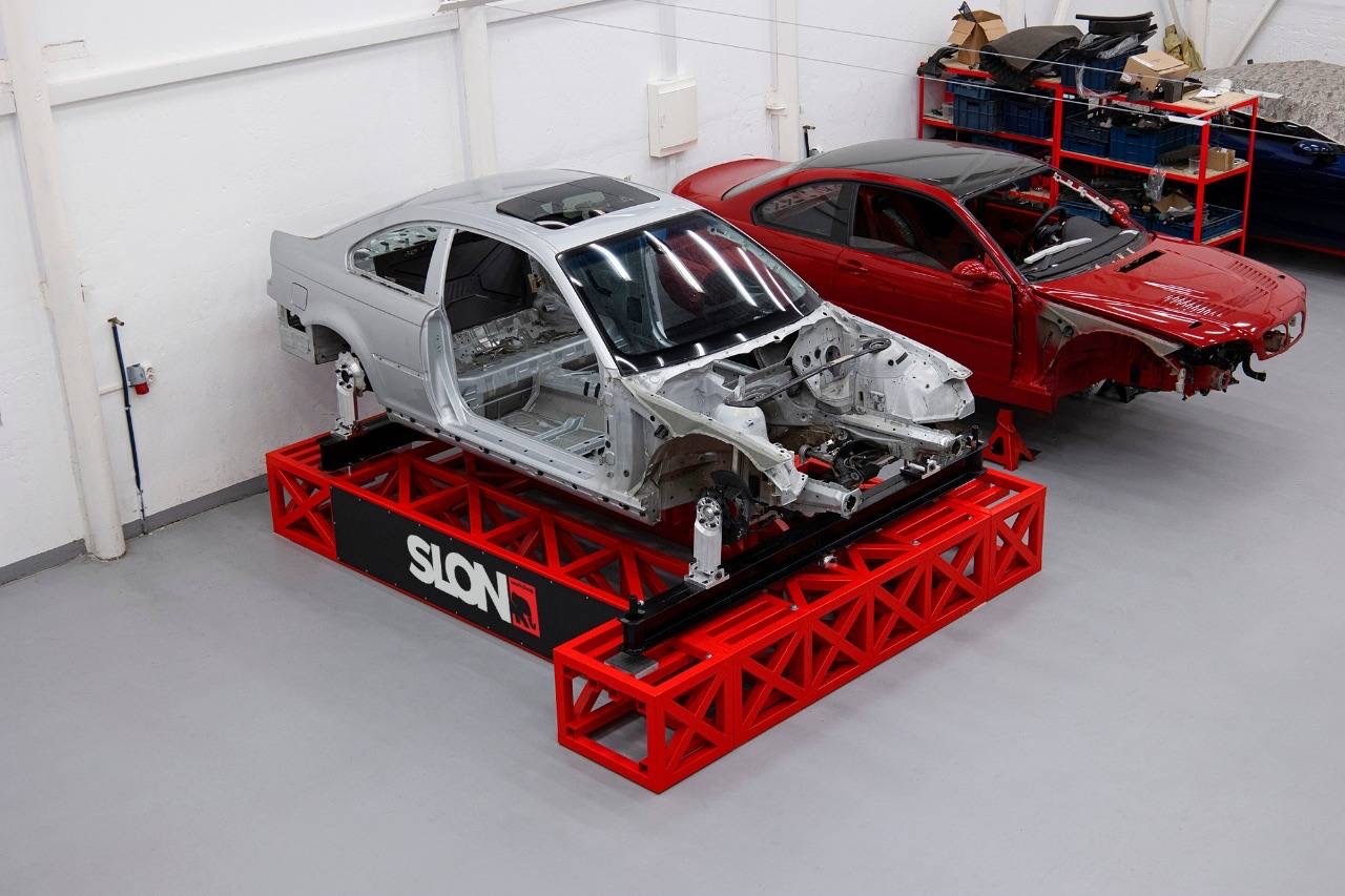

          Slonik got their chassis twister set up, so I'm hoping we have results soon!
            Chassis stiffness results with this installed inbound:
            Write something... Okay, i'll try (sorry for my English) :D. Hello guys and girls! I was mainly offline on the forum during summer season, cause we have a lot of local work, our customer's cars went "time attack" events, a lot of trackdays etc, and by the way, one of our M4 took 1 place in Russian Time Attack

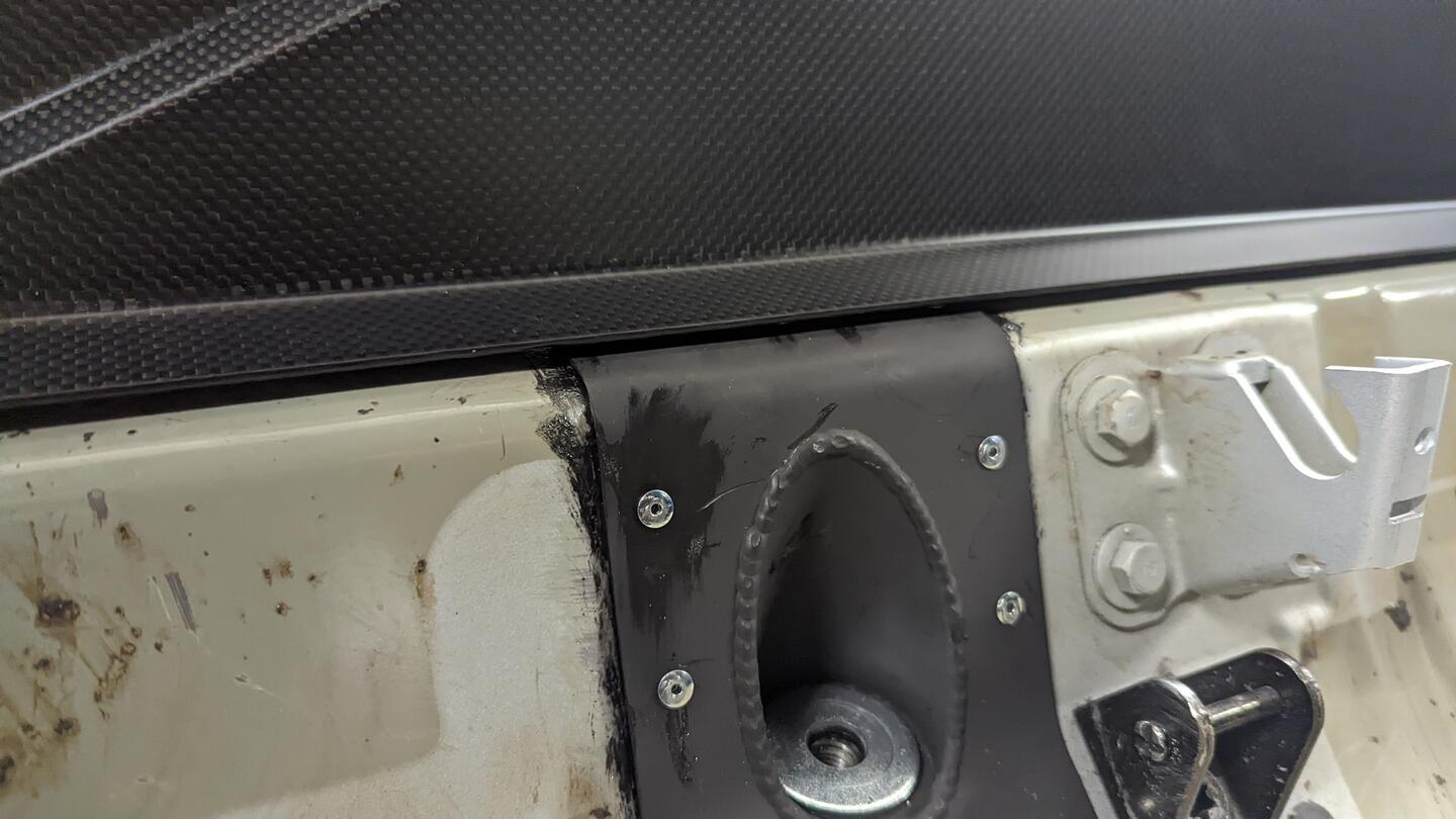

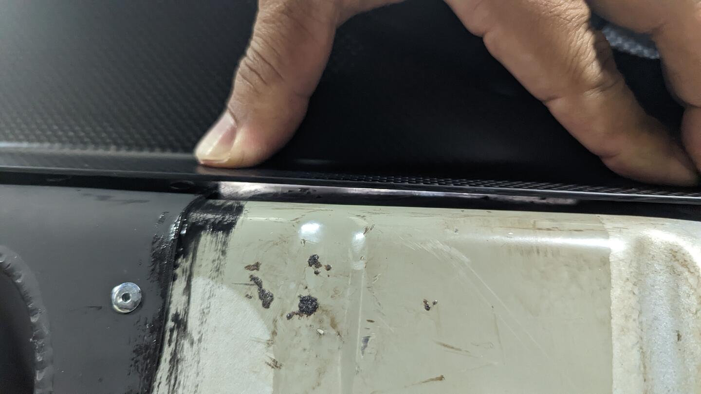

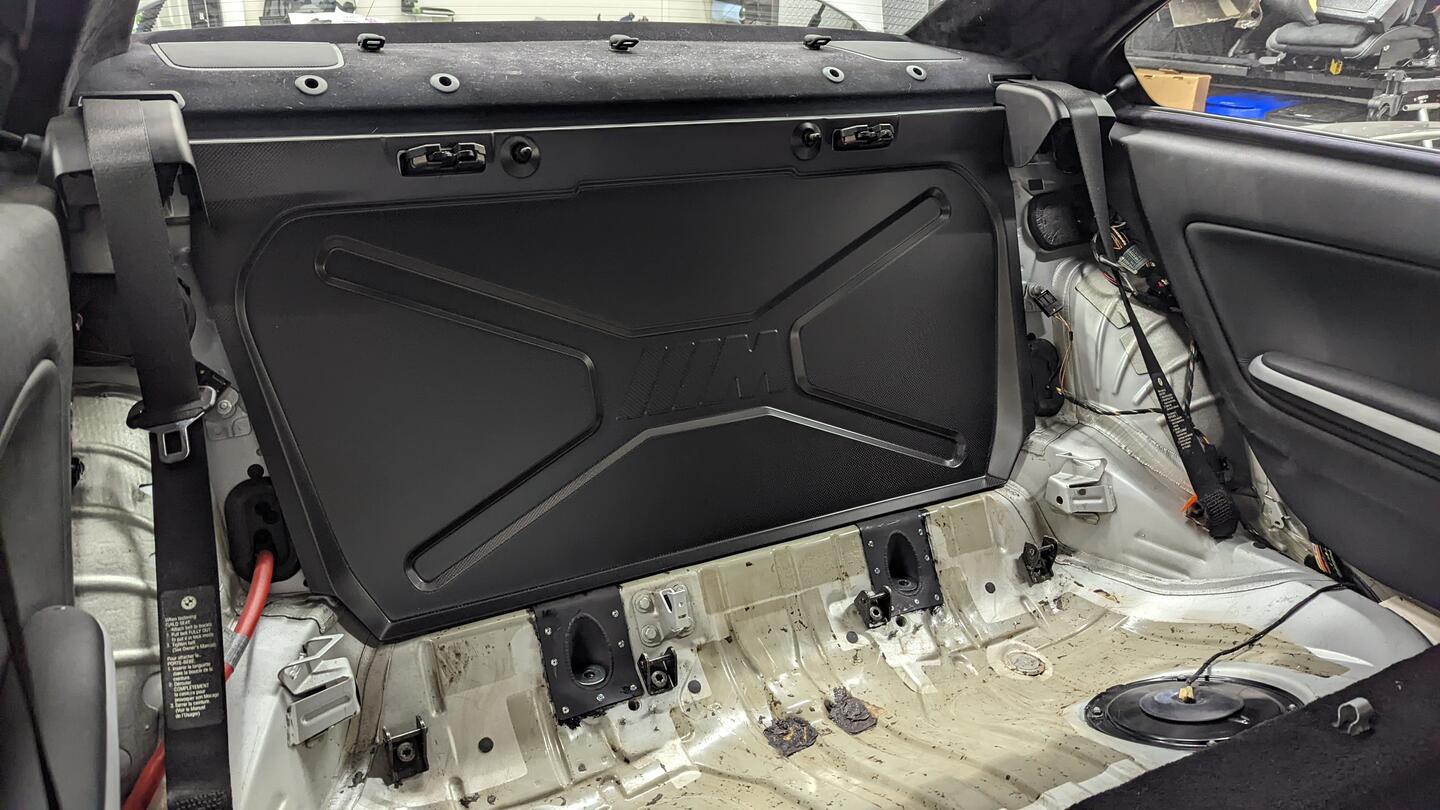

                  Finished my Vince Bar install and wanted to share how fitting is looking like. After speaking with Obioban we may need to figure out a solution with the plates being in the way causing a gap
                    Wall looks good.
                      Hmm, the rivets on the plates can definitely be ground down, as they shouldn't be contributing much once the adhesive has cured.
                      The wall still wouldn't be sitting completely flush though. Maybe the wall can be notched to go around the plates? I'm not sure if that would do anything to compromise it's structure though. Slonik any opinions?

                          Talked to Slon about this and was told NOT to cut the wall.
                          We ended up deciding the best choice is to grind down the reinforcement plates so that the gap between the wall and sheet metal is ~1mm (I measured the thickness of the plates to be 1.5mm).
                          As for adhesive choice, Sika 7888 is the adhesive BMW uses for their carbon roofs and so seems like a safe pick. I found this publication that explores the mechanical properties of this adhesive in relation to the thickness at which it is applied: https://www.researchgate.net/publication/271819313_The_Effect_of_Adhesive_Thickness_on_the_ Mechanical_Behavior_of_a_Structural_Polyurethane_A dhesive
                          Looks like the lap shear strength goes down from ~23 MPa at 0.2 mm adhesive thickness to ~20 MPa at 1 mm. Don't think the 13% decrease will be much of an issue.
                          We did consider other alternative adhesives —like Araldite 2014— but ultimately decided that Sika 7888 was the best choice. That conclusion was reached mostly because it's significantly less brittle, with elongation at the breaking point at 0.7% for the Araldite and 40% for the Sika. Araldite will be super hard, but might break under moments of high impact, which this wall will definitely see (e.g. hitting a big kerb on the track, hitting a pot hole, etc.).
                          So, my plan is to grind down the reinforcement plates so that the gap between the wall and sheet metal is ~1mm and then use Sika 7888 for the install.
