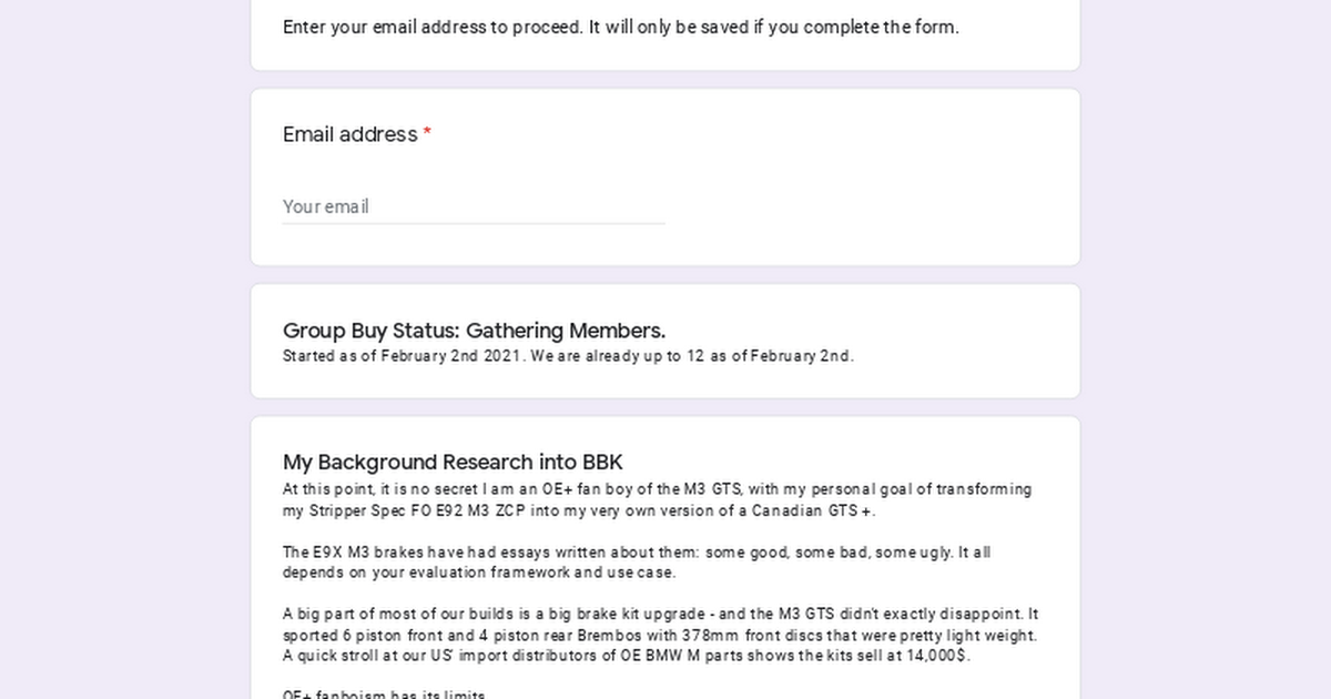

              I'm also thinking of expanding Slon's Advanced Retrofit BBK to the E46 in the current E9X GB. Let me know your thoughts!
              Details on this? Calipers, discs, pads etc? I’m in the market for brakes as well since I sold my 996 kit ...
                #52
                Welcome to the #Euroconnex by Matt @m3_epoustouflant. I'm the connect for overnighted parts from Europe for BMW M cars. Note: This GB is technical information heavy. Enter your email address to proceed. It will only be saved if you complete the form.
                Check the Advanced Kit section. Basic Kit doesn't fit E46.
                The Advanced also features the same brand new 6 piston Brembo caliper fitted with a machined and anodized bracket for easy mounting on the E9X M3 - no new spindles or hubs required.
                The Advanced Kit includes Slon's 2 piece 380mm slotted Brembo rotor. It is machined in house from Brembo blanks for usage on this caliper. All of Slon's rotors are made with the same dimensions as Brembo GT rotors.
                The replacement rotor rings will cost 730$ per pair including shipping, cheaper than Brembo's own 2 piece 380x28 mm rotors which retail at 1,445$ US at Turner Motorsport. Many of Slon's customer that were originally using the Brembo GT BBK switch to Slon's rotors and use on their kits.The complete replacement rotors with hats and rings are 1,300$ per pair.
                Note: we highly recommend you go with the optional Ferodo Racing DS2500 or equivalent quality pads. The Advanced Kit was developed with such pads in mind for street usage.
                Pad size and sweeping surface:
                - 380mm Slon 2 piece rotors you can use 57.5mm height for a nearly full sweeping coverage (60mm total)
                If you will track the car, use your preferred pads using the pad shape below:
                Front pads for 380mm 2pc:
                Rear pads for 380mm 2pc:
                https://ecat.ferodoracing.com/produc...s/code/FCP1348
