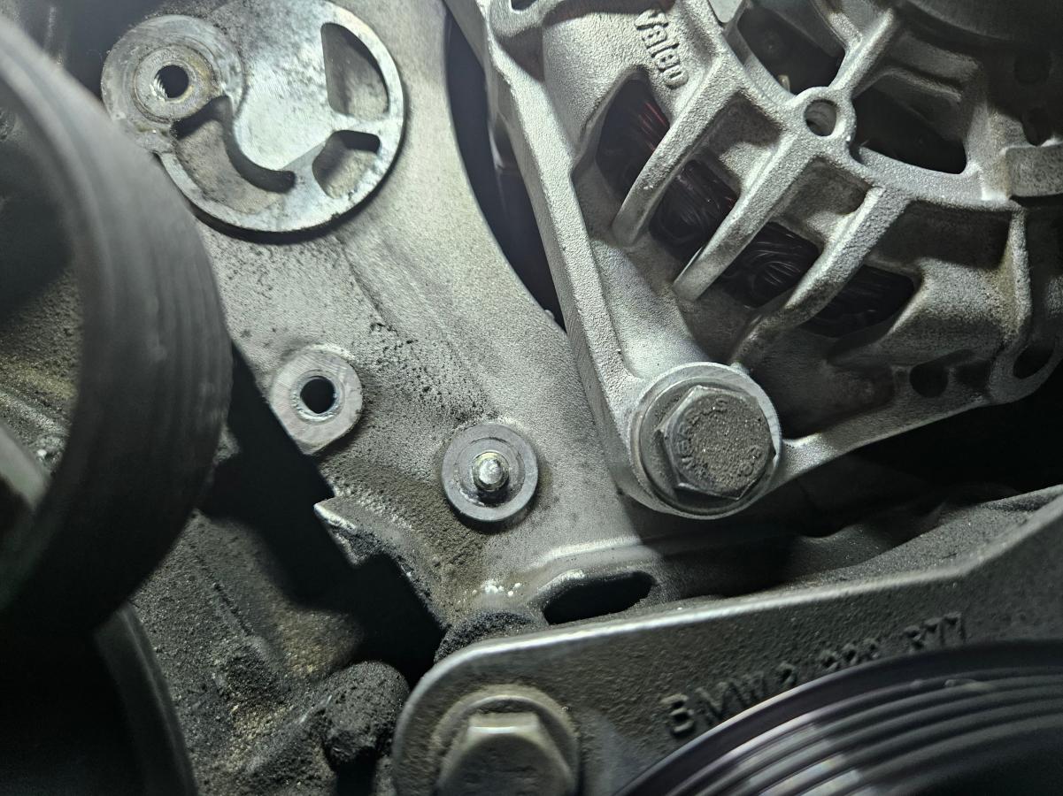

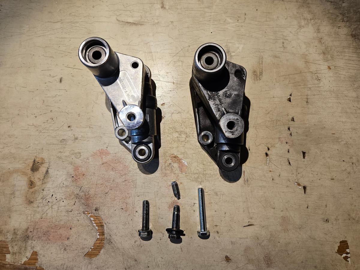

            Today, I managed to turn a 10 min job into a 2 hour one.
            Car was squeaking a bit when turning the engine off, so I decided it was time to swap the belt tensioner. Unfortunately, one of the bolts snapped when I went to remove it:
            Ignore the dirtiness. Looked mostly like old oil and grime that hadn't seen the light of day in decades. Cleaned up relatively easily.
            Anyway, there was still a bit of the bolt protruding past the oil filter housing, so I decided to try extracting with some vise grips. Sprayed some penetrating fluid then ground a flat into the threads so that there would be something to grab onto (and to get a bit of heat in the bolt).
            Fortunately, it worked!
            Replaced it with a hardware store bolt for now, but factory part is on order. Also ordered all the surrounding bolts just in case.
            Glad it was a easy fix, but also annoying to deal with. At least the belt isn't squeaking anymore!

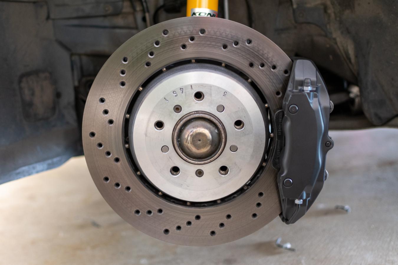

              Picked up something yesterday:
              Click image for larger version  Name:	20230818_145650.jpg Views:	165 Size:	134.3 KB ID:	229662​​​​​​​
              Finish is Cerakote Arctic Black P-202. Supposedly designed to help dissipate heat. https://www.cerakote.com/shop/cerako...lack-oven-cure
              Now just need to find some time to rebuild them and get them on the car.

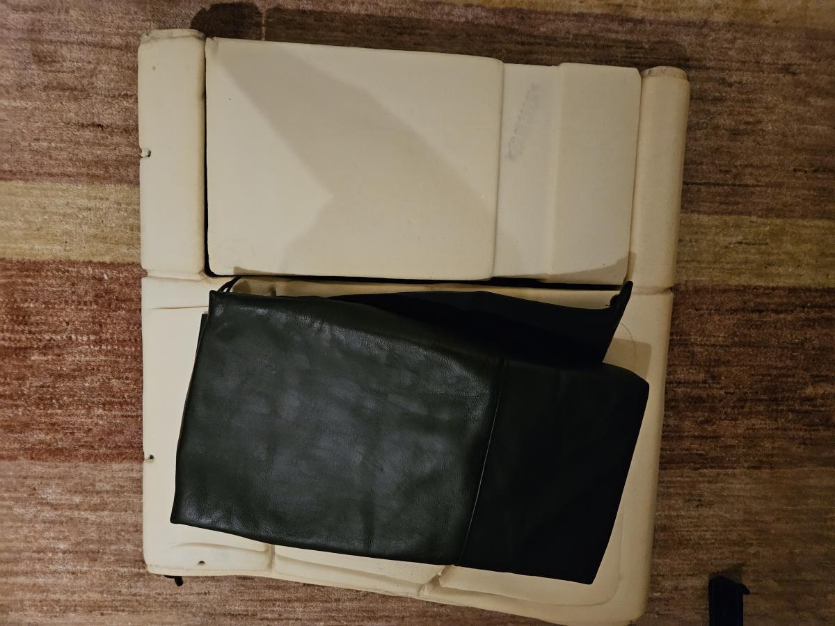

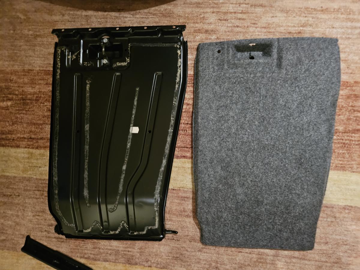

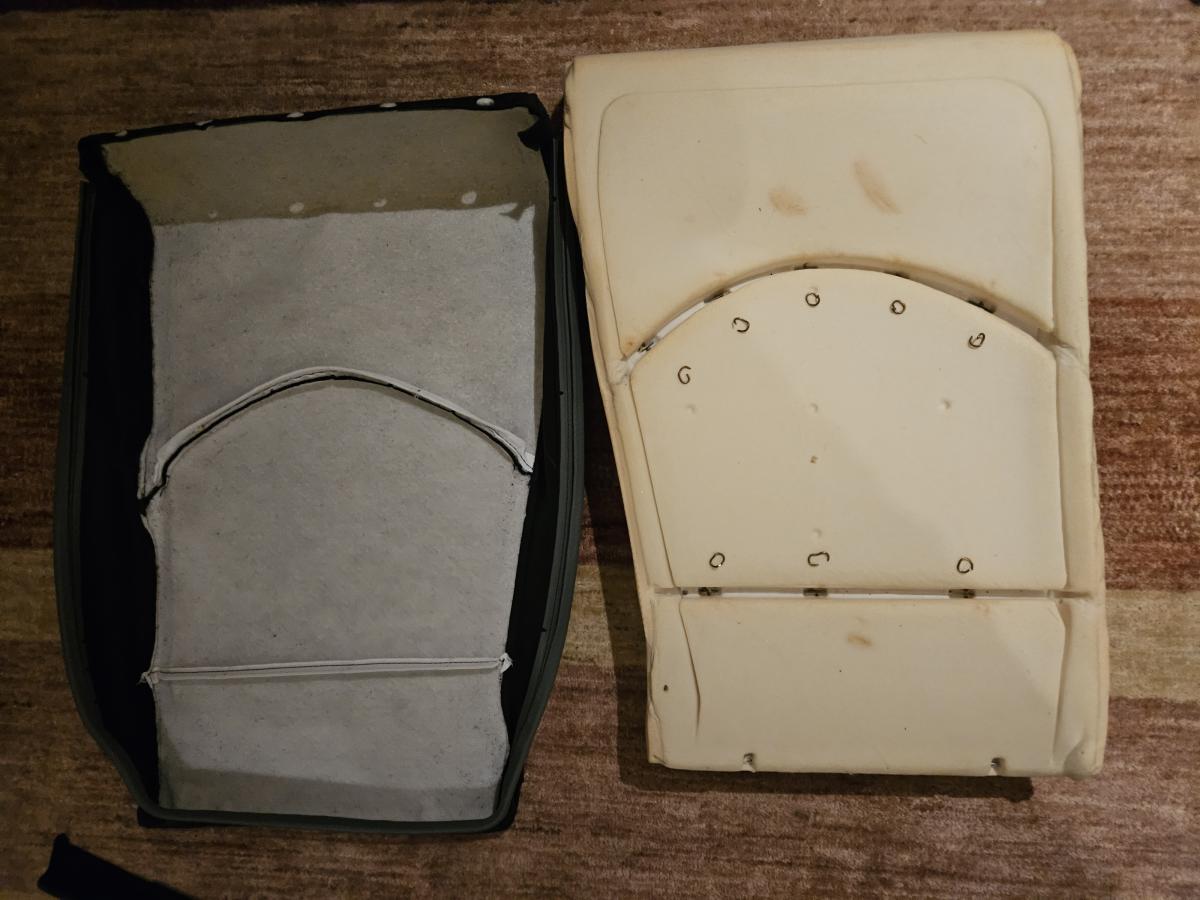

                            Speaking of the rear wall, I've had an idea for losing a decent chunk of weight for a while that was infeasible until I finished up that install.
                            The rear seat backs are pretty heavy due to the metal frames in them and I figured it wouldn't be too hard to make them lighter. However, without the wall, there would be very little to attach the frameless seats to, so I hadn't given this project a shot until now.
                            I picked up a spare set of seat backs to practice on and took them apart. Haven't gotten past that, but figured I'd document it for when I do this on my actual seats.

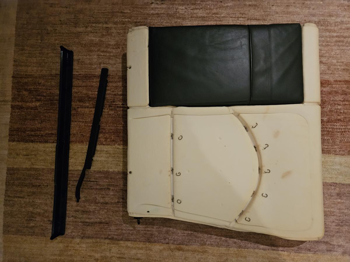

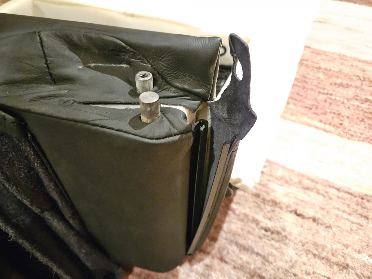

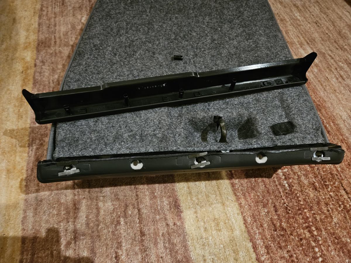

                            Started with the smaller one and removed the top plastic trim by pulling straight out:
                            Click image for larger version  Name:	20230905_201012.jpg Views:	2 Size:	212.5 KB ID:	232409

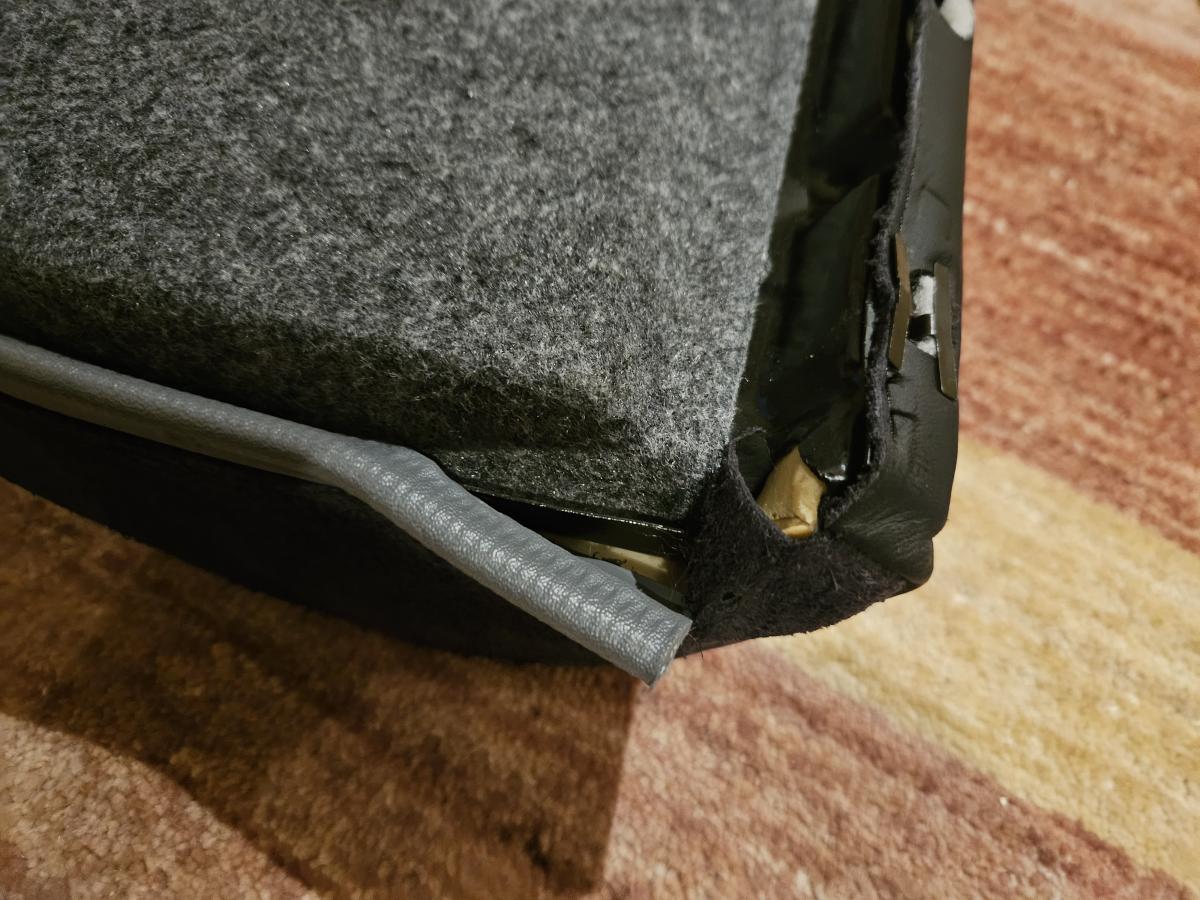

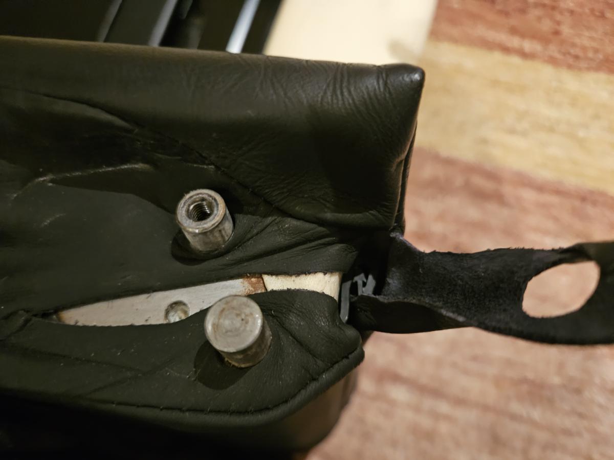

                            Then went around and pried this retainer off of the metal frame. It's stitched onto the leather, so once it's free, the leather is too:
                            Click image for larger version  Name:	20230905_201139.jpg Views:	2 Size:	148.1 KB ID:	232410
                            With that all pried up, the leather and foam are almost free. There's one T50 torx bolt at the bottom that needs to come out and then you can separate them:
                            Click image for larger version  Name:	20230905_202551.jpg Views:	2 Size:	173.5 KB ID:	232411
                            Click image for larger version  Name:	20230905_202554.jpg Views:	2 Size:	131.3 KB ID:	232412
                            Click image for larger version  Name:	20230905_202827.jpg Views:	2 Size:	146.5 KB ID:	232413

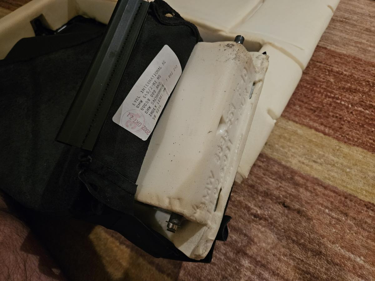

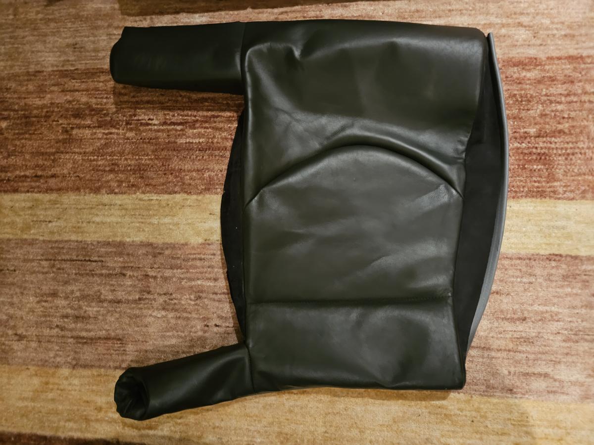

                            Leather is held onto the foam with some hog rings:
                            Click image for larger version  Name:	20230905_203417.jpg Views:	2 Size:	102.4 KB ID:	232414

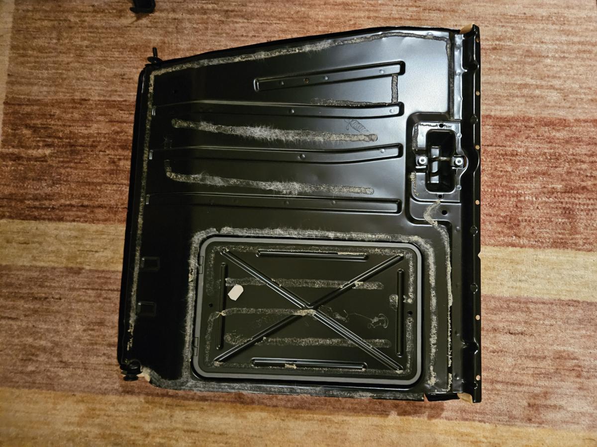

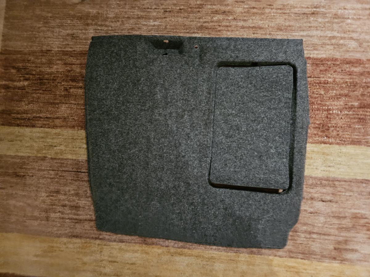

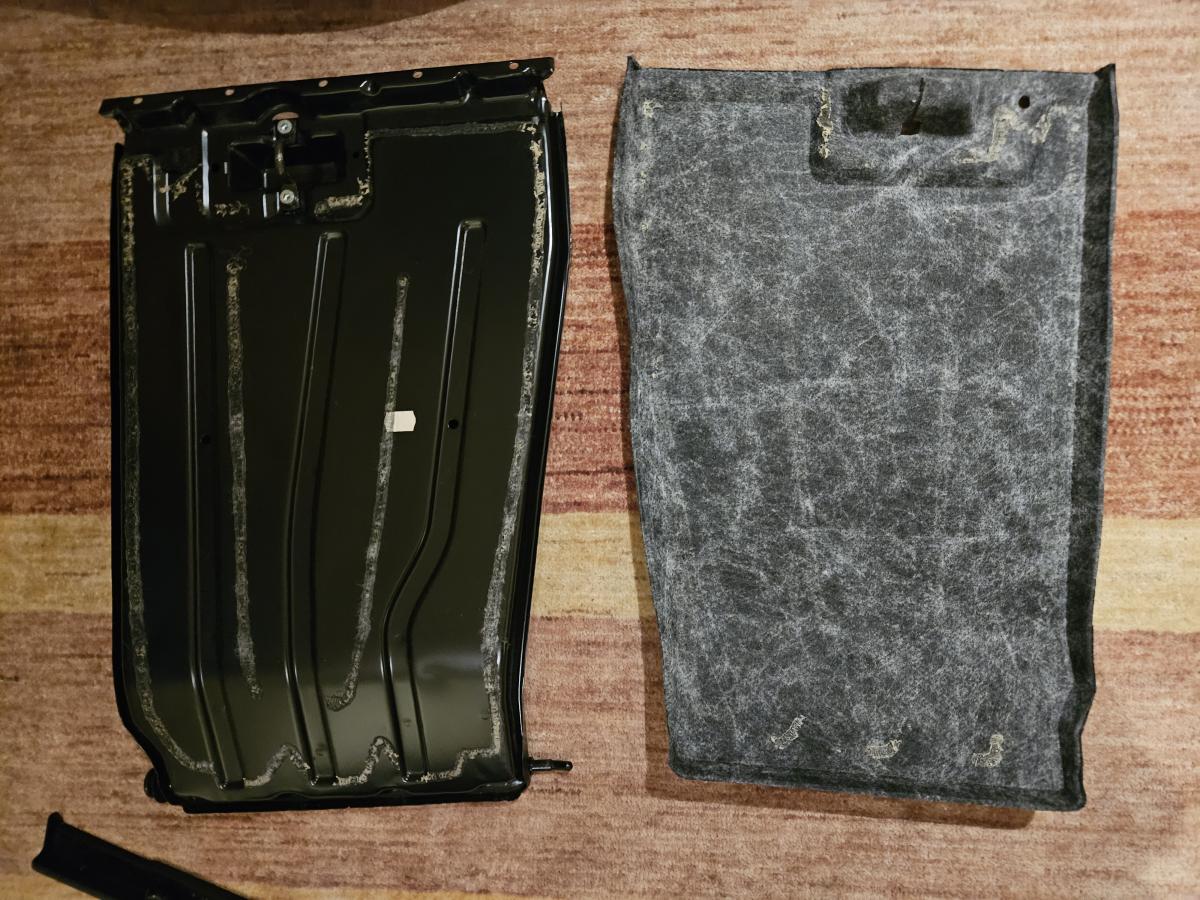

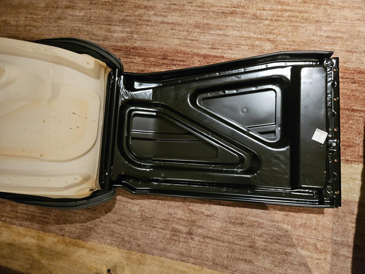

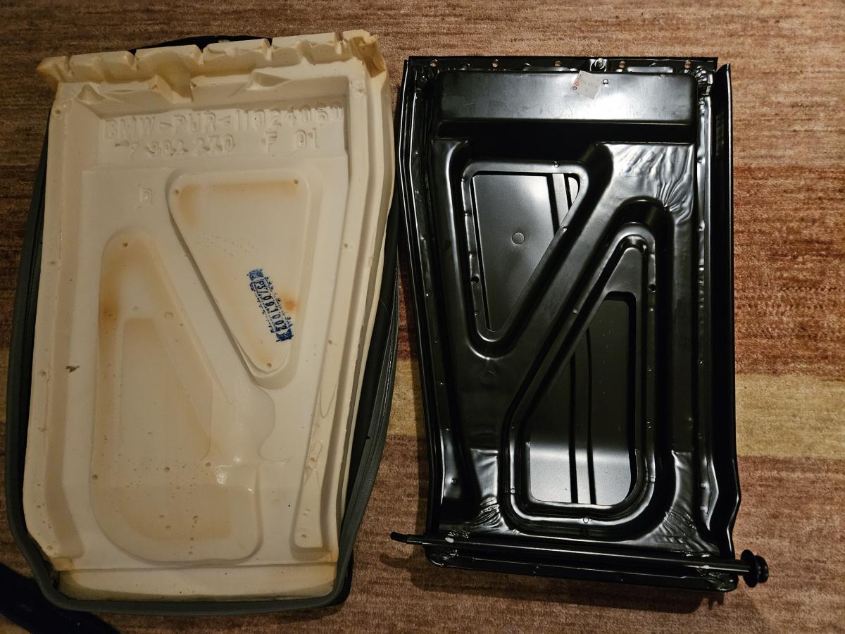

                            And that grey carpet material is just glued onto the metal frame. Pretty easy to pull apart:
                            Click image for larger version  Name:	20230905_203558.jpg Views:	2 Size:	165.7 KB ID:	232415
                            Click image for larger version  Name:	20230905_203605.jpg Views:	2 Size:	194.6 KB ID:	232416

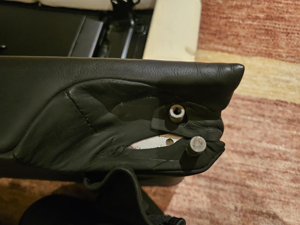

                            Disassembly of the larger seat back is mostly the same. First the plastic trim comes off, then the leather is pried away from the metal frame and finally the leather is detached from the foam by removing the hog rings:
                            Click image for larger version  Name:	20230905_205442.jpg Views:	2 Size:	118.9 KB ID:	232417
                            Click image for larger version  Name:	20230905_205527.jpg Views:	2 Size:	133.8 KB ID:	232418

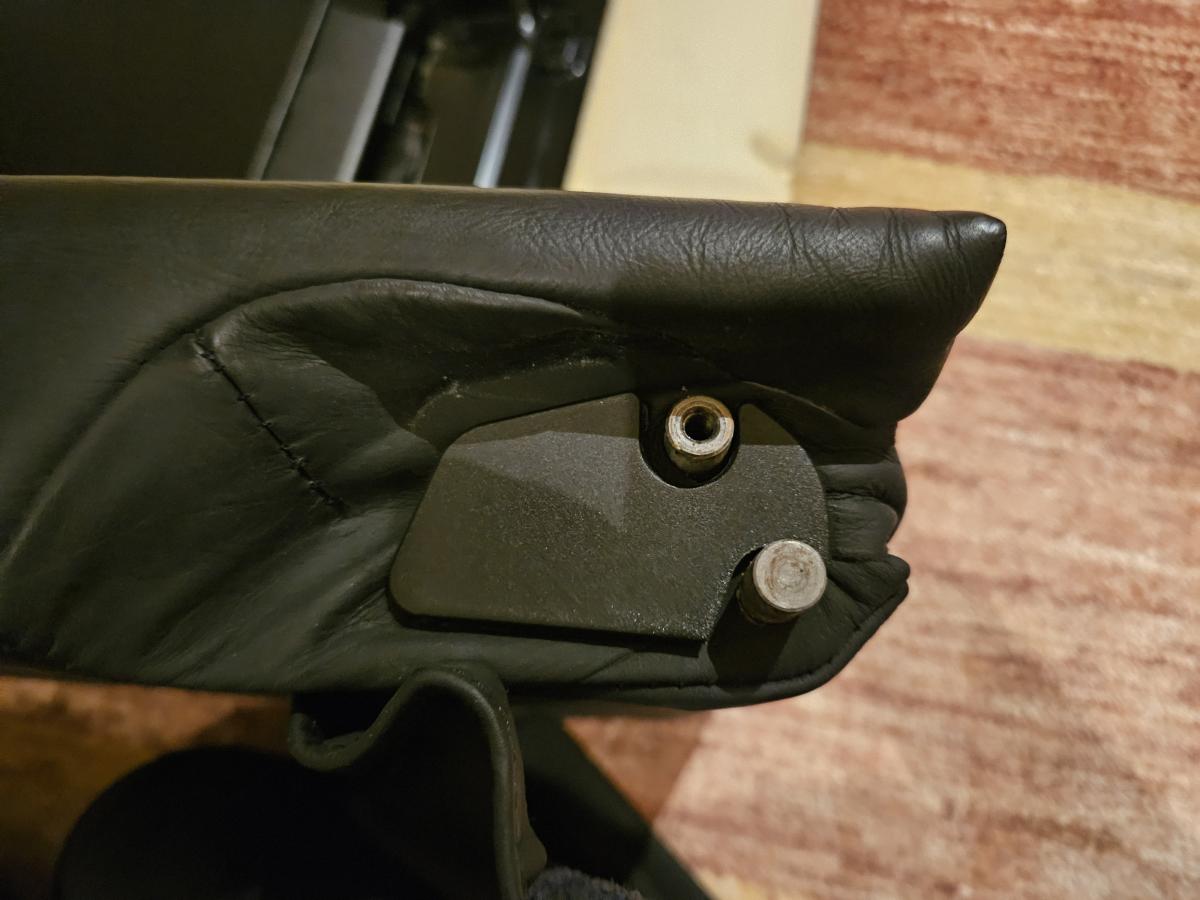

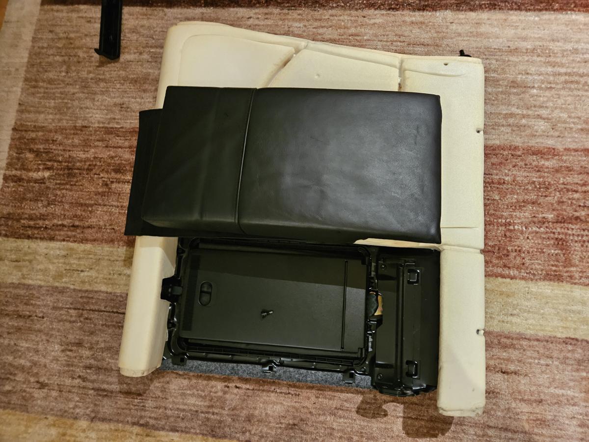

                            Armrest assembly is held in with one T30 bolt:
                            Click image for larger version  Name:	20230905_210142.jpg Views:	2 Size:	154.0 KB ID:	232419
                            Couple plastic trim pieces to remove, couple leather flaps to undo and one long plastic "clip" to separate and then the leather can come off:
                            Click image for larger version  Name:	20230905_210207.jpg Views:	2 Size:	85.6 KB ID:	232420
                            Click image for larger version  Name:	20230905_210213.jpg Views:	2 Size:	86.0 KB ID:	232421
                            Click image for larger version  Name:	20230905_210316.jpg Views:	2 Size:	69.6 KB ID:	232422
                            Click image for larger version  Name:	20230905_210430.jpg Views:	2 Size:	100.3 KB ID:	232423
                            Click image for larger version  Name:	20230905_210539.jpg Views:	2 Size:	106.7 KB ID:	232424
                            Click image for larger version  Name:	20230905_210853.jpg Views:	2 Size:	126.1 KB ID:	232425

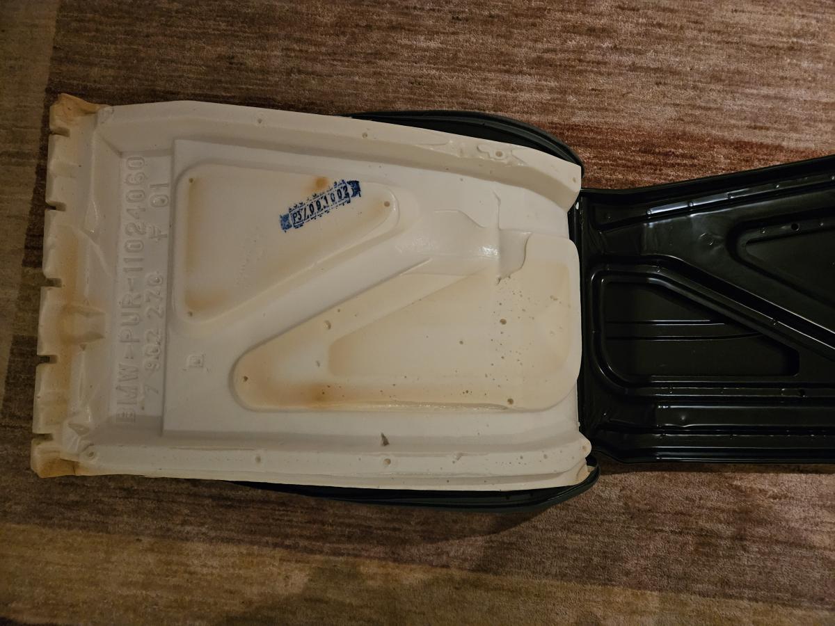

                            And once again, that grey stuff is just glued on and easily removed:
                            Click image for larger version  Name:	20230905_211159.jpg Views:	2 Size:	178.3 KB ID:	232426
                            Click image for larger version  Name:	20230905_211238.jpg Views:	2 Size:	183.0 KB ID:	232427
                            With everything apart, I weighed all the individual pieces. Here are the results:
                            Small Leather 1.3 lbs
                            Large Leather 2.2 lbs
                            Armrest Leather 0.9 lbs
                            Small Foam 1.8 lbs
                            Large Foam 2.3 lbs
                            Armrest Foam 1.2 lbs
                            Small Metal Frame 7.9 lbs
                            Large Metal Frame 16.3 lbs
                            Armrest Metal Frame 1.9 lbs
                            Now comes the question of what I want to remove. I think I've decided that I'm going to keep the leather, foam and grey carpet pieces. Previous experience with folding the seats down tells me that the foam is doing a ton of work to keep cabin noise down, so if I replace it with some lighter stuff, I'll likely need to add some sound deadening in. I doubt that I can get some other foam and sound deadening to weigh less than 4 lbs, so I'll just keep the OEM stuff. Plus, that means the cushions will be stuffed with the factory preformed foam and not something I hacked together in the garage. Should keep them looking exactly the same as before.
                            Next question is how to mount the seats back in the car with the frame gone. This is where those grey bits come in. I plan to sew some heavy duty velcro strips along the top of them and then glue the carpet + velcro assembly to the foam. Will probably also sew some velcro strips onto the sides of the leather to be able to velcro both seat backs together.
                            Last thing to consider is the armrest. This will likely need to be stuffed with some other foam. I'll try to separate the armrest foam from the armrest frame, but it didn't seem trivial. No big deal if I have to buy something to stuff it with though, as it's just a rectangular prism.
                            Final weight savings to be seen, but should be around 26 lbs. Not bad!
