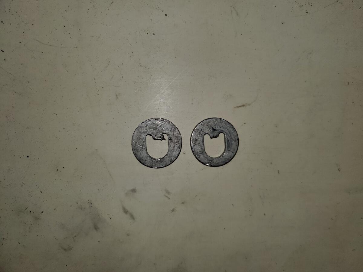

      Got a call in the middle of my alignment about an issue with the rear camber. Turns out I managed to somehow destroy the eccentric washers that set it:
      Not entirely sure how I managed to do this? Guess I wasn't paying enough attention and sheared both tabs off when torquing. Fortunately, these were new parts and the old ones weren't in bad shape. So I just went down with the old ones and the tech was able to complete the alignment.
      As expected, the rear camber was out of spec because of the CMP bushings. Maxed out at -0.5° so I guess I'm doing springs soon. Will probably go with Dinan springs for now, but I'm not sure if the drop will be enough to get the rear camber where I want it. Guess I'm going to have to go measure a bunch of stuff and do some trig. I'd rather avoid camber arms because I like that the stock arms are designed to bend in case of an impact (and also because I really don't want to torque that front diff bolt again).
      Also did some quick math with the Dinan springs and those would leave me with about 17mm clearance from the road when backing into the garage. Not ideal but not terrible.

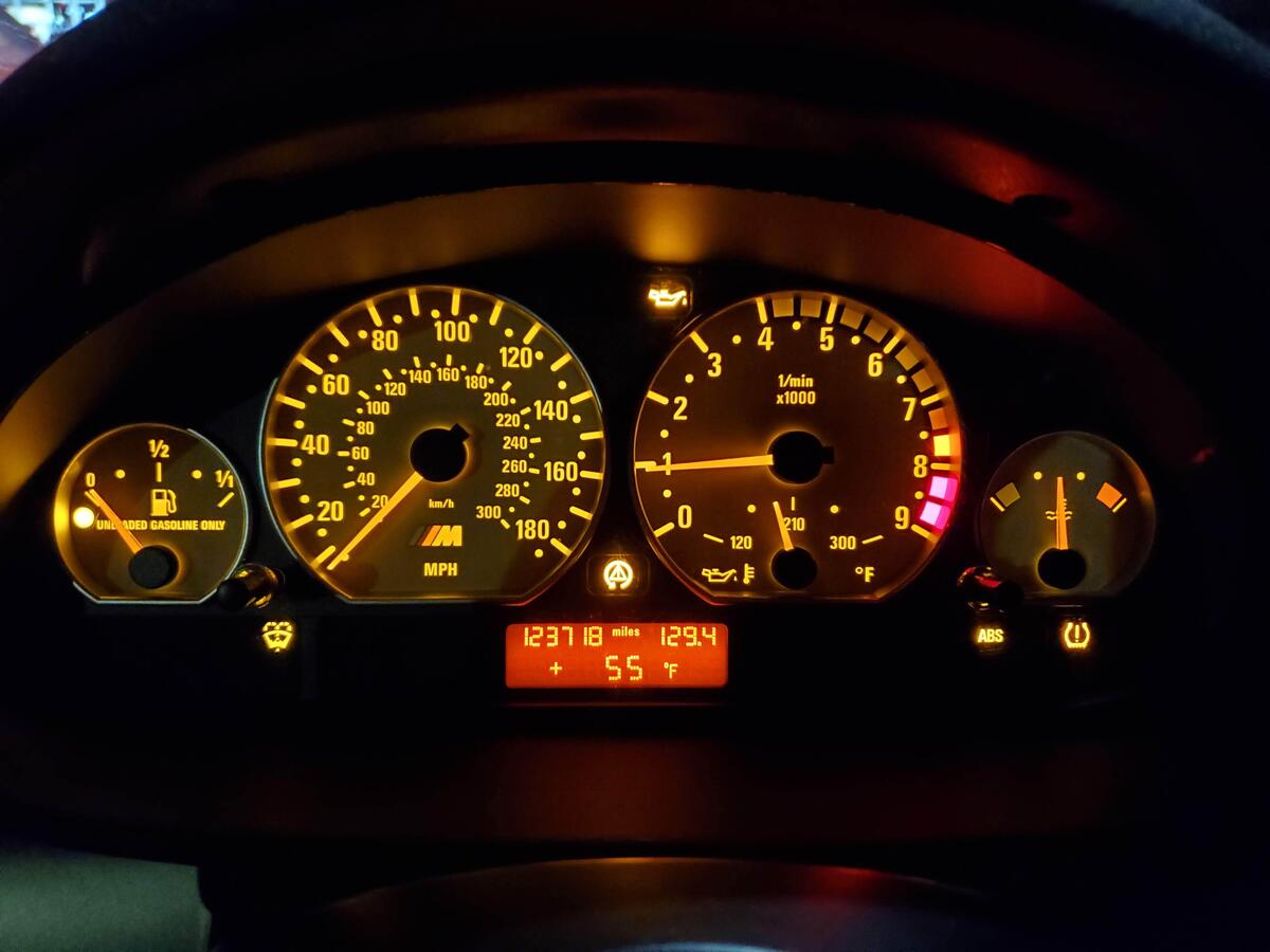

            Finally took the car on a real test drive. This is what the cluster looked like at the end of it lol.

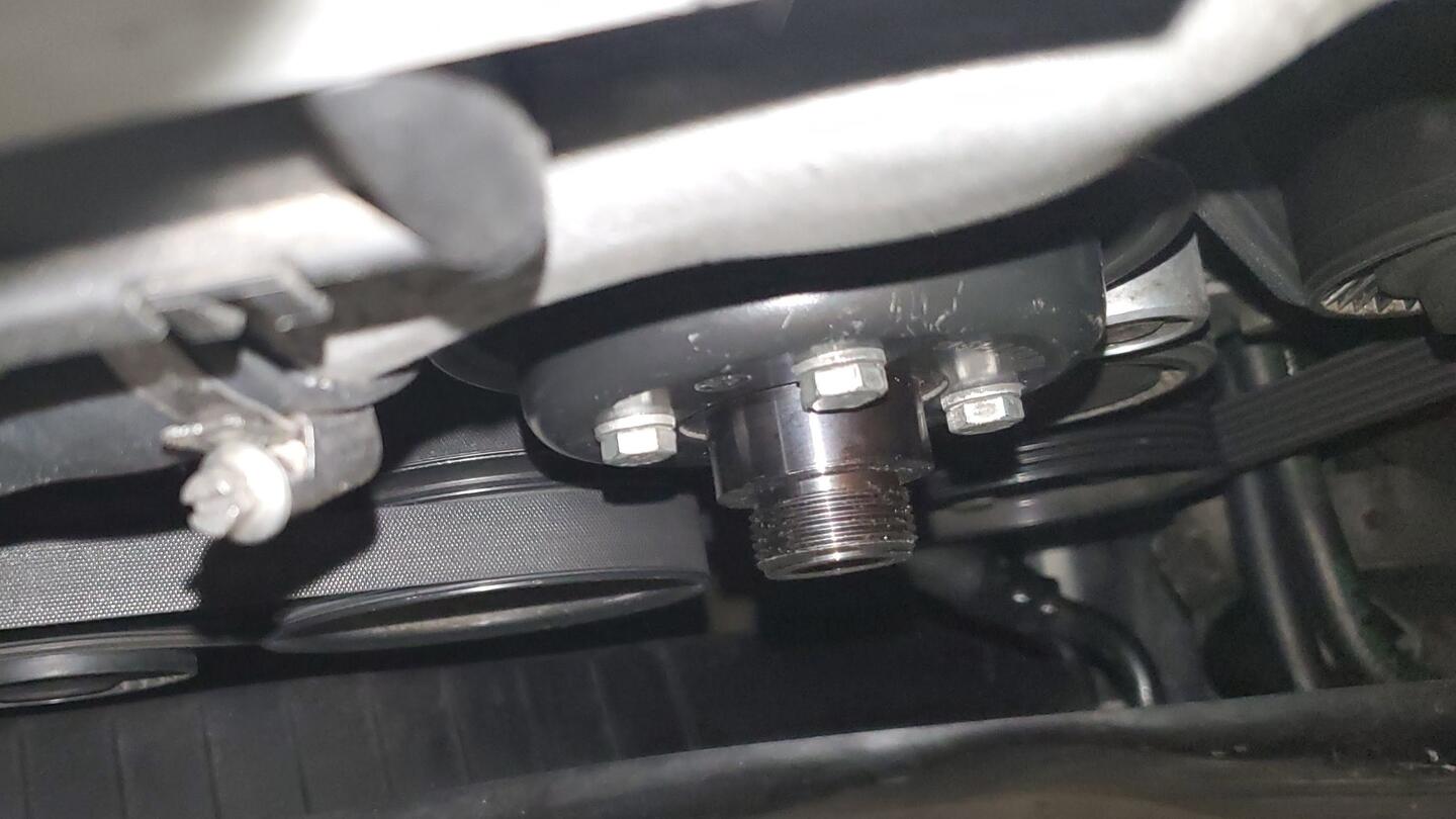

            Checked the oil and it was about 2 mm below the max fill line. This erroneous warning has happened before, but lately that yellow oil light has been turning on more frequently and the oil is never actually low. I'm guessing the sensor is going bad so I'll replace that next time I change my oil. I've also read that the CSL software expects more oil in the engine vs the regular US software, so that could be contributing as well.

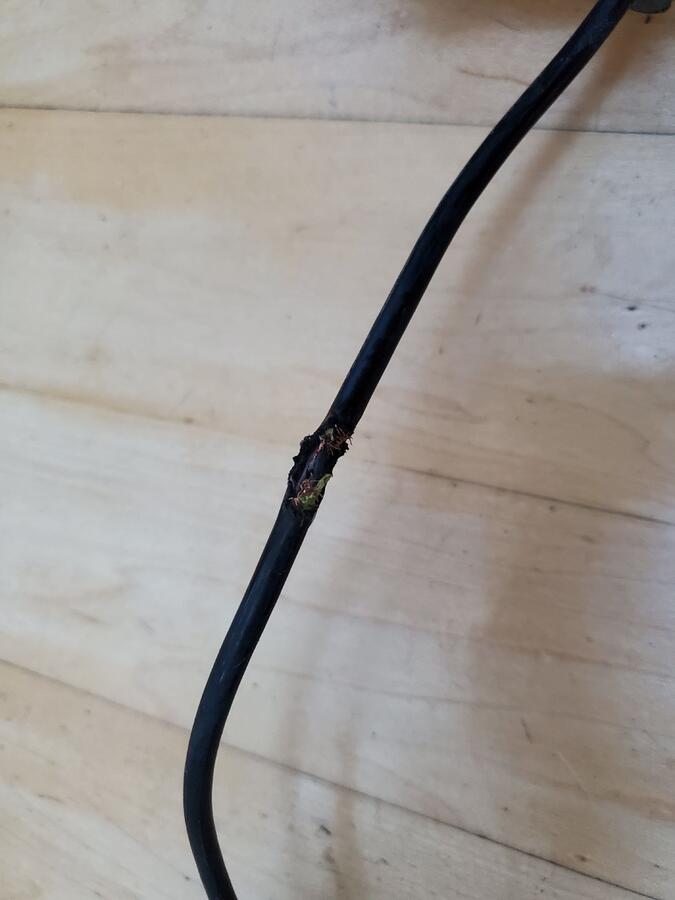

            The ABS lights turned out to be caused by this:

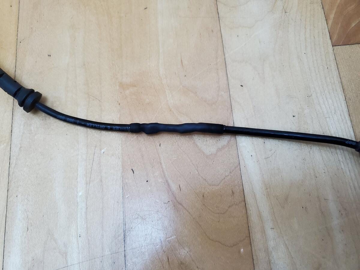

            Turns out I pinched the cable with the shock pinch bolt (appropriate) and caused a short. I cut off the damaged section, soldered everything back together, wrapped each individual wire in heat shrink, and then wrapped the whole thing in that heat shrink that has glue inside in an effort to make it as water proof as possible.
            Buuut then I got sketched out thinking that some water might be able to find its way in and mess with the sensor readings. Not sure how the DSC module would respond to messed up readings, but I'd rather not find out in case it gets confused and does something that might cause an accident. So I ordered a new OE sensor and swapped that one in.

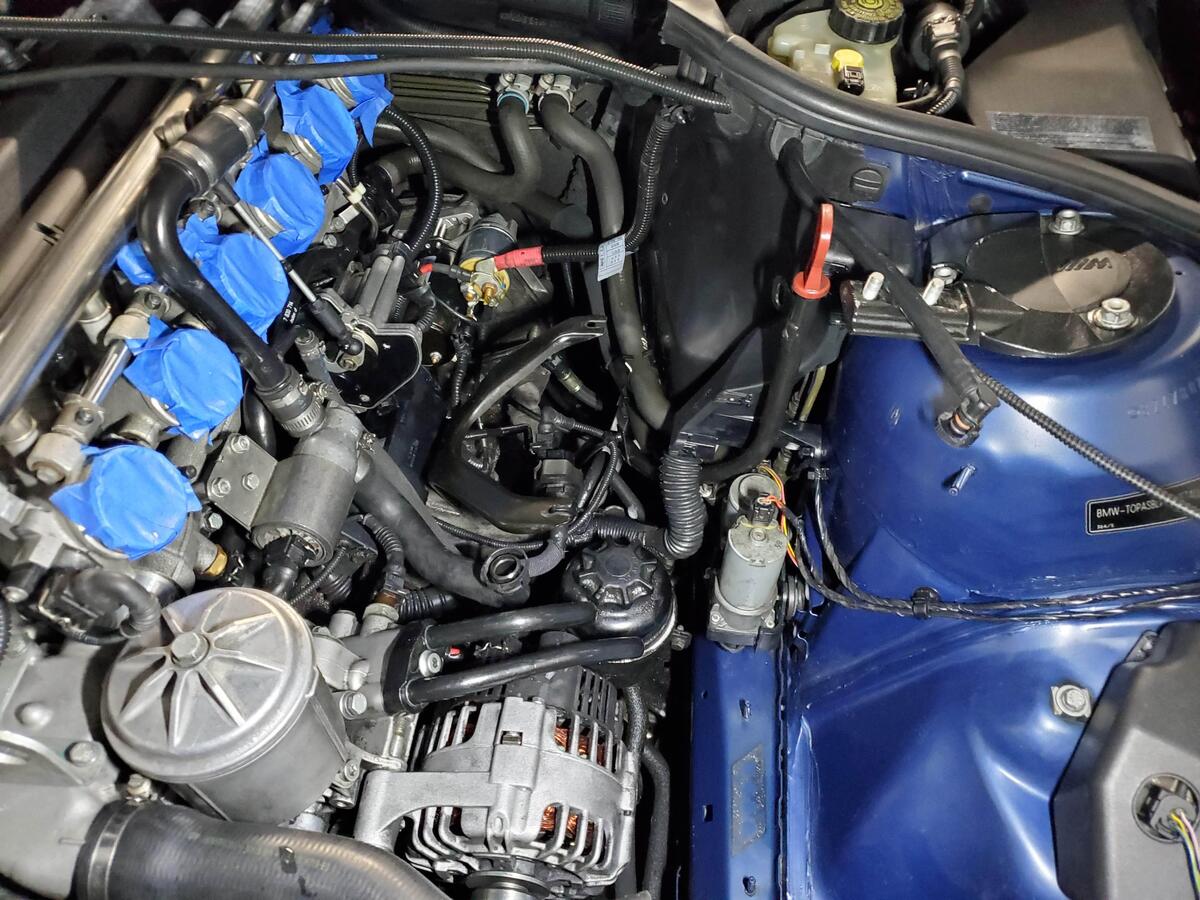

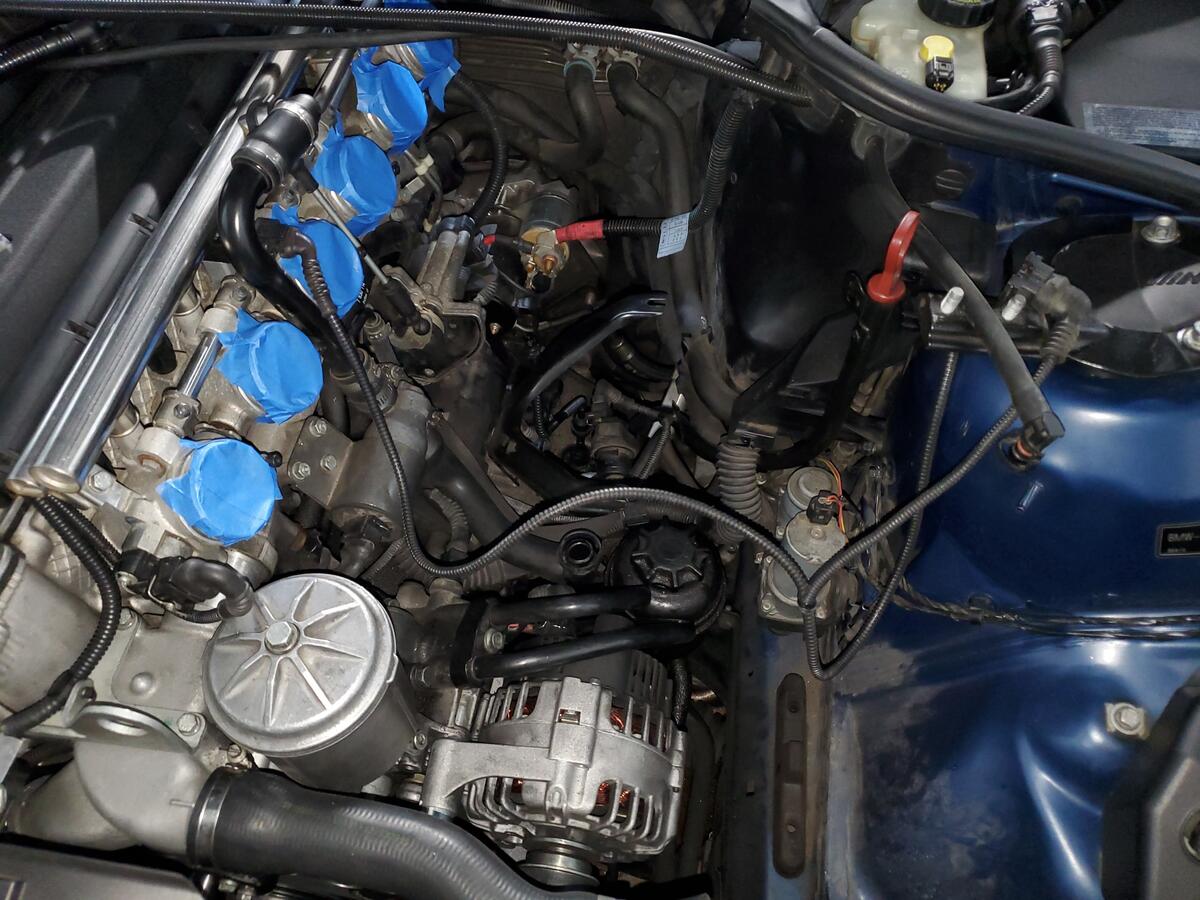

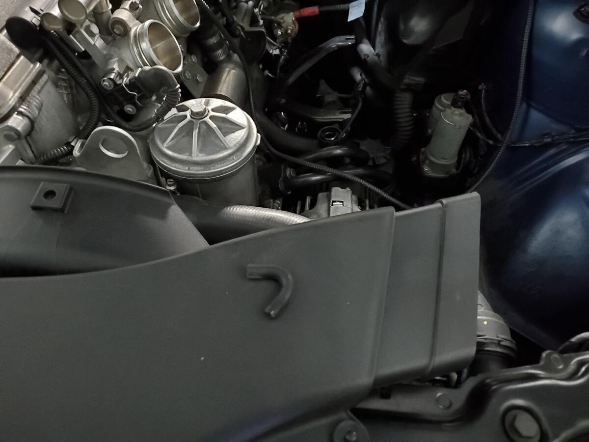

              I also decided to remove my AFD flex fuel kit. I barely run ethanol anymore since the car sits all week and I'd rather not have water get into the fuel. Once I start doing all the typical power mods (cams, full exhaust, etc.), I'll get bigger injectors and a tune for everything. With those on the car, I can decide how I want to approach the E85 thing. Might move away from the AFD kit or put it back on. Regardless, I do want to run E85 again in the future, so I'll just keep the kit in storage in case I do end up putting it back on.

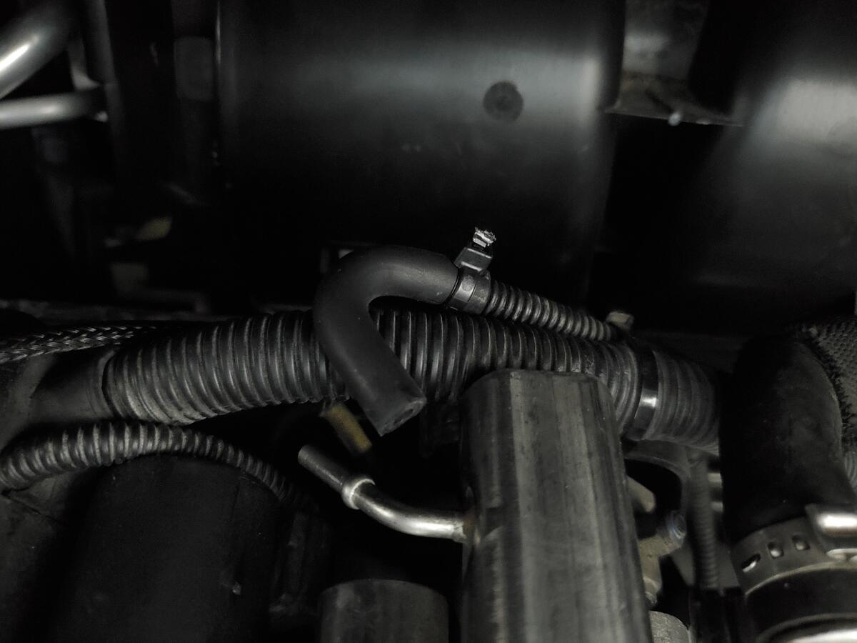

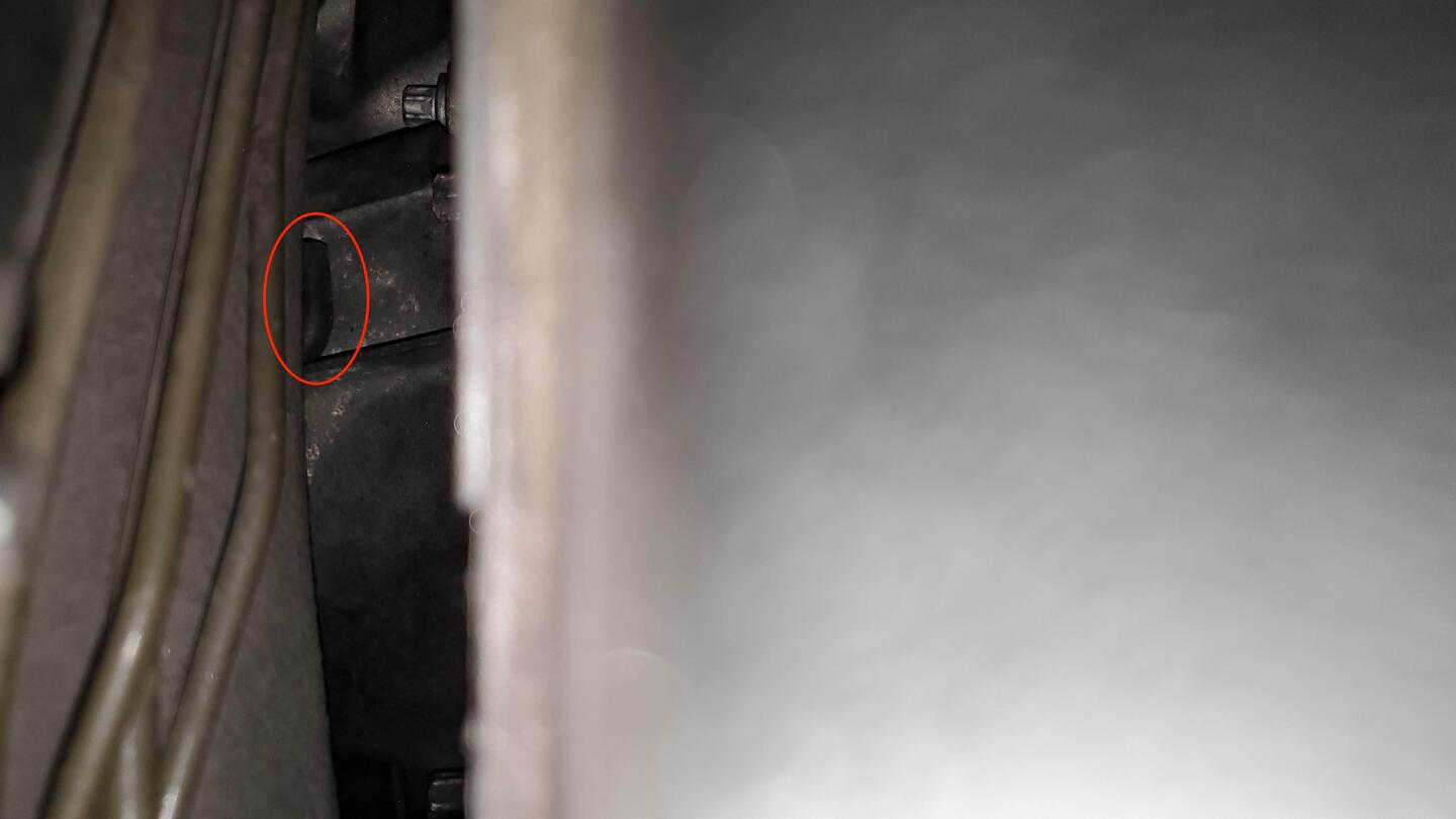

              When plugging the injector harness back in, I accidentally bumped the vacuum line that goes to the fuel pressure regulator. Accidentally pulled it off completely when reseating it and set off the alarm on the car shortly after (must have happened from me leaning against the car with the key in my pocket). Needless to say, I dropped the line onto the bell housing.
              Click image for larger version  Name:	20201231_134621.jpg Views:	56 Size:	46.0 KB ID:	76401
              The rear of the engine is to the right, firewall to the left and the circled thing is the line. Ended up having to take the intake off to retrieve it.
              Click image for larger version  Name:	20201231_144505.jpg Views:	47 Size:	87.1 KB ID:	76402
              It's now ziptied in lol. Don't want to drop that thing again.
              Click image for larger version  Name:	20201231_144750.jpg Views:	47 Size:	70.5 KB ID:	76403
              The good thing about this was that it made me realize that the bracket on the bottom of the intake was loose. One of the bolts was gone completely and the other was held in only by a few threads. They must have backed out from the vibrations of the engine. I found a new bolt that fit and put both of them back in with some threadlocker. Hopefully they won't go anywhere now.

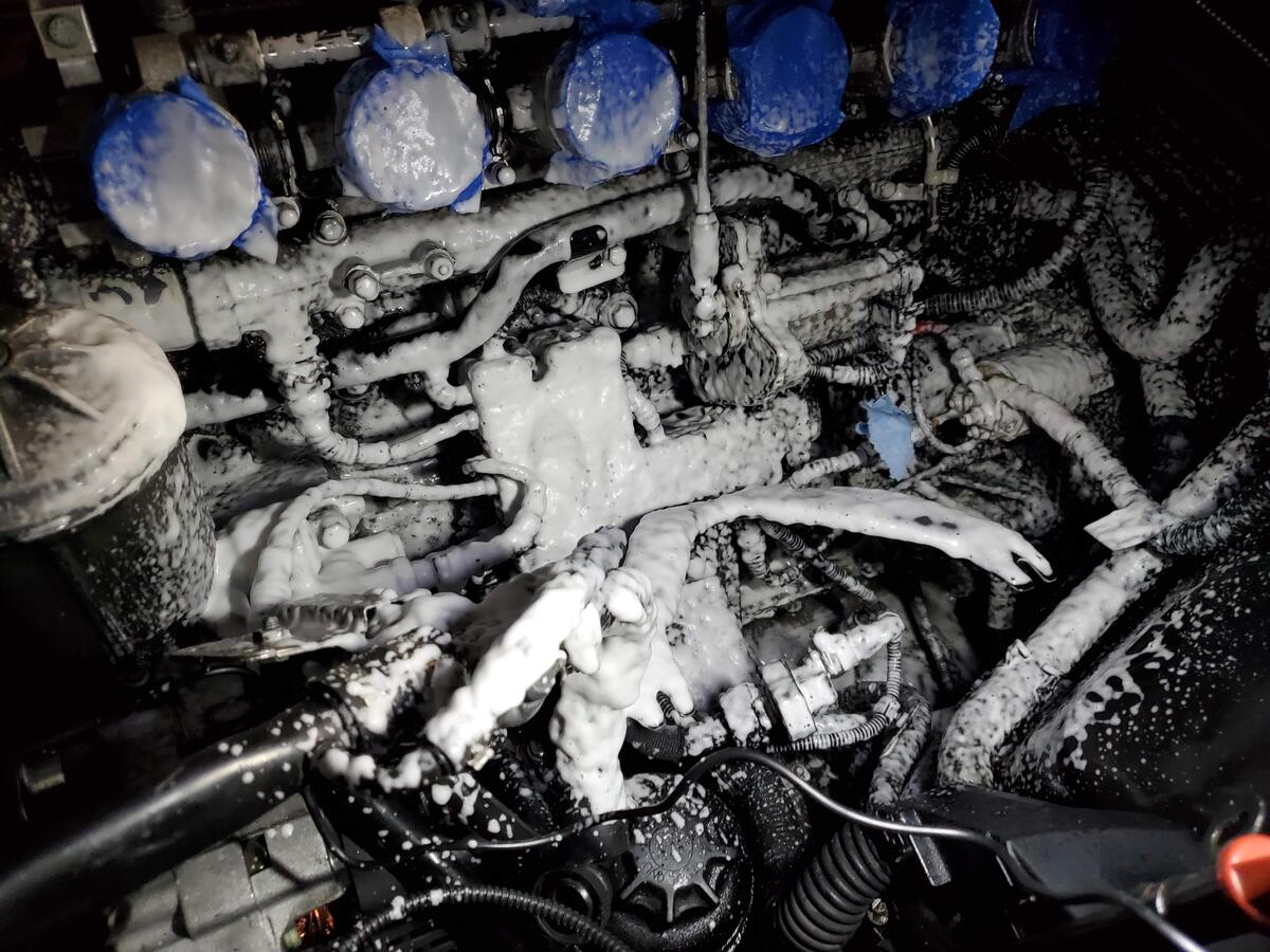

                Old oil leaks and this new power steering leak had made things under the intake pretty disgusting:
                Click image for larger version  Name:	20210109_183326.jpg Views:	0 Size:	157.1 KB ID:	83231
                Click image for larger version  Name:	20210109_184118.jpg Views:	0 Size:	237.1 KB ID:	83233
                Took this opportunity to get everything cleaned up (didn't bother cleaning the power steering reservoir since that was going to get swapped out):

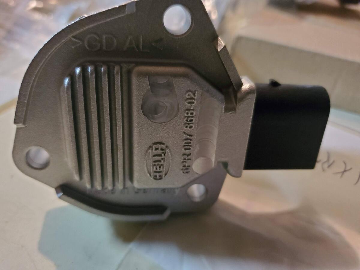

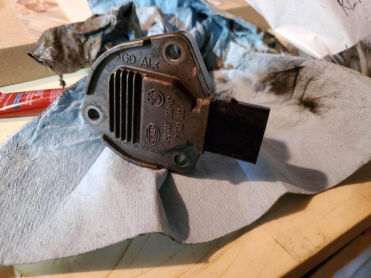

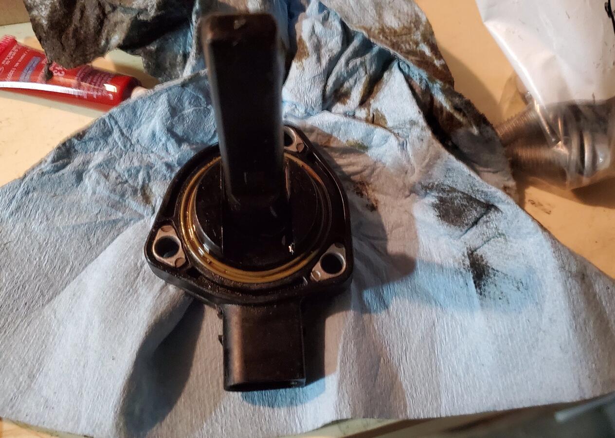

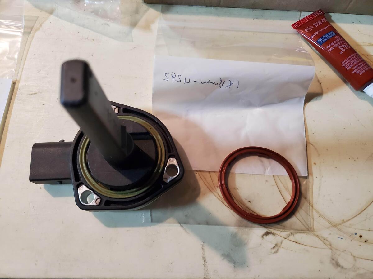

                            Did a couple things over the past couple weekends. First up: oil change.
                            Nothing too exciting here, but I did replace the engine oil level sensor at the same time since I was getting the yellow oil light with the level reading at full on the dipstick. So far I haven't seen the light again. Always hilarious to see the BMW logo milled off of parts that you can get for 1/3 of the price.
                            Genuine (old sensor):
                            Hella:
                            I wasn't sure if the seal was included with the sensor, so I also ordered the genuine BMW seal. Turns out the Hella sensor does come with a seal, but it came with a green one while the BMW one was red.
                            Swapped out the seal since I already had the BMW one, but I also kept the Hella one just in case. When I took off the old sensor, it had a green seal on it. Oh well, if there's any leaks I'll just swap the green seal back in on the next oil change.

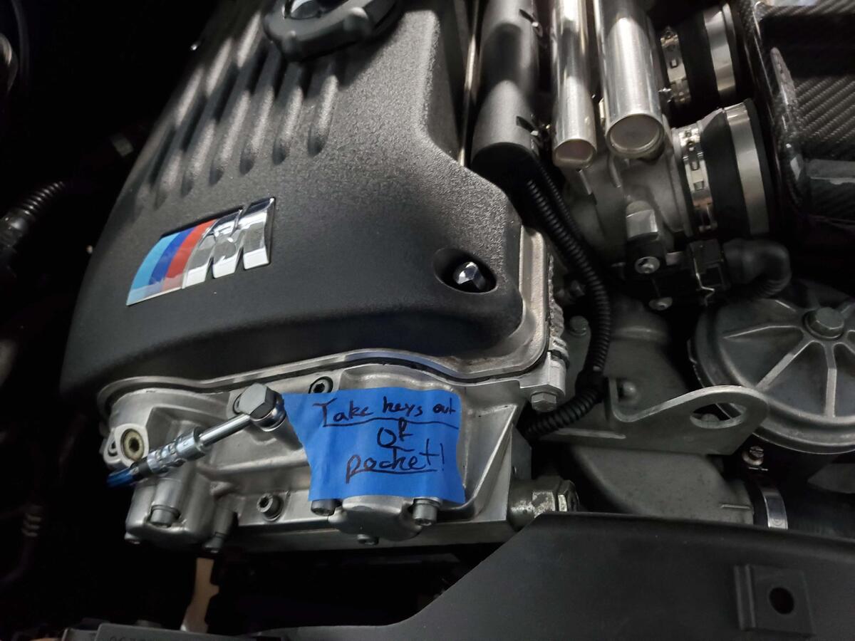

                            After what happened last time, I didn't want to set off the alarm accidentally again and drop something into the engine.
                            Valve adjustment went smoothly, found 10 out of 24 valves out of spec (!). Most of them were 0.001-0.003" under spec. I was honestly surprised that so many were out of spec, given that I had adjusted them about 20k mi ago. I did move across the country though so maybe temperature differences played a role? Regardless, managed to get them all in spec. Topside of the engine is significantly less clicky between 1-3k rpm now (any clicking noises get drowned out above that by the airbox/exhaust).

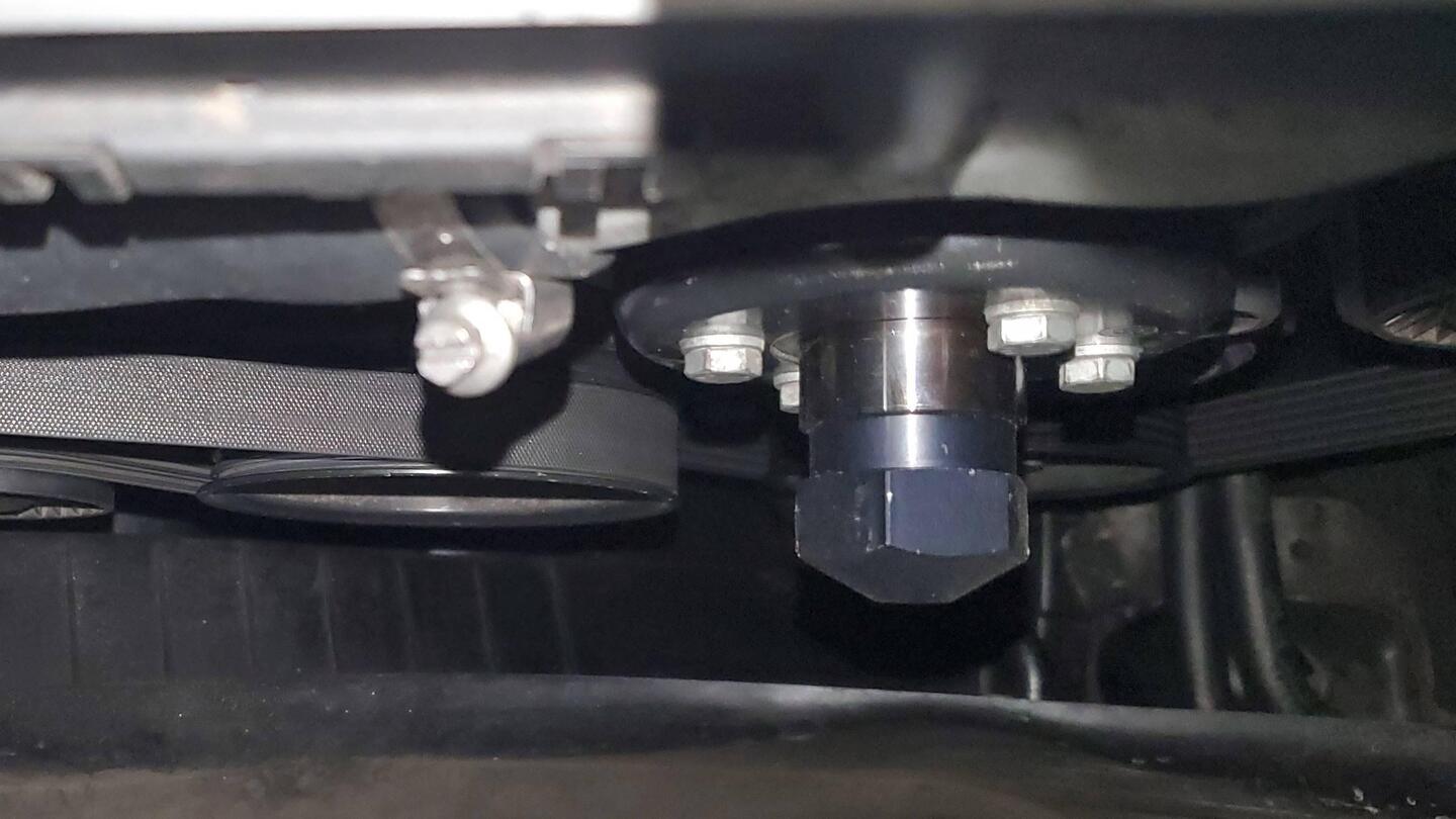

                            I then spent a tooon of time trying to get my engine timed perfectly. Probably spun the engine by hand thirty times and the timing pin slid perfectly into the cams on both sides every single time. Reset adaptations before the first start and re-checked them yesterday (I've driven the car a few times since). Intake cam is pretty much dead on, but exhaust was at something like -4°. Ah whatever, it's within spec.
                            Also added the BMW fan delete nut on the oil pump since I don't run the mechanical fan.

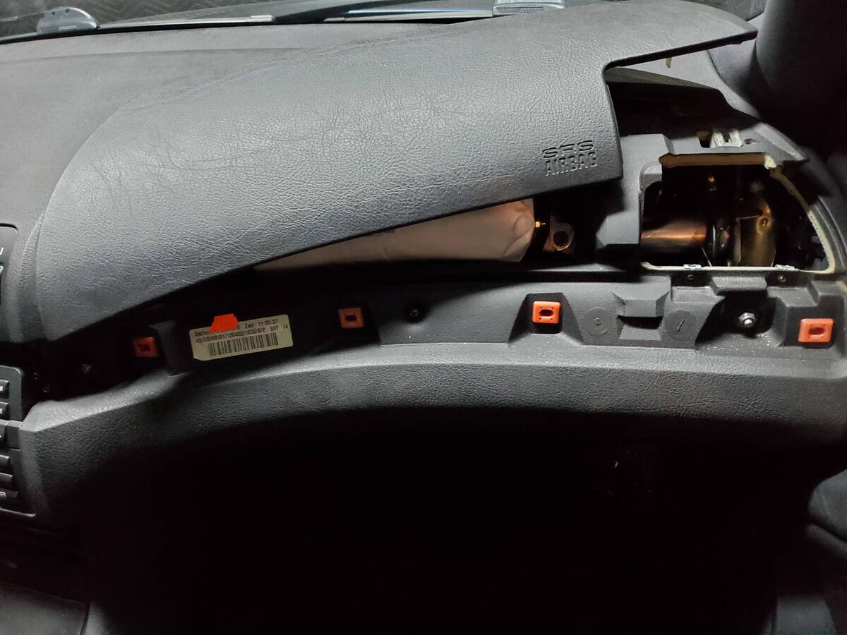

                            Last thing I did was get the car ready for the airbag recall. A mobile tech is scheduled to perform it tomorrow, but I wanted to be sure that none of my interior got damaged, so I took everything apart myself:

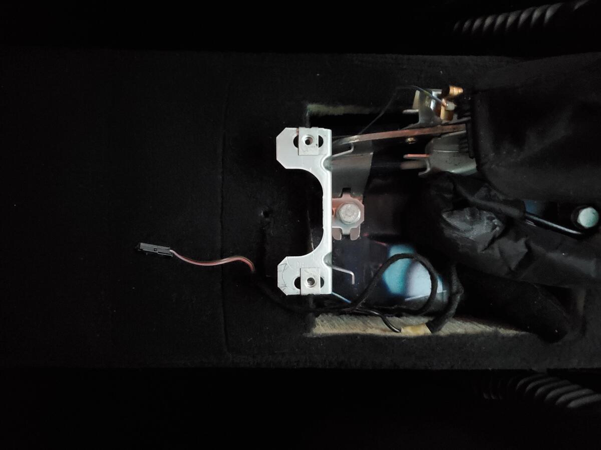

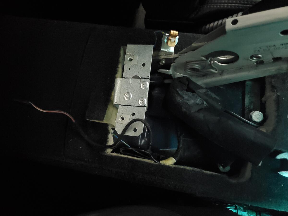

                            Also took the opportunity to replace my homemade $0.02 center console bracket with BMW's $5 bracket. Mine worked just fine, but it's a cheap part and will help avoid any future rattles.

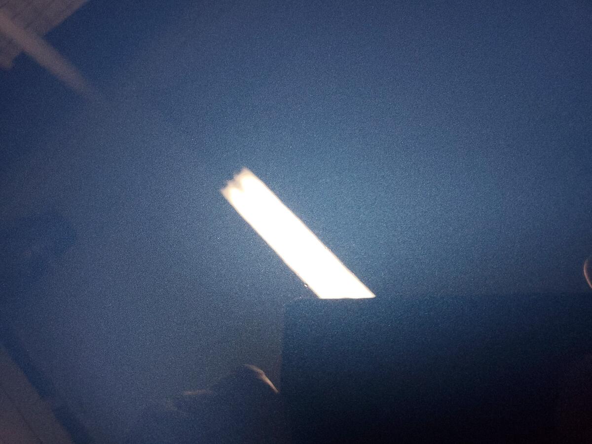

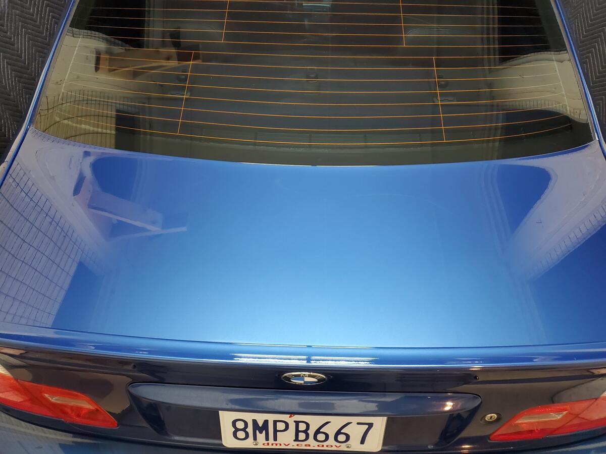

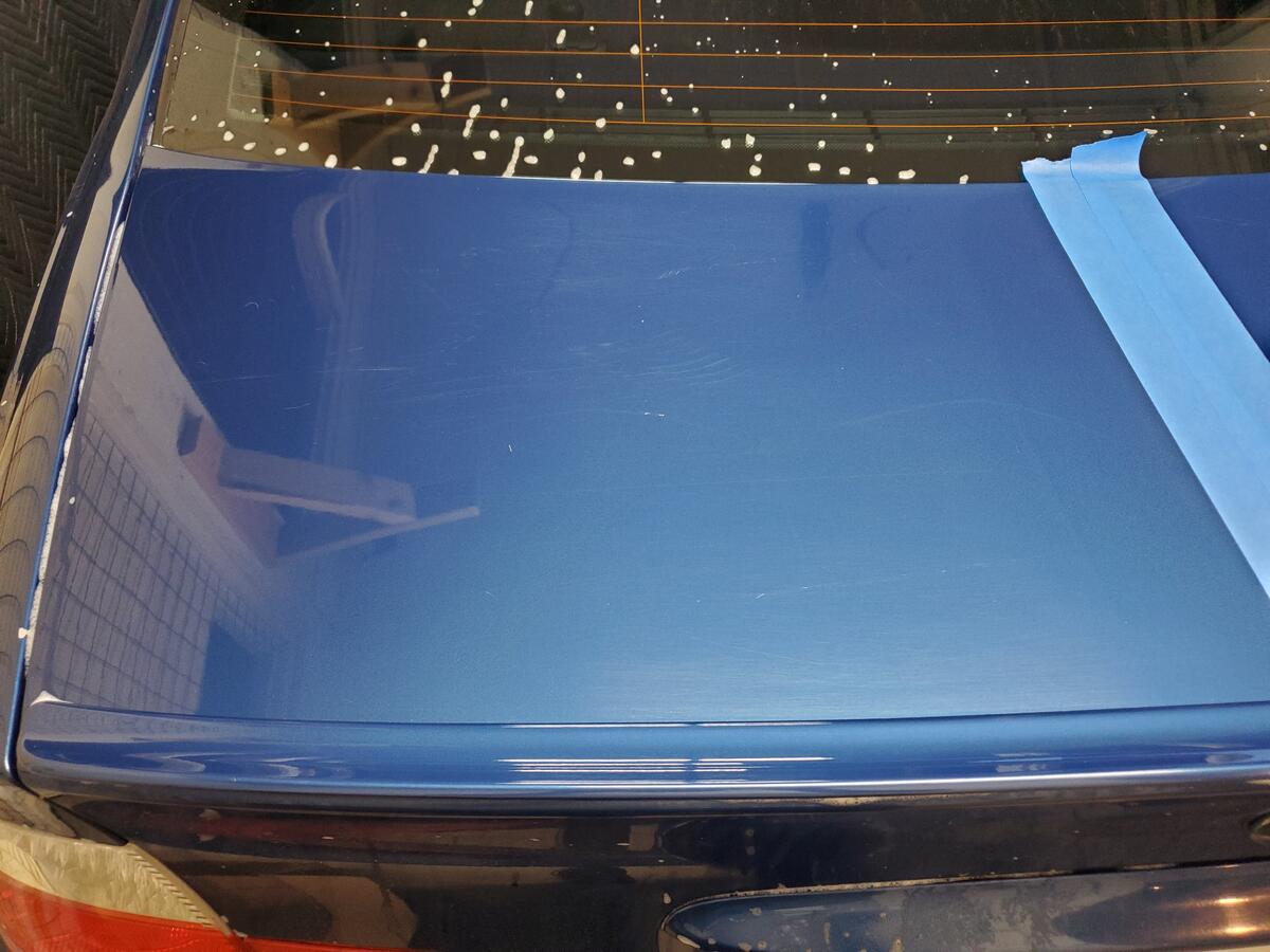

                              Started my paint correction today. Decided to do the top of the trunk lid because I've never done this before and thought a flat surface would be good to learn on.
                              I used a mf pad with megs 105, then a foam pad with megs 205 and added megs ultimate quik wax at the end.
                              Here's the paint after just a quick wash:
                              Tons of scratches of many different depths and lengths. Super dull look to the paint too.
                              Here's a quick video halfway through the process:
                              And a couple shots after finishing and waxing:
                              I'd say I managed to get about 90-95% of the imperfections out of the paint. Super excited to get the rest of the car looking like this. I'll probably work on the rest in the upcoming weeks/months.
