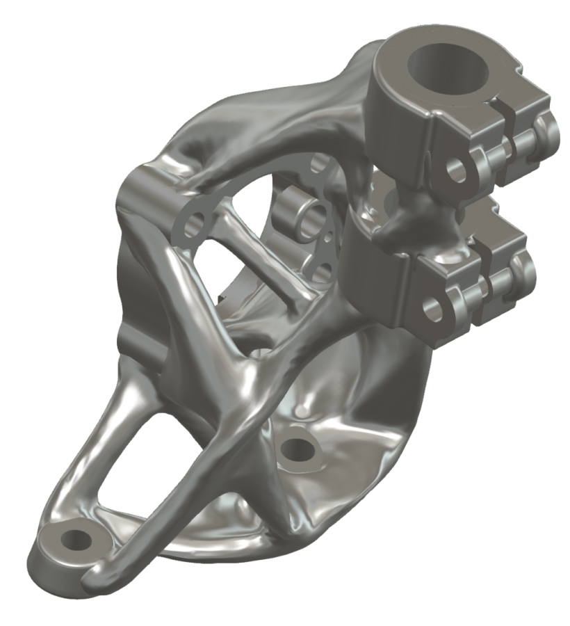

Black & Tan 332iT

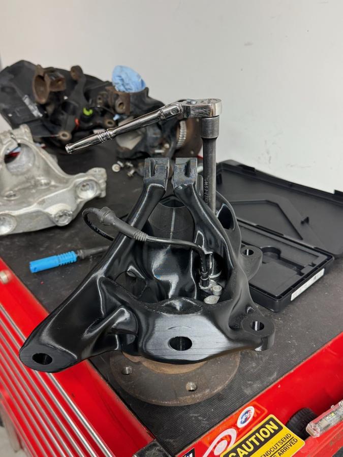

    Actual weights from the bathroom scale, without heat shields or ABS sensors, repeatable 3x:
    E46 total 14lb ‎ = 6.35 kg
    E60 total 13lb ‎ = 5.897 kg
    E60 aluminum knuckle 5.4lb = 2.5kg
    so in theory the superknuckle is .15kg heavier than the e60 setup and .3kg lighter than the e46 setup. So no appreciable weight benefit, but definitely a stiffness increase along with a much larger (and stiffer) wheel bearing that happens to bolt in.
    I’ve also decided that I’m going to reduce the steering ratio on the next iteration to match the non-m 13.7:1 steering ratio (vs the M3 14.5:1 with the same rack) that I find preferable. After adjusting for wheelbase differences, here are some baseline comparisons from other cars:
    911 ST converted to e46: 13.5:1
    911 GT3 converted to e46: 12.8:1
    E90 M3 converted to e46: 13.3:1
    Wife's Macan converted to e46: 13.9:1
    So 13.7:1 has some good company, I guess that’s why it feels so nice. The MK60 is easy to program with a write-in steering ratio, so I’ll have to knock that out along with this change as well to keep DSC in its happy place.

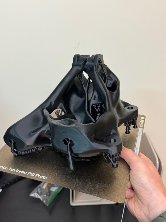

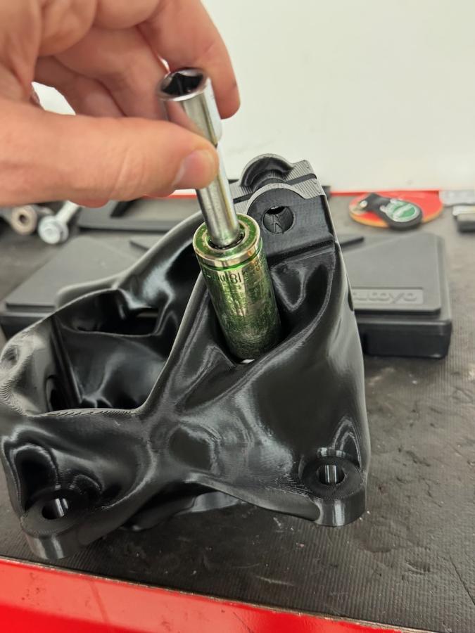

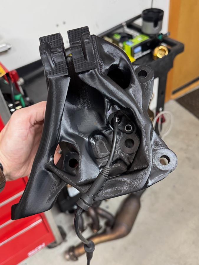

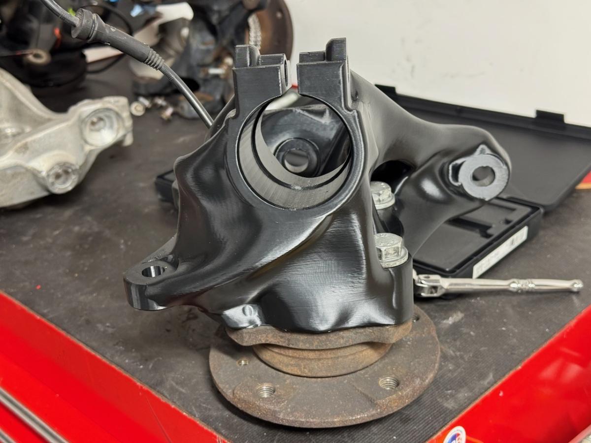

      Thanks to George Hill (whom I trust greatly with my CAD files) who's already printed one up! Got some good feedback on socket clearance that I'm going to have to incorporate into the keep out space. And he's got so many spare parts that he's probably going to beat me to my own test fit cases Click image for larger version

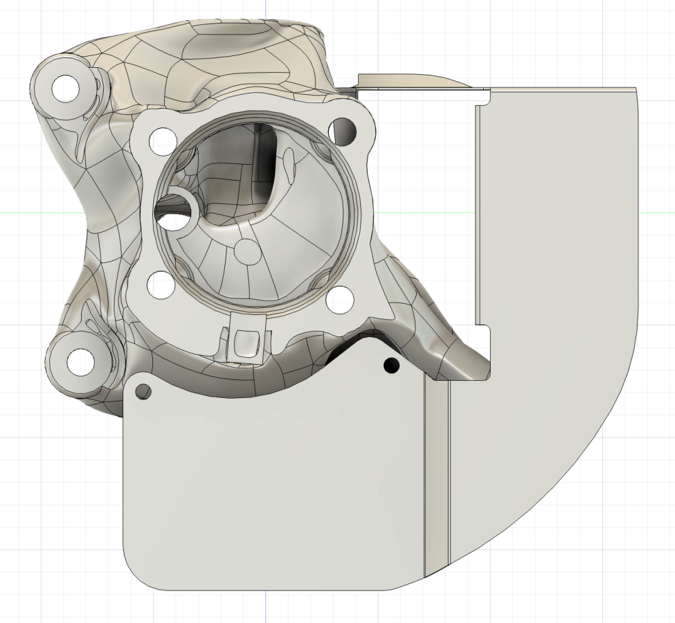

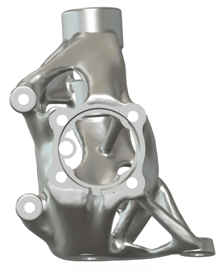

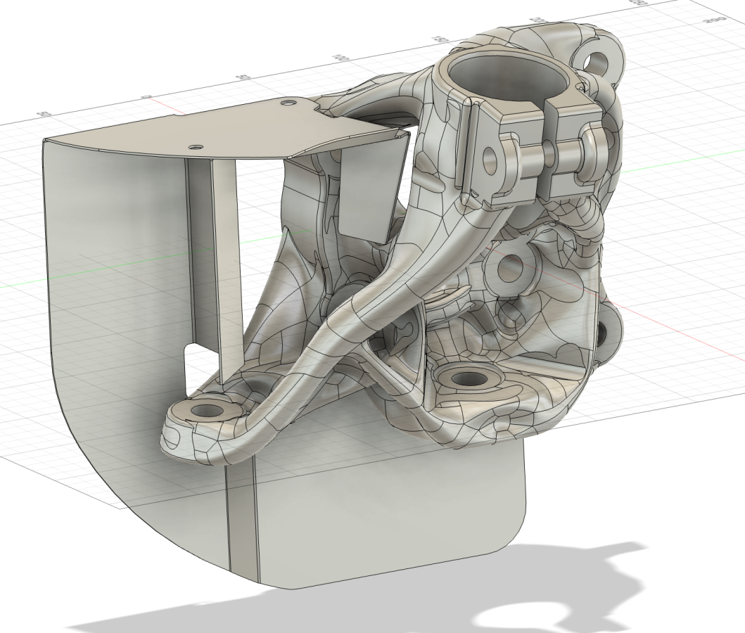

      I also forgot to mention I started conceptual designs on a bolt in brake shield. I'll be tweaking it to incorporate a ducting feature that matches my scoop a bit better, and replaces the plastic part that zip-ties to the strut:
Name:	Screenshot 2025-03-18 at 8.11.16 PM.png

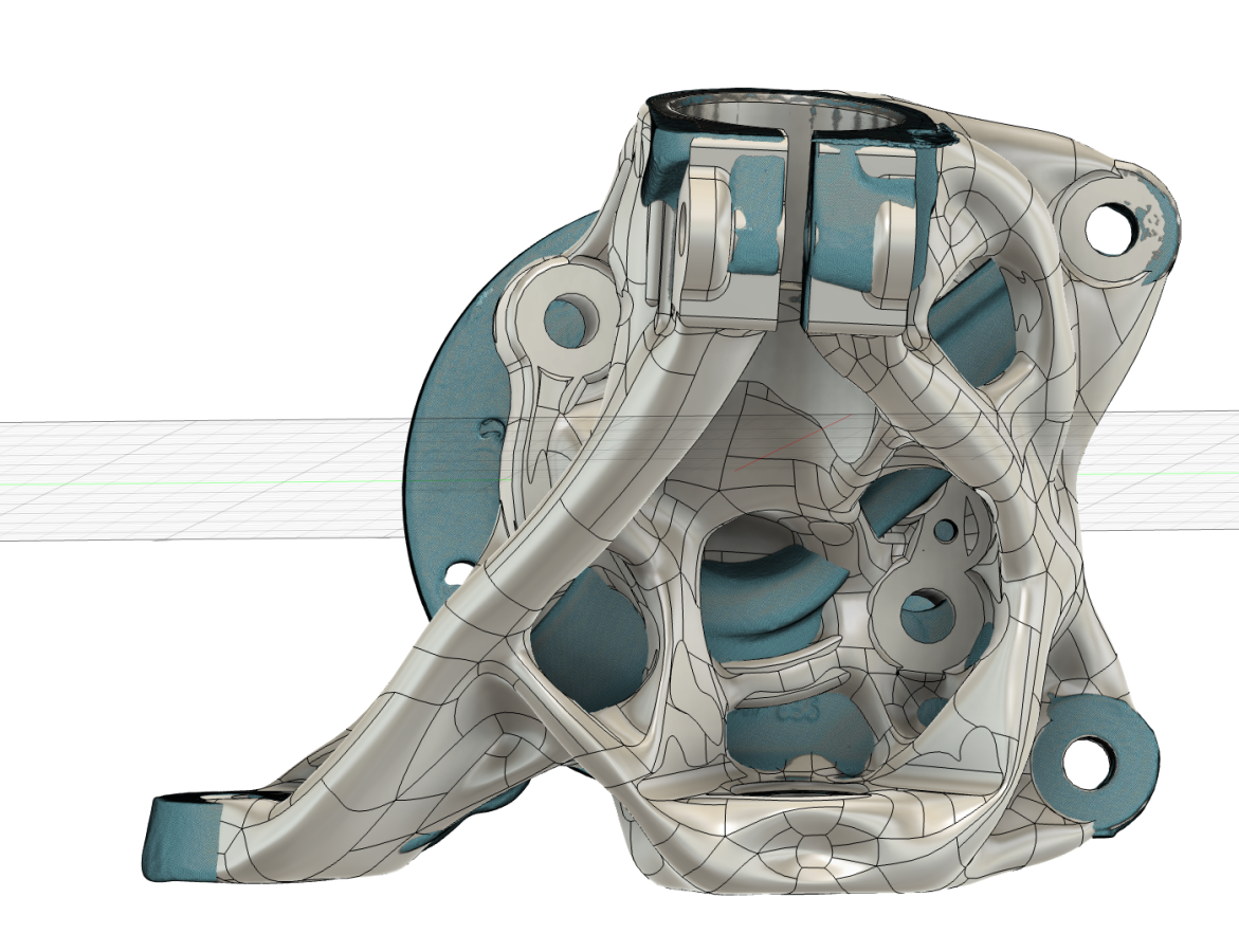

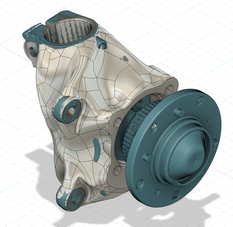

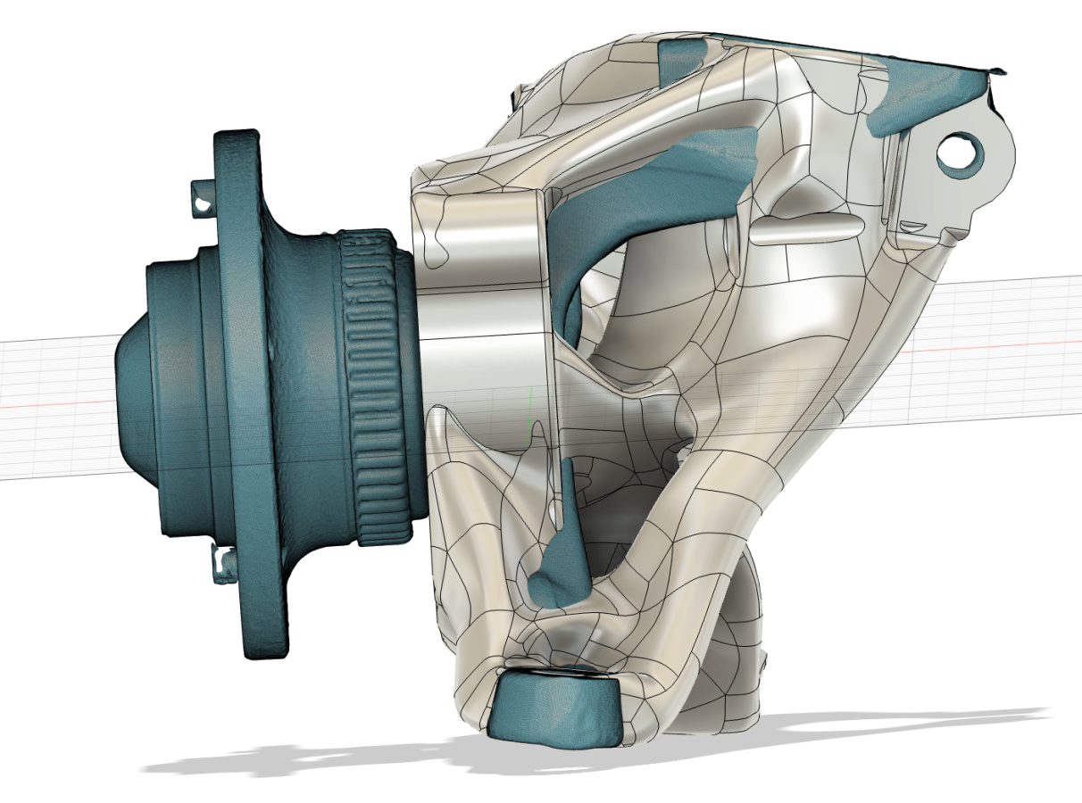

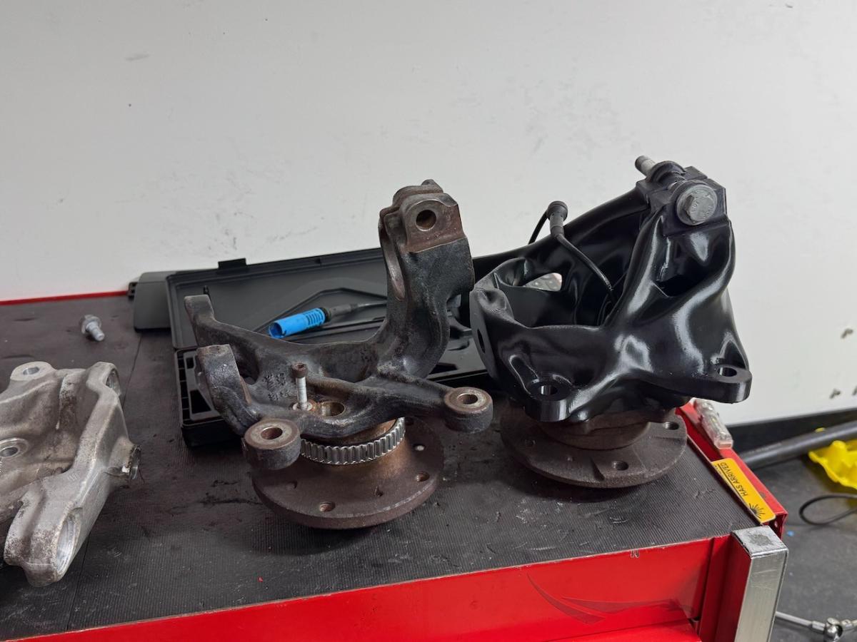

        Some comparison shots against the factory steel parts that look pretty cool:
Name:	Screenshot 2025-03-19 at 9.42.30 PM.png
ID:	298451 Click image for larger version
Name:	Screenshot 2025-03-19 at 9.42.08 PM.png
ID:	298450 Click image for larger version
Name:	Screenshot 2025-03-19 at 9.42.16 PM.png
ID:	298449 Click image for larger version
Name:	Screenshot 2025-03-19 at 9.42.56 PM.png
        And some shots of the brake shield/duct hybrid in progress:
Name:	Screenshot 2025-03-19 at 11.15.46 PM.png
ID:	298452 Click image for larger version
Name:	Screenshot 2025-03-19 at 11.16.00 PM.png
          Would be cool if your brake duct supported brake cooling hoses.
            Easy enough to design replacement bolt on backing plates that would adapt to a traditional hose - the backing plate should be easily replaceable with the rotor removed, no hub removal required.

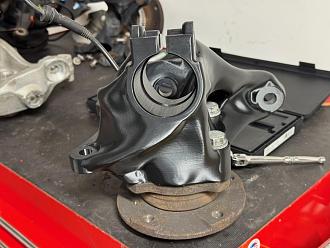

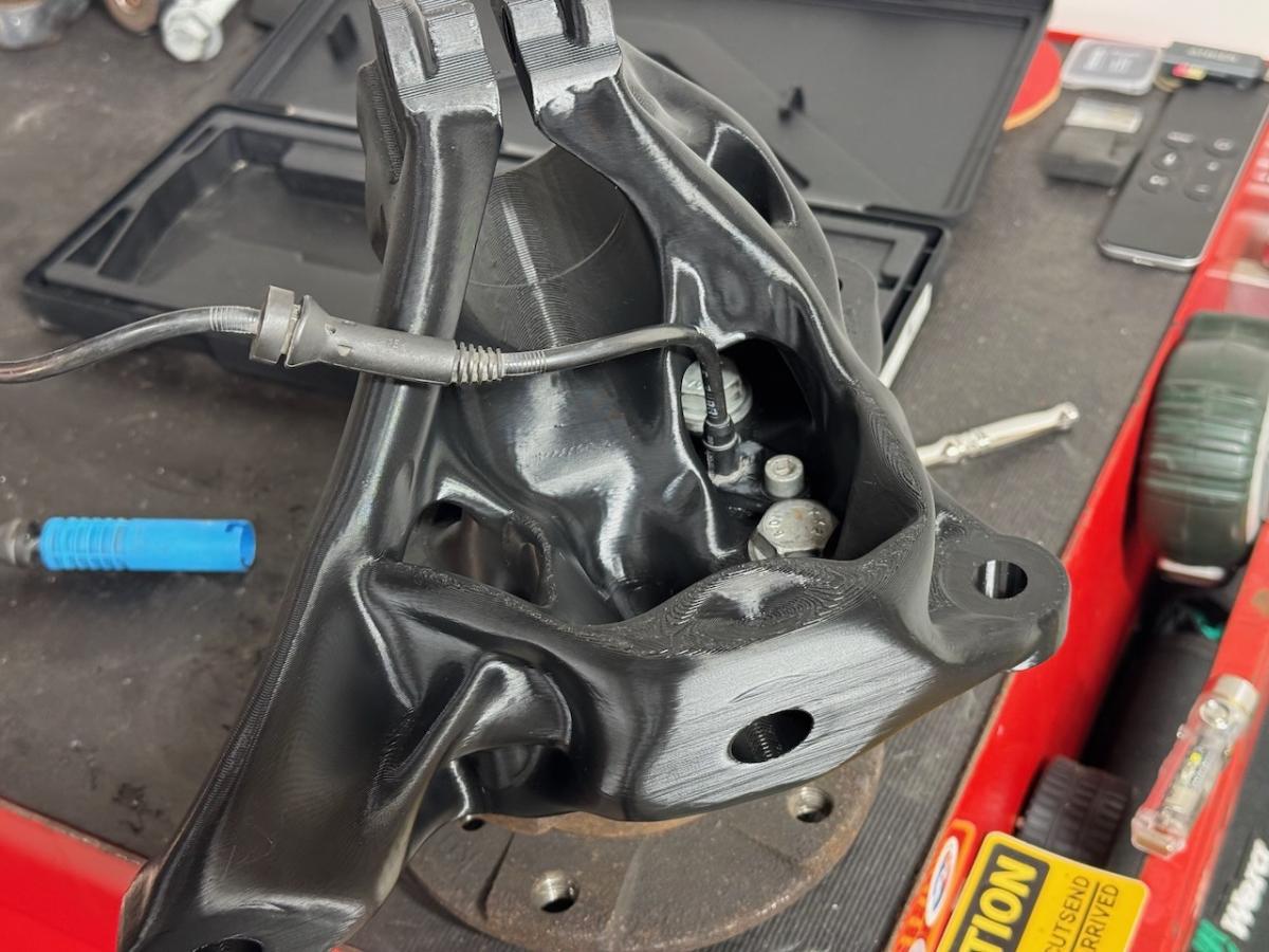

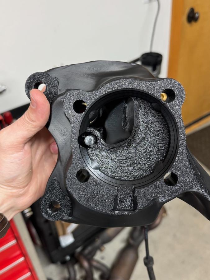

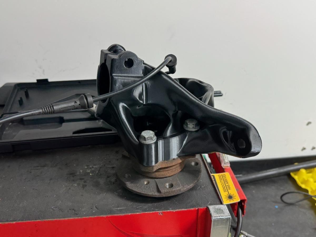

              Fresh off the printer, complete with a few tweaks from George's lessons learned. Dimensions are looking good, just needed to make the tapped hole a little deeper for the ABS sensor mount.
ID:	298584 Click image for larger version
ID:	298581 Click image for larger version
ID:	298587 Click image for larger version
ID:	298585 Click image for larger version
ID:	298582 Click image for larger version
ID:	298588 Click image for larger version
ID:	298586 Click image for larger version
ID:	298590 Click image for larger version
ID:	298583 Click image for larger version

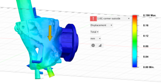

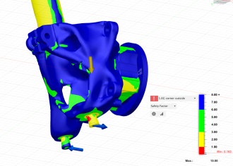

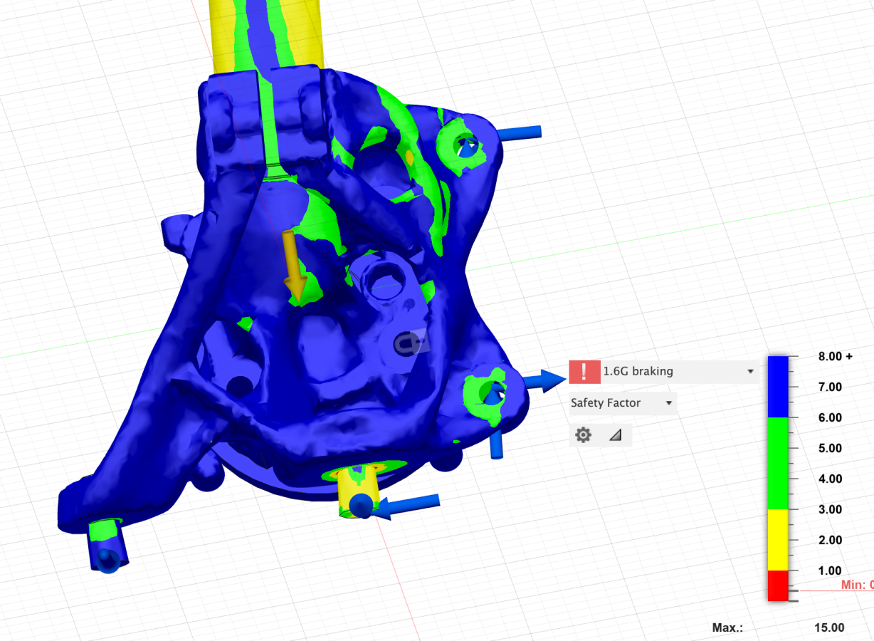

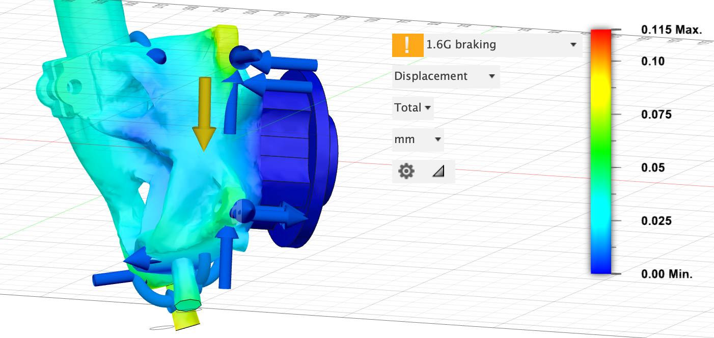

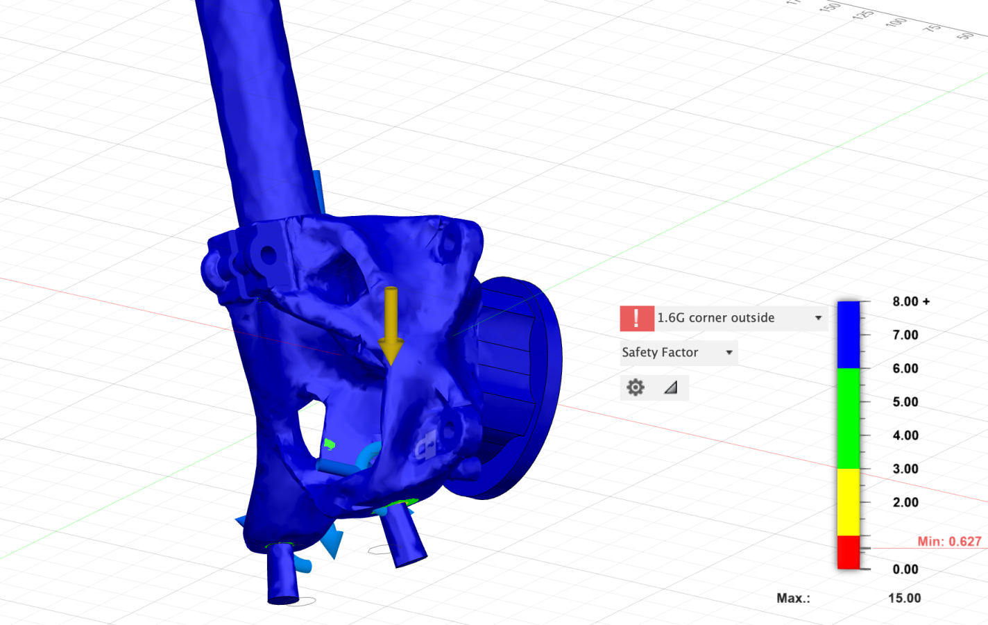

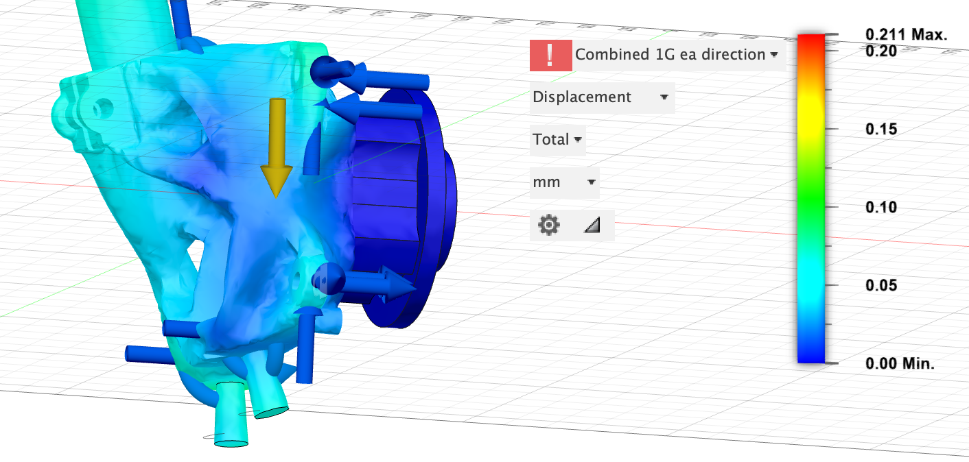

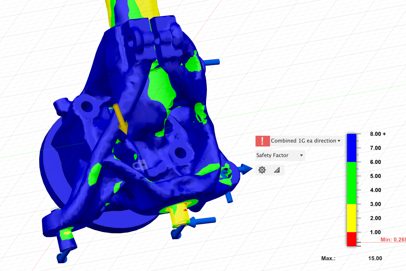

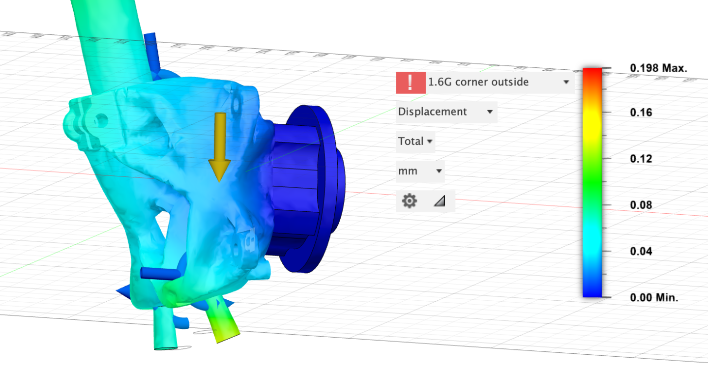

                Analysis run with the appropriate boundary conditions at the tie rods and strut tube. Interestingly it wasn't possible to use these during generative design. Looks more accurate now, this thing should be extremely beefy. Low stress and low displacement.
                Next up I will put the loads into the strut tube, tie rods and hub to see what that does to the simulation, instead of applying the loads directly to the part surfaces. The simulation can then factor in displacements of the steel parts as well as the aluminum parts.
Name:	Screenshot 2025-03-21 at 10.20.22 AM.png
ID:	298622 Click image for larger version
Name:	Screenshot 2025-03-21 at 10.21.10 AM.png
ID:	298621 Click image for larger version
Name:	Screenshot 2025-03-21 at 10.21.20 AM.png
ID:	298619 Click image for larger version
Name:	Screenshot 2025-03-21 at 10.21.28 AM.png

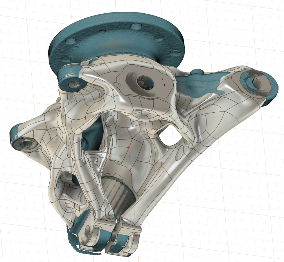

                  Hi Bryson... as for load cases I can think off...
                  * Pot hole, tough to estimate. I can ask around here to see if there is any directional input, like shock g's and damper speed.
                  * hitting a curb, although the week link here is the tie rod.
                  since we have more unknowns than not, one idea is to scan the OE design, and run the same modes, then you can have two data points you can use to compare under the same conditions.
                    Yeah, good idea. I was waiting for you to pop in here. thank you.
                    I’ve got the scan of the OE parts, just need to close the holes and make it a solid body.
                    I’ve also done a quick model of the tapered joints on the control arm and tie rod and placed the appropriate loads that put the tapers in bending. At first blush it looks like the control arm taper will fail before the knuckle by a small amount. I’ll need to disassemble a control arm to get good dimensions of the taper to make sure, I just estimated length of the taper based on an old iPhone scan.

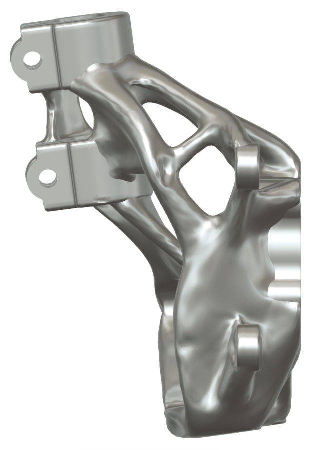

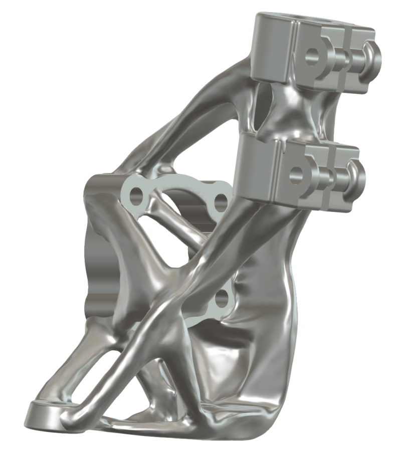

                              Couldn't help it, dropped the control arms and tie rods 30mm and added a second strut support 80mm higher, then tipped the strut in 4 degrees for ~20mm extra inner wheel and tire clearance. Here's the unrestricted by manufacturing constraints result:

                                Had a revelation today. I've been struggling to get the stress analysis to close ever since I started modeling the tie rod tapers as 4340 steel mating parts. I remembered that the e39 used a taper like the e46 does, and also had aluminum uprights, so I couldn't figure out why my analysis wasn't closing. Well, it's because the e39 has a steel insert where the loads would otherwise fail the aluminum part. Nice, that'll do it.
Name:	Screenshot 2025-03-26 at 8.31.38 PM.png

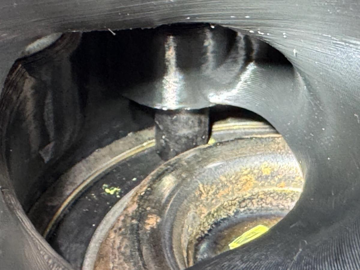

                                So looks like I need to make a trip to the junk yard this weekend to rip some of these bushings out of an e39, take some dimensions, then see if I should use the e39 bushings or design mating parts for the e46. I fear that there is not enough thread engagement on the e46 M3 control arm to use the e39 bushings as-is, so they'll probably need to make a trip to the lathe.
                                e39 bushing being pressed out (instead of the ball joint) to visualize it:
                                Click image for larger version  Name:	1089.jpg Views:	0 Size:	62.5 KB ID:	299336
                                and the bushing after it came out:
                                Click image for larger version  Name:	1090.jpg Views:	0 Size:	182.8 KB ID:	299337
