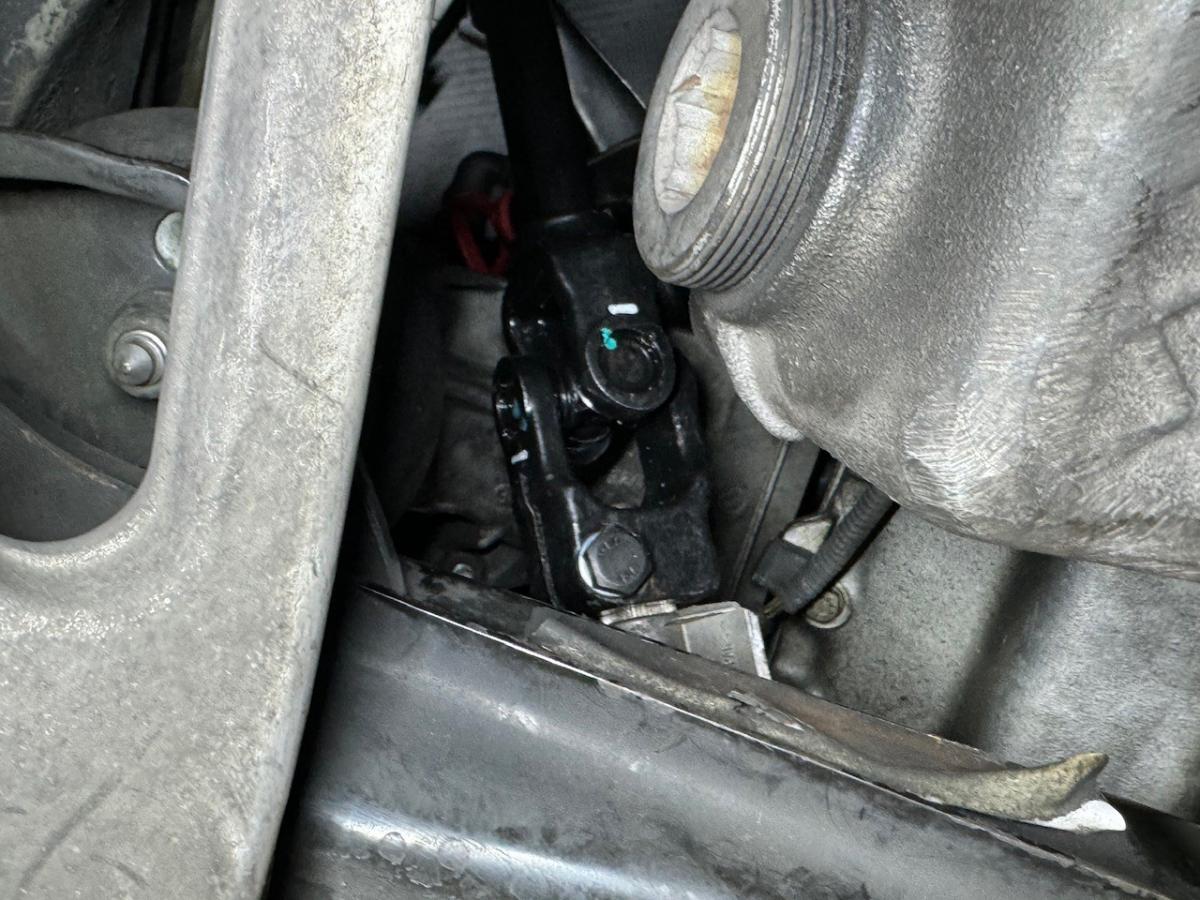

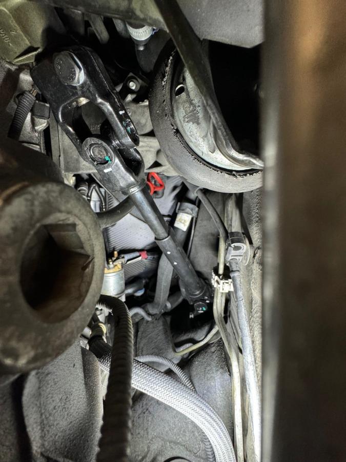

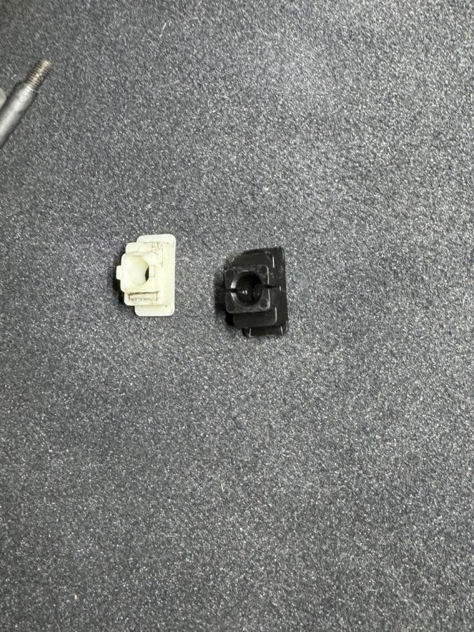

      Rainy day today, so I did a little work on the car again. Today’s task was to tighten up the steering with two specific changes: 1) New lower steering column bushings and 2) an LPSR solid steering shaft
      The lower column bushings made a big difference with how perfectly solid the steering wheel is now placed in my hands. The new bushings were actually a different design and shape than the loose ones that came out, and I expect these to stay tight and perform better over time. This was a surprisingly big change to the firm feel of the car in the hand.
      Click image for larger version Name:	IMG_0626.jpg Views:	0 Size:	122.2 KB ID:	242596
      Click image for larger version Name:	IMG_0624.jpg Views:	0 Size:	180.5 KB ID:	242597

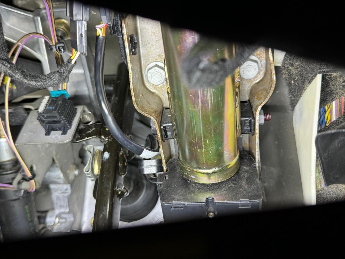

      Second was the LPSR steering shaft. Because this shaft doesn’t have a collapsible section anymore for installation, it is slightly shorter than the original, but the column has plenty of travel to accommodate this. I was also concerned that it was clocked differently so I purchased a spare plastic cover for the rack splines and trimmed the alignment fin off to allow any clocking at the rack side. To install, I locked the steering column in the center aligned position, and was then very careful to not disrupt the rack’s position as I removed the stock parts and installed the new ones. The result was a perfectly aligned steering wheel on the test drive. Here’s what it looks like installed.
      Click image for larger version Name:	IMG_0629.jpg Views:	0 Size:	87.8 KB ID:	242594 Click image for larger version Name:	IMG_0627.jpg Views:	0 Size:	164.6 KB ID:	242595
      Overall, this is a fantastic change to the car. It really makes the whole car feel firmer and much more direct, and actually reduced! vibration from the steering wheel. Well, it might be more accurate to say it added a slight bit of high frequency feedback, but removed the sloppiness and low frequency vibrations of the stock parts. Steering inputs are way more direct and controlled and it’s my opinion that the car should have come from the factory this way. I’d say this is in my top 3 for changes I’ve made to the car, 1 being seats, 2 being the Slon and v-brace chassis stiffening, with 3 being the more direct steering. Hope this encourages more folks to make this change!
      Any tips on the install for the steering shaft besides the plastic cover? Or is it pretty straight forward? Mine should be in this week!
        Awesome. No real tricks, other than being super cautious to not turn the steering wheel while you're installing. You can re-clock the plastic piece if you'd like to keep the alignment fin, but I opted not to as I was too paranoid of accidentally steering the rack while removing/installing it. Good luck and hope you enjoy it as much as I do!

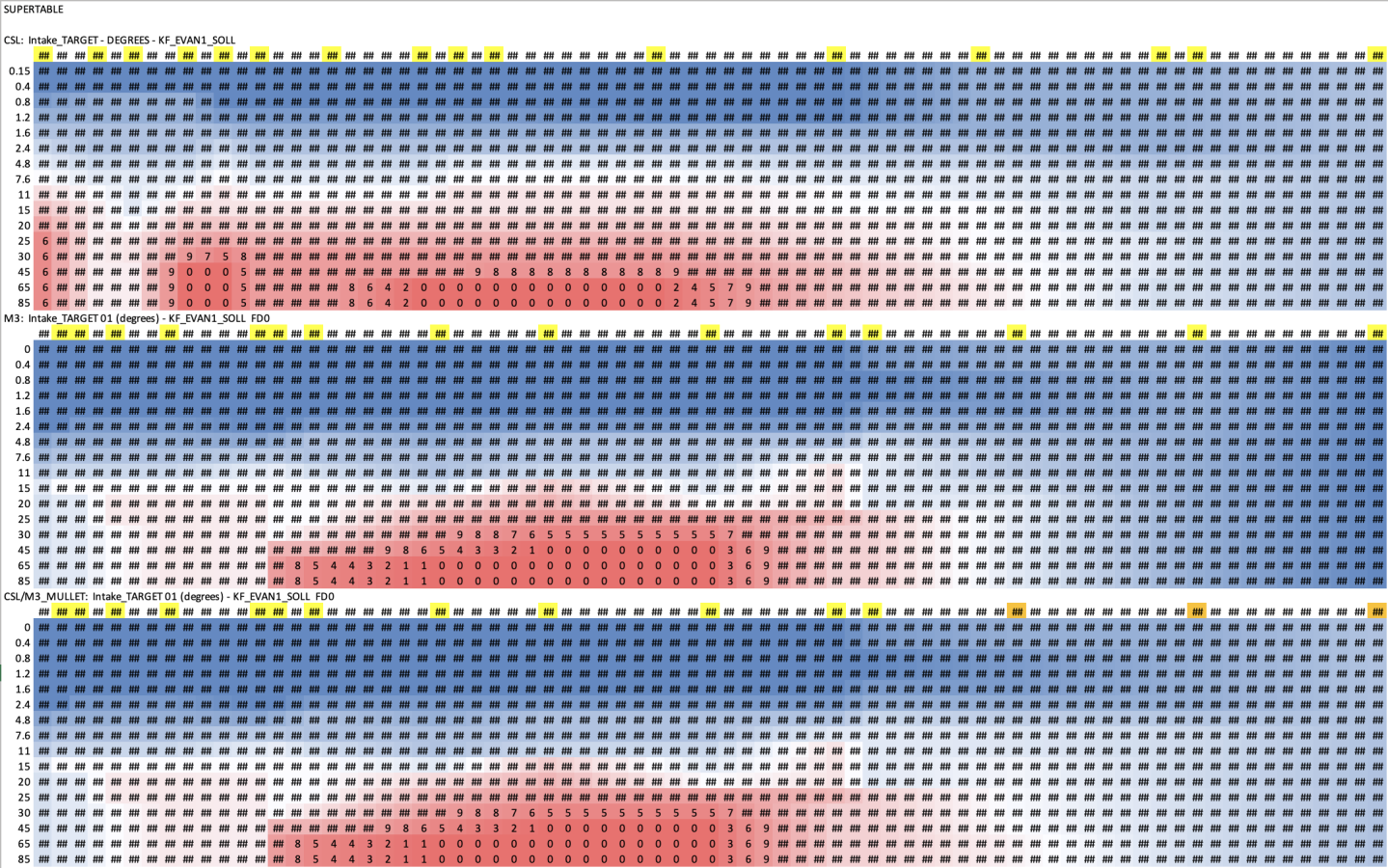

          Ok, so I've been driving my car around with the stock airbox (and now the no NVH exhaust) and I love how responsive the throttle is at low revs and how smooth the tip-in is. Honestly it's sufficiently better than the CSL setup that it had me considering never going back. But I miss the noise. So here comes another idea..
          What's different about the CSL engine, fundamentally from its principles of operation? Well, at low revs neither intake is going to be a restriction, so you can reasonably assume actual performance in the engine will be the same. The exhaust between and CSL and euro M3 from a flow perspective seems to be identical, so really it's just the cams, or maybe just the intake cam and some intake runner changes. The intake runners are short, they're only likely to go into effect really during high rpm operation. So let's assume that these are the big changes, then ask ourselves where in the tune this would be different between CSL and M3? You'd see it in the vanos/cam timing maps for sure, then probably some ignition timing, and definitely lastly fueling and injection timing. In a prior episode we dialed in the fuel, which was a huge improvement, but it's not to the point of the responsiveness of the M3. There's nothing in physics that says we can't achieve the same outcome, so let's get started.
          I stripped out the relevant part throttle tables from the CSL and M3 maps: Fuel injection end angle, ignition timing, intake cam advance, intake cam advance during cat heating, exhaust cam advance, and exhaust cam advance during cat heating. The interpolation targets between the CSL and the M3 are all different, so you can't actually directly compare them. But you can build out a complete map, do the interpolation, color chart them, then compare directly. I haven't seen anyone do this, so I did it myself. The results are enlightening! There are lots of changes in the vanos timing that are likely due to the cam difference (and some resultant tweaks to ignition timing). This is likely why folks with CSL or hotter cams report smoother running engines than folks with M3 cams and CSL bolt-ons.
          My car seemed pretty happy above 3500rpm with the CSL setup, but was never quite right at lower speeds. I'd still get pinging at WOT under 2k, the throttle response wasn't consistent and snappy under 3k, and there has always been some inconsistent odd behavior at 2700pm. I wanted to see if the maps explained this behavior, and for the most part, they do! So, I was happy with the high rpm performance of the CSL, but I want the low rpm performance of the M3. Enter the Mullet Tune(tm).
          I've taken the best of both tables and hybridized them to hopefully keep the benefits of the CSL power and noise at higher rpm, but the smooth operator of the M3 at low rpm. Here is what that looks like visually:
          Intake cam timing (CSL, M3, Mullet):
          Click image for larger version  Name:	MulletV1 Intake Cam.png Views:	0 Size:	1.27 MB ID:	260314
          Not a huge change on the intake side, but there's a big change at low rpm, high load that's notable.

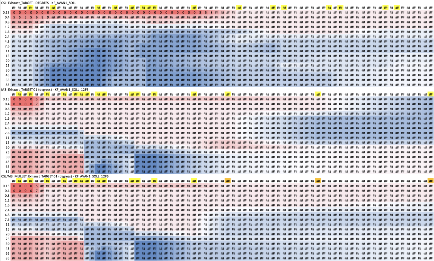

          Exhaust cam (CSL, M3, Mullet):
          Click image for larger version  Name:	MulletV1 Exhaust Cam.png Views:	0 Size:	1.33 MB ID:	260312
          Look how different the exhaust cam operation is at low RPM!! That big step change in the M3 map about 1/3 of the way to the right? That's 2700rpm! The data, it speaks to us.

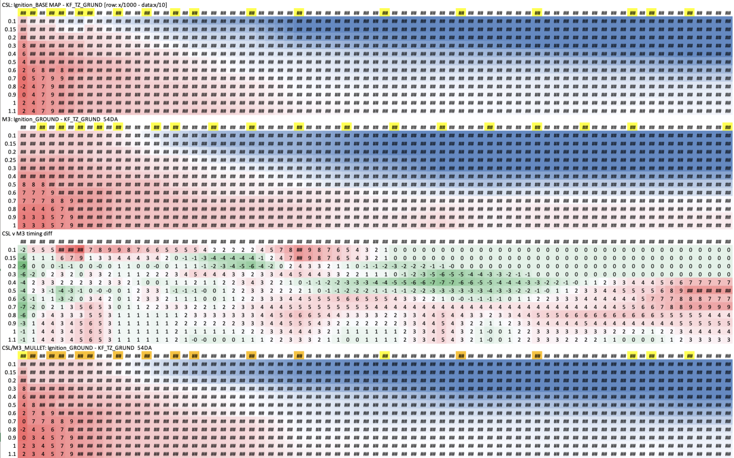

          Ignition timing (CSL, M3, CSLvM3 comparison, Mullet):
          Click image for larger version  Name:	MulletV1 Ignition Timing.png Views:	0 Size:	1.20 MB ID:	260313
          The next task will be to load this tune into the car, repeat the fuel map trimming process of a few months back, then see if the Mullet delivers. Business down low, party up high. Wish me luck.

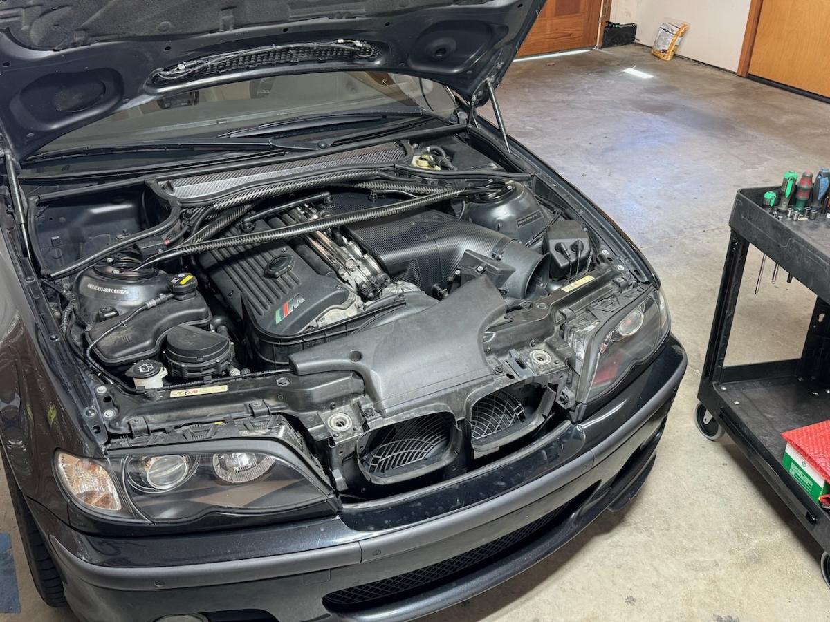

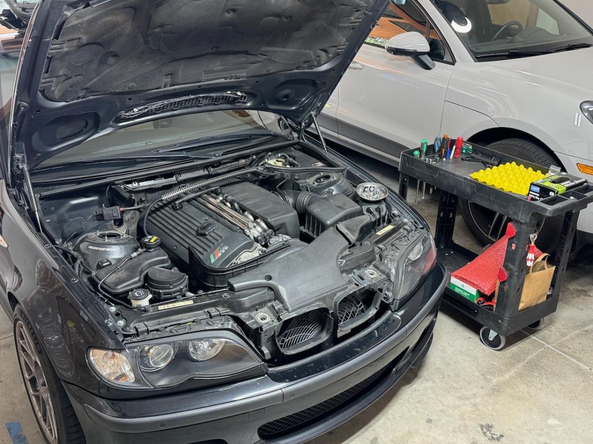

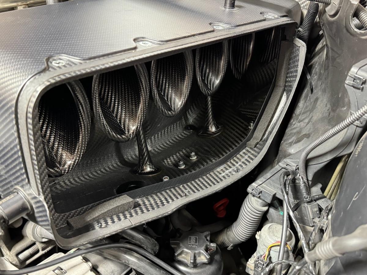

              Well, the Mullet Tune is an absolute resounding success! This morning, I removed the stock airbox, added some extra foam where the filter didn't seal well (there was sand behind the filter!), then reassembled with the CSL airbox. I also measured the length of the trumpets in an effort to calculate any shift in peak power resonance. The trumpets in the stock airbox and the CSL airbox are nearly identical in length, so I had even more positive reinforcement that the Mullet would be a likely success.
              Click image for larger version  Name:	IMG_1982.jpg Views:	0 Size:	191.4 KB ID:	260398
              Click image for larger version  Name:	IMG_1985.jpg Views:	0 Size:	185.6 KB ID:	260399
              Click image for larger version  Name:	IMG_1987.jpg Views:	0 Size:	192.8 KB ID:	260400
              After that, I uploaded the Mullet Tune and went out for a drive. From v1, I only had to make a couple corrections: pull a degree of timing out from 1900-2200rpm at WOT, and tune the exhaust cam advance around 3700-3800rpm under mid-throttle. I haven't touched the fuel maps yet, but it's just about on the money as is.
              It works exactly as expected, smooth like a stock M3 down low, and rips like before up top. Downshift blips are doing just what the pedal asks for, super repeatably and responsively, there's no lumpiness in the rev band under 3k anywhere, and you can go WOT at any time without pinging. I had a good long 6th gear uphill WOT pull from 1200rpm to 3100rpm that was smooth sailing the whole way. Tip-in is smooth and not jerky, making shifting a little smoother and easier. I was enjoying driving around at low revs nice and quietly, and finding excuses to downshift from every perceivable rpm just to get the satisfaction of solving the CSL tune issues. So this is the hot ticket for a bolt-on CSL conversion! This really increases the jeckyl/hyde nature of the car even more, it's so docile and smooth around town, but when that valve opens at 3300rpm, the game changes. A solid fix!

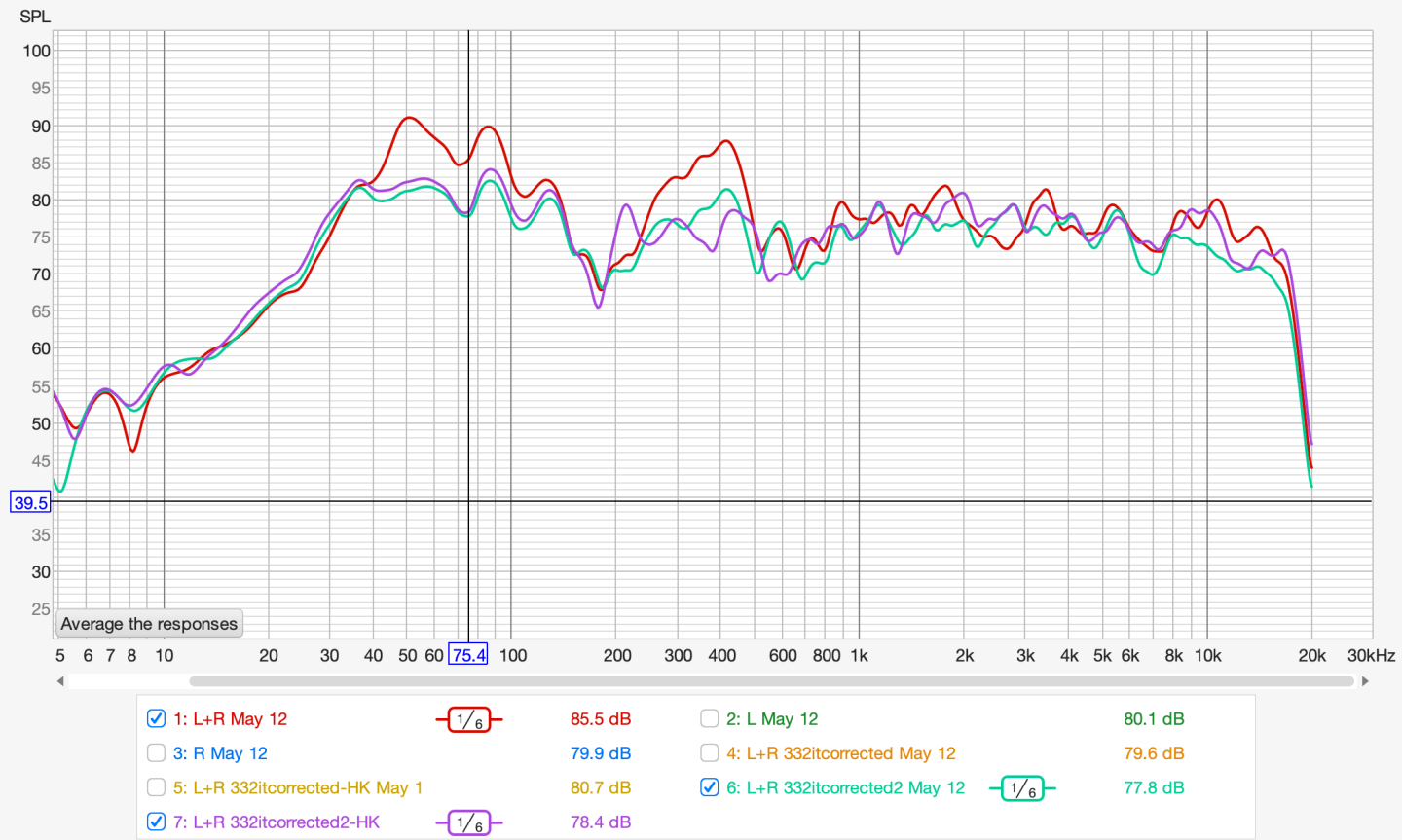

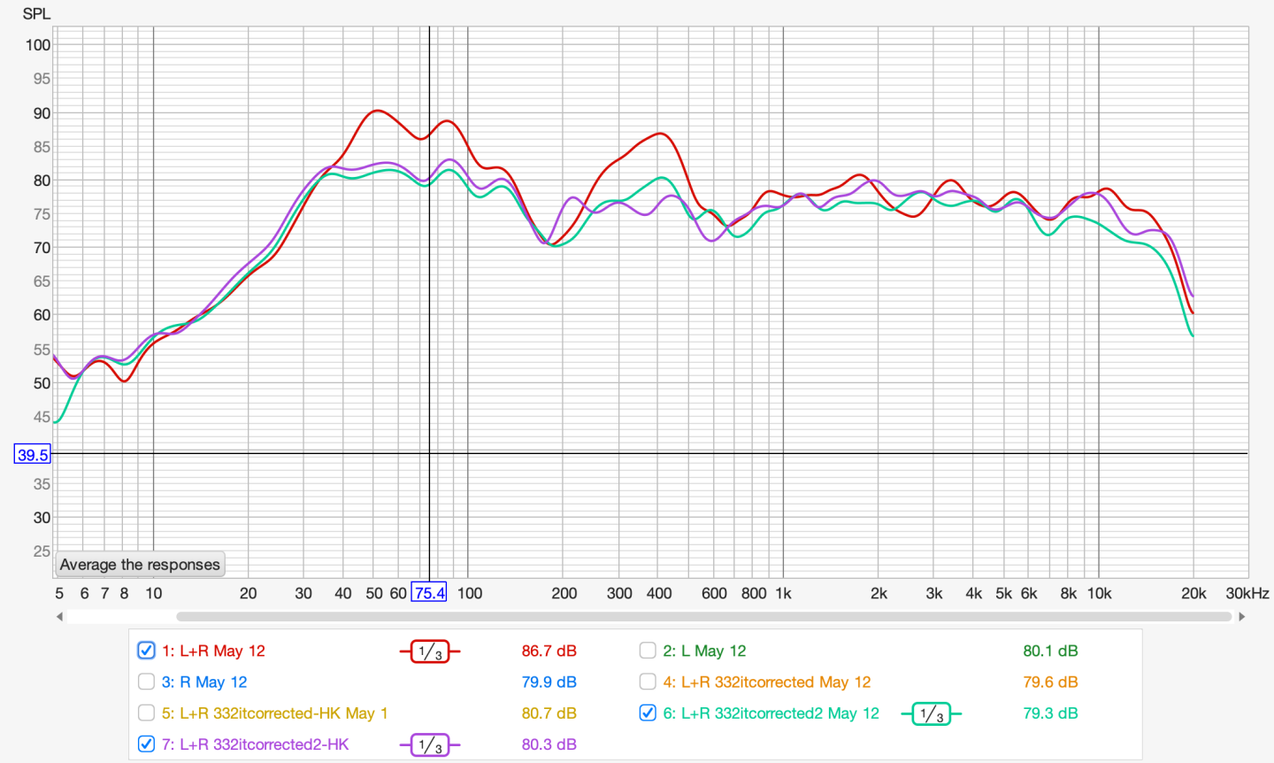

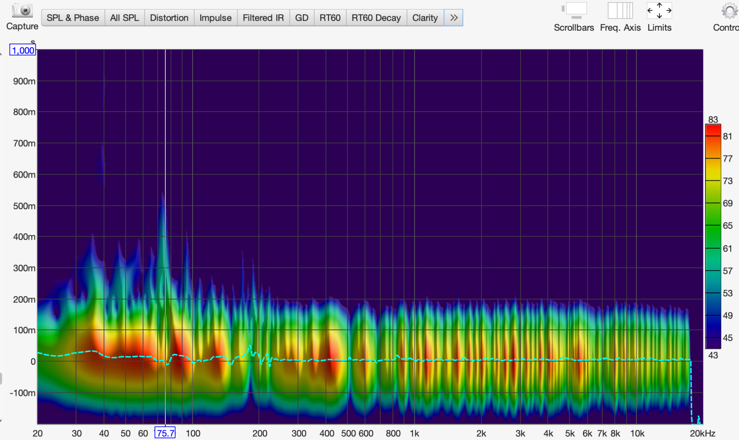

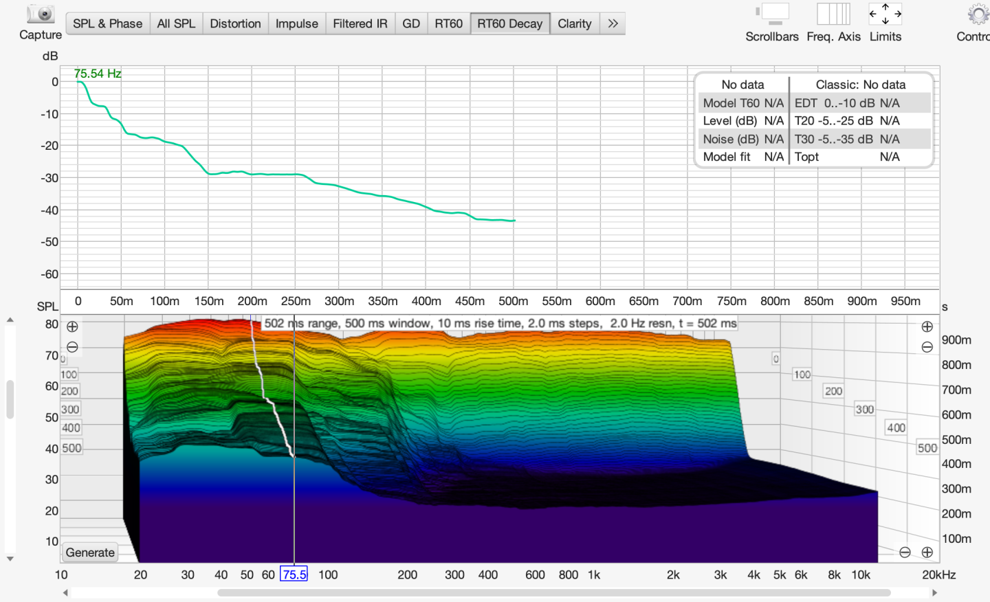

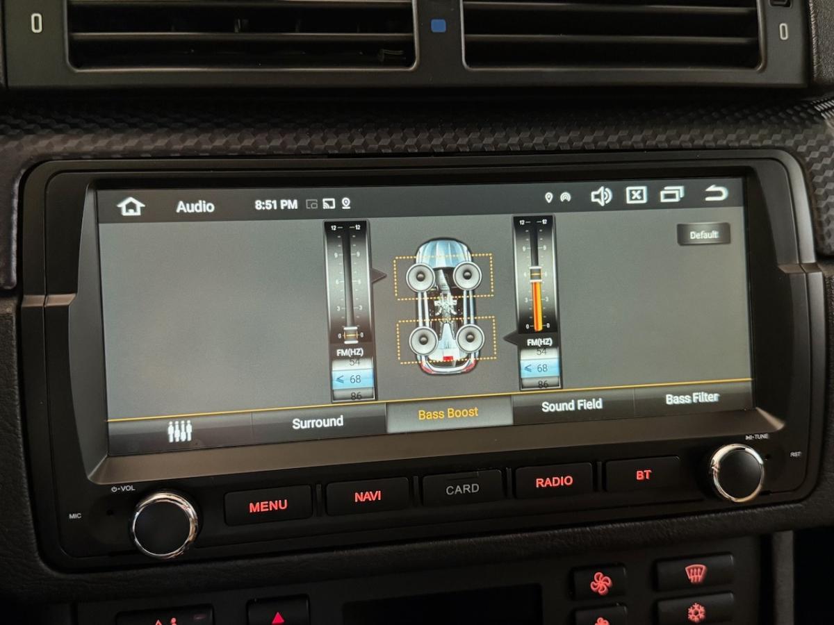

                                The AVIN head unit crapped out on me, so I bit the bullet and ordered an XTRONS. The XTRONS is significantly better and easier to use, more polished (although not perfect, it's much better). Since this has a nice EQ, I broke out the UMIK-1 microphone and REW (Room EQ Wizard) to correct the frequency response. This car has BavSound speakers, so if you're looking to grab these settings, be sure to make sure you have a wagon with HK and BavSound speakers first!
                                On to the data:
                                Frequency response of the system set (both 1/3 and 1/6 smoothing shown):
                                - Flat with HK off (red)
                                - EQ applied with HK off (green)
                                - EQ applied with HK on (purple)
                                Click image for larger version  Name:	Screenshot 2024-05-12 at 6.12.56 PM.png Views:	0 Size:	241.3 KB ID:	264461 Click image for larger version  Name:	Screenshot 2024-05-12 at 6.10.54 PM.png Views:	0 Size:	273.1 KB ID:	264462 RT60 Decay response (after EQ):
                                Click image for larger version  Name:	Screenshot 2024-05-12 at 6.24.13 PM.png Views:	0 Size:	478.2 KB ID:	264463 Spectrogram plot that highlights in-cabin resonances (after EQ):
                                Click image for larger version  Name:	Screenshot 2024-05-12 at 6.24.33 PM.png Views:	0 Size:	478.3 KB ID:	264464

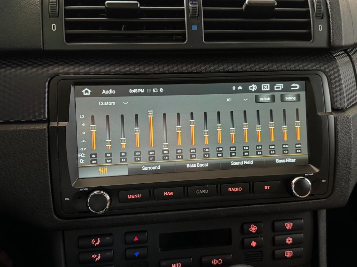

                                And the EQ settings:
                                Click image for larger version  Name:	IMG_2612.jpg Views:	0 Size:	107.5 KB ID:	264459
                                Plus a little rear bass bump (not included in any of the EQ plots above) because the woofers in the wagon are on the rear channel, facing the tailgate:
                                Click image for larger version  Name:	IMG_2613.jpg Views:	0 Size:	96.1 KB ID:	264457
                                Overall happy with the XTRONs unit now, and I prefer all of the response tweaks that the HK system adds even after EQing with it off - it really does appear pretty well tuned to the e46 cabin and speaker placements.
