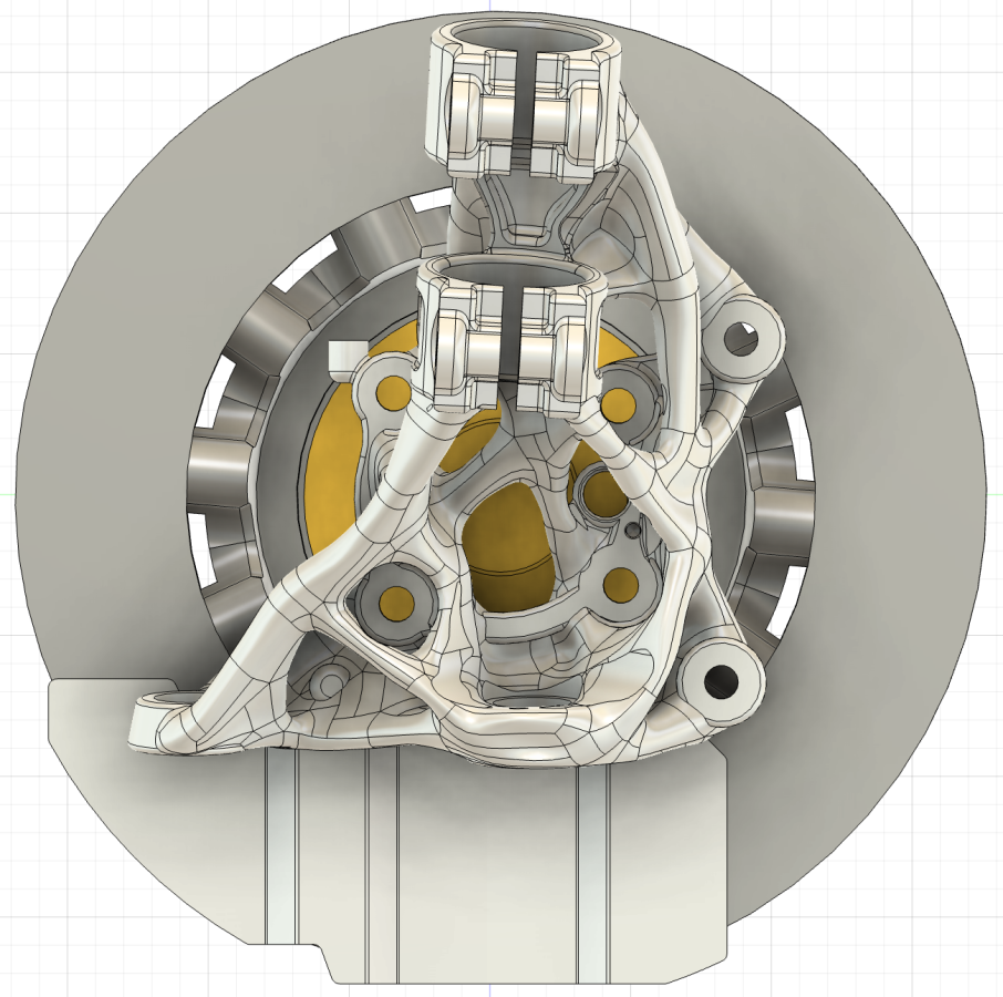

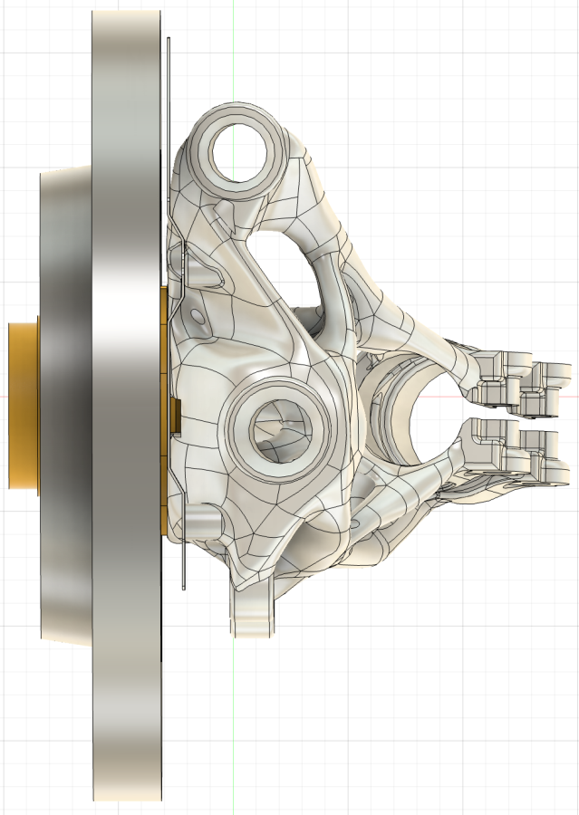

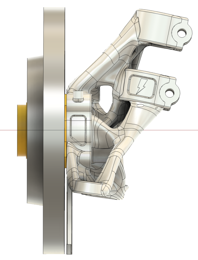

    Thanks guys, I’m enjoying this project as it’s giving me a chance to really test out Fusion 360 and generative design.
    Tonight I worked on some lightweighting and managed to get this down to a .09kg weight penalty over the single clamp version. So we’re pretty much maintaining the 1lb (.92lb) unsprung mass reduction. Pretty good I’ll say!

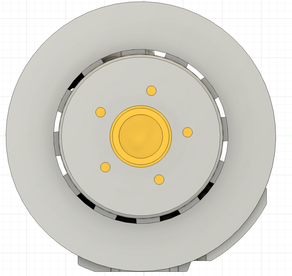

    And thanks to a member on e46fanatics we now have a visual and measurement of heatshield clearance - 3.25mm to the rotor - snug.
    The latest:

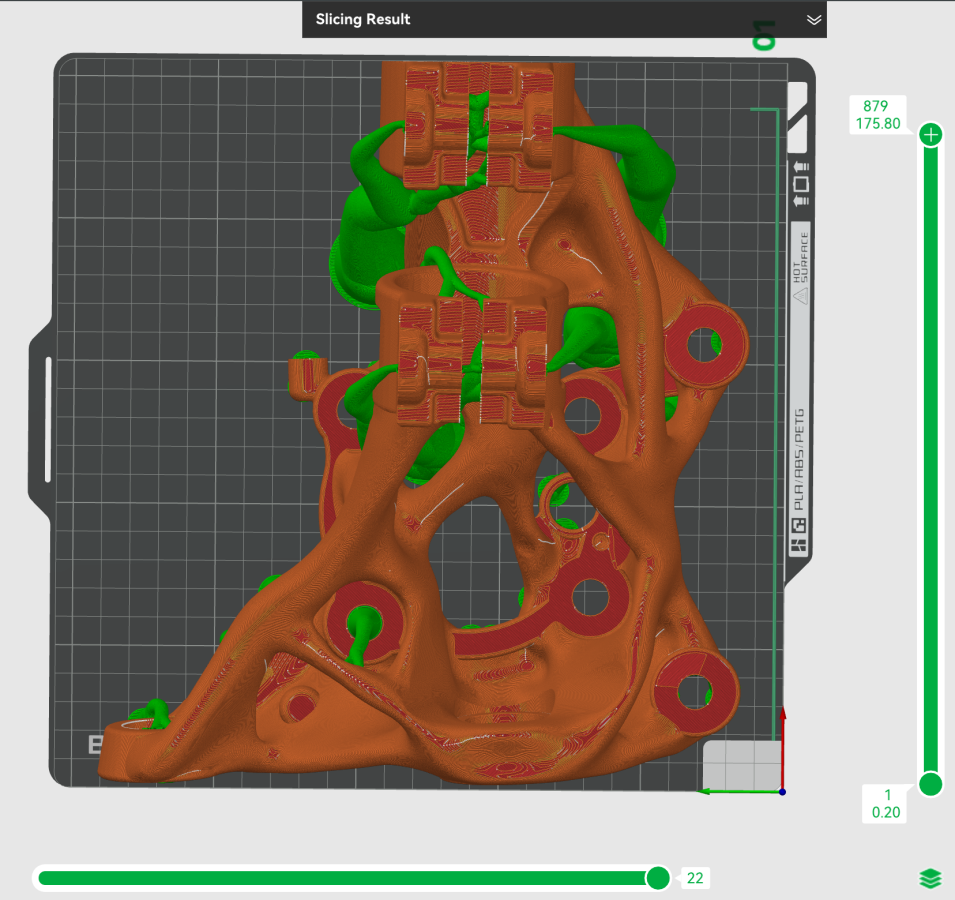

    Off to the printer(s) we go! (George is printing one too)

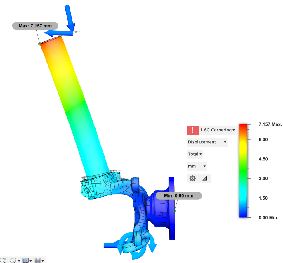

      Ran a quick analysis on the stock parts assuming they're a similar enough material to 4340 and here we go - large deformations leading to camber loss. 11.5mm of displacement at the strut tower ~= 1 degree of camber. So at 1.6G, the factory parts are losing 7.2/11.5 = 0.63 degrees of camber, compare this with 2.0/11.5 = 0.174 degrees of camber in the latest knuckle version. Excellent.

        I didn't want to steal @Bryson thunder, but I have been man handling the latest design for a couple days now and its really impressive.
        The part is 255mm "tall" and my printer max dimension is 256mm so pretty tight, but we got it fitted. After a couple fails I got a mostly "perfect" print.
        The ball joint inserts printed in a different color and press nicely into the knuckle (and yes, I realize I could have picked a better color lol)

                  I took a look at this last night in more detail. Cursory analysis limits it at about 15mm before you need to change Ackerman or kingpin inclination axis as the tie rod will impact the heat shield if you go any lower. At about 30-35mm lower the tie rod will actually impact the rotor. Now I see why Porsches run 50mm front offsets without such flat wheels, it’s a hell of a packaging challenge. One way to gain clearance is to move the rotor out a few millimeters, which would then necessitate higher offset front wheels to maintain reasonable scrub. It’s doable but you introduce tradeoffs, which in my opinion would be worth accommodating.
                  You’d also be able to run 18s in either scenario.
