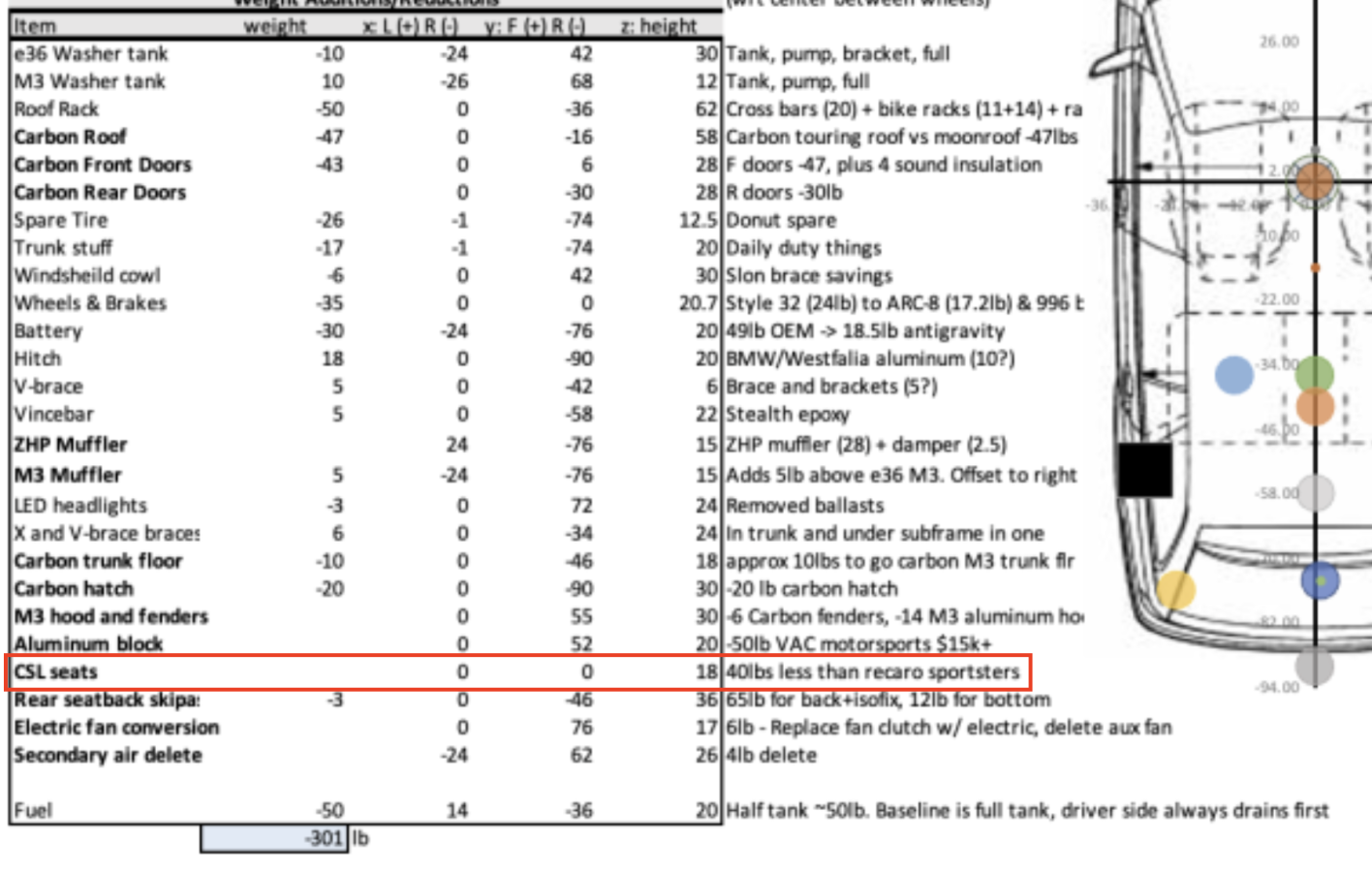

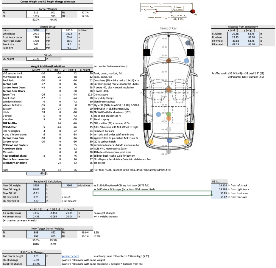

    Here’s the weight distribution all said and done, almost perfect 50/50 (I’d prefer 48/52):
    Click image for larger version  Name:	Screenshot 2026-07-10 at 12.56.31 PM.png Views:	0 Size:	348.5 KB ID:	360755

      Do I read anything into this line? 😉

        Ha, how about the line above it?!
        Mostly several of those items are an exercise to see what is possible in what I’d consider a no-compromise (except $) M3 touring. Fully populating that list but keeping the stock M3 muffler, keeping the hitch, full interior, etc gets you to ~3150lb and 49/51 weight distribution. A couple gallons of water heavier but better weight distribution than the CSL. All with a functional/comfortable back seat and trunk.
          Ah haha - I completely missed that 😂

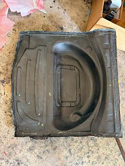

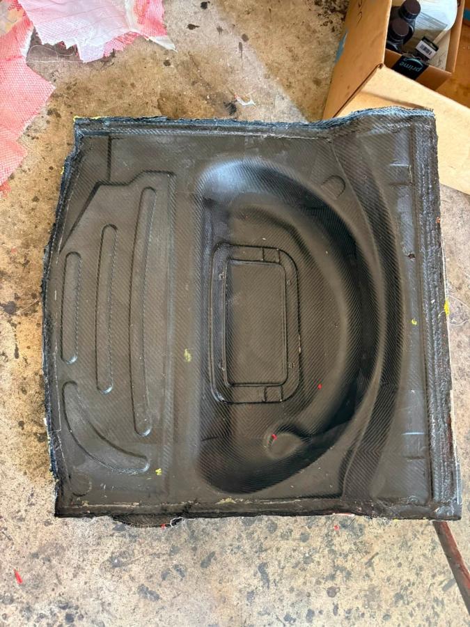

              I am making the CF M3 trunk floor for Bry5on. I was working long hours to try and get it done on time. Two problems. First, never rush composites work because it never goes well. Second, I'm old and the weather in Houston just turned to its usual summer swelter. I didn't make it.
              I could have made it if the part was smaller then I could risk using a faster cure epoxy. First time infusing on this mold which is not flat, not sure how long it would have taken. In the end, it would have been close.
              Straight out of the mold! Not perfect cosmetically but looks good! I used a parts car to pull the mold and had to leave the EVAP canister mount in. The underside and ground were disgusting and there was no way I could block off the opening within the timeframe I had. I think I can make that from CF as well so that can be riveted and bonded onto the part.

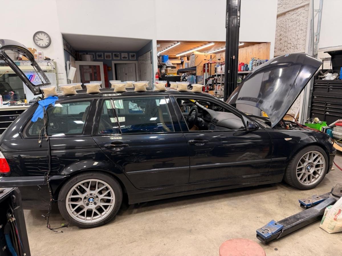

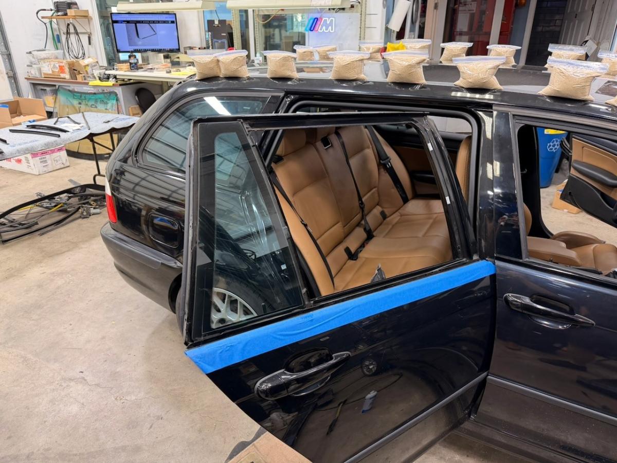

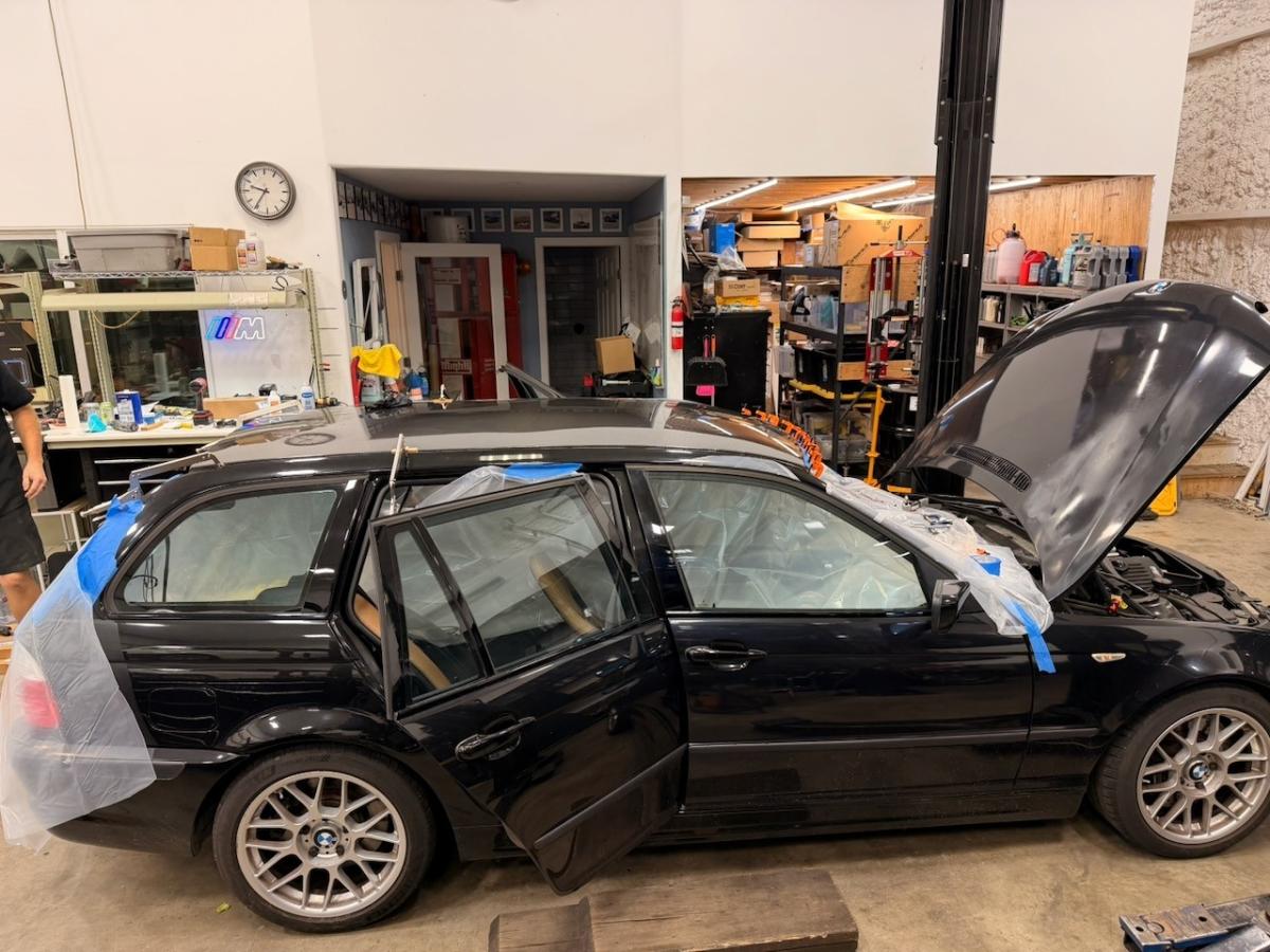

                  Day 2 at HPB. Got a full day in today.
                  Click image for larger version  Name:	IMG_9496.jpg Views:	0 Size:	140.1 KB ID:	361800 Click image for larger version  Name:	IMG_9503.jpg Views:	0 Size:	158.6 KB ID:	361799
                  Click image for larger version  Name:	IMG_9504.jpg Views:	0 Size:	91.3 KB ID:	361796 Click image for larger version  Name:	IMG_9507.jpg Views:	0 Size:	155.5 KB ID:	361798 Click image for larger version  Name:	IMG_9510.jpg Views:	0 Size:	187.2 KB ID:	361797

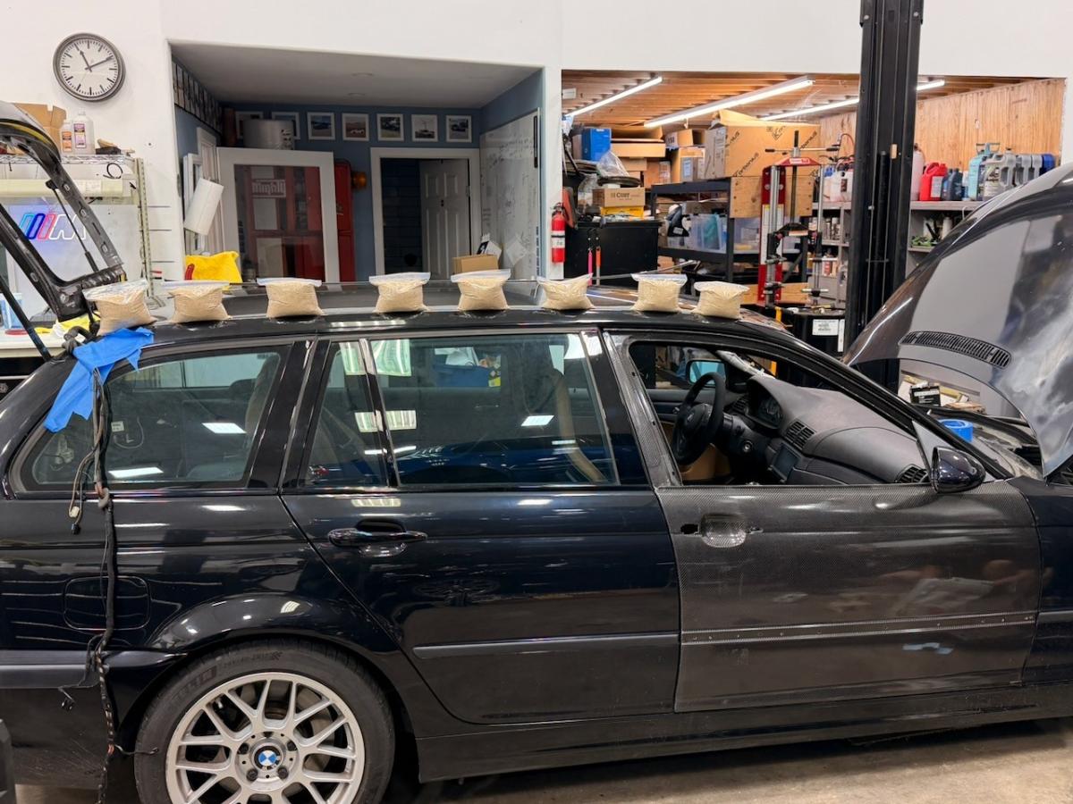

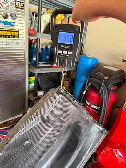

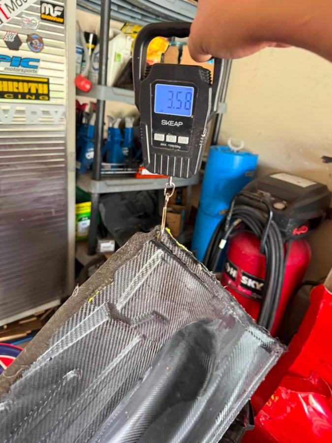

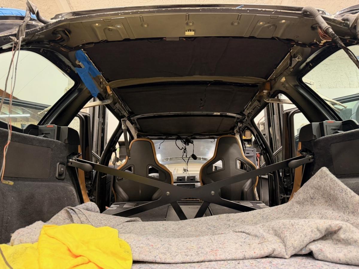

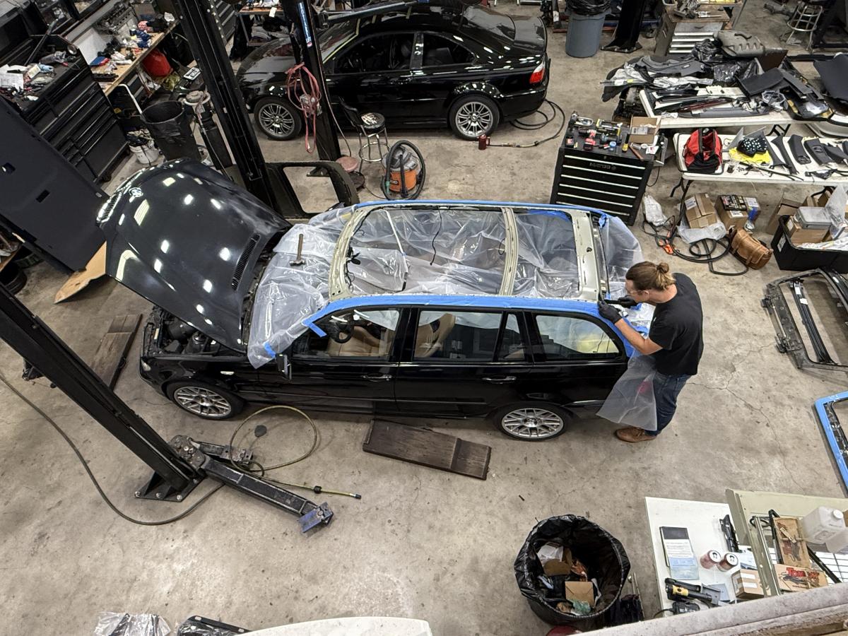

                    Final tally, 59lb. Hot damn.
                    Sunroof roof 33.5lb
                    Sunroof glass 14 (Heinz)
                    Sunroof cassette 16.5 (Heinz)
                    Sunroof extra shit 4.5 (3.5 is headliner cover, 4oz wiring harness, bee stinger, roof drains, etc)
                    Sunroof headliner 7
                    Total ~75
                    Carbon roof 8lb
                    Slicktop headliner 5.7
                    Roof bar 2.3lb
                    Epoxy .3lb
                    Total ~16​
                    4.7% body roll reduction
                    7.3% reduction with hatch, F doors, trunk floor
                    - Doors 1.6%
                    - Hatch .8%
                    - Trunk floor .2%

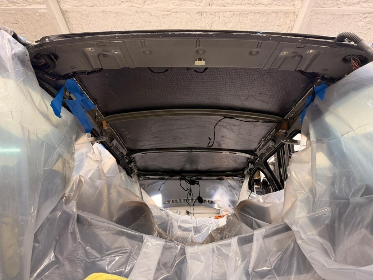

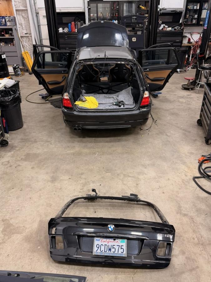

                    Day 3 at HPB:
                    Click image for larger version  Name:	IMG_9514.jpg Views:	0 Size:	130.7 KB ID:	361803 Click image for larger version  Name:	IMG_9515.jpg Views:	0 Size:	150.9 KB ID:	361807 Click image for larger version  Name:	IMG_9527.jpg Views:	0 Size:	116.1 KB ID:	361804 Click image for larger version  Name:	IMG_9522.jpg Views:	0 Size:	164.9 KB ID:	361805 Click image for larger version  Name:	IMG_9526.jpg Views:	0 Size:	169.4 KB ID:	361808 Click image for larger version  Name:	IMG_9534.jpg Views:	0 Size:	160.1 KB ID:	361806 Click image for larger version  Name:	IMG_9535.jpg Views:	0 Size:	157.8 KB ID:	361809

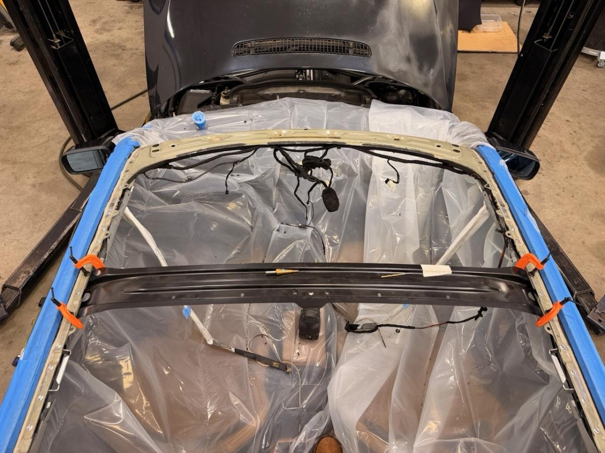

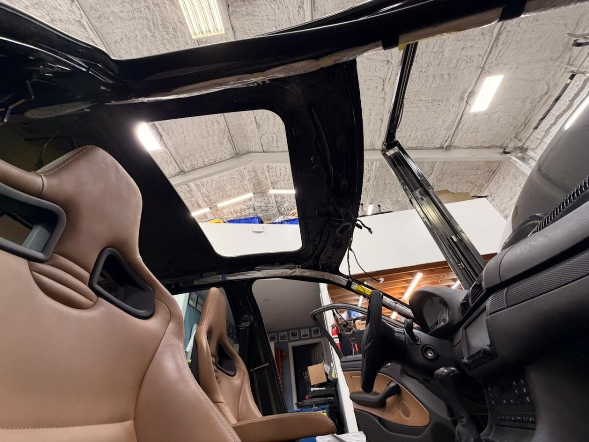

                      Body matched slicktop^2 rails going in. ‘Bonding’ retaining clips With adhesive tape:​
ID:	361814 Click image for larger version

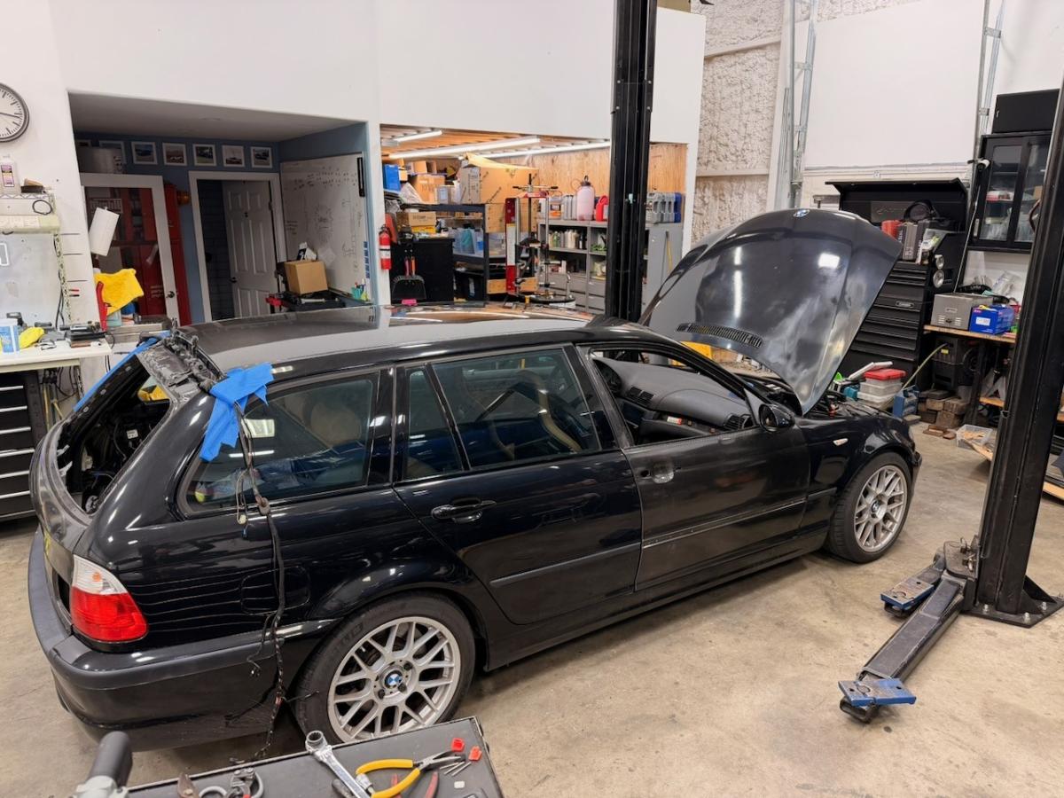

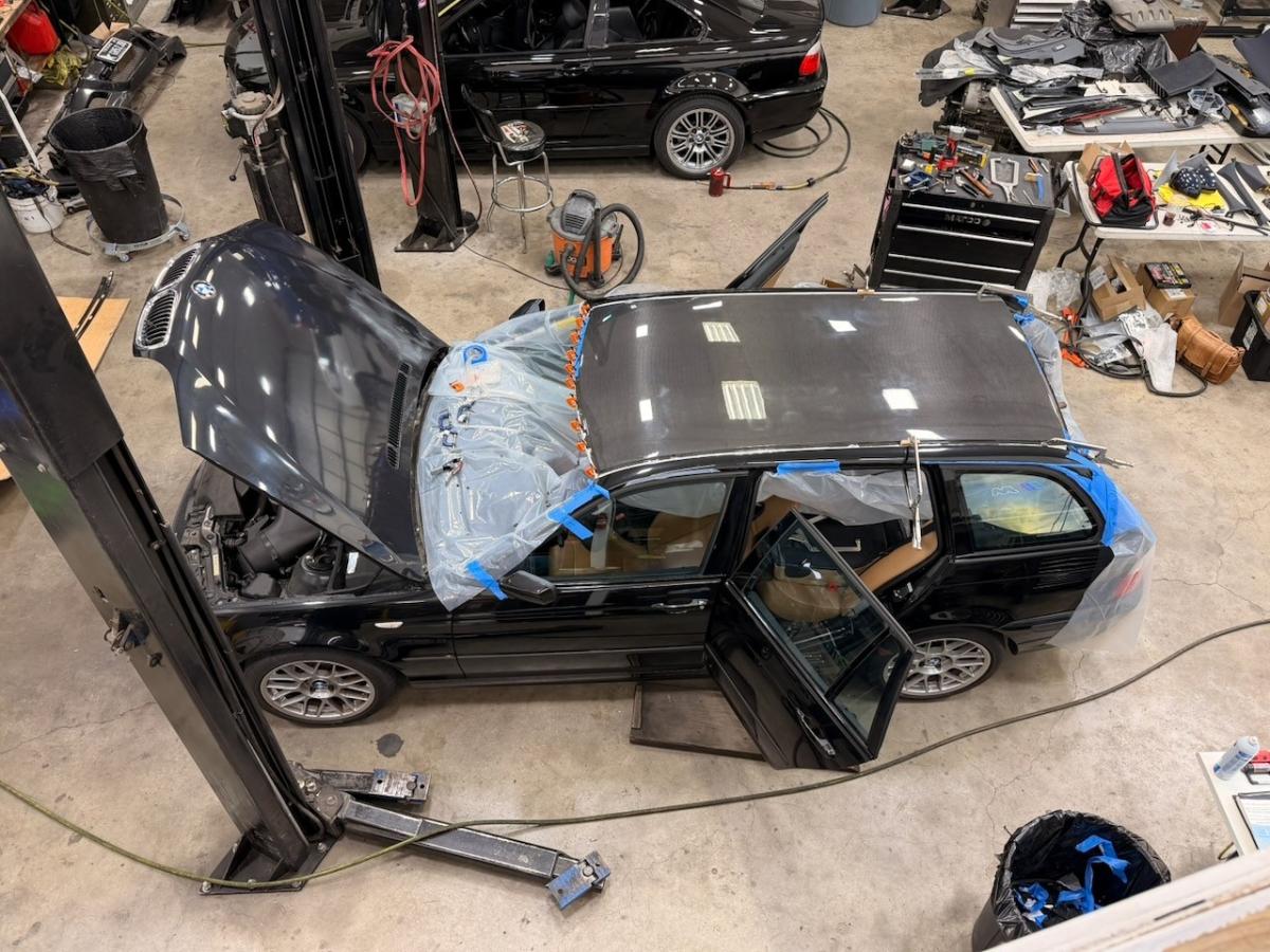

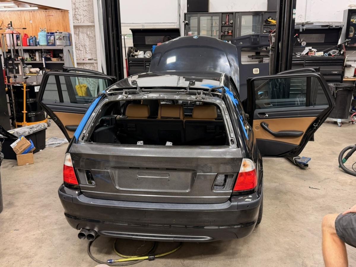

                        Day 4 at HPB:

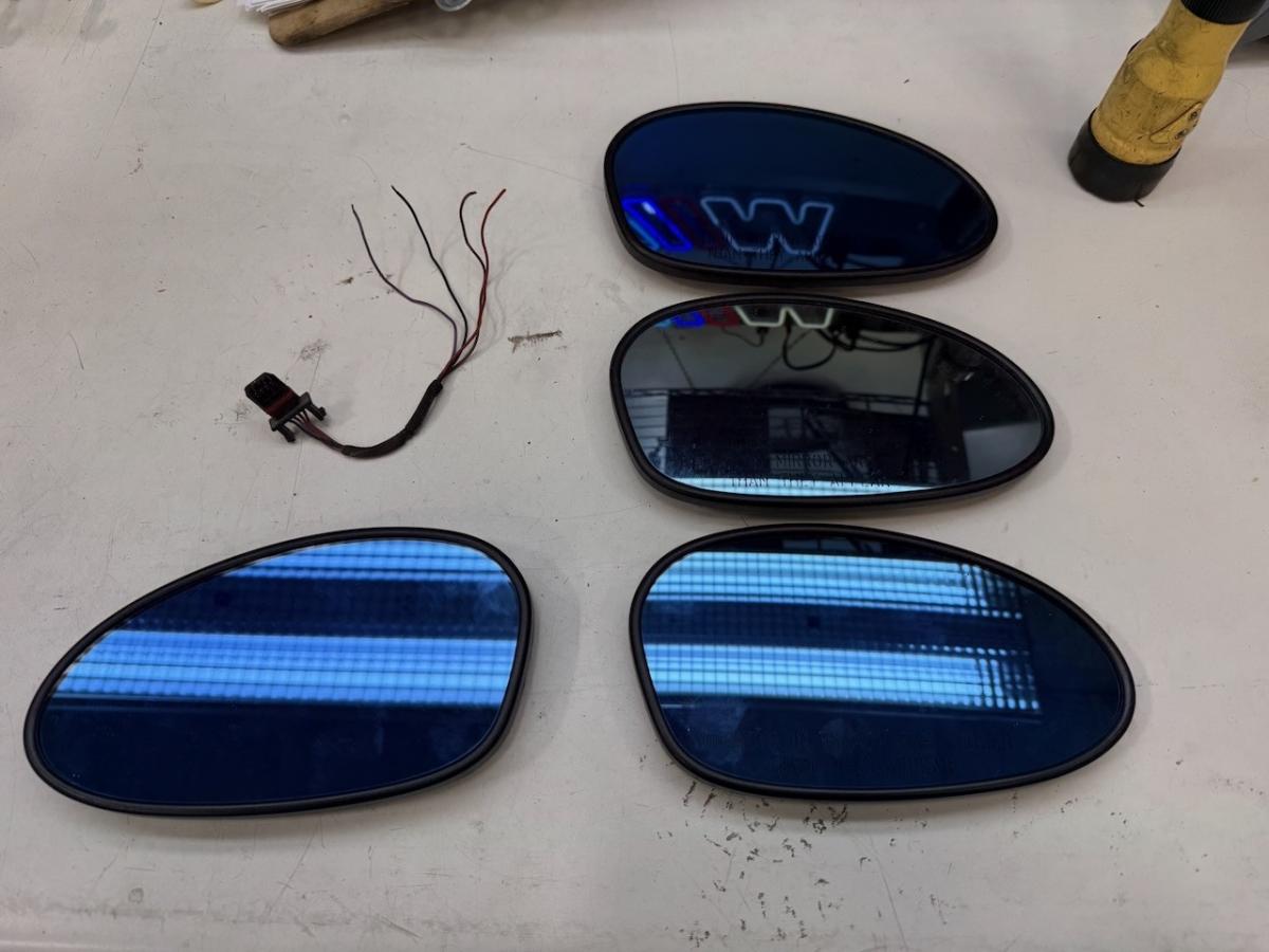

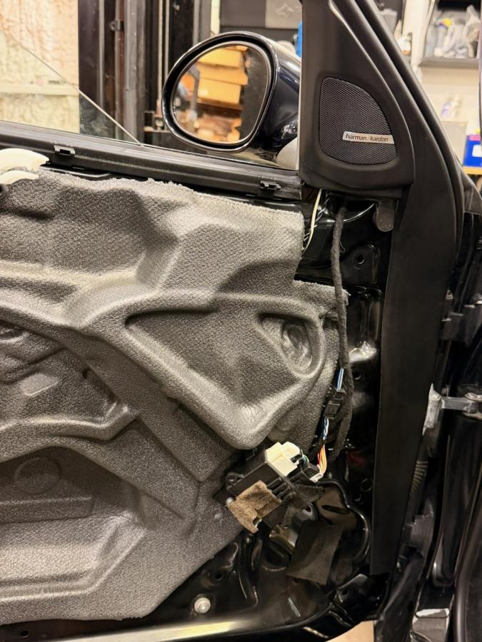

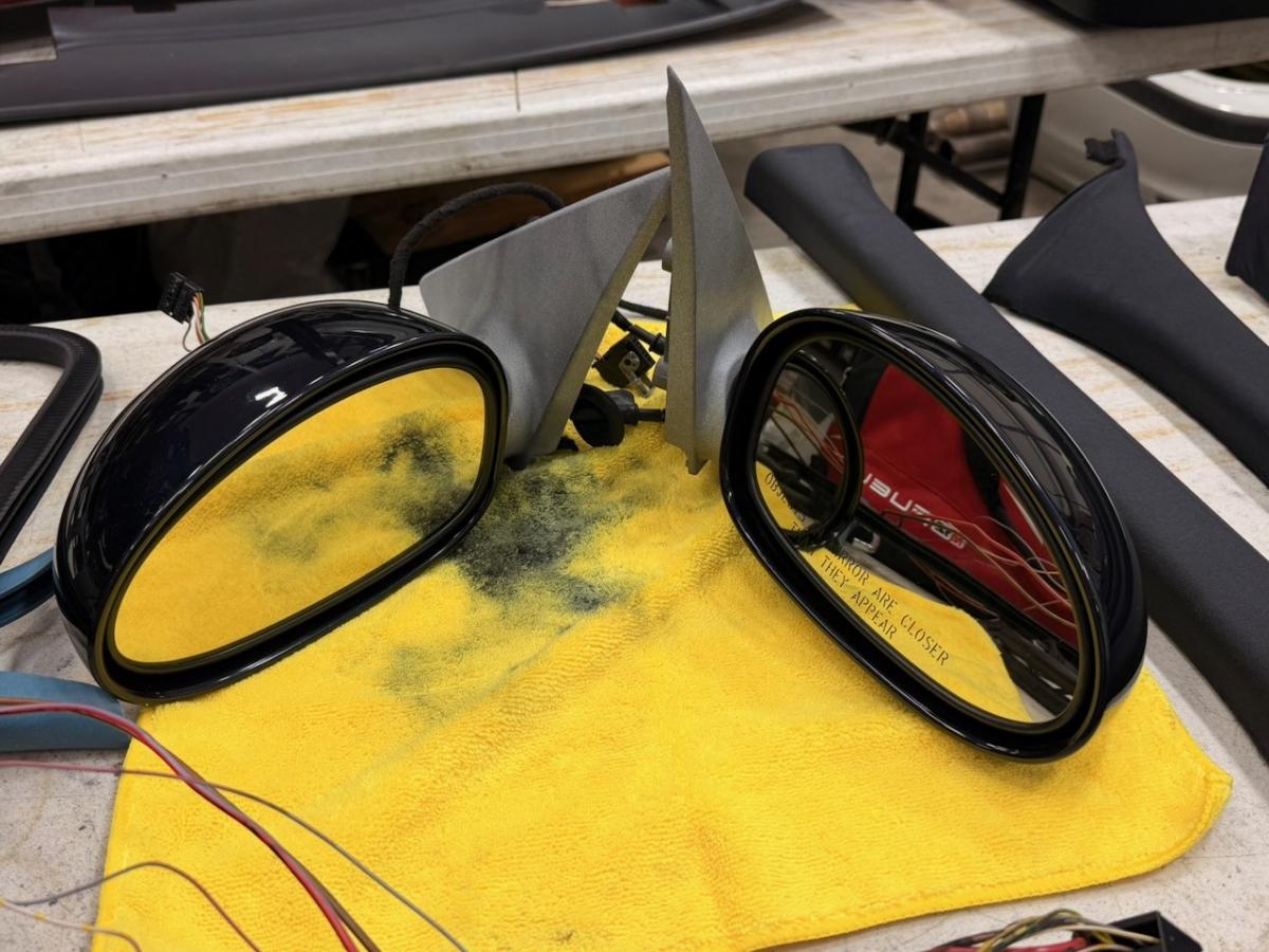

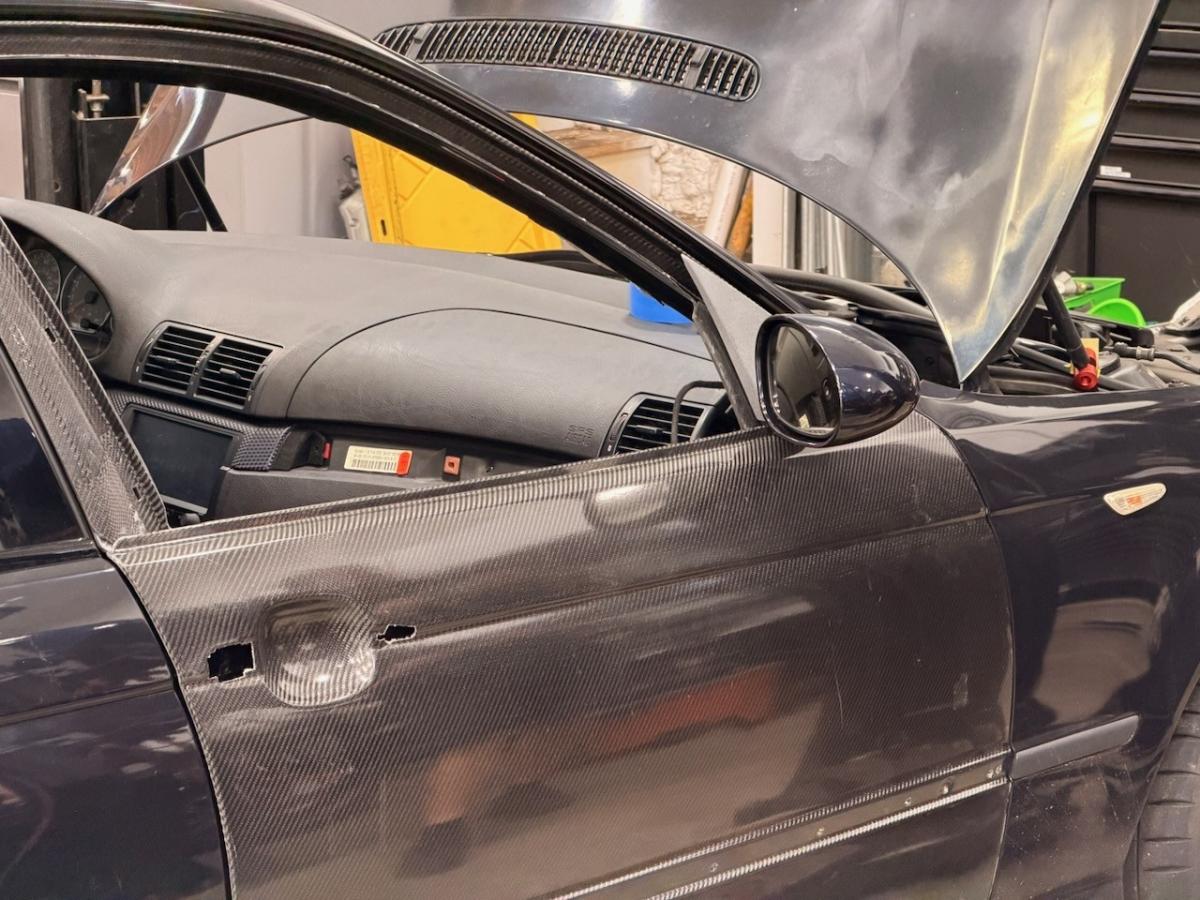

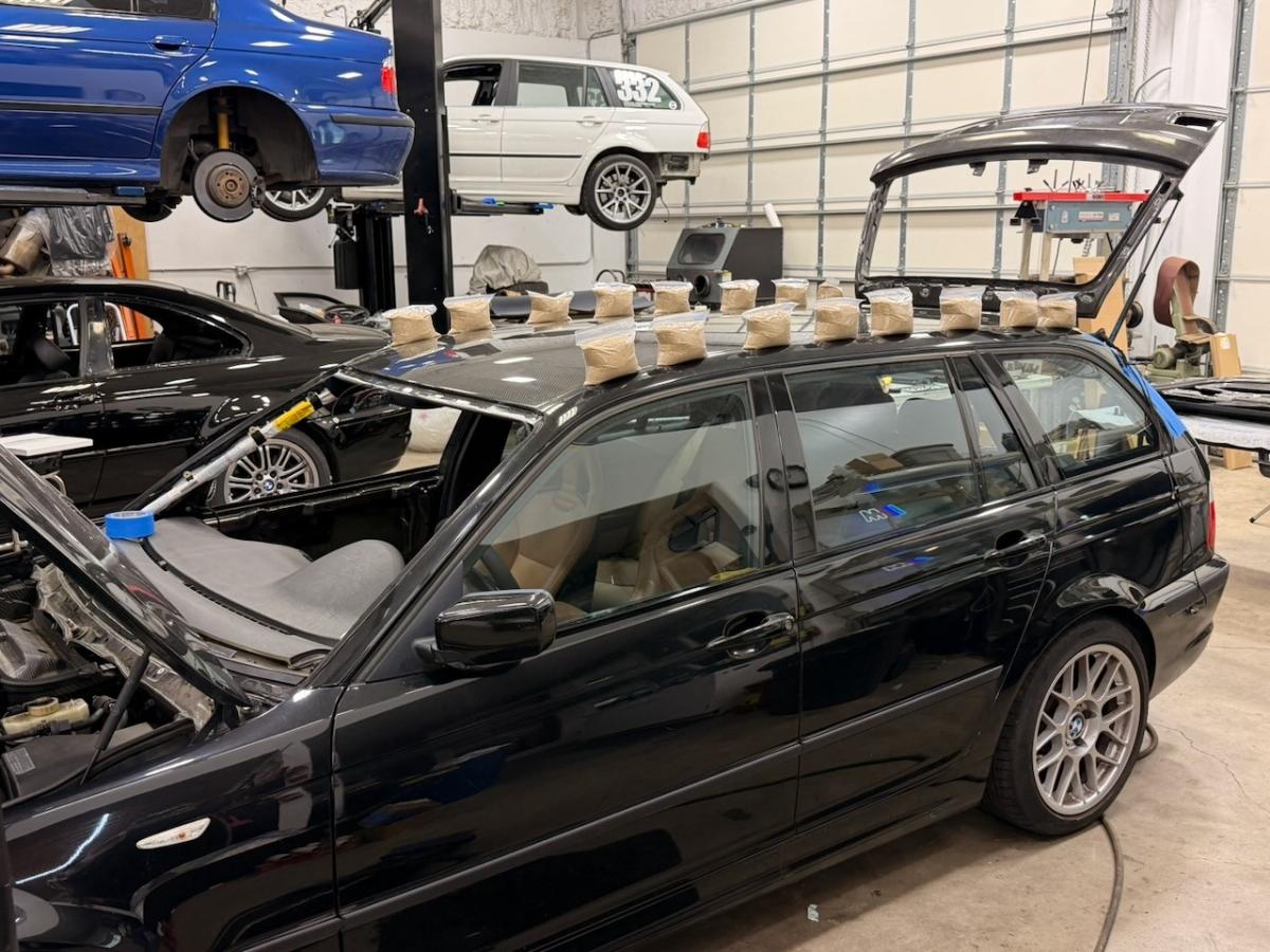

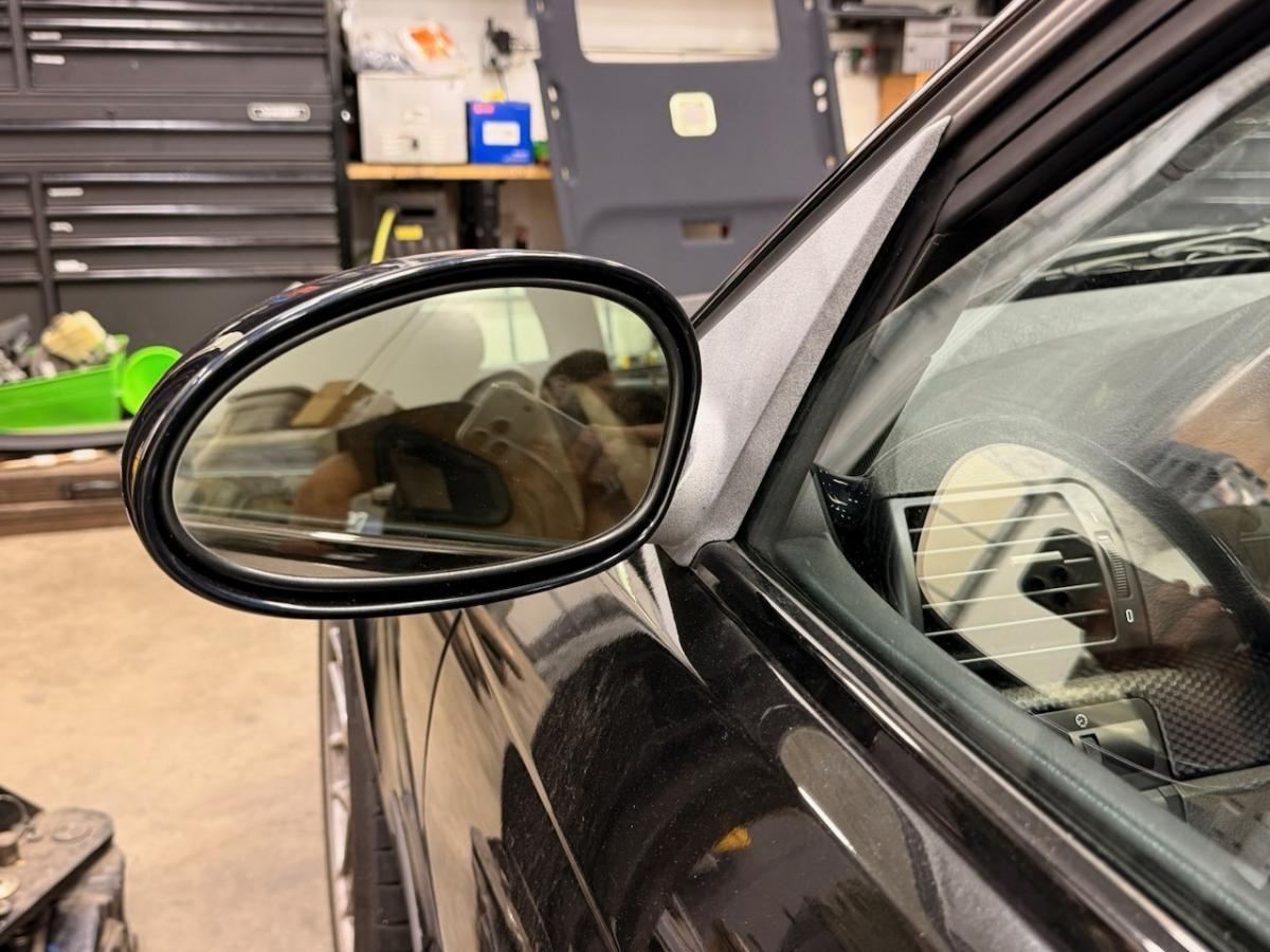

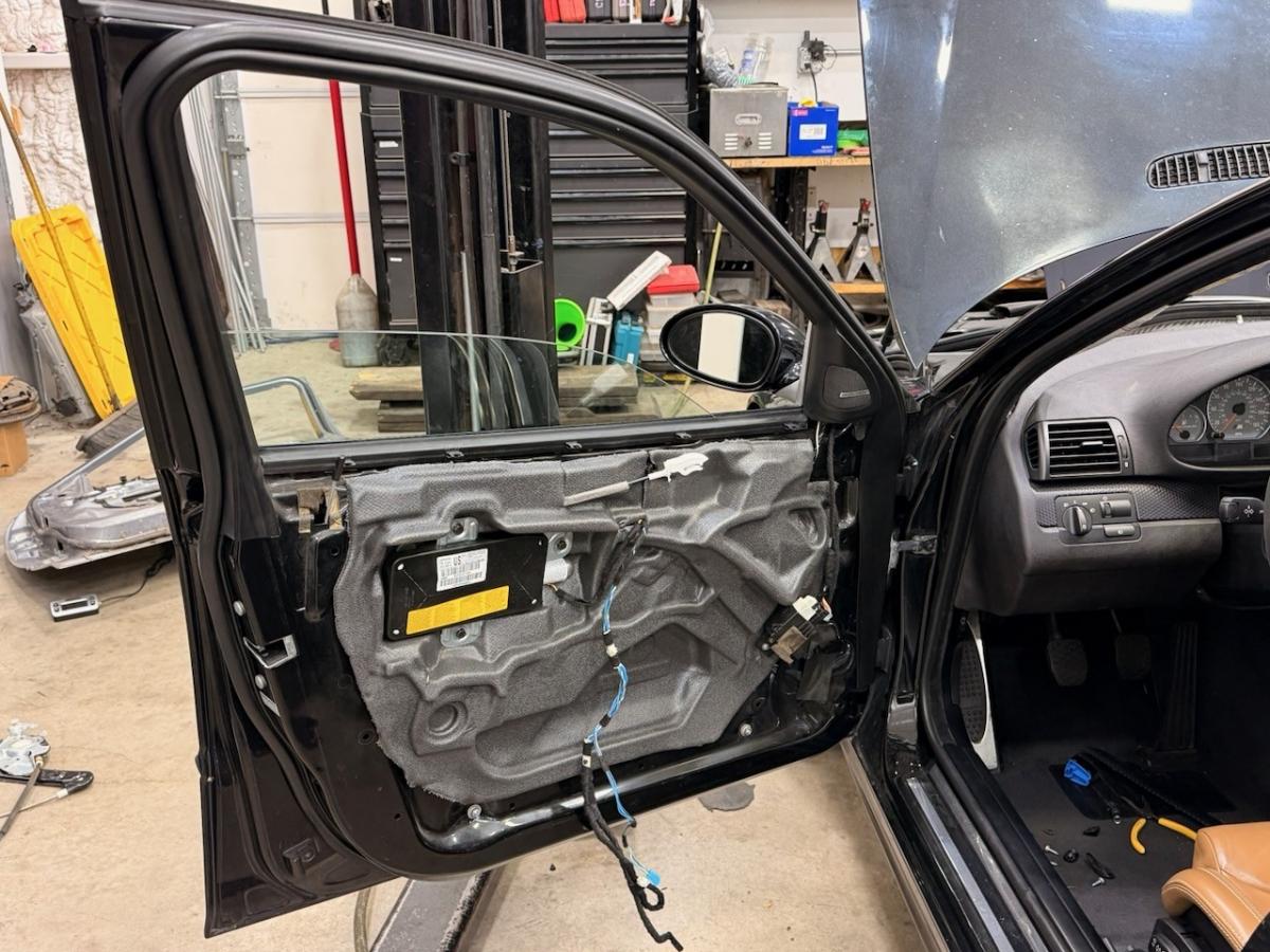

                        Bonded the roof rail clips, removed the carbon door - back to steel, finished the M3 mirror install, debugged and determined how the e90 side view mirrors dim, and made them dim 😎.
                        We will leave the carbon doors and hatch for another time as the doors need some detail work and this way I can paint everything before install. We did determine that e93 trunk struts are a good option for the lighter hatch and are ordering something that should nail it from the stabilus catalog for the future. Also it looks like the quad exhaust has to wait, as the donor M3 floor wasn’t quite good enough, and the carbon one didn’t quite make it in time.​

                          well, damn. this is awesome. so.... attila's mirror bases, then... M3 mirror bodies, and pre-facelift E9x mirror glass? slick. very very slick. what mirror motor - E9x?
                          very curious to hear about the end result on the lighter-duty hatch struts as well.
                          so.... when is Phase 2 happening?​

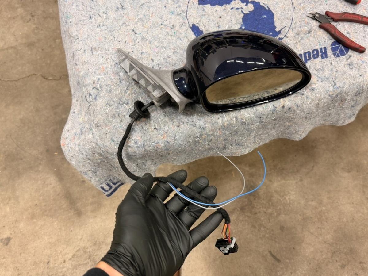

                          e90 pre-LCI sport mirror glass, e46 mirror motor.

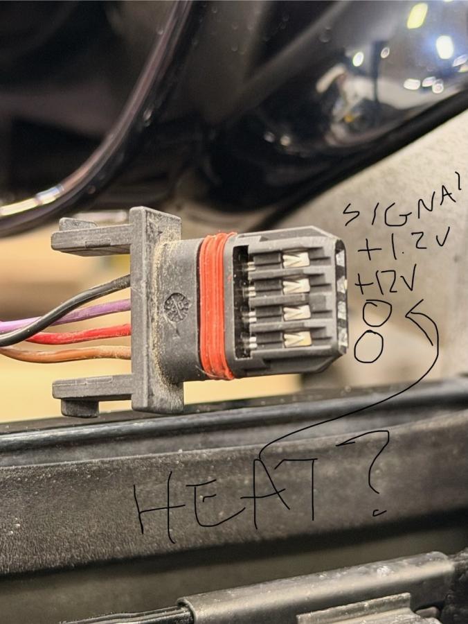

                          The current circuit we have wired does activate dimming but it doesn’t utilize the full range of dimming, so I’ll design something that fixes that
                          But the wires to the glass are
                          Brown: Shared Ground
                          Red: Mirror heating switched 12V
                          Purple: Mirror dimming switched 12V (switched on when dimming should be active)
                          Black: Mirror dimming signal 0-1.3V depending on dimness
                          Currently I have the mirror wired to Brown and Purple directly to the 0-1.3V signal from the central mirror itself. This will dim the unit but not full range. George and his epic collection of cars were invariable in their assistance in the end to get this down, as the ETS doesn’t have this info.
                          Many electrochromatic mirror glasses were harmed in the making of this post.​

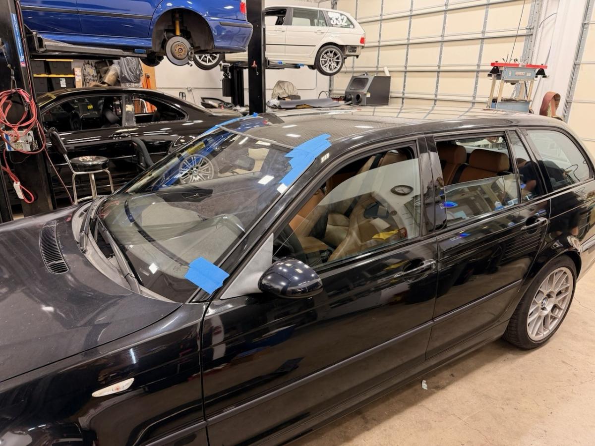

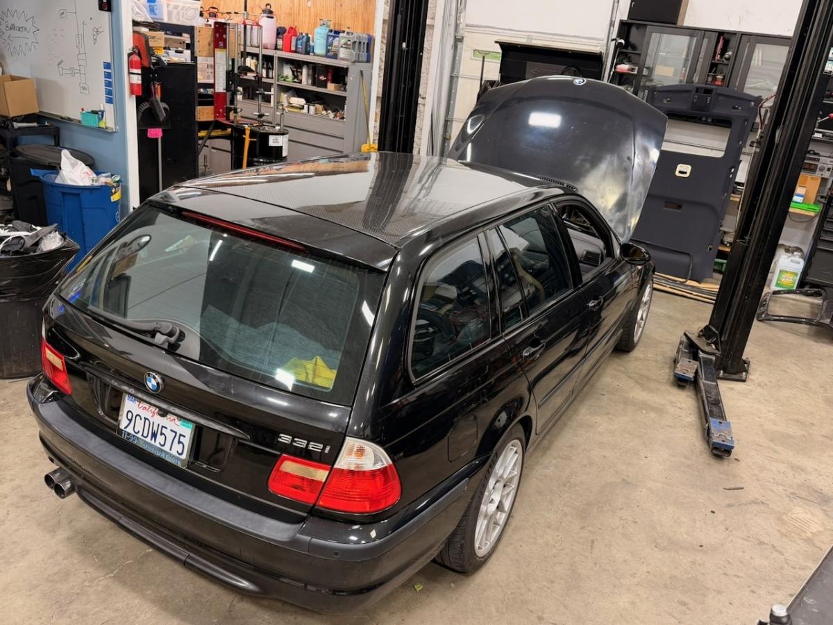

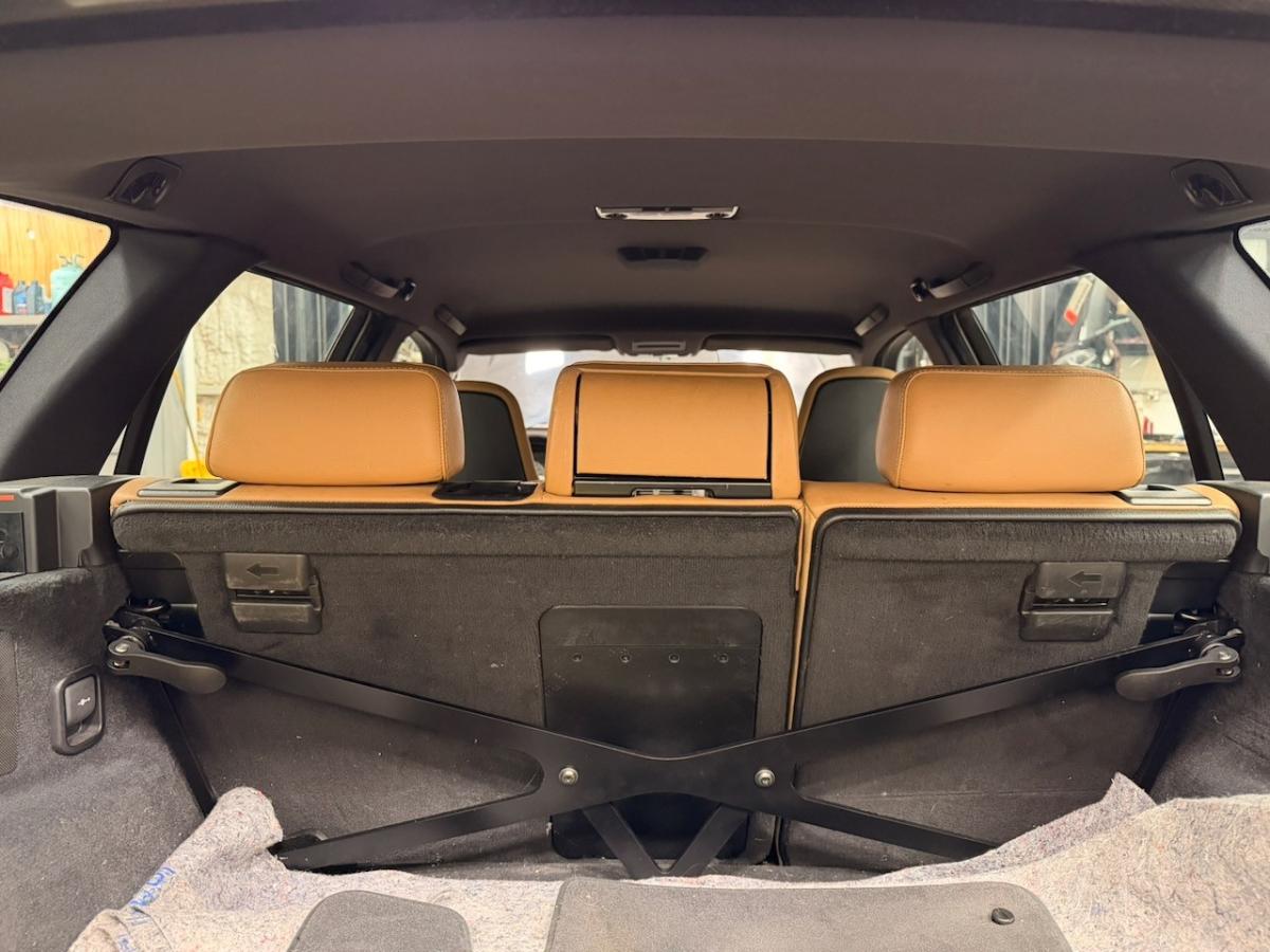

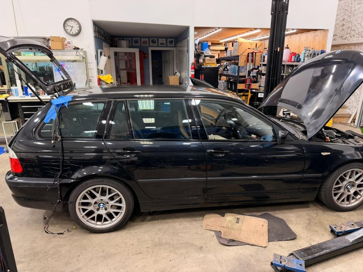

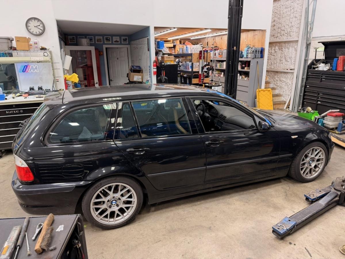

                            Days 5 and 6 were thankfully more chill. Got the factory fresh vertical chrome shadow line trim installed in everything but the front doors (carbon doors will get those). Replaced the rear rear door glass trim using the excellent @malapane trick and boy what a nice subtle improvement. Also installed the hatch and trim, plugged sunroof drain holes, got the IR comfort windshield installed, bench flashed a mullet tune and George gave me a ride back to the airport so I can make the trip home. We’ll ship the car back to SD in the coming weeks and George has agreed to shake the car out with a very critical eye for me
                            Jobs waiting for me at home are installing a rain sensor prism (can’t get sedan/touring comfort windshield with rain/light sense), doing the bigjae46 trunk floor and M3 muffler, then attacking carbon trimming on the door and sending doors, hatch, mirrors out for paint before assembling everything. After fitting my stock hatch, we realized that the carbon one is the exact same shape 😅 so no issues there.
                            So far just a cruise since the windshield is setting but the cabin is definitely quieter without the sunroof!! Super pleasant result. Can’t wait to toss it into some corners now, and to get George’s longer term thoughts.
                            What a great trip, thank you George!!!​
